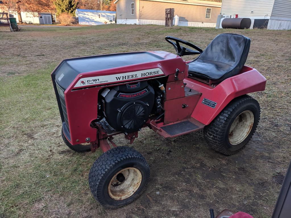

Probably going to put the carlisle tru power ags on the back of this. Cannot decide on 8.5 or 10.5" width.  Looking to see everyone's setup.  Also, what will look good in the front?
This will be the machine running my snowblower and probably mowing a few acres a week come the summer.

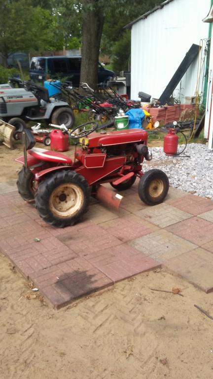

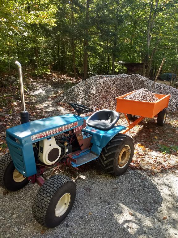

 Here is one of my tractors are used some 8.50 x 12 works good for me

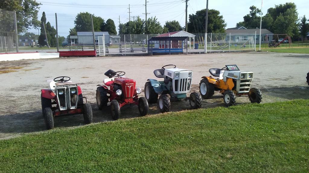

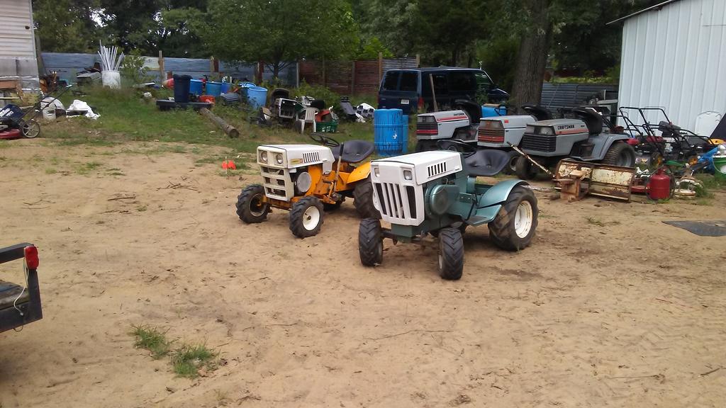

23x8.50x12 Carlisle power tracs on the Sears compact 8e and 23x10.50x12 Goodyear (same tread has hi-runs and other brands) on the other. I don't run ags on wheel horses except 701 which are original ones. The power tracs do the best out of all I tried. I do have bkt trentchers on a craftsman size 23x10.50x12. They do alright

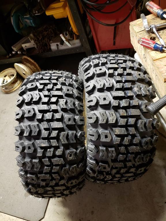

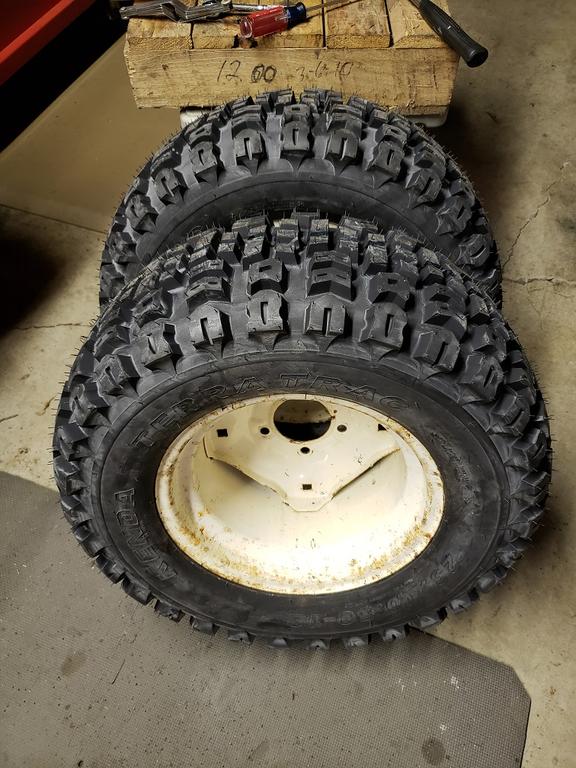

Not ags like you're talking about, but I went with Kenda Terra Trac's for my Bronco 14. These are 23x10.5-12 on 7" wide wheels.
Also, i like having the fronts match, so the fronts will be the same. I went with these cause they are more aggressive than turfs, but not as much as ags

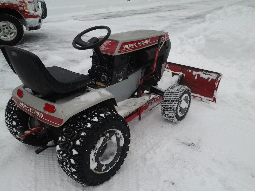

I'll play....

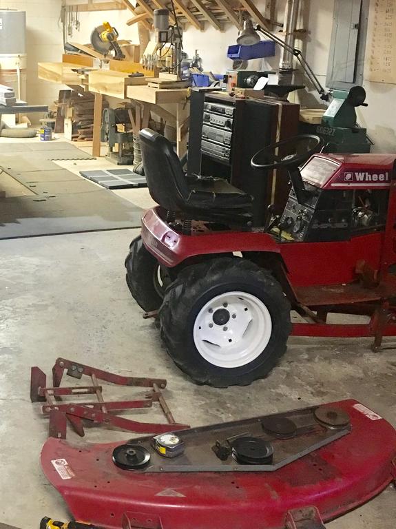

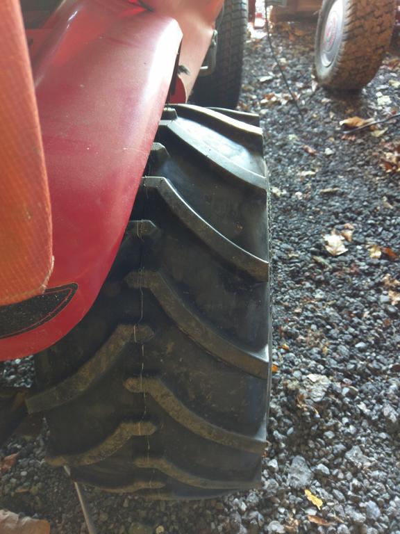

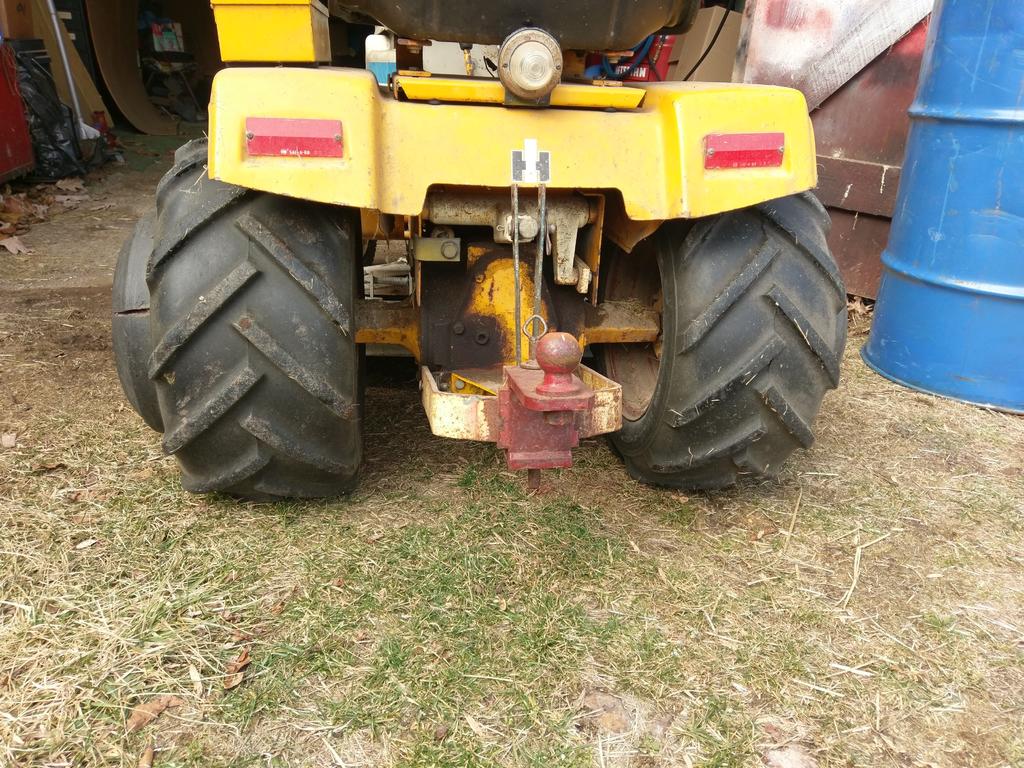

Deestone ag rear tires 23x10.5-12 people are right when they tell you these run small on width mine are in reality maybe a hair over 8 1/2 inches wide. I wanted more or less stock width so worked out great for me.
Fronts are  deestone 4.00x8 triribs

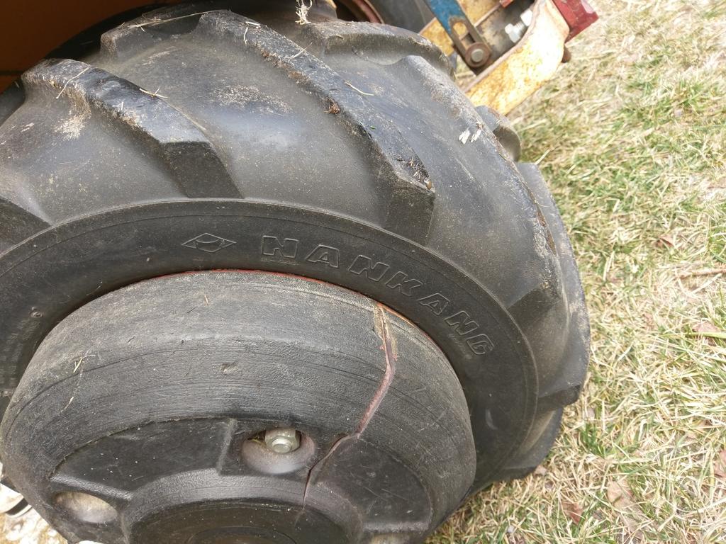

31 minutes ago, WildmanC120 said:
Would those in 10.5 fit my rims?

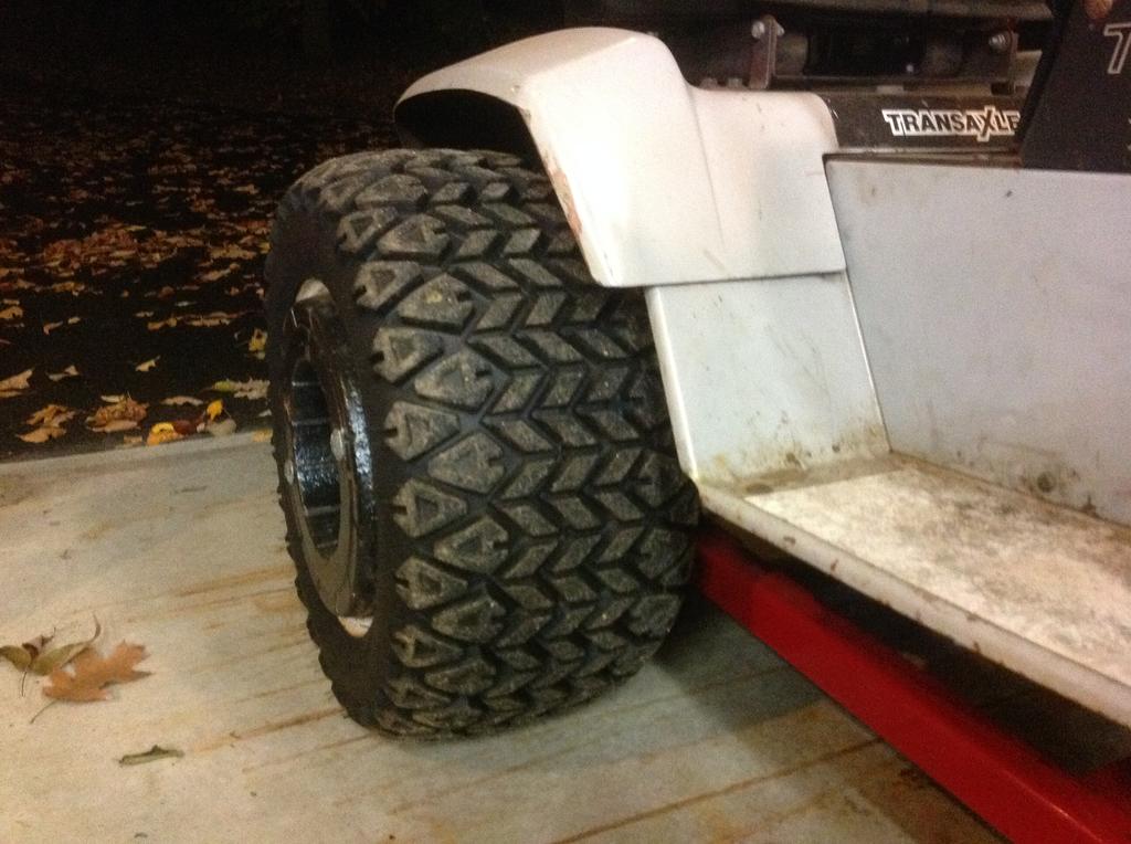

They will fit but they may "bulge" a bit at the sidewalls I put (NanKang)10.50s on my dad's Cub with the 7.5" wide wheels here's what they look like...

2 hours ago, Digger 66 said:
I'll play....
Pretty sure this photo was the inspiration for me getting the tires I did. Cool tractor!

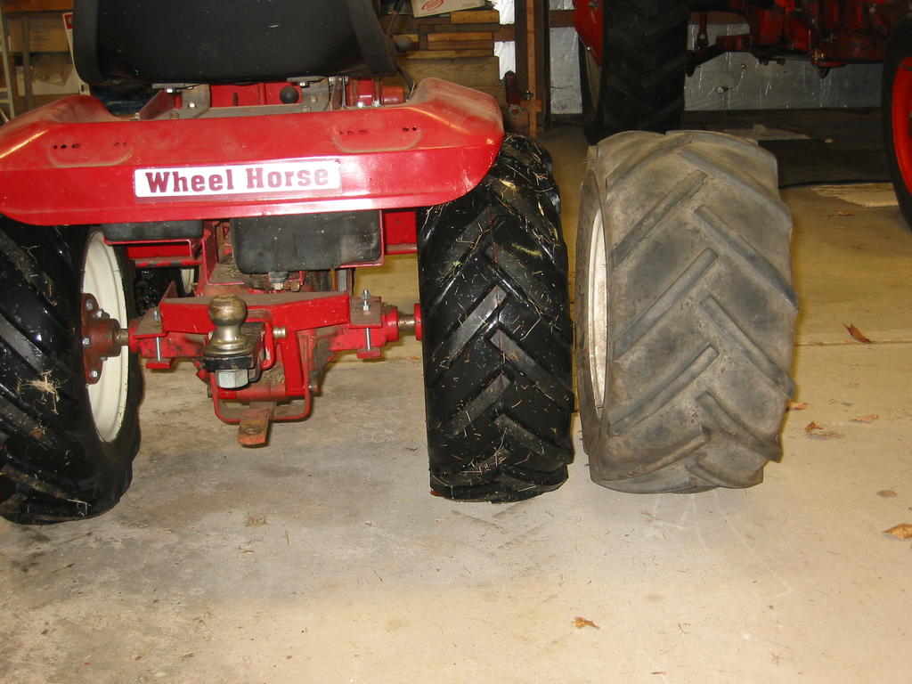

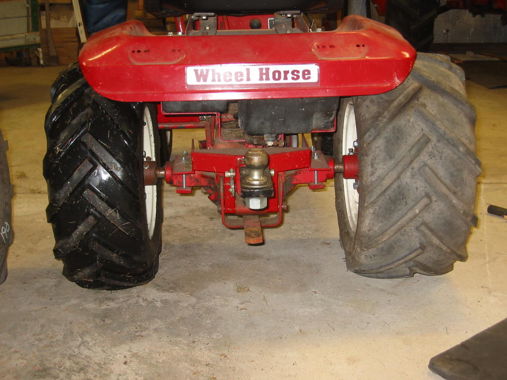

pfrederi

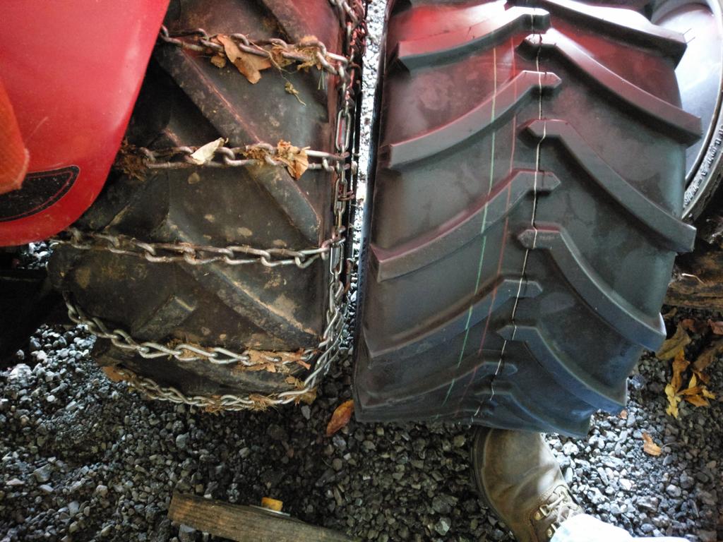

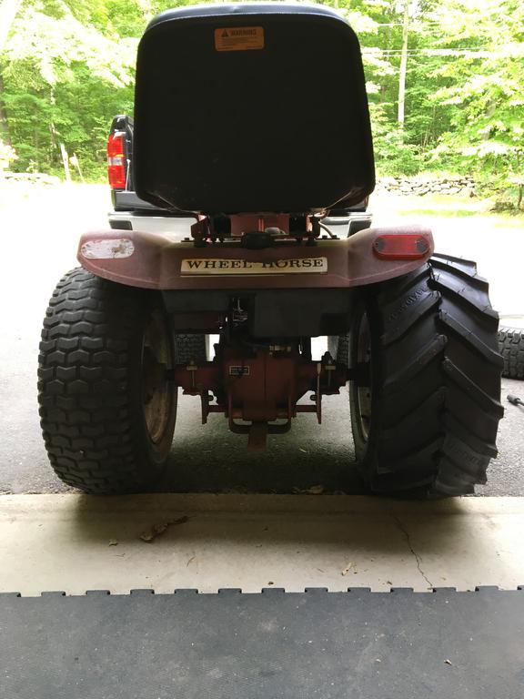

Saying Deestones run small would be an understatement..Carlisle 10.50 vs Deestone 10.5
WOW, first time I have seen someone post side by side pics and it really tells the story of how much difference there is!!
