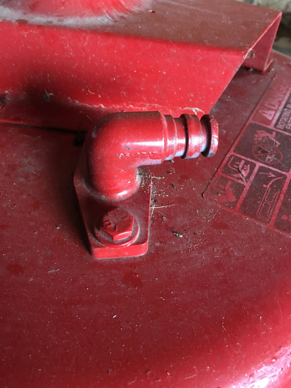

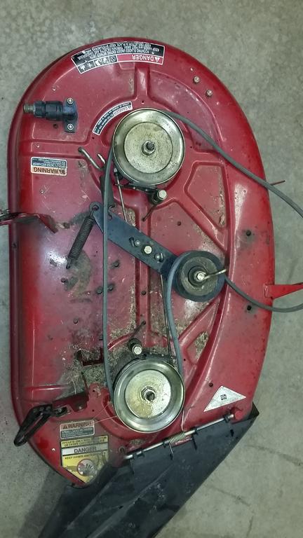

Jake0030 47 #1 Posted November 7, 2018 So, just Got the 312-8 winter ready: oil change, snow thrower, weights, chains and all. I was rather unprepared for what i found under the 42" mowing deck (model 78345) when i went to clean it and get it winter ready. It is clear I should have been doing regular, routine cleaning of the underside of the deck this past summer, but i did not. Well, Deck has been thoroughly cleaned, lubed and spindles hit with grease gun before setting aside for the winter. Here is the question, what should my regular cleaning entail next mowing season? I have this funny little hose attachment on the deck, not sure for air or water or what? Any tips members can give me on what regular cleaning routine should be, would be quite helpful. You would think I was scraping and washing 10 year old cow dung off the bottom of that deck when i finally got around to cleaning it. Thanks in advance for any replies. Share this post Link to post Share on other sites
WHX?? 56,709 #2 Posted November 7, 2018 (edited) Here is the manual for your deck in case you don't have one. Some tips in there on service. https://www.wheelhorseforum.com/files/file/3083-mower-rotary-42in-sd-2002-2012-2014-2016-78345-3-400-om-snpdf/ And an IPL https://www.wheelhorseforum.com/files/file/2294-mower-rotary-42in-sd-2000-2012-2014-2016-78345-3-400-iplpdf/ You'll notice that fitting is not on the IPL. Some later model deck had them, some didn't. Mostly only smaller decks had them from factory but were often added by a dealer. It's a deck wash fitting and was meant to hook up to a garden hose for washing the underside. Was a Toro thing to try and help keep the underside clean. You are (probably) missing the quick attach that goes on the end of the garden hose but they can be had yet from a dealer or Partstree or other places. Supposed to be O-rings in those grooves. Couple of different schools of thought on deck washing. Some like it some don't. Claim it leads to premature rusting but wet grass buildup will too. Claim it can put water in spindle bearings which it does so regular greasing is in order. You have to do it right after EVERY mowing or the buildup won't come off. One deck I have came with it, top pic upper left, so I thought it a good idea and bought one and installed it on another deck, just below the deer corn, and do use them. No substitute for pulling the deck and manual cleaning tho. Edited November 7, 2018 by WHX21 1 Share this post Link to post Share on other sites
Kenneth R Cluley 679 #3 Posted November 7, 2018 The fitting is for garden hose to attach. Turn on water and run mower and it is supposed to clean deck. Previous posts have described in detail some successful methods for maintenance. 1 Share this post Link to post Share on other sites

peter lena 9,895 #5 Posted November 7, 2018 this is what I do , on a regular basis , if you want your deck to last , you must break the stagnant moisture cycle, I also leave it upside down over winter , with another oil soak , this is only me , but it works , pete 1 Share this post Link to post Share on other sites

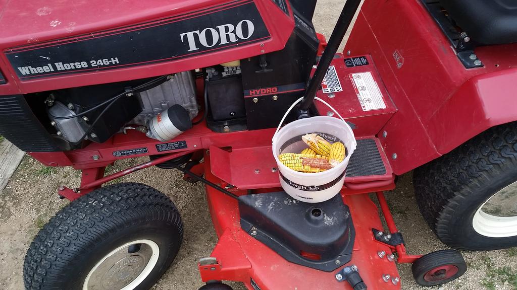

953 nut 66,369 #6 Posted November 8, 2018 19 hours ago, WHX21 said: I thought it a good idea and bought one and installed it on another deck, just below the deer corn, and do use them. Or you could use the deck to shell, crack and spread the deer corn and the abrasion would clean the underside. Seriously; I have had good luck with Plastidip spray coating, clipping don't stick to it. 1 Share this post Link to post Share on other sites
