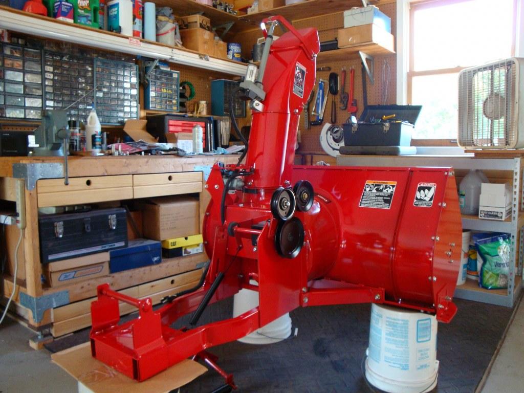

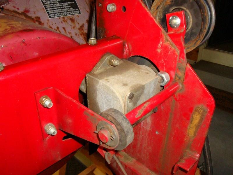

CTBT&D 77 #8 Posted November 12, 2018 I checked mine back in 2010 while doing a complete refresh, paint and customizing. Had no leaks with gear oil, cleaned and refilled with 90W gear oil about half full. No problems for 6 seasons. The first picture is the way I got it, except for the nut as a spacer. The gear box had bent the mounting surface, I used the nut to keep the box somewhat square to the machine so I could run it. Picture #2 was after the refresh. I did reinforce the mounting surface for the gearbox by welding 1/4" plates on the other side. 3 1 Share this post Link to post Share on other sites
cleat 9,382 #9 Posted November 13, 2018 Blower looks great. All power too.... Share this post Link to post Share on other sites
David Portenier 8 #10 Posted November 16, 2018 Holy Moly that paint job is stellar!!!!!!!!!! Share this post Link to post Share on other sites
