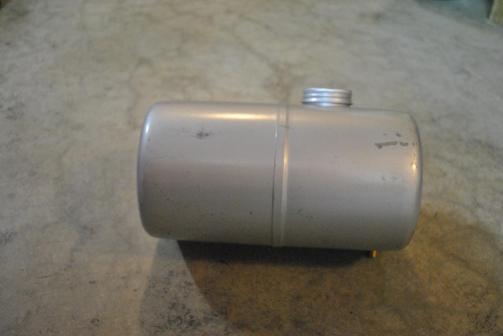

Horse Play 393 #28 Posted June 9, 2019 Well it is 12:30am on a Sunday morning! I have a few things accomplished, but also have some more issues. The good: - mud work is almost complete on the hood. The hood is far from perfect, but I am going to be lazy and move on. I really should call this "Project Good Enough" - recieved a proper 1611 transmission input pulley (I have been looking for one for a long time) - I may have fixed my bent rear wheel (at the hub-center area) with a BFH, scrap piece of 2x4, and Rocky Mountain Kool-Aid The bad: - wrong gas tank. I knew I had the "wrong" gas tank all along because it has the petcock on the same side as the cap, but I was going to use it until I found the proper RJ tank. But now I realized this tank I have will not fit properly if I install the tank straps to their original location. So now I am debating on waiting to come across the proper tank or use this one with the straps in a different location. Share this post Link to post Share on other sites
wallfish 20,724 #29 Posted June 9, 2019 Not only the petcock location, but original RJ tanks had the filler neck closer to the edge of the tank. They are difficult to find as many are gone and many also seek them. They can go for good money if you do find one. IMO if you are not going completely "all the way" might as well use the tank you have. Only the observant RJ collector will ever know the difference anyway. Share this post Link to post Share on other sites
71_Bronco 1,073 #30 Posted June 9, 2019 There's one on Ebay right now that looks like it may be what you need (at least to the untrained eye). Its not listed as an RJ tank, so search for "wheel horse gas tank" and you should find it. From what I can see, I think you're doing a great job on it. Share this post Link to post Share on other sites
Horse Play 393 #31 Posted June 9, 2019 22 minutes ago, 71_Bronco said: There's one on Ebay right now that looks like it may be what you need (at least to the untrained eye). Its not listed as an RJ tank, so search for "wheel horse gas tank" and you should find it. From what I can see, I think you're doing a great job on it. Is it the silver one? If so, I already contacted the seller Friday and the tank is too long; it would hit the steering shaft. Share this post Link to post Share on other sites
71_Bronco 1,073 #32 Posted June 9, 2019 9 minutes ago, Horse Play said: Is it the silver one? If so, I already contacted the seller Friday and the tank is too long; it would hit the steering shaft. Yes, the silver one with the pair of straps. Hard to tell the size with nothing to reference for size. Share this post Link to post Share on other sites
Horse Play 393 #33 Posted June 9, 2019 22 minutes ago, 71_Bronco said: Yes, the silver one with the pair of straps. Hard to tell the size with nothing to reference for size. Yup, you and I were thinking the same thing. To where the the cap is really close to the edge and is overall 1-1/2" longer than my tank, it kicks the tank too close to the steering shaft. Share this post Link to post Share on other sites

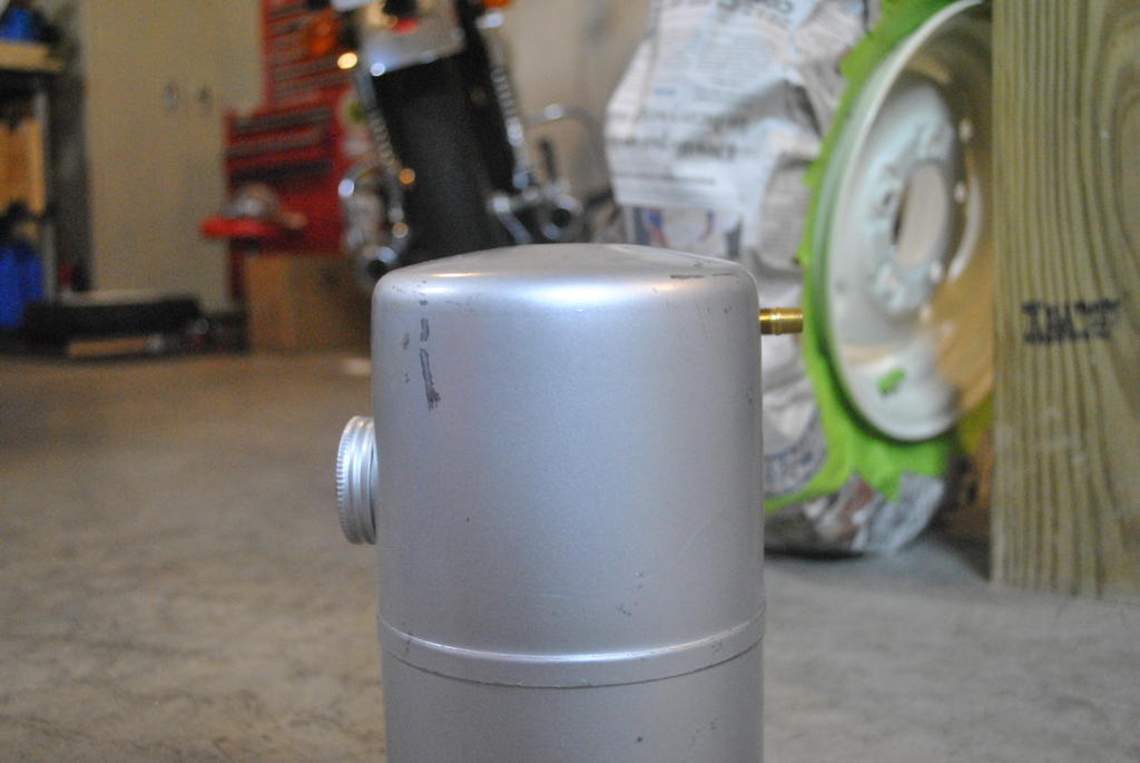

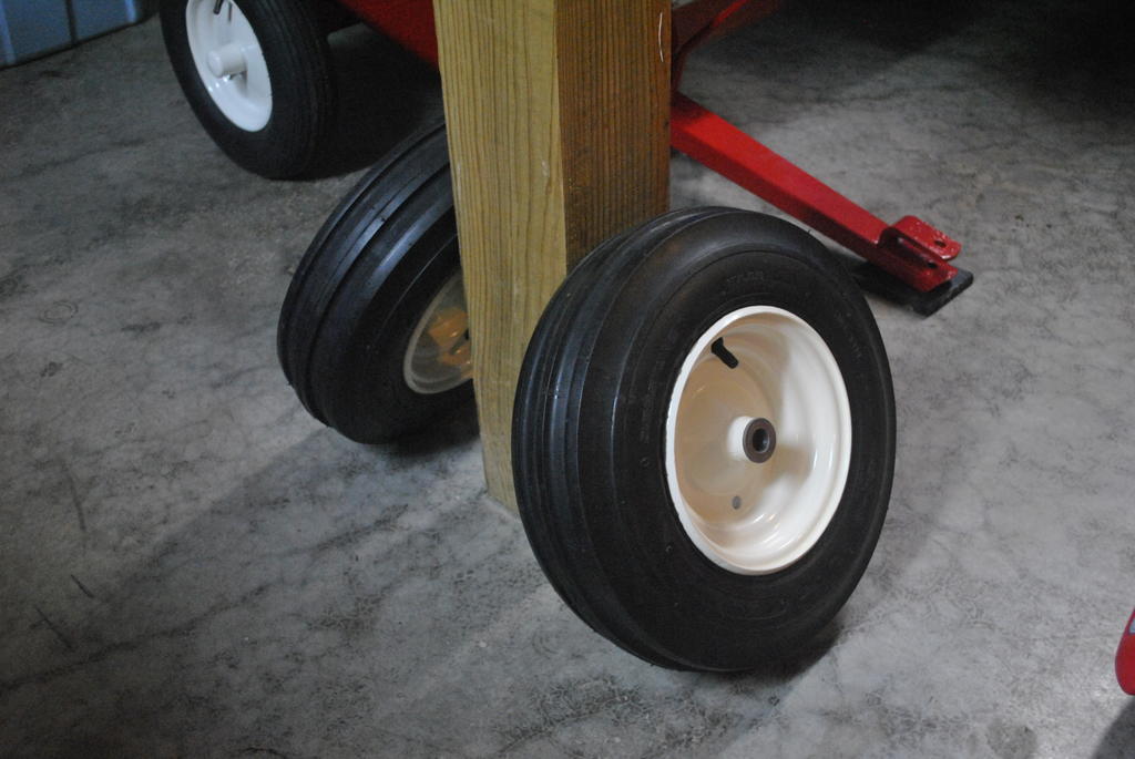

Horse Play 393 #34 Posted June 9, 2019 Front wheels/tire are ready to go on. One rear wheel ready for a second coat of paint. 1 Share this post Link to post Share on other sites

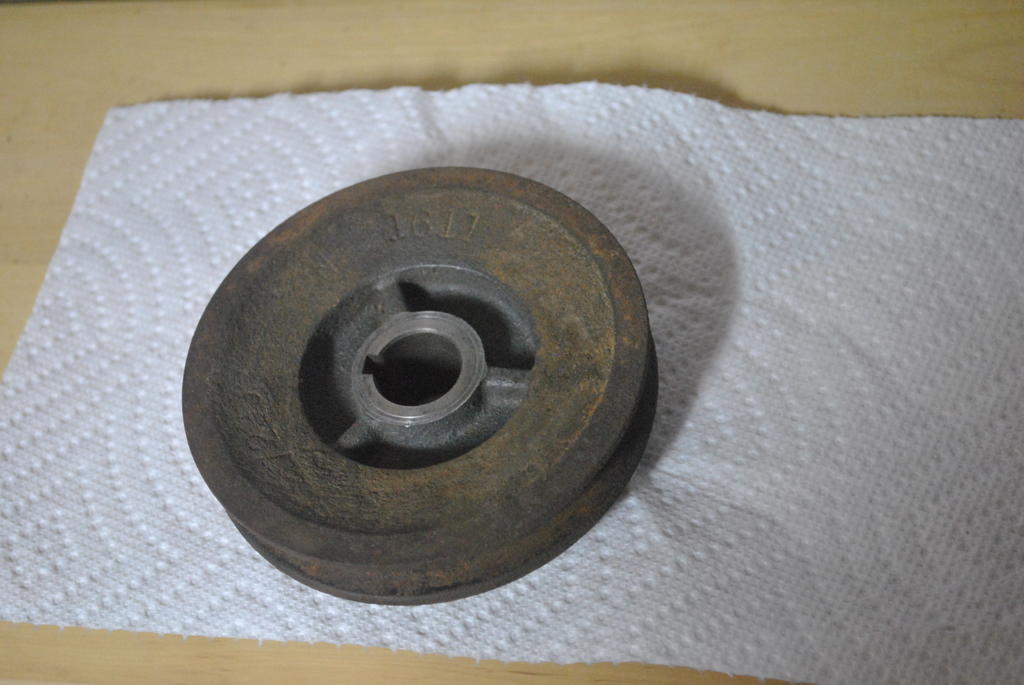

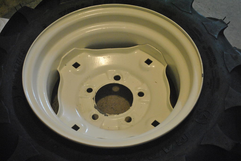

Horse Play 393 #35 Posted June 9, 2019 Here is the one I straightened out last night. I may mount it to the hub on my 857 to see if it needs more persuasion. My 1611 pulley; probably will wire brush it and spray on some self etching primer today. Share this post Link to post Share on other sites
Horse Play 393 #36 Posted June 9, 2019 Here is the gas tank I have now; it came with the tractor from the previous owner. 1 Share this post Link to post Share on other sites

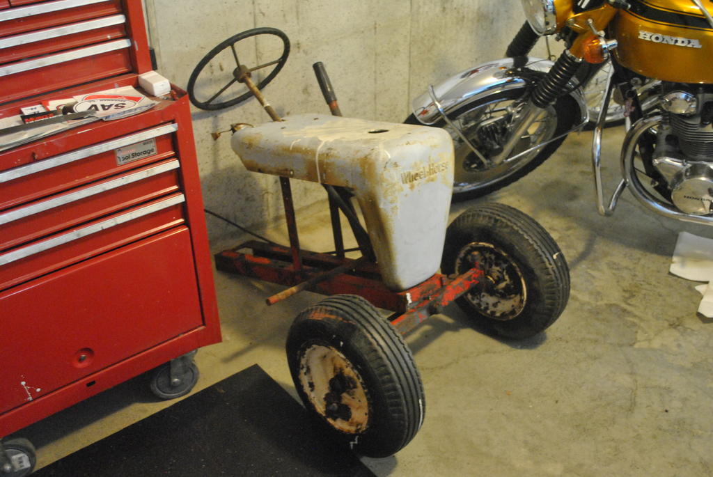

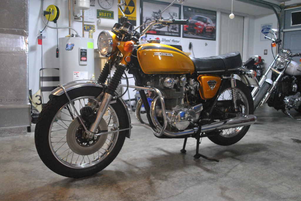

8ntruck 9,368 #37 Posted June 10, 2019 Sorry, but this is off topic. Is the Honda in the background a CB 350 four or a CB 750 four? Share this post Link to post Share on other sites
Horse Play 393 #38 Posted June 11, 2019 (edited) 2 hours ago, 8ntruck said: Sorry, but this is off topic. Is the Honda in the background a CB 350 four or a CB 750 four? It's a '71 CB450 - my grandfather bought it new and it has always been in the family. An early CB750 is my dream bike, lately I've been thinking about selling my Sportster for one. Edited June 11, 2019 by Horse Play 4 1 Share this post Link to post Share on other sites
8ntruck 9,368 #39 Posted June 11, 2019 Looks like I miss-counted the exhaust pipes. Back in college, I had a CB 350. I don't remember the year, but it was the last year for the front drum brake. It came to grief on the right front fender of a Caddy. Fortunately, I flew clear of the car across the hood and just ended up with a stiff hip, bumps and bruises. Nice paint work on your project tractor, by the way. 2 Share this post Link to post Share on other sites
Horse Play 393 #40 Posted June 11, 2019 27 minutes ago, 8ntruck said: Looks like I miss-counted the exhaust pipes. Back in college, I had a CB 350. I don't remember the year, but it was the last year for the front drum brake. It came to grief on the right front fender of a Caddy. Fortunately, I flew clear of the car across the hood and just ended up with a stiff hip, bumps and bruises. Nice paint work on your project tractor, by the way. Yikes! Glad to hear your injuries were not worse than that. Share this post Link to post Share on other sites

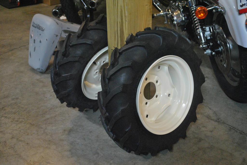

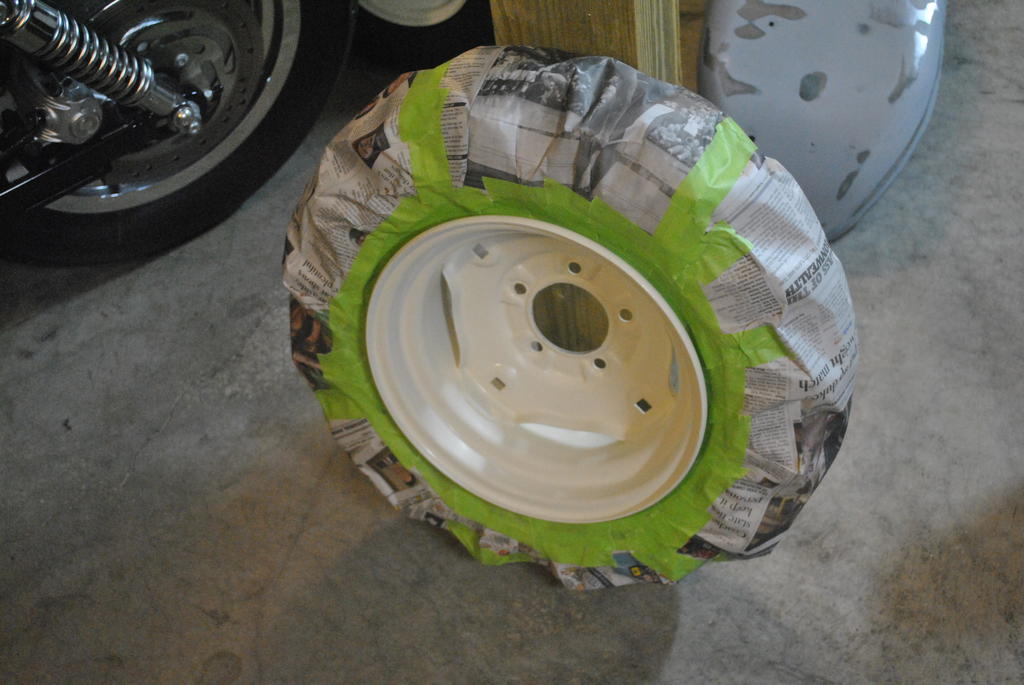

Horse Play 393 #41 Posted June 18, 2019 Rear wheels are finished. I primed and painted them six months before mounting - I knew they would lose some paint mounting. I feathered out the chips from mounting and then scuffed the wheels with a grey scuff pad. Then I masked off the tires and sprayed an addition three coat of white. These wheels came out really well, especially for a spray bomb. 3 3 Share this post Link to post Share on other sites

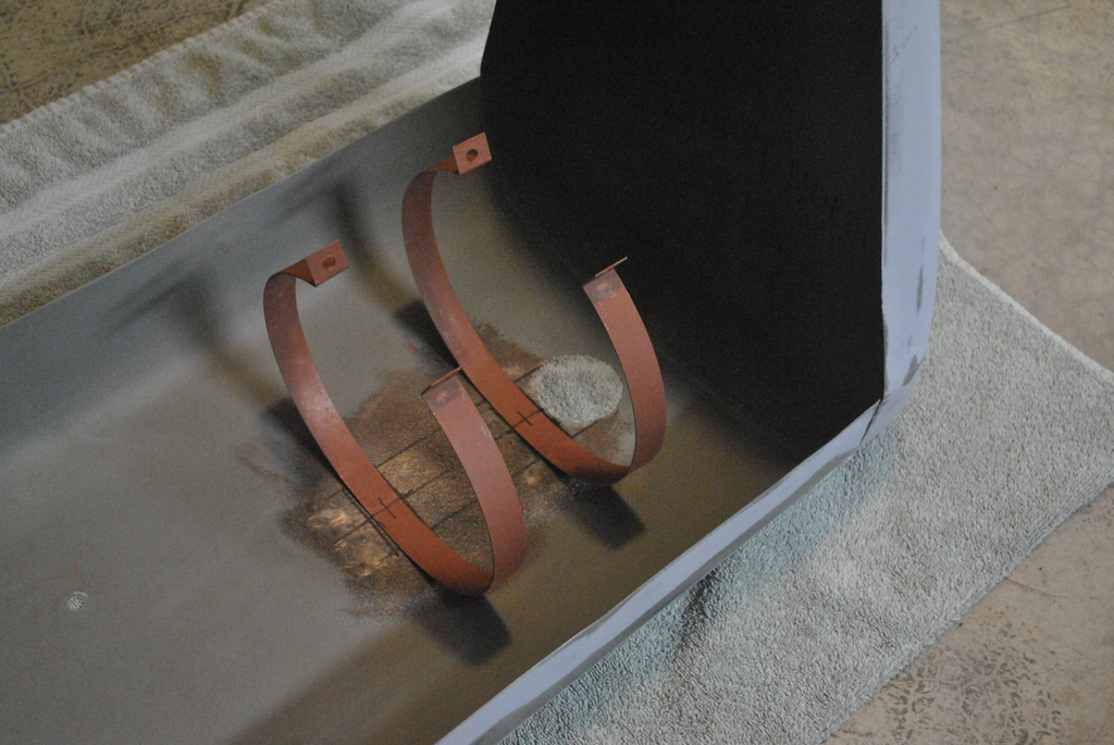

Horse Play 393 #45 Posted July 8, 2019 Tomorrow I will be doing the tank straps with some 3M Panel Adhesive. 2 Share this post Link to post Share on other sites

oliver2-44 11,791 #47 Posted July 9, 2019 14 hours ago, Horse Play said: Tomorrow I will be doing the tank straps with some 3M Panel Adhesive. Let us know how the panel adhesive works out. That could be a repair that's attractive to many of us that don't have a wire welder to weld sheet metal! 2 Share this post Link to post Share on other sites
WHX?? 58,324 #48 Posted July 9, 2019 try separating them after it sets to see if they will hold. Share this post Link to post Share on other sites
RandyLittrell 3,946 #49 Posted July 9, 2019 Coming from the body shop, not sure that will work as such. Could you cut some sheet metal that would go over the straps and cover more area? Randy 1 Share this post Link to post Share on other sites
Lane Ranger 12,159 #50 Posted July 9, 2019 Randy I had that done on my last redo . My welder spot welder a plate and strengthened hood inside then spot welded newbtank straps, the RJ’s were notorious for cracking around the gas tank neck hole on top of the hood. Another good idea is to put a longer neck on gas tank to be assured of being able to remove the gas cap easily. Filler Neck Supply sells new necks and caps for less than ten dollars. 1 Share this post Link to post Share on other sites
