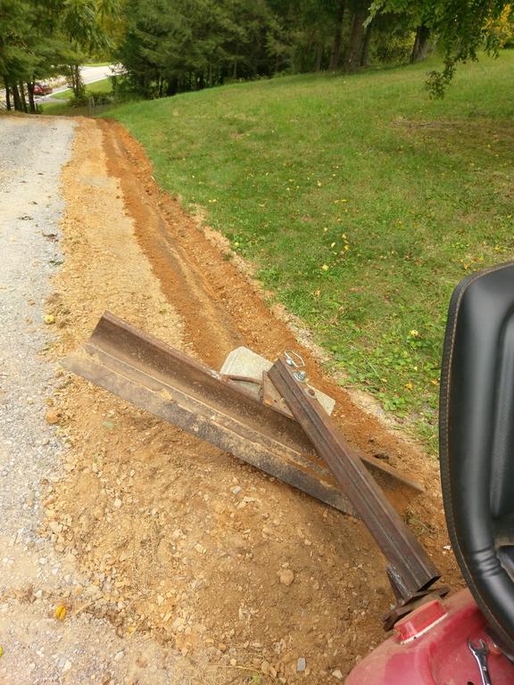

WVHillbilly520H 10,379 #6 Posted November 7, 2018 I don't run WOT for anything except running PTO engaged attachments(deck tiller snow thrower) when I'm doing blade woek (front or rear) usually 1/2-3/4 throttle, no issues as of yet, bought it new in 1998, I believe you are over thinking it, Jeff. Share this post Link to post Share on other sites
