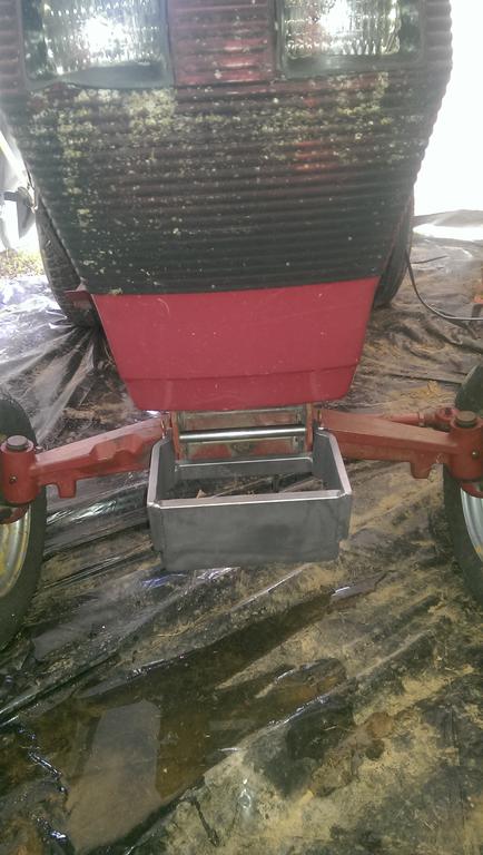

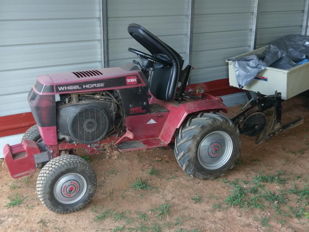

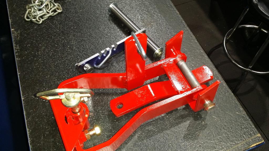

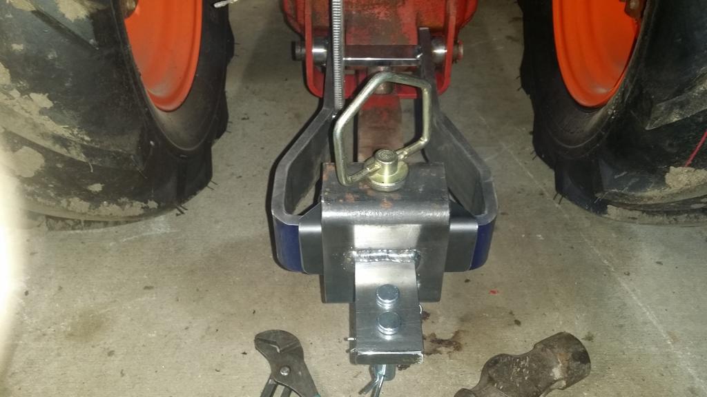

bellevillerod 835 #1 Posted November 5, 2018 Made this the other day for my C160. Man I had sticker shock when I looked at buying a new one. 6 17 1 Share this post Link to post Share on other sites
WVHillbilly520H 10,376 #2 Posted November 5, 2018 @bellevillerod, excellent work there, and to , also like the clevis pin hitch you added as well, Jeff. 1 1 Share this post Link to post Share on other sites
bellevillerod 835 #3 Posted November 5, 2018 Thank you sir, I try to make as much as possible to avoid having to spend any money... Lol 3 3 Share this post Link to post Share on other sites
Daron1965 644 #4 Posted November 5, 2018 Hitch looks great. Great work. They are very pricey. to the site. 2 Share this post Link to post Share on other sites

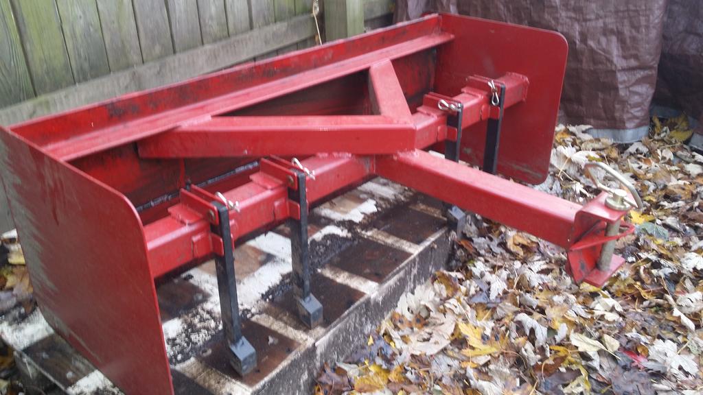

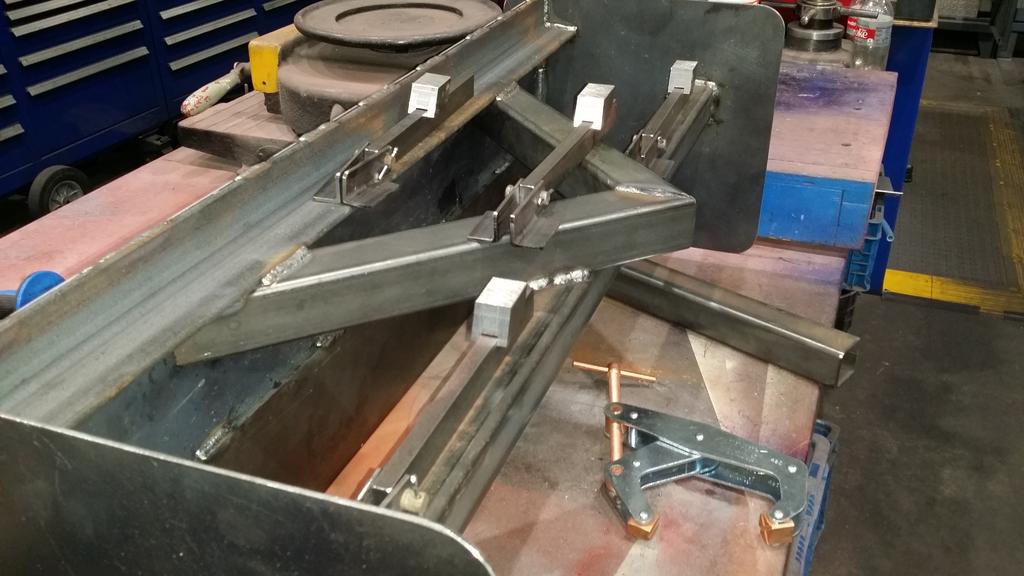

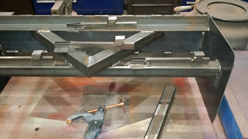

bellevillerod 835 #5 Posted November 5, 2018 I'm making a box blade for the back to go with the hitch now. 2 9 Share this post Link to post Share on other sites

Pullstart 68,316 #9 Posted November 5, 2018 I didn’t see, is your tractor equipped with hydraulic or electric lift by chance? That is some sweet fab work, you gonna be ready for the snow forecasted this week? 1 Share this post Link to post Share on other sites

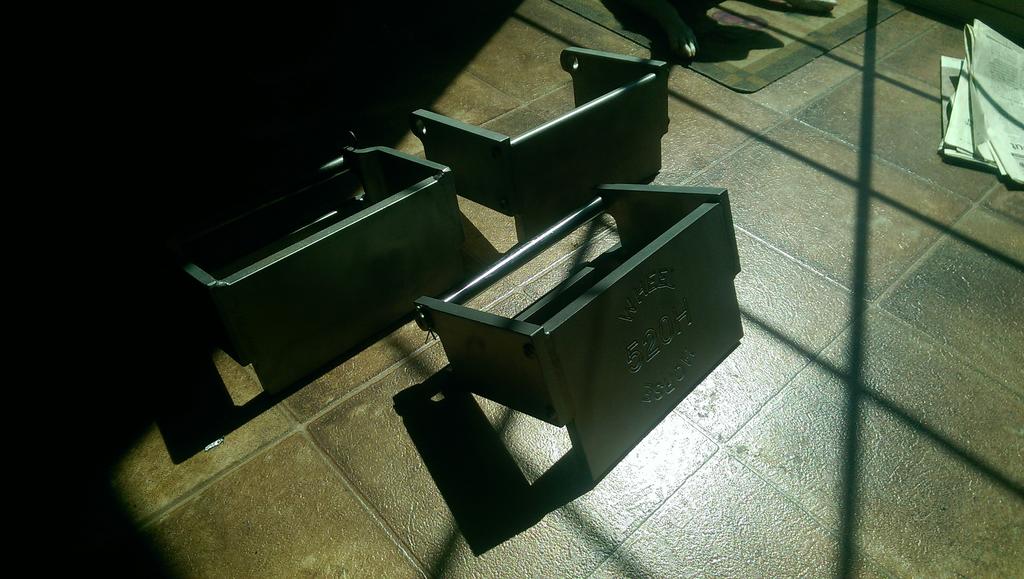

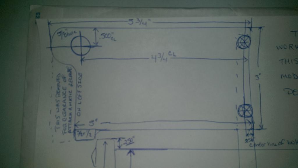

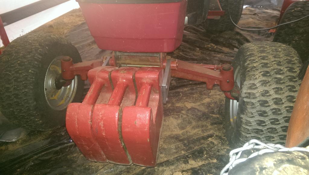

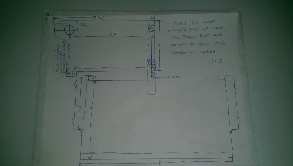

WVHillbilly520H 10,376 #10 Posted November 5, 2018 Your gonna need some counter weight up front with that box blade hanging off the back here's what I have been making...and a blue print to make your own, good luck with your , Jeff. 5 Share this post Link to post Share on other sites
BOB ELLISON 2,981 #11 Posted November 5, 2018 Welcome to another Michigander that make's great stuff. And the nice thing is we're almost neighbor. I can see by your work you need me as a friend. Hahaha And a man who knows great tractors. I also have a C160 that's my favorite. 2 1 Share this post Link to post Share on other sites
ebinmaine 74,680 #12 Posted November 5, 2018 Looks like some really high-quality work there 1 Share this post Link to post Share on other sites
bellevillerod 835 #13 Posted November 5, 2018 4 hours ago, pullstart said: I didn’t see, is your tractor equipped with hydraulic or electric lift by chance? That is some sweet fab work, you gonna be ready for the snow forecasted this week? Thanks, I hope so and yes the C160 is a hydro. 1 Share this post Link to post Share on other sites
bellevillerod 835 #14 Posted November 5, 2018 3 hours ago, WVHillbilly520H said: Your gonna need some counter weight up front with that box blade hanging off the back here's what I have been making...and a blue print to make your own, good luck with your , Jeff. Thanks for the prints I will get right on it. I have 4 of the weights and was wondering how to hook them up.! 1 1 Share this post Link to post Share on other sites

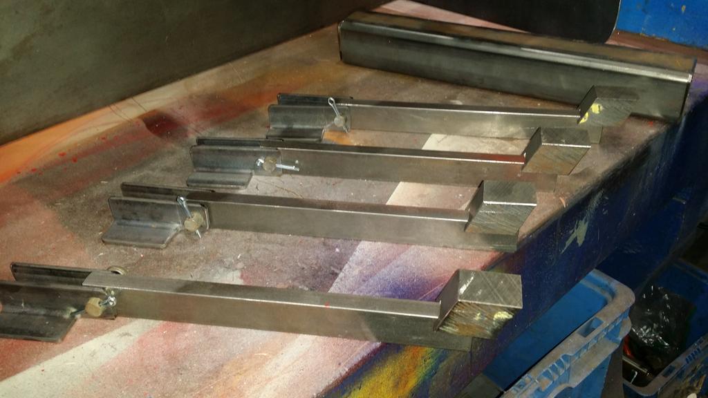

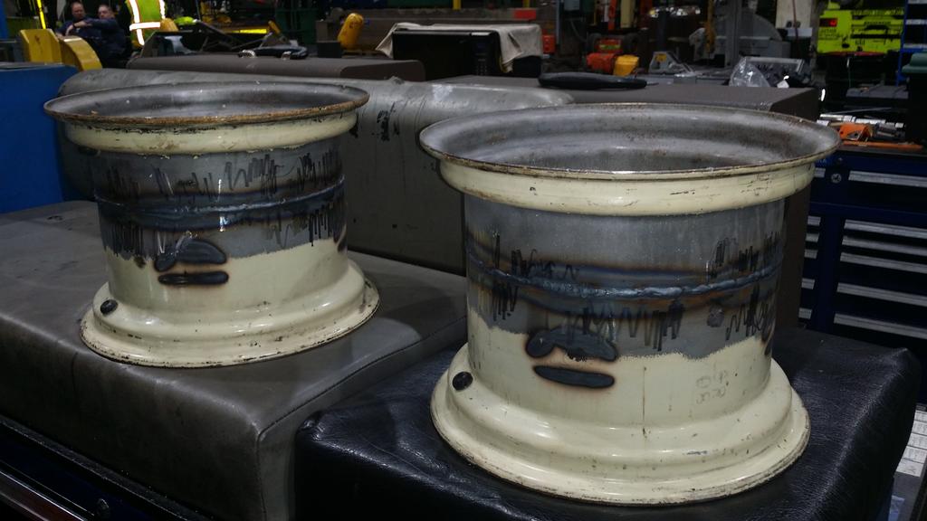

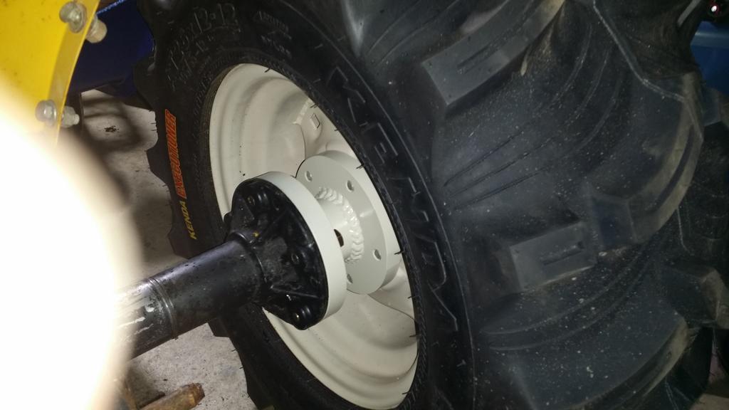

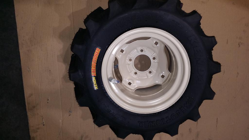

bellevillerod 835 #15 Posted November 5, 2018 I'm constantly making stuff for the tractors. Split some rims and made some spacers for 26x12 tires... Lol 4 1 Share this post Link to post Share on other sites
bellevillerod 835 #16 Posted November 5, 2018 9 hours ago, bellevillerod said: I'm making a box blade for the back to go with the hitch now. Don't mind the dirt this thing gets used lol 1 3 Share this post Link to post Share on other sites
