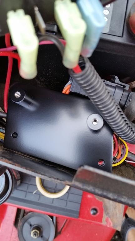

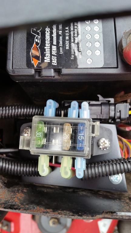

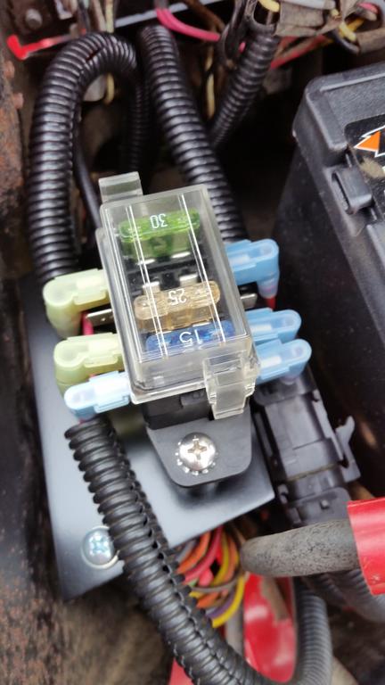

tlb41 38 #1 Posted November 4, 2018 Hi all I just thought that I would share my custom bracket to mount an aftermarket fuse block on my 1990 520. Since I do not like drilling extra holes in my machines I used the two factory holes and went from there. I also eliminated the 9 pin connector and ran the charge wire from the fuse block straight to the starter so that aloud me to use two 4 pin weather pack automotive style connectors. They should used this style of connector at the factory because it sure would of saved some of us the electrical headaches associated with are awesome 520's. 2 6 Share this post Link to post Share on other sites

peter lena 10,076 #3 Posted November 4, 2018 looks like a good upgrade to me, the purists will be horrified , but, YOU are the one dealing with the issue, making it better and stopping a nagging problem , is what its all about. did you dielectric grease / spray all contact areas? found that to help electrical issues. like the cable wrap and neat detailing , good job, pete 1 Share this post Link to post Share on other sites
