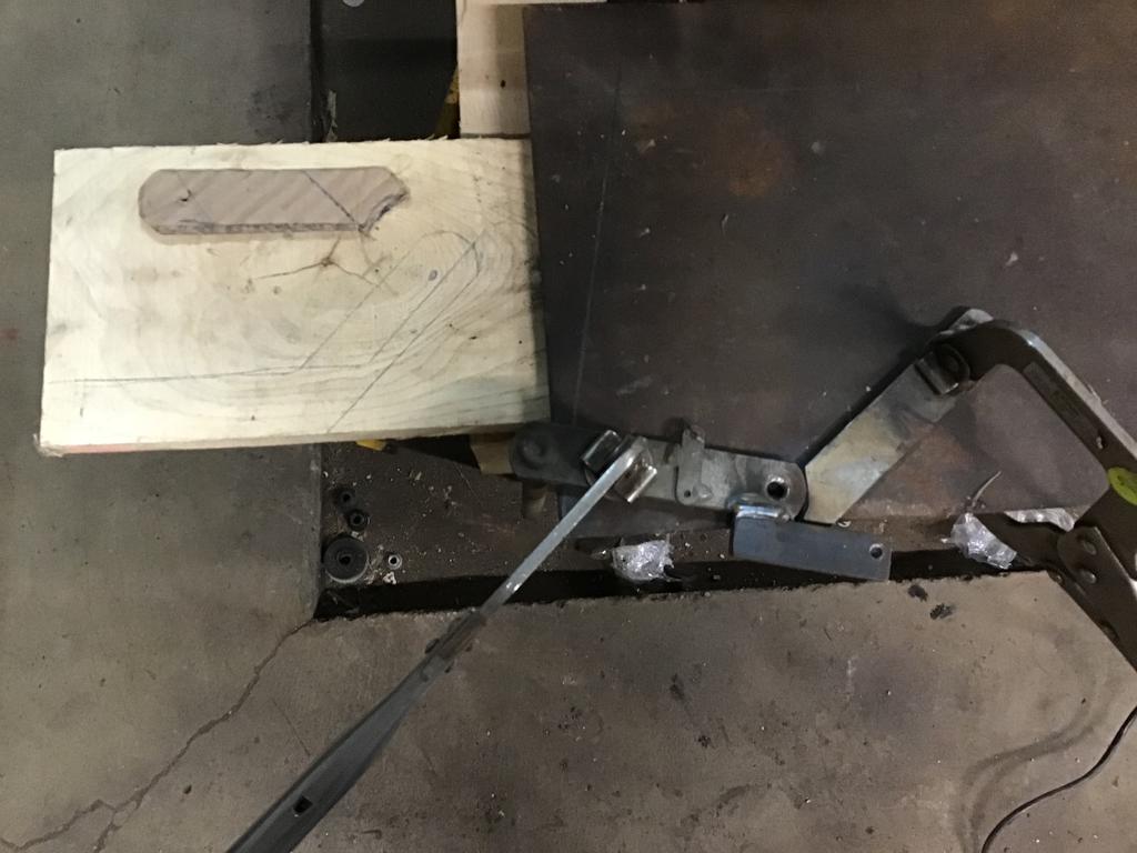

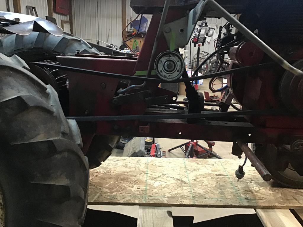

Pullstart 68,941 #1 Posted November 1, 2018 Anyone with a sunstrand transmission, could you possibly snap a pic of the parking brake lever while engaged and released and post them up please? I want to lock my current project in “drive” in regards to the brake lever. thanks! Share this post Link to post Share on other sites

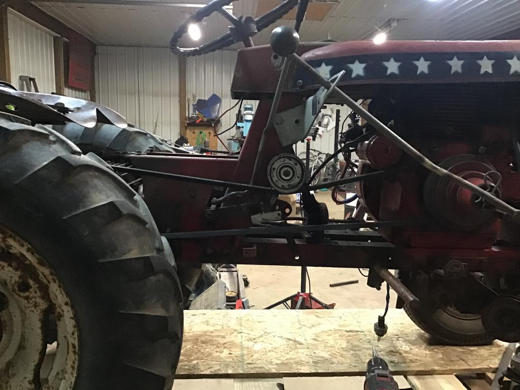

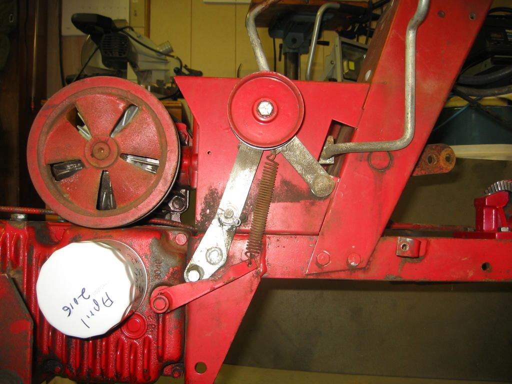

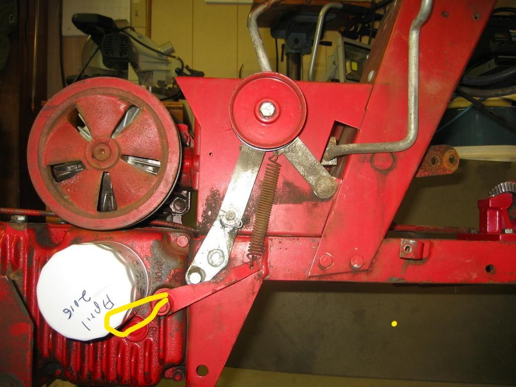

pfrederi 19,941 #2 Posted November 1, 2018 (edited) You are missing some parts and the belt is routed incorrectly let me find some pictures. What model is this on Edited November 1, 2018 by pfrederi 1 Share this post Link to post Share on other sites
Pullstart 68,941 #3 Posted November 1, 2018 8 minutes ago, pfrederi said: You are missing some parts and the belt is routed incorrectly let me find some pictures. What model is this on It’s a custom jobby... I intentionally changed it, to essentially delete the parking brake. Now I’d like to “lock” the brake lever in place, to eliminate it’s functionality. I just don’t know what position is “run” and what is “stop”. Share this post Link to post Share on other sites
pfrederi 19,941 #4 Posted November 1, 2018 Up is engaged 1 Share this post Link to post Share on other sites
pfrederi 19,941 #5 Posted November 1, 2018 (edited) That idler pulley is not going to last long on the tension side of the belt idlers are always on the return Edited November 1, 2018 by pfrederi 1 Share this post Link to post Share on other sites
Pullstart 68,941 #6 Posted November 1, 2018 5 minutes ago, pfrederi said: That idler pulley is not going to last long on the tension side of the belt idlers are always on the return I didn’t think of that, thank you for your input! Share this post Link to post Share on other sites

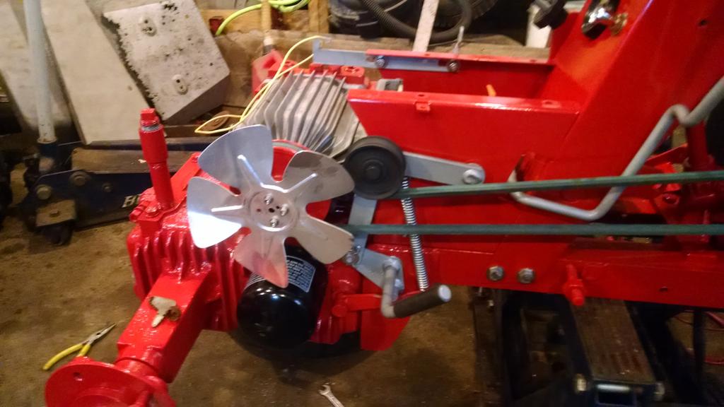

Achto 31,114 #8 Posted November 1, 2018 (edited) 4 hours ago, pullstart said: Anyone with a sunstrand transmission, could you possibly snap a pic of the parking brake lever while engaged and released and post them up please? @pfrederi's picture shows the late model set up - 1967 & up. Here is a picture of the early set up - '65 & '66. The pic shows it in the engaged (drive) position. When you push the black lever down it releases tension on the drive belt and allows the parking brake lever on the transmission to come up. Edited November 1, 2018 by Achto 1 Share this post Link to post Share on other sites
pfrederi 19,941 #9 Posted November 1, 2018 I am not sure if I understand you correctly. Bottom line if you pull the he parking pawl lever up it engages the brake pushing it down releases it. It pivots when the lever is up the pawl is down into the gears. See my poor yellow lines it drops into the gear running in the closed end bearing.. Makes no difference as to what year. The brake is engaged in this picture 2 Share this post Link to post Share on other sites
Achto 31,114 #10 Posted November 1, 2018 17 minutes ago, pfrederi said: I am not sure if I understand you correctly. Please reread my post. I had to amend it after I ran out to the garage & took a second look. Didn't think it sounded right after I wrote it. Sorry bout that. 2 Share this post Link to post Share on other sites
pfrederi 19,941 #11 Posted November 2, 2018 Got it!! Share this post Link to post Share on other sites

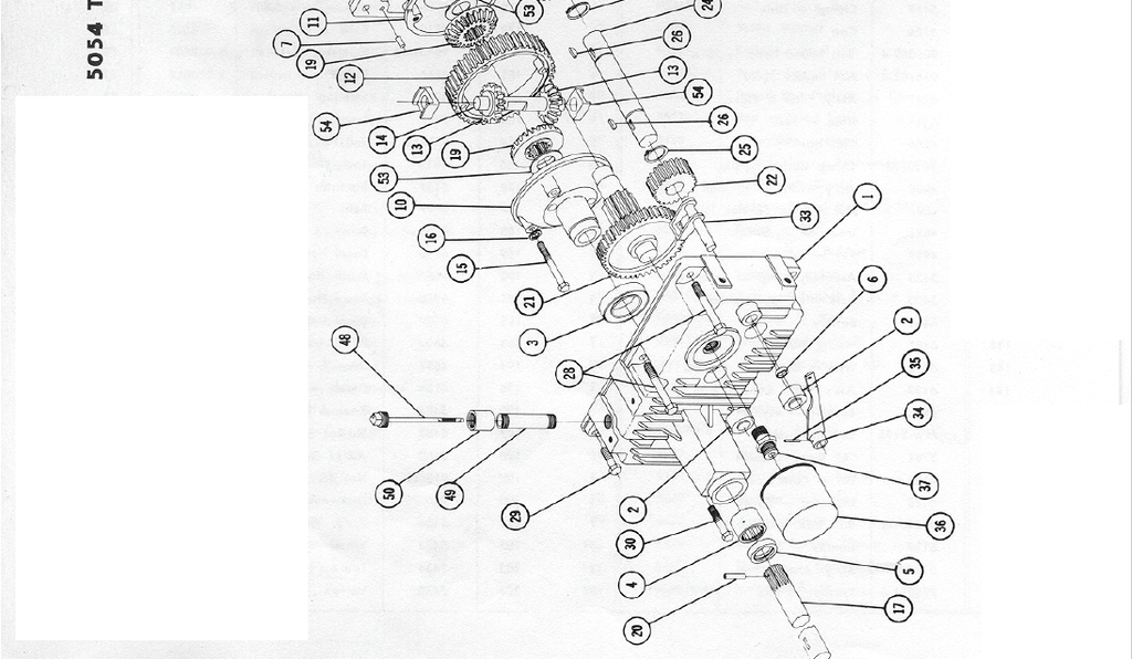

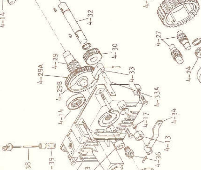

Achto 31,114 #14 Posted November 7, 2018 (edited) 9 hours ago, pullstart said: I can feel it jump/skip while pushing forward, it grabs pull it backwards. It’s toast The parking brakes on these were never very strong. They were easily damaged if the brake was pulled while the tractor was still in motion. The parking brake is #33 in the diagram below, when engaged the brake would drop into the teeth on the mushroom gear #21 to lock the transmission. Sounds like the edges of your brake may be rounded off a little, causing it to skip when pushing the tractor forward. The parking brake on my 1076 is shot also, it won't grab in either direction. I just pay attention to where I park so it don't roll away on me. Edited November 7, 2018 by Achto 1 Share this post Link to post Share on other sites
Pullstart 68,941 #15 Posted November 7, 2018 41 minutes ago, Achto said: The parking brakes on these were never very strong. They were easily damaged if the brake was pulled while the tractor was still in motion. The parking brake is #33 in the diagram below, when engaged the brake would drop into the teeth on the mushroom gear #21 to lock the transmission. Sounds like the edges of your brake may be rounded off a little, causing it to skip when pushing the tractor forward. The parking brake on my 1076 is shot also, it won't grab in either direction. I just pay attention to where I park so it don't roll away on me. This helps a bunch, I can totally understand how stamped steel can be torn up by a gear! It needs a small gear section grafted into the arm to be effective, I’d suppose. Or just park on flat surfaces and call it a day 2 Share this post Link to post Share on other sites
pfrederi 19,941 #16 Posted November 7, 2018 (edited) 2 hours ago, pullstart said: This helps a bunch, I can totally understand how stamped steel can be torn up by a gear! It needs a small gear section grafted into the arm to be effective, I’d suppose. Or just park on flat surfaces and call it a day Some models D series for instance the parking brake was a pawl. Sort of like a bent finger with teeth #4-33 Edited November 7, 2018 by pfrederi 1 2 Share this post Link to post Share on other sites

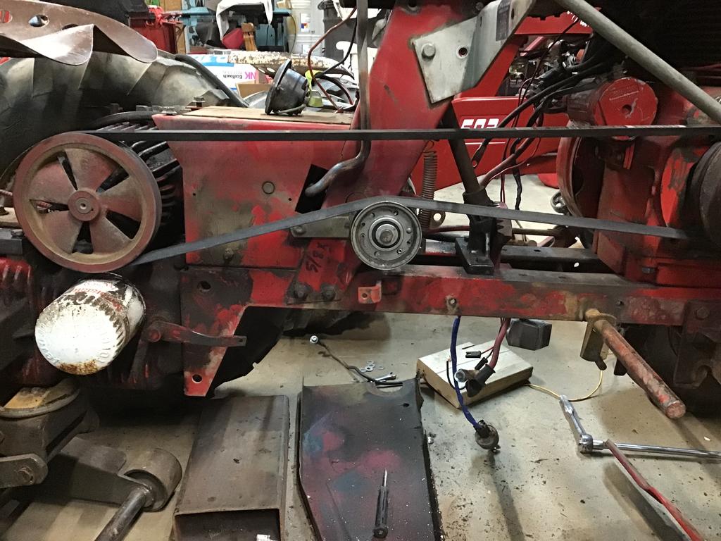

Pullstart 68,941 #17 Posted November 9, 2018 On 11/1/2018 at 4:16 PM, pfrederi said: That idler pulley is not going to last long on the tension side of the belt idlers are always on the return On 11/1/2018 at 4:22 PM, pullstart said: I didn’t think of that, thank you for your input! I have rerouted the belt and tensioner, for anyone looking at this in the future. Sometimes I forget to follow up to bring a question or issue to closure. 2 Share this post Link to post Share on other sites

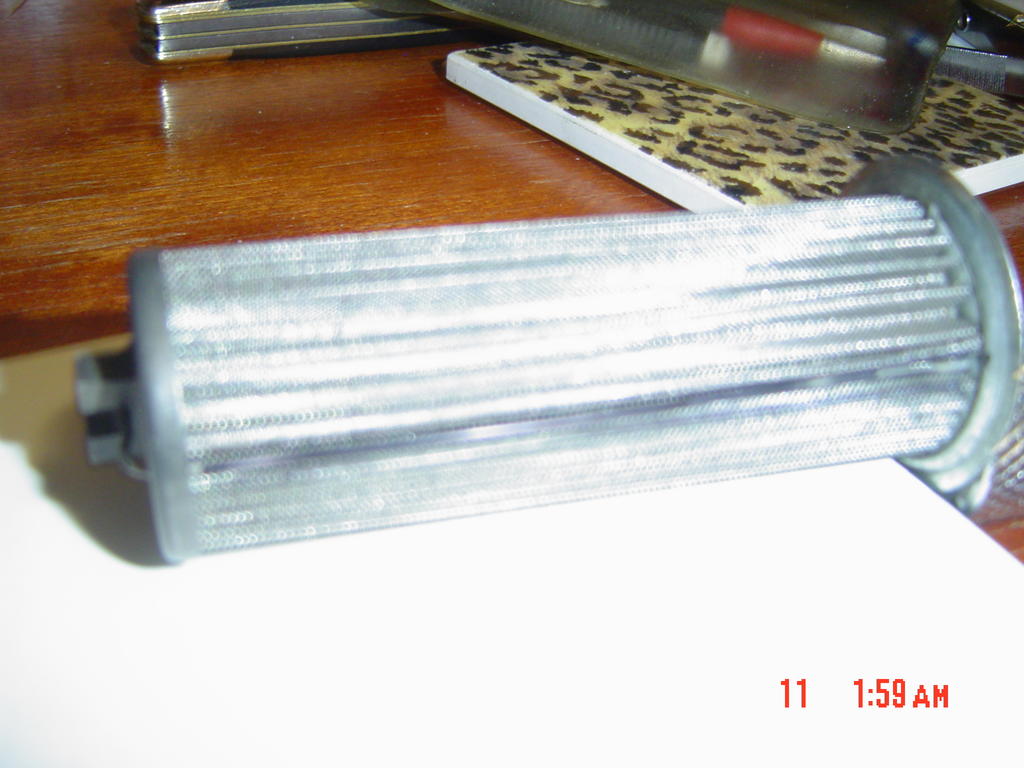

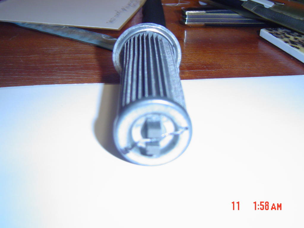

R. L. Addison 300 #18 Posted November 9, 2018 Three of the last four I have been into have had the epoxy that holds the strainers together let loose & the strainers have been in pieces in the bottom of the case. No others have mentioned it, so maybe I'm the only one, but why just these? I'm now putting safety wire through them to keep them together. 1 1 Share this post Link to post Share on other sites
Jakeshorsetuff 36 #19 Posted November 23, 2018 On 11/9/2018 at 1:24 PM, R. L. Addison said: Three of the last four I have been into have had the epoxy that holds the strainers together let loose & the strainers have been in pieces in the bottom of the case. No others have mentioned it, so maybe I'm the only one, but why just these? I'm now putting safety wire through them to keep them together. I had a charger 12 transmission strainer get ground up in the gears a while back but could never find one to replace it. Now I am doing a full rebuild on the tranny and found a strainer but don't know to epoxy the strainer in or not? LMK what your thoughts are. Share this post Link to post Share on other sites
R. L. Addison 300 #20 Posted November 24, 2018 I epoxied mine back together then ran wire (stainless). 1 Share this post Link to post Share on other sites
R. L. Addison 300 #21 Posted November 24, 2018 Sorry to have to make two entries, can't remember how to do multiples. I just folded wire into open end. I used care in drilling! Hope you can tell wire is between pleats in picture. 1 Share this post Link to post Share on other sites
Jakeshorsetuff 36 #22 Posted November 24, 2018 Just to clarify you don't epoxy the strainer in the hole to the tranny, but epoxy a magnet to the other side 3 hours ago, R. L. Addison said: Sorry to have to make two entries, can't remember how to do multiples. I just folded wire into open end. I used care in drilling! Hope you can tell wire is between pleats in picture. Share this post Link to post Share on other sites
R. L. Addison 300 #23 Posted November 25, 2018 That is an older screen than the ones that came apart in my transmissions, the magnets are epoxied on the closed end of the screen as in my pictures, outside. The wire will hold them in place as shown. Maybe updated for fear the magnets could come out or they caused a reduction in oil flow to pump. Closed loop system should not make that much difference though. Share this post Link to post Share on other sites
