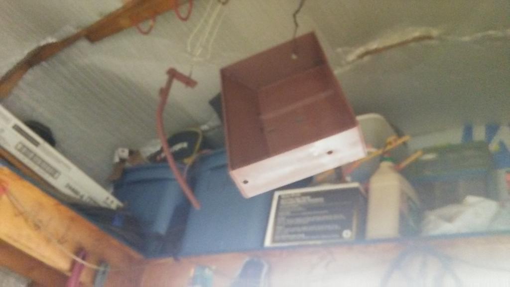

Elkskin's mower junkyard 1,117 #1 Posted November 1, 2018 Last week or so I got a 312-8 Toro which I parted and I also got this trailer. I took it over to shop they straightened the axle sort of. The tub is tweeked but I don't care. Ill fix it up for use. I do have a 64 dump trailer but its all nice. This trailer here needs a lot of love but better than it going to scrap. Got to make the dump lever 9 Share this post Link to post Share on other sites

Elkskin's mower junkyard 1,117 #5 Posted November 2, 2018 H eres handle for dump bed. Note this trailer isn't going to be a show trailer but a worker. I still have lots of patching to do. One top of a side is bent pretty bad I am going to cut it out and put new metal in. 3 Share this post Link to post Share on other sites
Elkskin's mower junkyard 1,117 #6 Posted November 2, 2018 Success in top pic you can see side is bent. I cut it out and put it in a vice was able to straighten the price and welded it back in. I got a Chicago electric 125 amp wire welder does a decent job. In process of grinding down welds. I do little sections at a time to avoid warping in sheet metal when welding. And yes side isn't perfect lol 2 Share this post Link to post Share on other sites

Elkskin's mower junkyard 1,117 #10 Posted November 4, 2018 Been a couple days since I updated. I got it patched up pretty good. Today I put it back in my red shed (heated shed) and sanded it down on the inside. Sprayed a rusty metal primer on. Then after that dried I played down 2 coats of bed liner. Like I said its not a show piece. In a few days I will flip it over remove dump lever and wheels then prime the bottom and regal red will be laid down on outside. 1 Share this post Link to post Share on other sites
Elkskin's mower junkyard 1,117 #11 Posted November 8, 2018 (edited) Even though I am hurting due to a injury. I made it out to shed to work on the trailer. I got the primer down. And I also did another toolbox for 701. In morning I will lay the red down. I may go over bed liner with red too. I can't get axle out due to the bend but I am not worried Edited November 8, 2018 by craftsmanmowerfreak Share this post Link to post Share on other sites

Elkskin's mower junkyard 1,117 #13 Posted November 8, 2018 Red paint down. Share this post Link to post Share on other sites
Elkskin's mower junkyard 1,117 #14 Posted November 9, 2018 Got tires on and flipped it right side up and painted the inside regal red over the bed liner. Extra protection this way since it is so pitted. In this picture you can see the tub is tweeked Share this post Link to post Share on other sites
