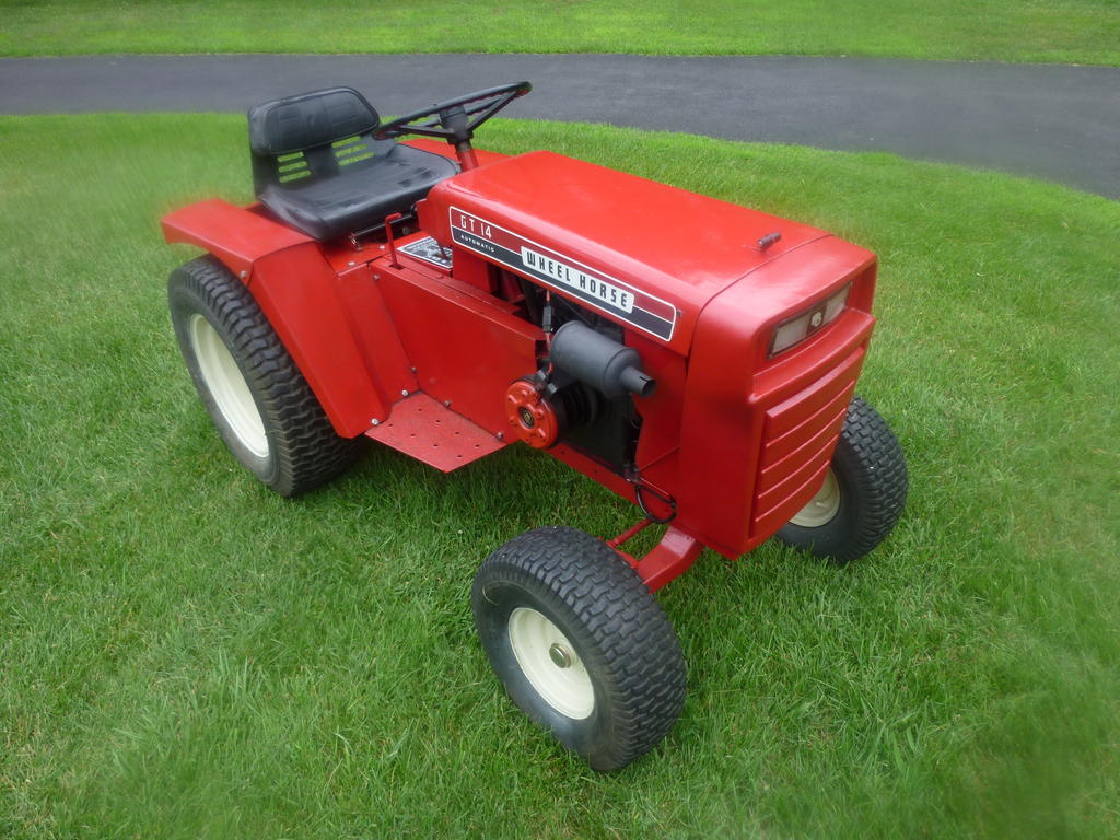

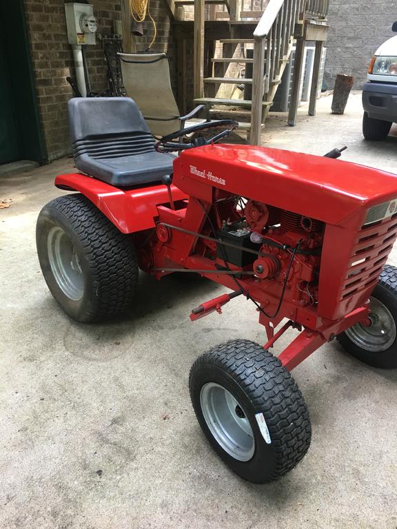

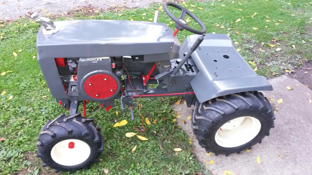

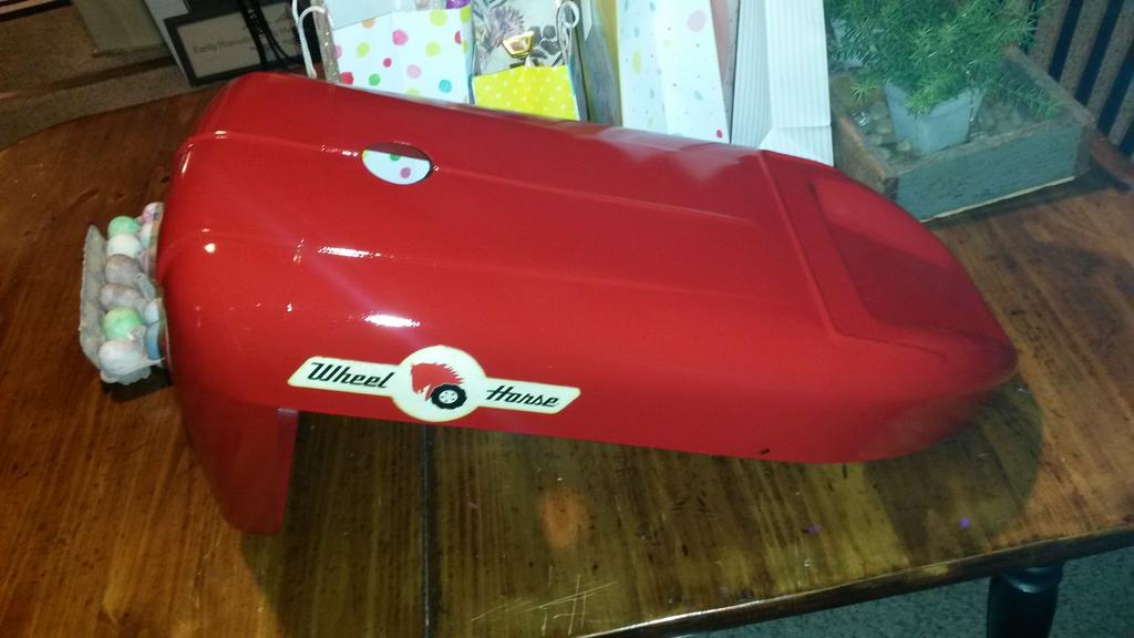

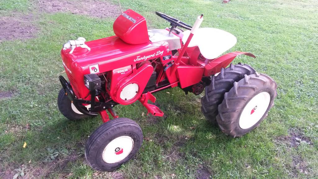

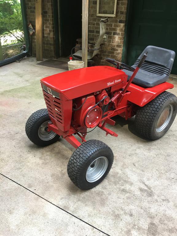

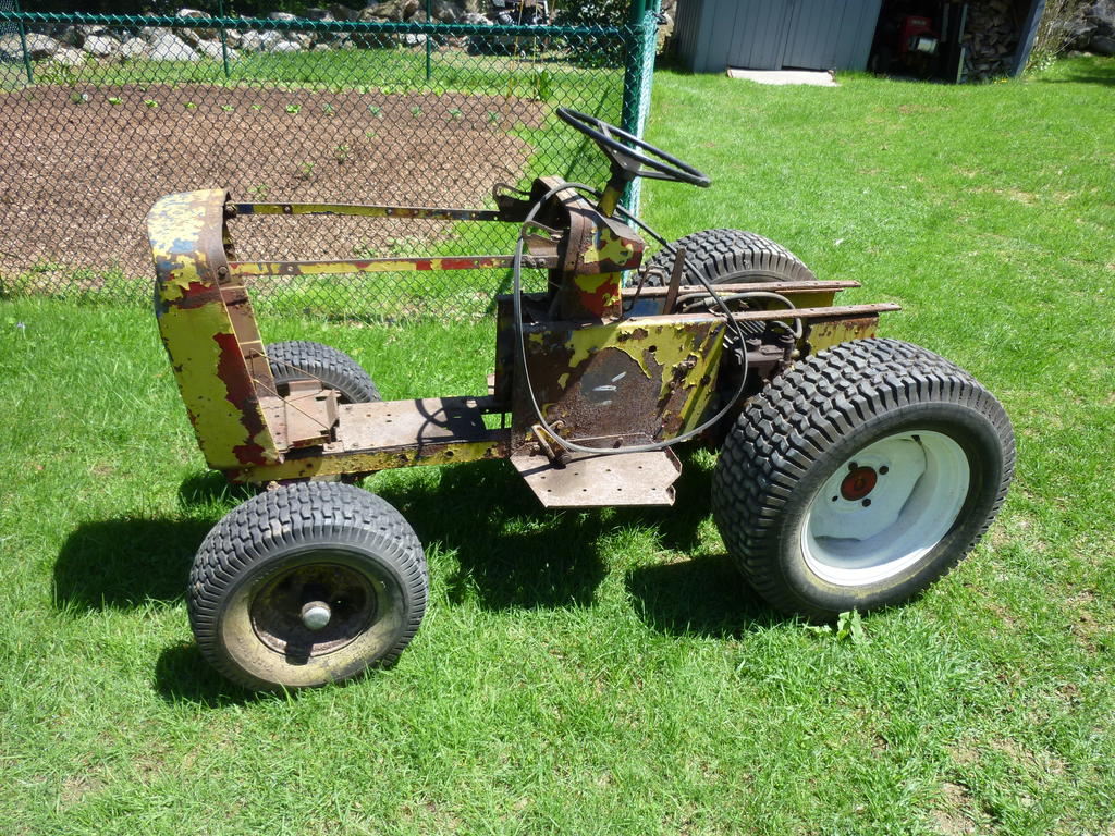

Chris G 3,392 #29 Posted November 1, 2018 I rattle canned every horse I've done and no problems. Prepping and a good dry time and you will end up with a good paint job. Here's some photos to show some of them. 1 Share this post Link to post Share on other sites

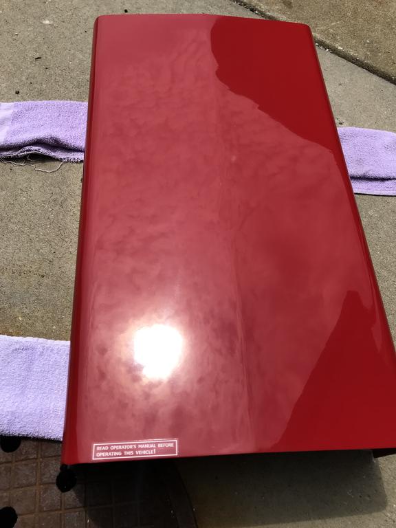

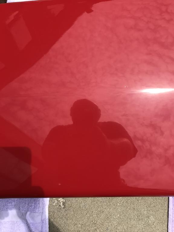

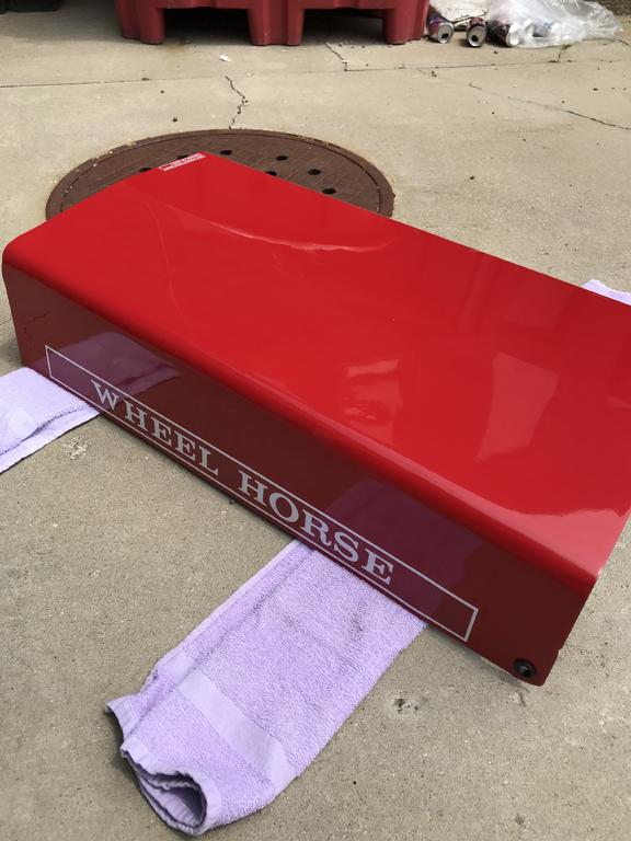

Firebug 267 #31 Posted December 1, 2018 I have done a few rattle can jobs. I used the majic brand ih red. 3 light coats, wet sanded with 1500 grit between each coat. Then a coat of rusteum clear wet sanded with 1500, then a coat of clear wet sanded with 2000 grit. Buffed to a shine. It was pretty time consuming but the results were better than I expected 2 Share this post Link to post Share on other sites
