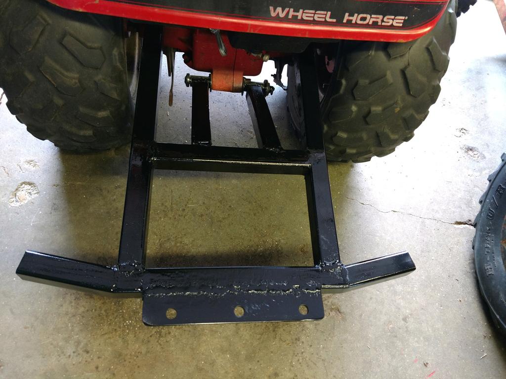

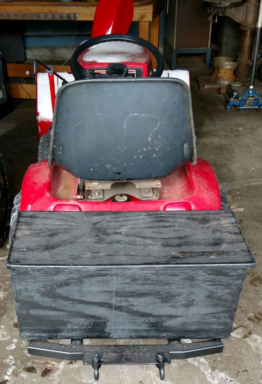

WHMan2012 170 #51 Posted January 23, 2019 Oh Ya, I Made My Weight Box First Priority, Along With A Pair Of 50# Wheel Weights. In My Box I Have 140#'s Of Steel Weights, And Filled The Rest Of The Area In With Roughly Two 40# Bags Of Traction Sand. As Of Now It Seems To Work Out Ok, I Notice That When I'm Snow Blowing I Can Still Steer Ok, But Definitely Need A Different Set Of Front Tires That'll Dig In Better Than These Lawn Tires. 1 Share this post Link to post Share on other sites

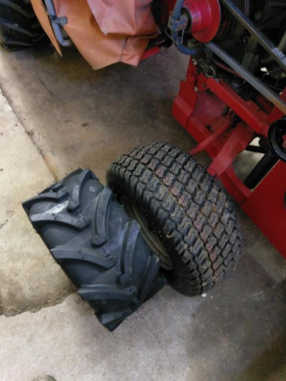

wallfish 18,818 #57 Posted February 13, 2019 On 1/23/2019 at 12:08 AM, WHMan2012 said: I Notice That When I'm Snow Blowing I Can Still Steer Ok, But Definitely Need A Different Set Of Front Tires That'll Dig In Better Than These Lawn Tires. Glad to see you got her going. As far as steering, #40 roller chain wrapped around the fronts. Deflate the tires and put the chain on, inflate to get them tight. They must be installed fairly tight with the tire deflated and kept very tight when inflated or they will work their way off from the side load as you steer. The other option is tri-rib tires but I've used both setups and the roller chain work much better. 1 Share this post Link to post Share on other sites
WHMan2012 170 #58 Posted February 14, 2019 Thank you for your advice, but with our newly paved driveway the #40 chain is out of the question, but I will look into the tri-rib tires. I did pick up a ( Used ) set of Carlisle snow blower tires and they're working ok for now, but I already had to Slime them due to dry rot cracks. Now that I got her up and running and now know what she's capable of, I will be putting new tires on by next Winter along with a cab and some other new upgrades, like a new seat for one. preferably one that doesn't crack in the cold. I have a foam style on my plow tractor and that works really good. Any other ideas and places to get them would be helpful as well, thanks. Really would like a snow storm up here that didn't involve rain at the end of it. Quick question does anyone know who posted that video on youtube of the 416-8 throwing snow with one of these 2-stages ? His name there is 74 Sharps and it was posted in 2015. It looks like he's throwing it a mile in the video lol. Anyways after watching that video, I couldn't wait to get my hands on one. Just wanted to say thanks for posting that video, love the sound of that Onan !! Share this post Link to post Share on other sites
WVHillbilly520H 10,377 #59 Posted February 14, 2019 Front wheel weights help some as well, but IMHO the turf tires with the peanut tread or even bar lug tread will help with the steering too. 1 Share this post Link to post Share on other sites
