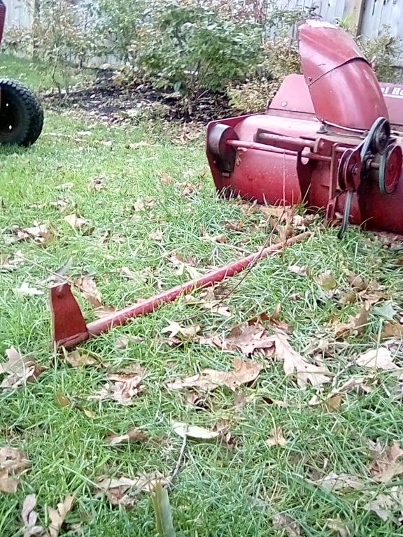

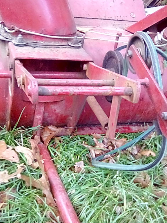

tkeon 0 #1 Posted October 30, 2018 Interested in possibly getting this single stage snowblower for my C-175 hydro. Based on these pictures, will this fit and work with my hydro? Having trouble understanding how this attaches to my lift system. Previous owner has a manual lever lift. thanks ted Share this post Link to post Share on other sites
gwest_ca-(File Mod) 12,456 #2 Posted October 31, 2018 The chute should turn in 4 grooved rollers. Looks like they have been replaced by a flat washer so may not work well. The lift arms on manual and hydraulic lifts are the same. The snowthrower attaches to the more vertical arm so when lifted the arm pushes the lift tube forward. With the snowthrower in the front hitch the rod forced forward causes the snowthrower to rotate on the front hitch rod effectively lifting it off the ground. Likely one of these 1975 model 6-6214 - (First model to include 8-0221 [103552 replaced by 93-1617 and 93-1617-01] side extensions with the front straight return. First model to have a cable spool on chute rotating crank handle) 1976 model 6-6215 - This one - 1976 model 66-42ST01 - and this one are likely identical. The model number format changed. 1977 model 76-42ST01 - This one 1978 model 86-42ST01 - and this one 1979 model 96-42ST01 - and this one plus 1980 may be all the same. They started using a different model number for each model year. 1980 model 06-42ST01 - (Last 42" model to use 4 grooved rollers for the chute) Garry 1 Share this post Link to post Share on other sites
tkeon 0 #3 Posted October 31, 2018 Ok thanks. See what you mean about the washers/rollers. Might the rollers still be available (or similar replacement) and would they probably be able to just replace the the bolts with washers. Otherwise maybe just grease the heck out of the flange. Appreciate the info. Share this post Link to post Share on other sites
gwest_ca-(File Mod) 12,456 #4 Posted October 31, 2018 The rollers didn't work all that well but had to be much better than washers. The rollers were replaced by a plastic collar that is no longer available. My next attempt to improve on the rollers is to try blocks made with low friction plastic with a groove machined into them to accept the chute flange. If each was about 2" long it should help spread the weight against them out. Some have had the opportunity to replace the short chute with a longer one used on the latest models. I don't know if the attaching hardware is enough to get past the roller problem. The tall chute was also used on some Toro walk-behind snowthrowers so that may be a source. Garry Share this post Link to post Share on other sites
