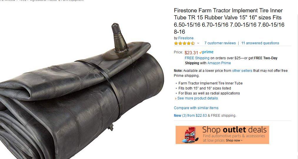

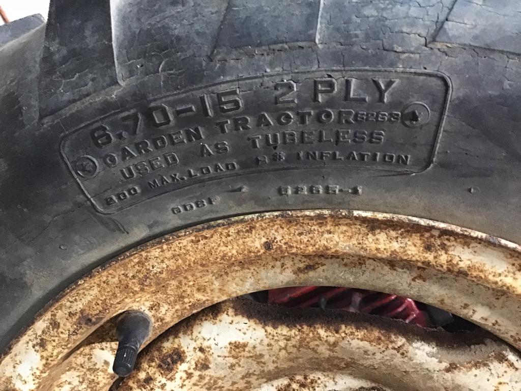

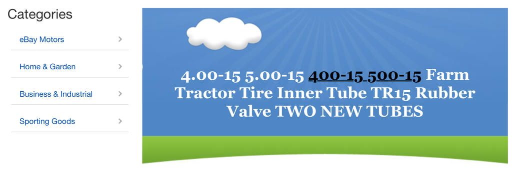

Pullstart 71,482 #1 Posted October 30, 2018 I have a set of 6.7-15 tires, and have found tube sets on eBay sized 6.5 or 7 by 16 or 5 by 15. Should I stretch the 15”, or bunch the 16”? Share this post Link to post Share on other sites

Pullstart 71,482 #4 Posted October 30, 2018 (edited) 18 minutes ago, pacer said: Many years ago when I was employed at 'a major airline' (Delta) I was the mechanic for ground equip, bag carts, etc. The baggage carts used 5.70x8 tires and would wear fairly quickly so I changed a LOT of tires! Pretty quickly I discovered that by using a 5.70x8 tube that it would often get a fold inside the tire when aired and with the fold flattened it would crack and get a leak there. So, I started using a 4.10 tube and it would not get a fold and decreased my flat tires greatly. I have followed that thru with my horses and use one or two sizes smaller tube - I havent seen a fold crack in a long time. I like to use the comparison of when we were kids and swam with inner tubes we would 'blow' them up to huge sizes Great advice! So the 5-15 should go just fine you suppose? Edited October 30, 2018 by pullstart 2 Share this post Link to post Share on other sites

ebinmaine 81,048 #6 Posted October 30, 2018 Kevin, I agree with above posts. Bunching a tube is not the best idea in the world. Perhaps order that one that Paul has showing or the one you have available at 15 in. Better to stretch it a bit. Share this post Link to post Share on other sites
Pullstart 71,482 #7 Posted October 30, 2018 Thanks guys! This might be a stretch or a long shot, but the tire is overall about 26x7r15 so I tossed a spare 23x8.5r12 onto it hoping the diameter difference will take up some of the width difference. For now, it’s holding. I suppose if or when it dies, I’ll go for the 5-15 option. 1 Share this post Link to post Share on other sites
