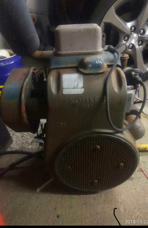

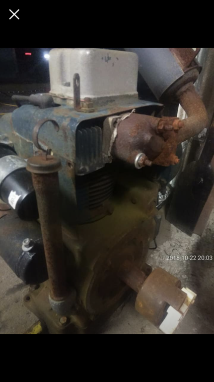

Chris1055 106 #1 Posted October 29, 2018 Hi everyone. In my travels I’ve come across a k361 I can’t see it going to salvage. I know they went made long and have trouble with getting oil up in the top end. It was on a wood splitter and the guy said it was not abused. I’m pretty much a purest when it comes to wheel horses and don’t like cutting them up. So my question would be. Is this a good candidate to put on a c160 auto to use with a snowblower? I have a hood that is pretty beat up that I can make work with clearance issues because of the ohv. This motor is not a need more of just experimenting. But I was going to repaint the tractor in the spring so I’d figure I can clean up and put new gaskets and seals on the original motor it needs a couple and then I can paint it and have it ready. What do you guys think? Worth it or not? 1 Share this post Link to post Share on other sites
