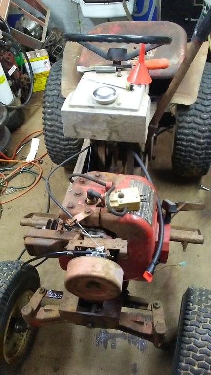

Elkskin's mower junkyard 1,117 #1 Posted October 29, 2018 okay on my 552 wheel horse i put a h70 from a snowblower on it. in one way i would like to put the electric start from the short block that was on the 552 onto the h70. but i am not sure i want to do that because of the lack of a actually regulator in that system. so does anyone have any ideas i was thinking of see what others have done to their tecumseh model wheel horses. Share this post Link to post Share on other sites
