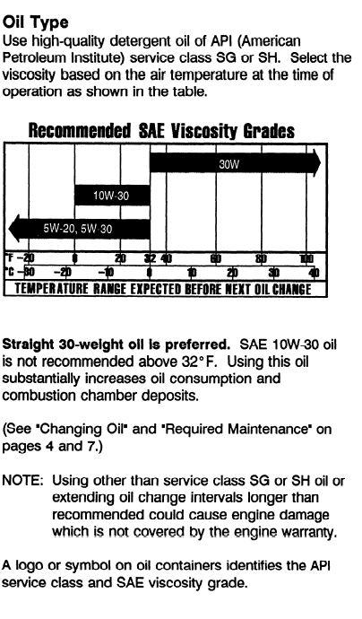

stevasaurus 23,705 #3 Posted October 28, 2018 I don't think adjusting the carb is the answer. Adjusting the carb would be more of an issue if you were at sea level and you took your horse to a M&G at the top of Pikes Peak. Like Paul said, more control by choking and allowing to warm up is the way to go. I also think that changing to a thinner oil could help...I think Wheel Horse recommended 10w-30 for those in the colder climates. Of course a fully charged battery, and holding in the clutch pedal, while starting, will help also. 3 2 Share this post Link to post Share on other sites

pfrederi 20,658 #7 Posted October 28, 2018 I run 5w-30 in the winter horses 1 Share this post Link to post Share on other sites
