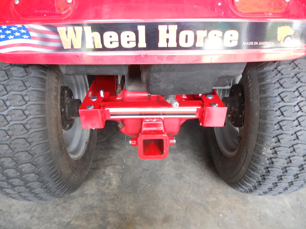

RandyLittrell 3,946 #2 Posted October 26, 2018 https://www.wheelhorseforum.com/forum/132-rupprechts-welding-and-fab-the-hitch-guys/ Check this hitch out, its a great hitch and if you can weld you could build one yourself, or buy one from them. Randy 1 Share this post Link to post Share on other sites

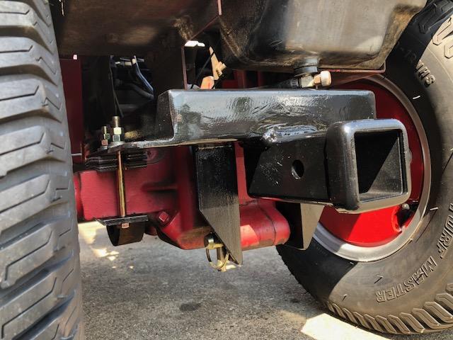

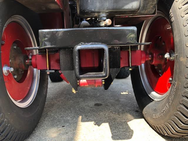

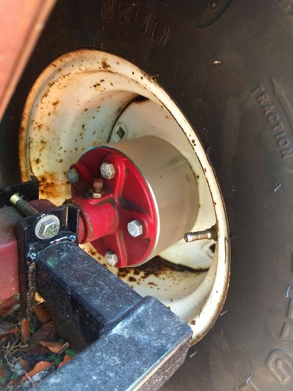

ebinmaine 80,974 #4 Posted October 26, 2018 I have a cheapie 2" receiver hitch I picked off fleabay. Nowhere near as heavy duty as the ones sold by the vendors on our site but it gets the job done ok. Then I bought a ball mount with the appropriate drop / raise for the couple different trailers we move. These pics aren't ideal but you can see what I'm using if you zoom in on the first. The second shows the end of the hitch where it bolts on. 2 Share this post Link to post Share on other sites
KC9KAS 4,746 #5 Posted October 26, 2018 30 minutes ago, ebinmaine said: The second shows the end of the hitch where it bolts on Just thinking out loud----Is your hitch mounted anywhere else, or on the axle housing only? I am thinking that a really heavy load could cause the axle housing to break.... Share this post Link to post Share on other sites
ebinmaine 80,974 #6 Posted October 26, 2018 Just now, KC9KAS said: Just thinking out loud----Is your hitch mounted anywhere else, or on the axle housing only? I am thinking that a really heavy load could cause the axle housing to break.... I agree. I've had that thought as well I have had some extremely heavy loads on this tractor but that doesn't mean I should keep doing it. I actually have a plan to put this particular hitch on Trina's 657 because she does not haul super heavy loads like this tractor does. At that point I'll either buy one or have a friend of ours make up one that utilizes the lower hitch Point as well as the axle Square. 1 Share this post Link to post Share on other sites

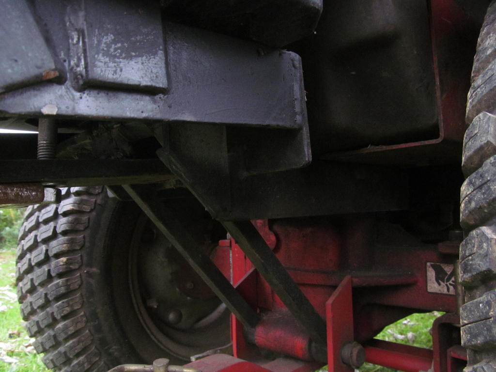

Mows4three 833 #7 Posted October 26, 2018 (edited) Here's my first shot at a rig that uses both the transaxle and the lower hitch point. Not pretty, but for my use, form follows function. To overcome the slight taper of the transaxle I used a couple lengths of conveyor belting cut to fit under the 2" angle. It might also possibly help to dissipate sudden shocks on the hitch with heavy loads over rough terrain. Cheers! Dave Edited October 26, 2018 by Mows4three 4 2 Share this post Link to post Share on other sites

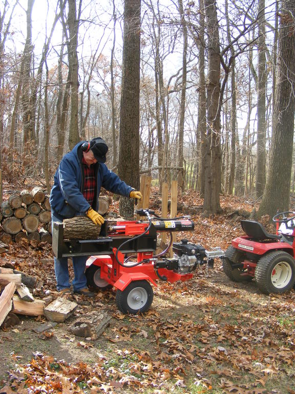

Racinbob 13,213 #8 Posted October 26, 2018 You also have this one from our vender. I love it! 1 Share this post Link to post Share on other sites

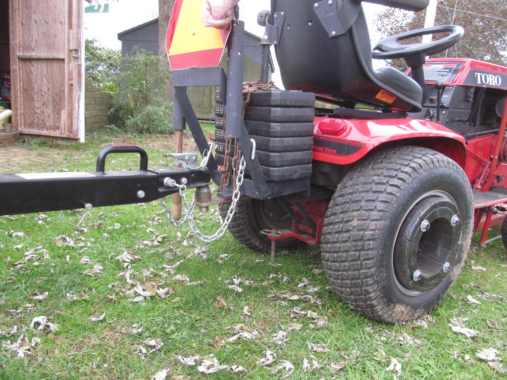

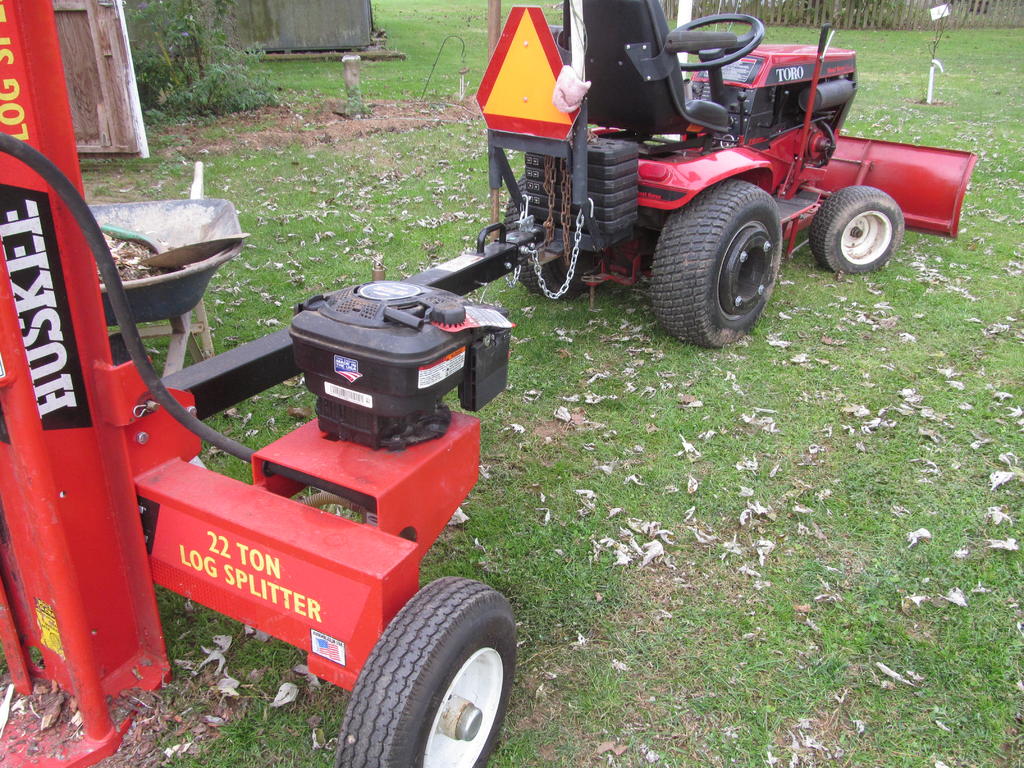

Ed Kennell 47,615 #9 Posted October 26, 2018 Mine is not a receiver type, but it does have a high ball mount and the original drawbar. Also serves as a weight carrier. It bolts to the seat pan bracket and the tranny drawbar pin. Share this post Link to post Share on other sites
clueless 3,440 #10 Posted October 27, 2018 19 hours ago, Ed Kennell said: Mine is not a receiver type, but it does have a high ball mount and the original drawbar. Also serves as a weight carrier. It bolts to the seat pan bracket and the tranny drawbar pin. Try putting all of that on a 25hp cub cadet from Home Depot and then use it . 2 2 Share this post Link to post Share on other sites

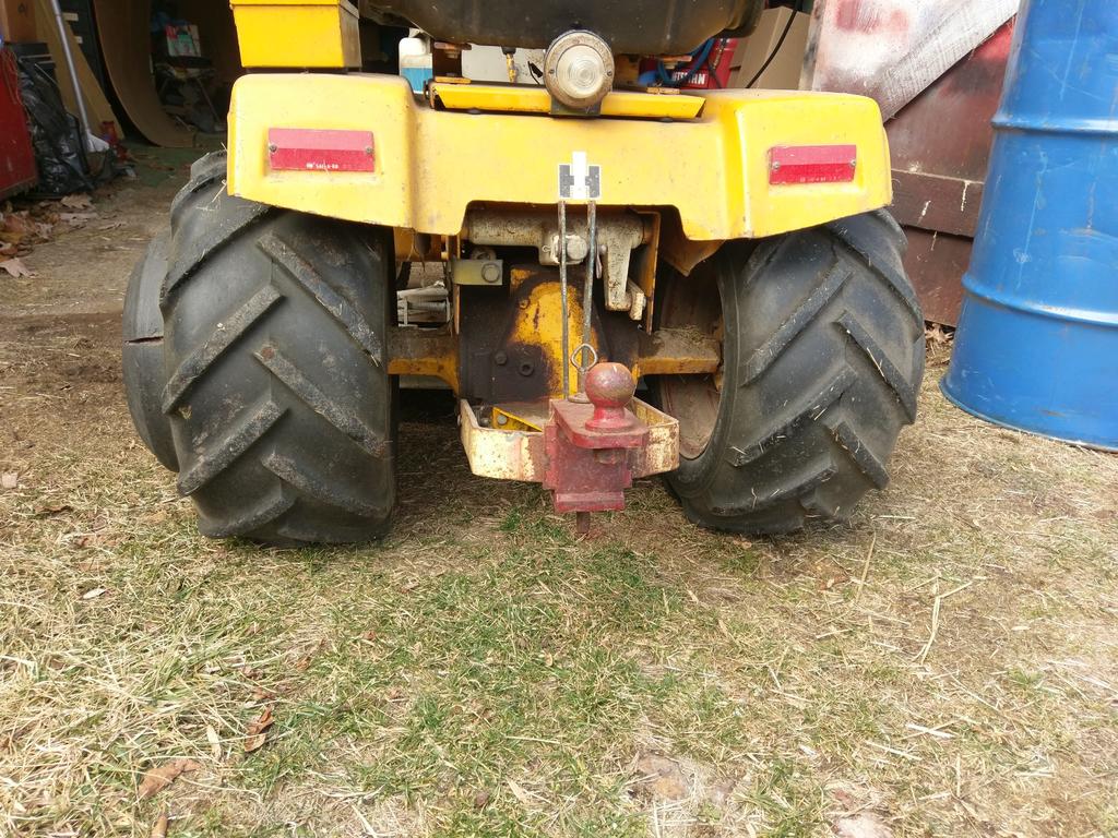

Lee1977 7,805 #12 Posted October 28, 2018 I have built two receiver hitches the first one uses the axle housing and the hitch mount. The other uses the axle housing and the top of the transmission where the fender brackets mounts. Share this post Link to post Share on other sites

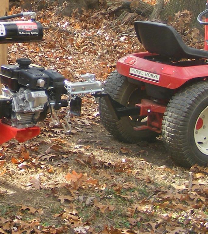

shallowwatersailor 3,222 #14 Posted October 29, 2018 I used 2" receivers on my tractors by Scott and Tom (Rupprechts Welding), and a Harbor Freight 6" Drop/Rise hitch to tow my logsplitter around. Share this post Link to post Share on other sites
