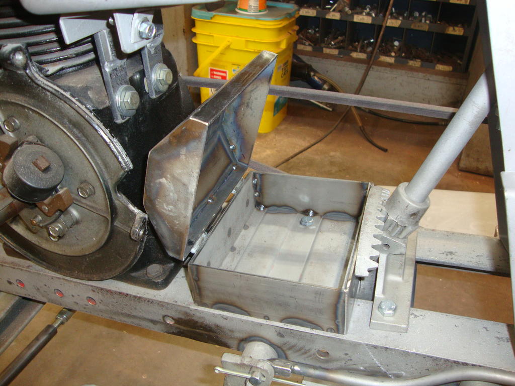

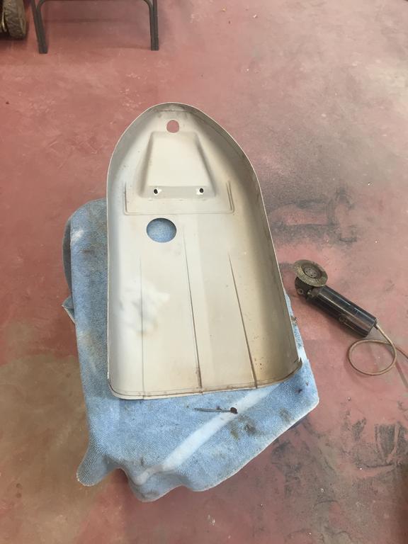

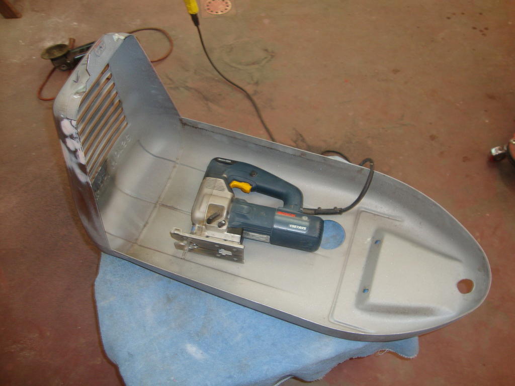

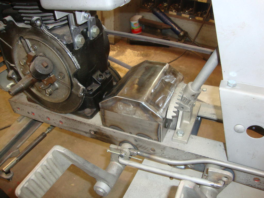

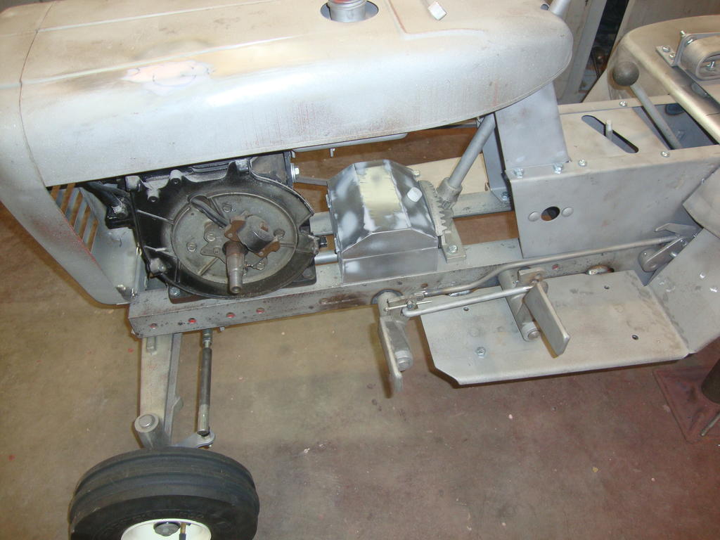

dclarke 4,274 #29 Posted December 29, 2018 (edited) Since this is a recoil start engine I wanted to fill in some of the empty space where the battery used to sit on this Ranger so I cut the battery tray down a little and welded up some 1/8" flat to make a tool box out of it. It's not very big but I think the boys will like it. I'll put a small latch on it and maybe add a small handle if I run across something that fits the dimensions.... I've also taken my seat pan to have cushions made and the guy tells me it'll be mid February before I get it back. Edited December 29, 2018 by dclarke 5 11 1 Share this post Link to post Share on other sites
Shynon 7,709 #30 Posted December 29, 2018 That's cool I'll bet there gonna like that. 1 1 Share this post Link to post Share on other sites
Sarge 3,473 #31 Posted December 31, 2018 Great idea on the toolbox - it's the one thing I wish WH had thought of besides the one under the seat on the older models, which loves to lose small clips and other parts - lol. Sarge 1 Share this post Link to post Share on other sites
dclarke 4,274 #32 Posted December 31, 2018 (edited) 26 minutes ago, Sarge said: Great idea on the toolbox - it's the one thing I wish WH had thought of besides the one under the seat on the older models, which loves to lose small clips and other parts - lol. Sarge Thanks Sarge. I had an extra hood knob that I used for a handle and the lid is heavy enough that I don't think it needs a latch. I think I'm gonna shoot the inside with some bed liner. Edited December 31, 2018 by dclarke 7 Share this post Link to post Share on other sites

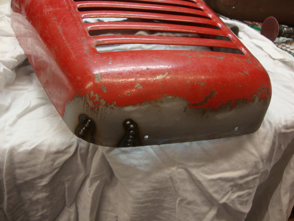

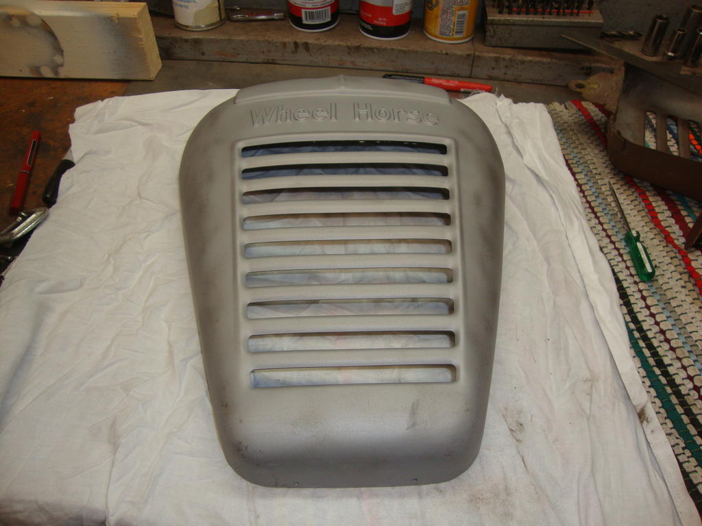

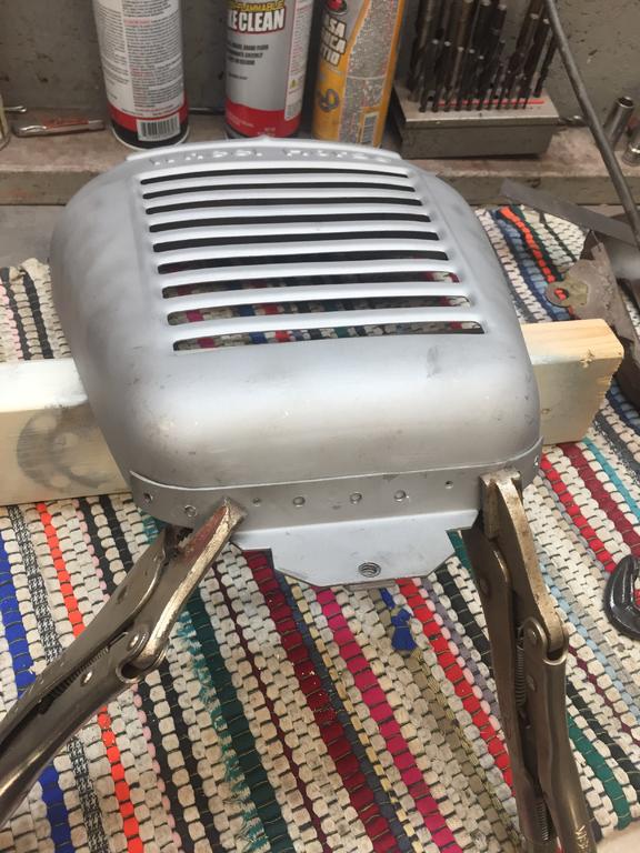

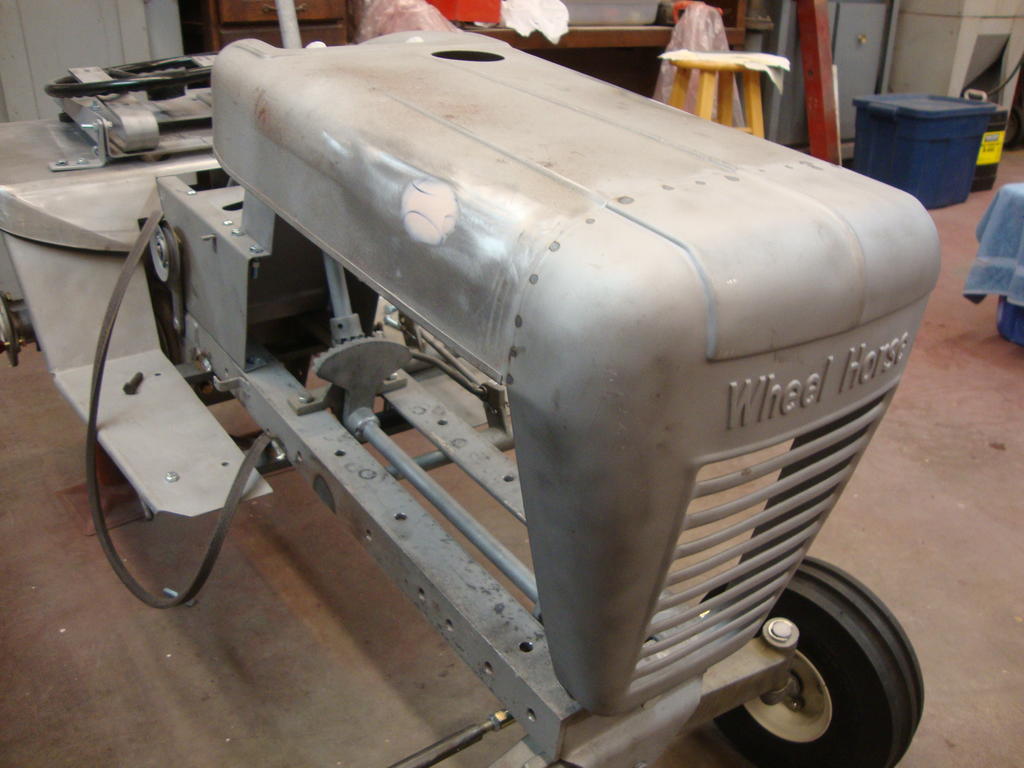

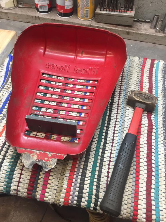

dclarke 4,274 #34 Posted January 3, 2019 (edited) The hood on this Ranger had a dent on the nose where the “Wheel Horse” lettering is and I never could get it straightened good enough to be happy with it. Another member here gave me a nice nose piece so I’m attempting to replace the front of my hood with the the one I just got.I ended up using the front mounting tab from my old hood and now I’m ready to tack the new front onto the hood. Tomorrow my son in law is gonna come by and help me get everything lined up so I can tack the two halves back together. So far this has gone better than I thought it might, I think it’ll make a nice hood when it’s done. Edited January 3, 2019 by dclarke 7 2 Share this post Link to post Share on other sites

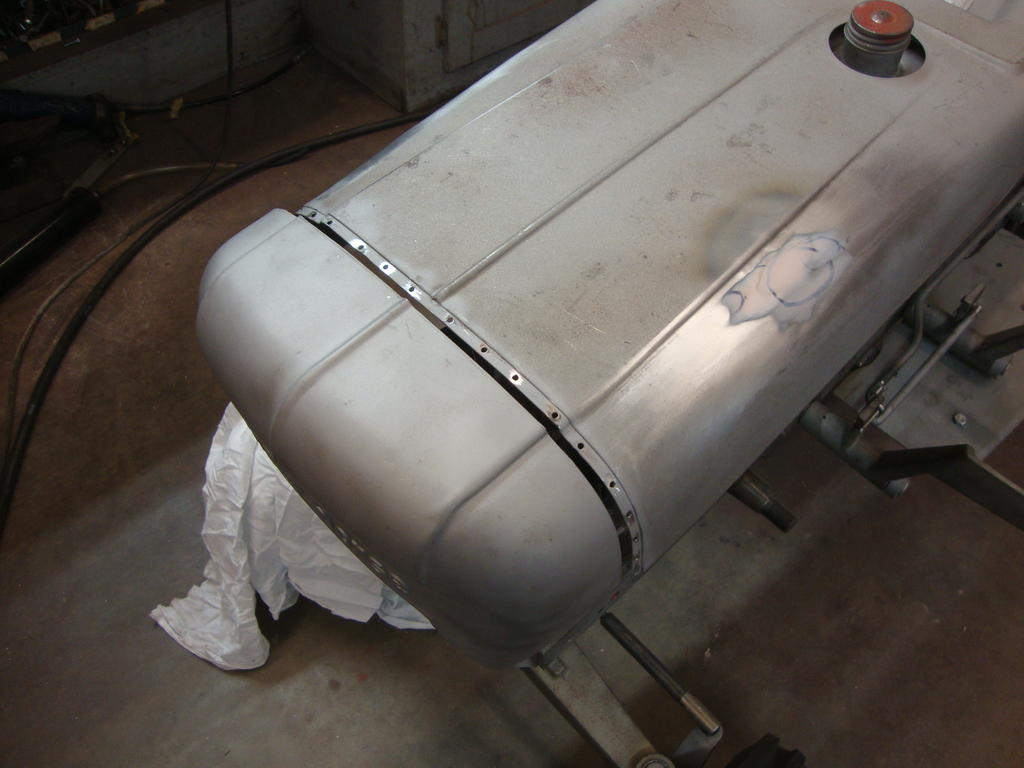

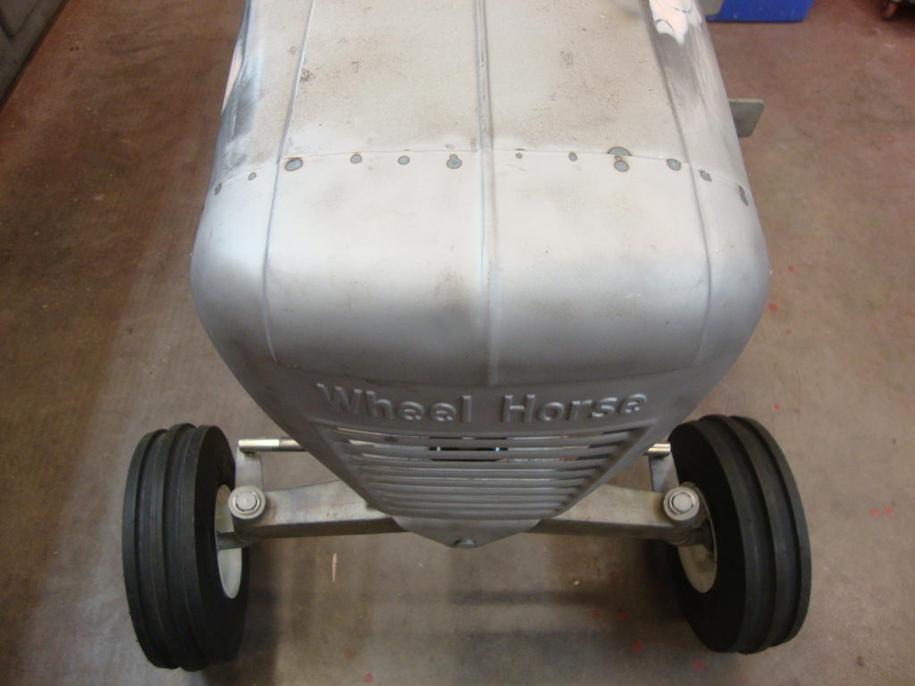

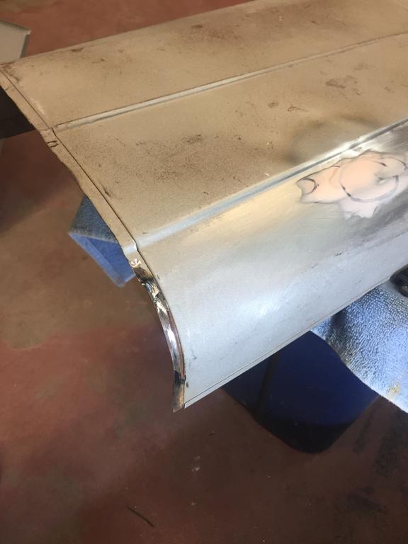

dclarke 4,274 #35 Posted January 3, 2019 Got the hood back together this morning, I wasn't sure how this was gonna turn out when I started but I'm happy with it. 7 7 Share this post Link to post Share on other sites
WHX?? 58,239 #36 Posted January 3, 2019 Nice work and the tool box is the bomb! Don't scrap the old nose piece out Denny ...might be good for another project or even just shop deco. 4 1 Share this post Link to post Share on other sites

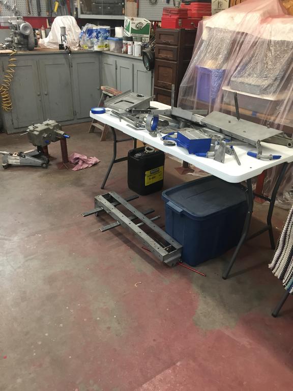

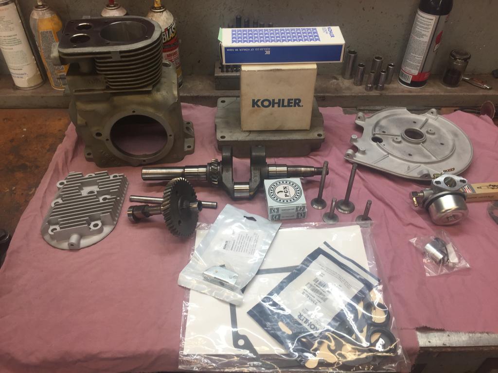

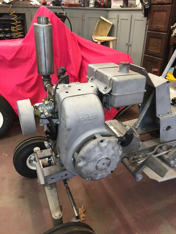

dclarke 4,274 #39 Posted May 8, 2019 I got my block and crank back from the machine shop and am cleaning up parts so I can get this engine back together. I’ve also got the seat finished for this project. Gettin closer to paint. 😁 6 4 Share this post Link to post Share on other sites

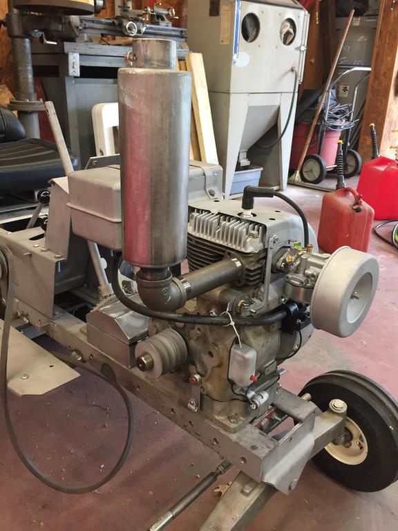

dclarke 4,274 #42 Posted May 11, 2019 I got the engine back together and ran it a little. Now I’m ready to take this tractor back apart and start prepping it for paint. 5 3 1 Share this post Link to post Share on other sites

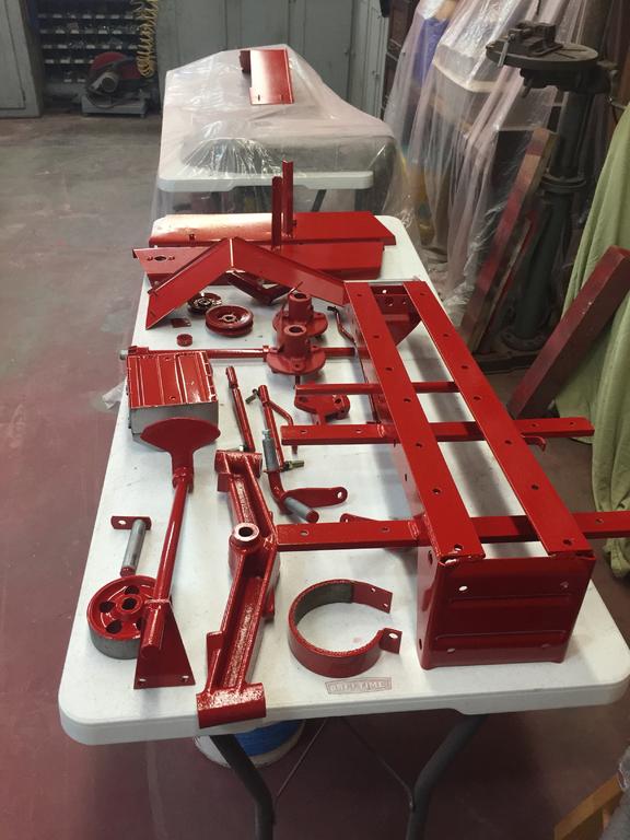

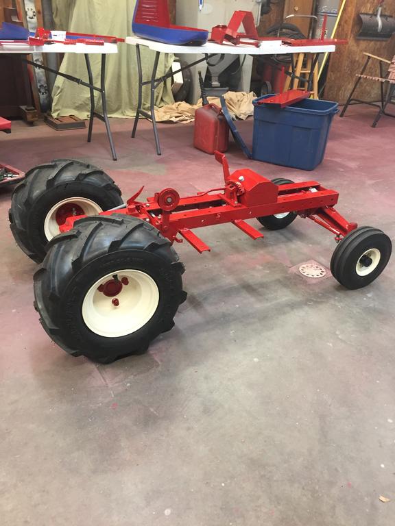

dclarke 4,274 #43 Posted June 9, 2019 Starting to put some color on my grandsons’ Ranger. 6 2 Share this post Link to post Share on other sites

dclarke 4,274 #49 Posted June 14, 2019 I got a few more pieces painted today and got started reassembling this project. With any luck I’ll get the engine painted tomorrow. 6 1 Share this post Link to post Share on other sites
