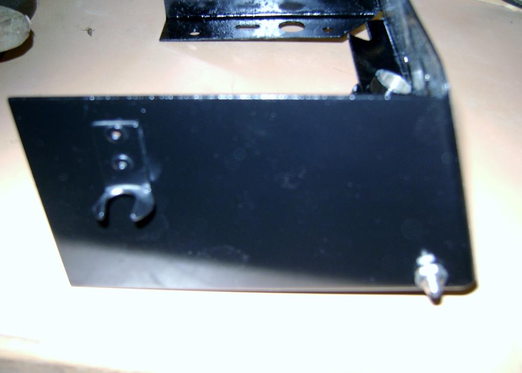

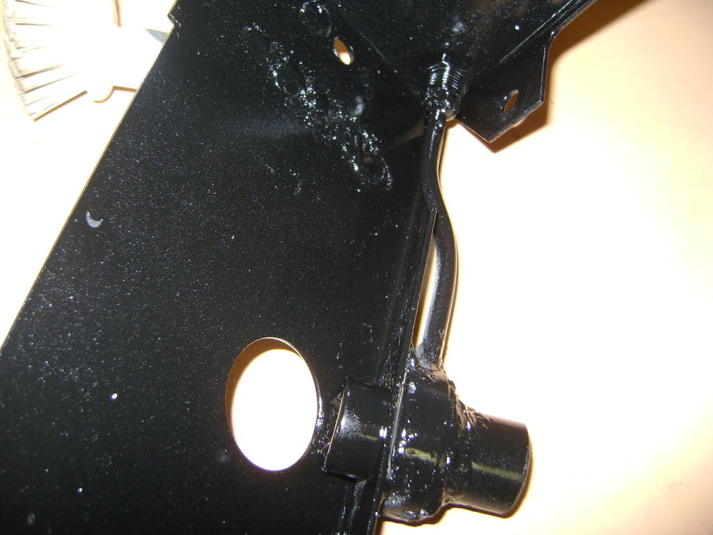

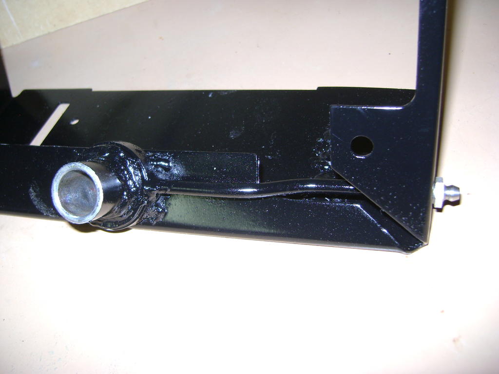

dave647 27 #11 Posted October 24, 2018 here comes the pictures. they are not award winning (my first attempt) any questions please ask. steering bushing is a steel 3/4 id x 1" od with a 1" stop collar welded to it. drilled thru set screw location on stop collar. used a 1/4" brake line and a 3/8" x 1/8" reducer bushing to screw zerk into. 1 1 Share this post Link to post Share on other sites
dave647 27 #12 Posted October 25, 2018 more pictures 1 2 Share this post Link to post Share on other sites
Pullstart 71,482 #13 Posted October 25, 2018 Great idea! Share this post Link to post Share on other sites
