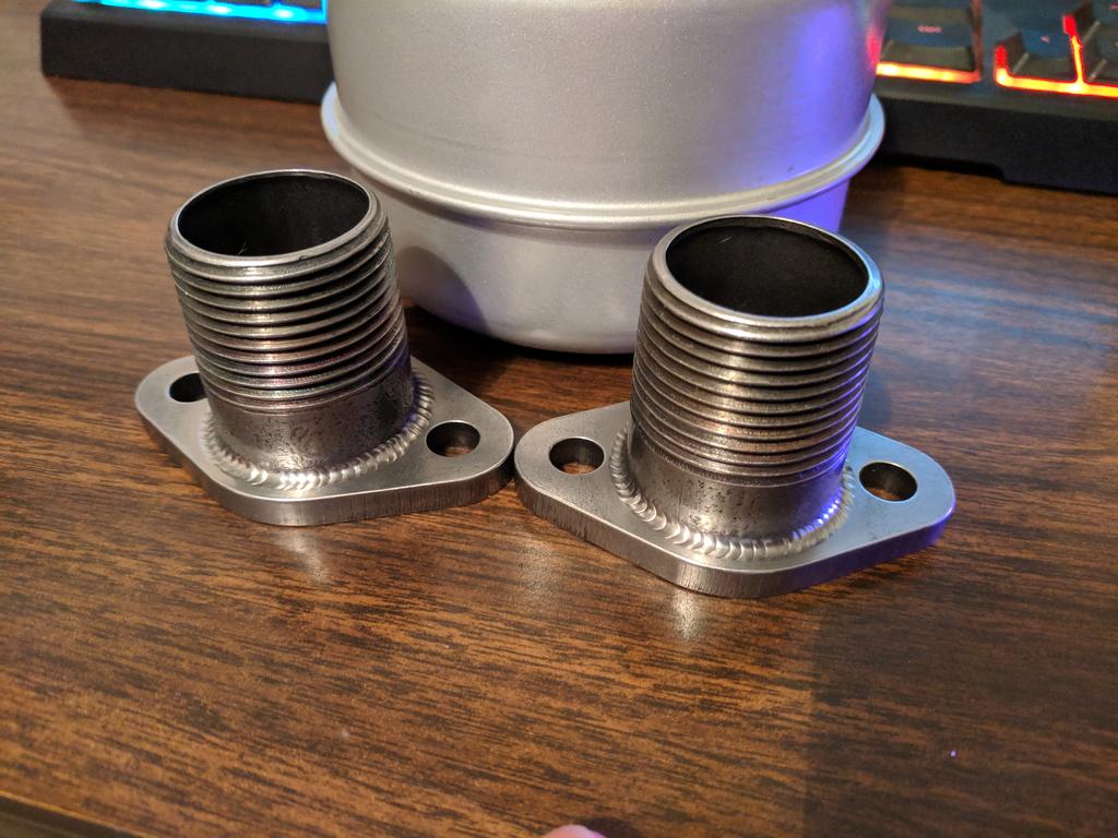

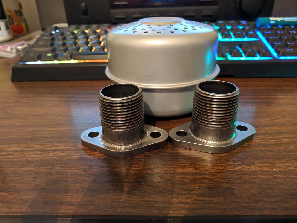

WildmanC120 615 #56 Posted November 6, 2018 Picked up these trick flanges thanks to a member here. These are awesome and will make my life so much easier. 2 1 Share this post Link to post Share on other sites

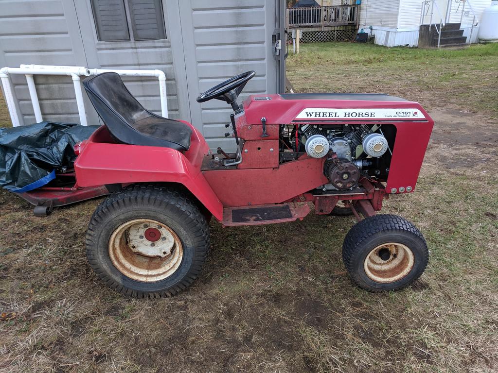

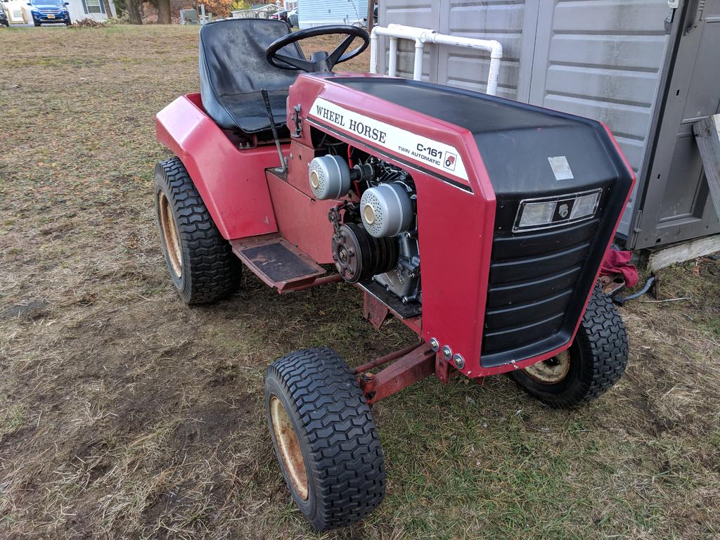

WildmanC120 615 #57 Posted November 7, 2018 Got the new exhaust installed and at the length I want it. Finished wiring up my PTO and putting the switch in the dash. I also was able to trim the stock choke and throttle cables in the dash and those are now functional. All I have left is to move the key switch and remove the box from side of motor. Tractor is now fully functional. I will be removing the snowblower from my C-120 and putting it on this for the winter tomorrow. Wheel Horse C-161 22HP Predator Complete Pepper Pot Exhaust 1 2 Share this post Link to post Share on other sites

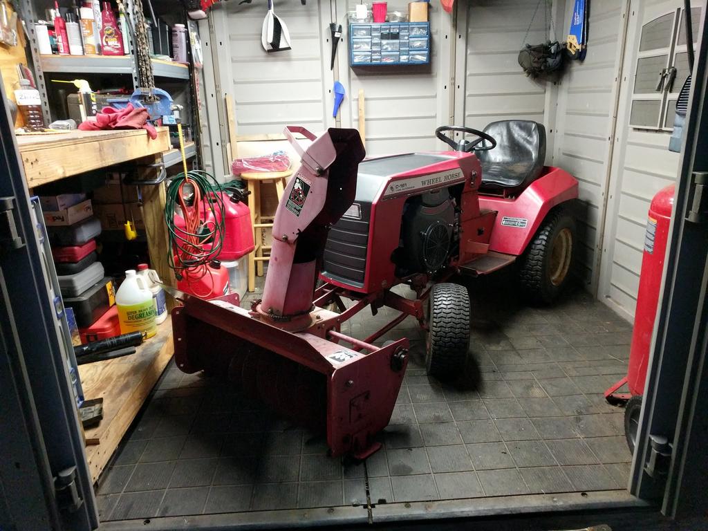

WildmanC120 615 #59 Posted November 8, 2018 Another decent day today in the North East. Pulled out the C-120 and took the snowblower off and brought it to storage. Got the snowblower installed on my C-161. It sure is nice to have that hydro lift. I am now officially ready for winter and kinda excited to see hoe well this thing works. Wheel Horse C-161 22hp Predator W/ Snowblower Attached 3 3 Share this post Link to post Share on other sites

WVHillbilly520H 10,379 #61 Posted November 9, 2018 Where are your thrower extensions so its 42" wide? 1 1 Share this post Link to post Share on other sites
WildmanC120 615 #62 Posted November 9, 2018 6 minutes ago, WVHillbilly520H said: Where are your thrower extensions so its 42" wide? I had to take them off because I couldn't shut the door on my shed. 1 1 2 Share this post Link to post Share on other sites
cleat 9,333 #63 Posted November 9, 2018 Time for a bigger shed 3 Share this post Link to post Share on other sites
WildmanC120 615 #64 Posted November 9, 2018 2 minutes ago, cleat said: Time for a bigger shed Truth. Thank god that's only temporary living arrangements. Share this post Link to post Share on other sites

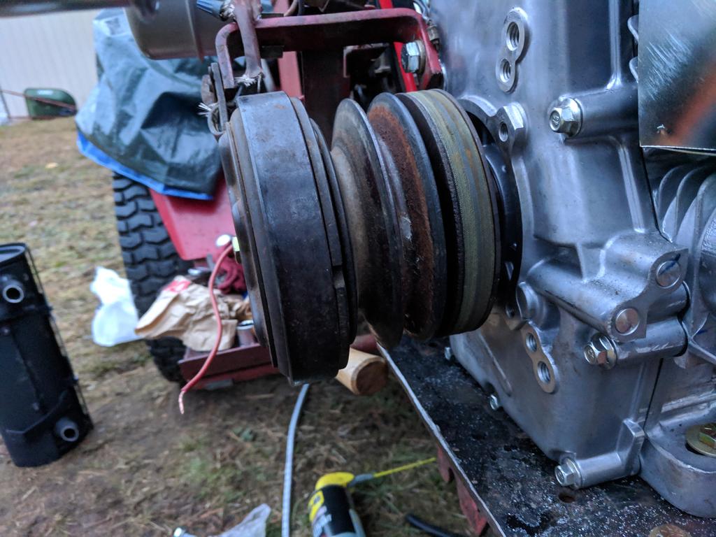

USHorse 41 #70 Posted November 11, 2018 I am doing a similar swap. How much space should there be between the electric PTO and the drive pulley...Should there be a spacer? Share this post Link to post Share on other sites
TravelinJavelin 621 #71 Posted November 11, 2018 man i like the looks of these predator engines in these tractors we just need to see one with a set of fish tail pipes ......wonder if there is enough room on a 953 lol? Share this post Link to post Share on other sites
WildmanC120 615 #72 Posted November 11, 2018 7 hours ago, USHorse said: I am doing a similar swap. How much space should there be between the electric PTO and the drive pulley...Should there be a spacer? I do not have a spacer or anything. The PTO will bottom out on the shaft before it touched the drive pulley. Share this post Link to post Share on other sites
