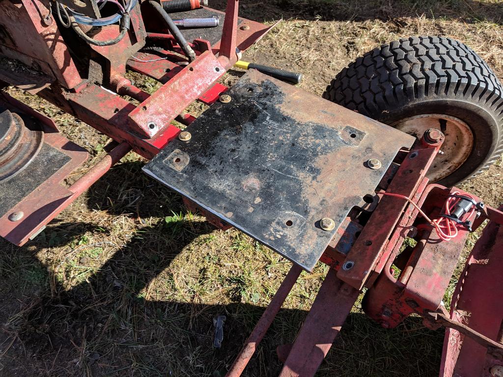

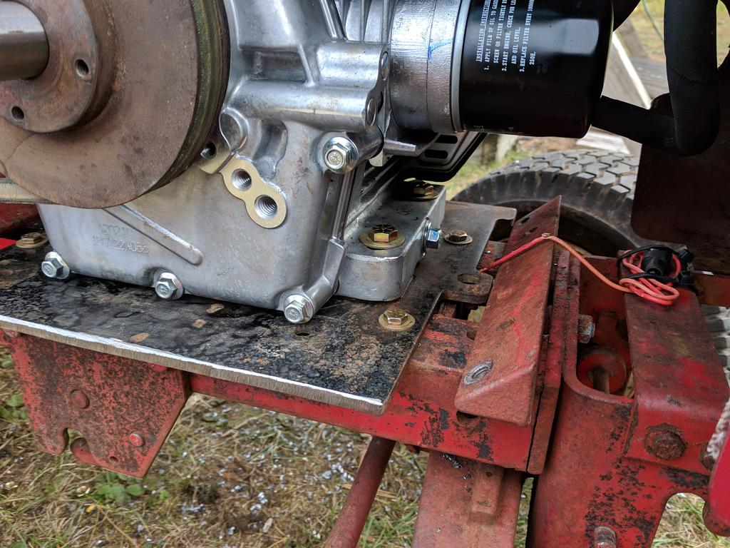

WildmanC120 615 #8 Posted October 25, 2018 (edited) I took the old Briggs mounting plate and cut the angled pieces with the rubber mounts off each end. I then placed it where I wanted it and drilled some new mounting holes. This gave me something to mount the engine too. This plate is literally as high as you can go otherwise the hood will hit and rest on the top of the engine. I wish you could go a little higher but in the end it should work OK. I will have to find some shorter belts to run the deck and snowblower i'm sure. Edited October 25, 2018 by WildmanC120 2 Share this post Link to post Share on other sites

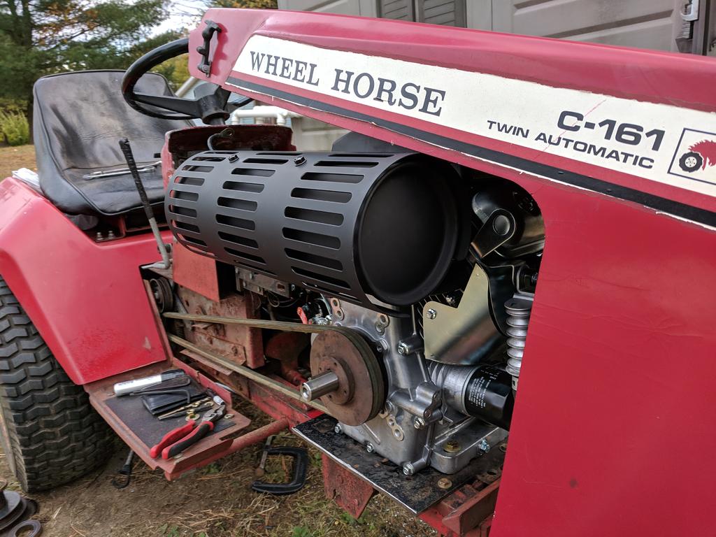

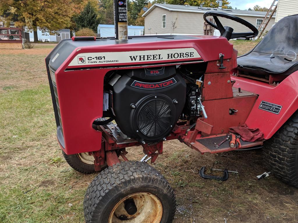

WildmanC120 615 #9 Posted October 25, 2018 Engine looks pretty good in there, Not too out of place. I think I may run the stock key setup for now as time is getting short and its literally 1 wire from the battery to have it running. When the weather warms up in the spring I can rewire it for the stock tractor key switch, choke and throttle controls. 5 Share this post Link to post Share on other sites

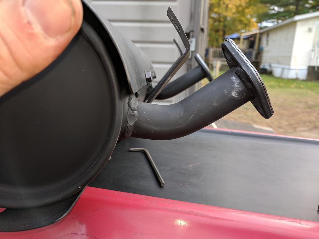

WildmanC120 615 #10 Posted October 25, 2018 Only thing really left to do is fins someone local to cut these flanges off where the pipe is straight and extend it a few inches. The hood will not close with the stock muffler. I would like to keep it mounted on the side like that as I think it looks good and kinda mimics the 520. The muffler also needs to be turned 180* so the output faces front and not the operator. 1 Share this post Link to post Share on other sites
