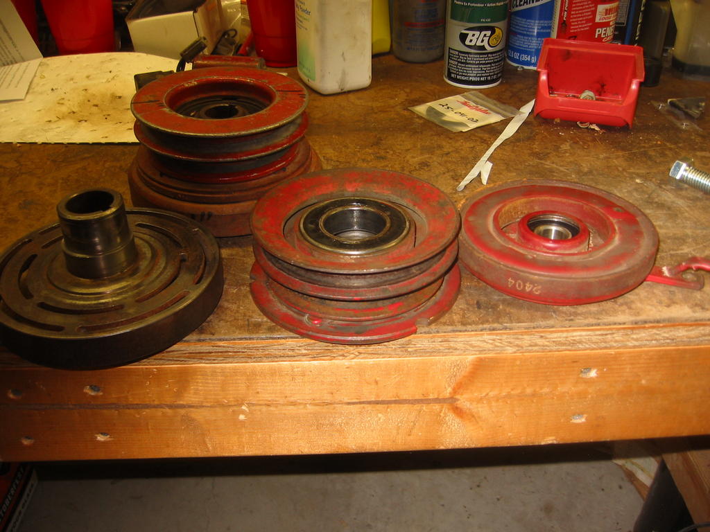

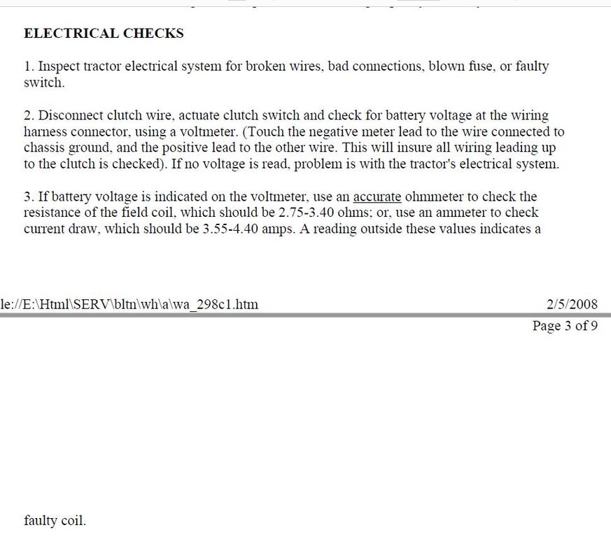

pfrederi 20,964 #26 Posted October 26, 2018 (edited) 3 hours ago, 953 nut said: The electric clutch on mt GT-14 draws ten to eleven amps. Interesting. I happen to have two Electric PTOs sitting on the work bench. Grabbed an extra battery and my multi meter..According to it they both drew less than 4 amps. (one about 3.25 the other 3.48.... I memory serves (and it frequently does not) that is near what the amp meter on my C175 shows when I use the electric PTO for the Sweepster Edited October 26, 2018 by pfrederi 1 Share this post Link to post Share on other sites

953 nut 67,942 #28 Posted October 26, 2018 I was just going by the amp meter on the tractor, at half throttle it shows 10 amps charging and drops to zero when the PTO is turned on. Share this post Link to post Share on other sites
pfrederi 20,964 #29 Posted October 26, 2018 (edited) 24 minutes ago, 953 nut said: I was just going by the amp meter on the tractor, at half throttle it shows 10 amps charging and drops to zero when the PTO is turned on. Rich: with switch in run engine off you should show 0 amps (If you still have breakerless ignition) then turn the pto on what discharge rate do you get? Edited October 26, 2018 by pfrederi 1 Share this post Link to post Share on other sites

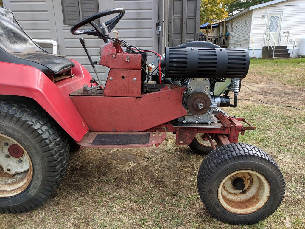

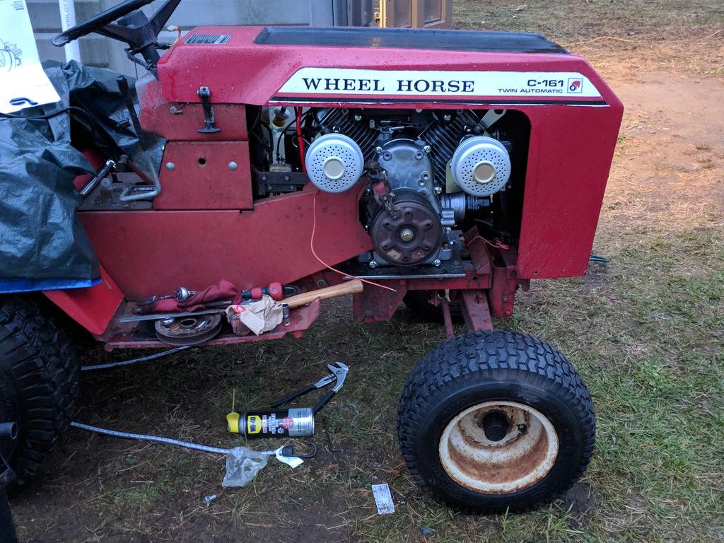

WildmanC120 613 #30 Posted October 26, 2018 Well got the engine running today. Sounds pretty good. Now that I know it runs, over the next few days I will remove the stock key switch box from side of engine and rewire it to use the stock key switch/controls in the dash. Only thing left to do is decide on what electric clutch I need for this and modify my exhaust so the hood closes. Wheel Horse C-161 Predator 22hp 1st Run Wheel Horse C-161 Predator 22hp Drive 2 Share this post Link to post Share on other sites

pfrederi 20,964 #32 Posted October 26, 2018 The electric PTO dual sheave pulleys are the same diameter as the Manual PTO pulleys. The crank size 1 or 1-1/8th makes no difference in pulley size Share this post Link to post Share on other sites
WildmanC120 613 #33 Posted October 26, 2018 10 minutes ago, pfrederi said: The electric PTO dual sheave pulleys are the same diameter as the Manual PTO pulleys. The crank size 1 or 1-1/8th makes no difference in pulley size Did wheel horse offer a electric PTO in 1" crank size though. Share this post Link to post Share on other sites

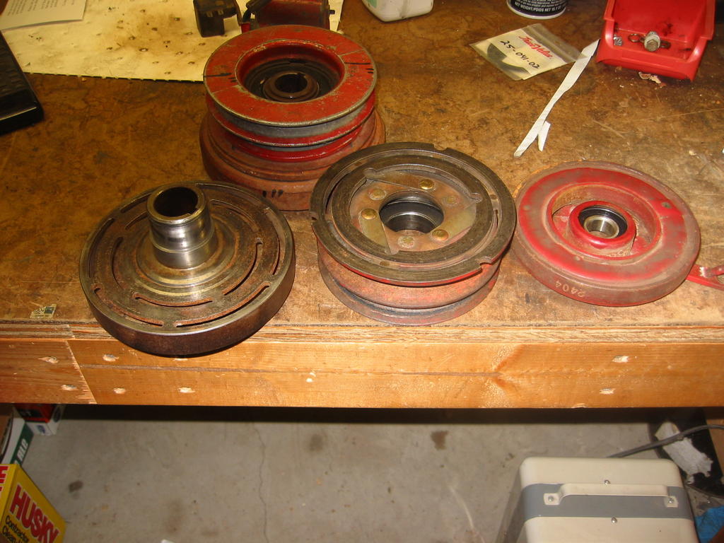

pfrederi 20,964 #34 Posted October 26, 2018 (edited) Yes they did Only the hub unit is different between 1 and 1-1/8. The field coil and pulley parts are the same Edited October 26, 2018 by pfrederi 2 1 Share this post Link to post Share on other sites
WildmanC120 613 #35 Posted October 26, 2018 17 minutes ago, pfrederi said: Yes they did Only the hub unit is different between 1 and 1-1/8. The field coil and pulley parts are the same Ok looks like I will have to find one with a 1" ID then. Might be better then find ding an aftermarket unit. Share this post Link to post Share on other sites

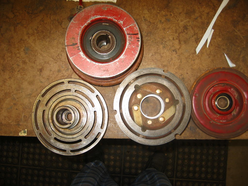

pfrederi 20,964 #39 Posted October 27, 2018 In a manual PTO the friction disk is locked to the crank, they PTO lever pushes the PTO Bell and pulleys against it to engage. You are pushing the crankshaft into the engine. The normal sleeve bearings with small flanges used in many engines cannot deal with this pressure and will quickly wear out. In an electric PTO the field coil when activated pulls the pulley drive out towards the coil. no end pressure on the crank. 3 5 Share this post Link to post Share on other sites

953 nut 67,942 #42 Posted October 29, 2018 On 10/26/2018 at 3:19 PM, pfrederi said: Rich: with switch in run engine off you should show 0 amps (If you still have breakerless ignition) then turn the pto on what discharge rate do you get? Turns out my amp meter shows about four amps draw from the PTO. 2 Share this post Link to post Share on other sites
pfrederi 20,964 #43 Posted October 29, 2018 3 hours ago, 953 nut said: Turns out my amp meter shows about four amps draw from the PTO. Found this in a TSB on electric PTOs 4 amps is a good reading!! 2 1 Share this post Link to post Share on other sites

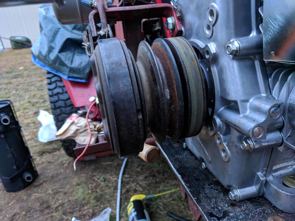

82Caddy 851 #44 Posted October 30, 2018 Sleeve adapters all over the place (ebay etc) to go from a 1" crank to a 1 1/8" electric PTO. Might open up a few options for you when hunting PTO's. Regarding the electric PTO, you'll need to disconnect the oil pressure sensor. Otherwise with the electric PTO engaged the engine will die. Lots of folks have used these engines in JD platforms and have experienced the electric PTO shutting the engine down. Google will tell you exactly what wire to disconnect. Take care when you decide to change the key switch, the wiring won't be the same as what is currently on your tractor and will need a different key switch then your tractor has now. The easiest option is to extend the wires from the factory predator switch to your dash. When I used this engine in a D series, I traced the gaskets for the exhaust onto a piece of paper and then cut them out of metal with a piece of black threaded pipe to be able to run stacks or a different style of exhaust. Another idea for you to consider for exhaust options. 1 Share this post Link to post Share on other sites
richmondred01 2,383 #45 Posted October 30, 2018 On 10/27/2018 at 9:09 AM, pfrederi said: In a manual PTO the friction disk is locked to the crank, they PTO lever pushes the PTO Bell and pulleys against it to engage. You are pushing the crankshaft into the engine. The normal sleeve bearings with small flanges used in many engines cannot deal with this pressure and will quickly wear out. In an electric PTO the field coil when activated pulls the pulley drive out towards the coil. no end pressure on the crank. 100 percent on the money. If you are doing these swap outs and want a pto, the electric one is the way to go. Share this post Link to post Share on other sites

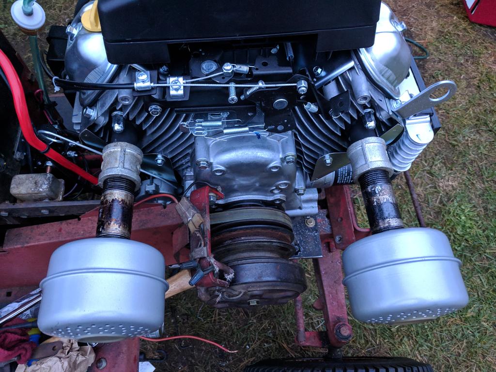

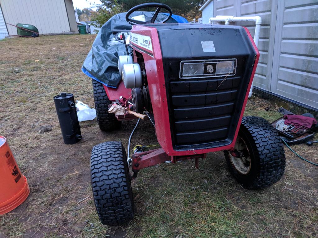

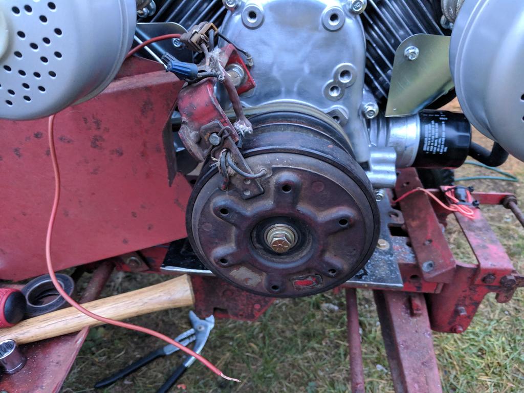

WildmanC120 613 #46 Posted November 1, 2018 Got the PTO installed today. Still have to hook up the wire but that's no big deal. Also cut my stock exhaust off so that there are just the flanges and a little piece of pipe. Trying to figure out what to do for a muffler. I bought some pepper pots but unsure how to attach them if I want to go that route. Share this post Link to post Share on other sites

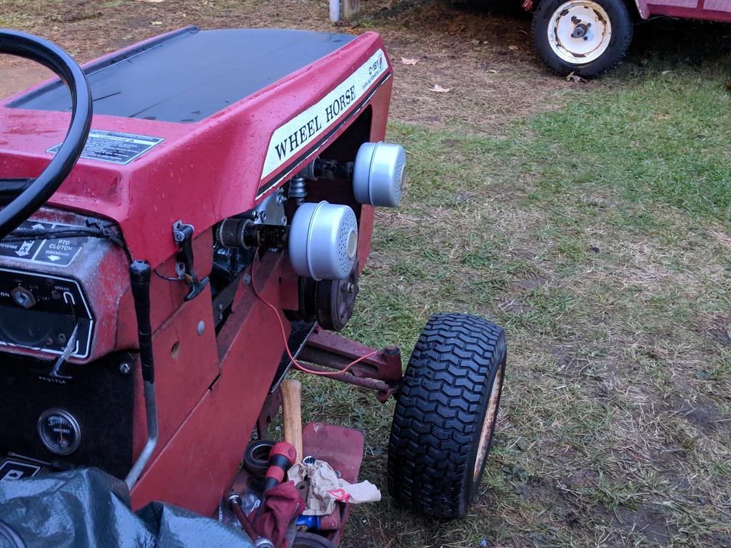

WildmanC120 613 #47 Posted November 1, 2018 How do I attach these mufflers? Share this post Link to post Share on other sites
WildmanC120 613 #48 Posted November 1, 2018 I'm not sure if I care for the look but it would be functional. I may get some pipe and see if I can use the stock muffler. If I were to use these I would use 2" pipe instead of the 4" that's on there so they do not stick out as far. 1 Share this post Link to post Share on other sites
WildmanC120 613 #49 Posted November 2, 2018 22hp Running with Pepper Pot Mufflers 2 Share this post Link to post Share on other sites
USHorse 41 #50 Posted November 2, 2018 I used these and the pepper pots screwed right on. Very tight fit by the oil dipstick but worked. https://www.ebay.com/itm/PREDATOR-420cc-HF-THREADED-EXHAUST-ADAPTOR-FLANGE-GENERATOR-GOKART-MINI-BIKE/262865560772?epid=579196641&hash=item3d340224c4:g:bl4AAOSwdGFYrgIR 1 Share this post Link to post Share on other sites
