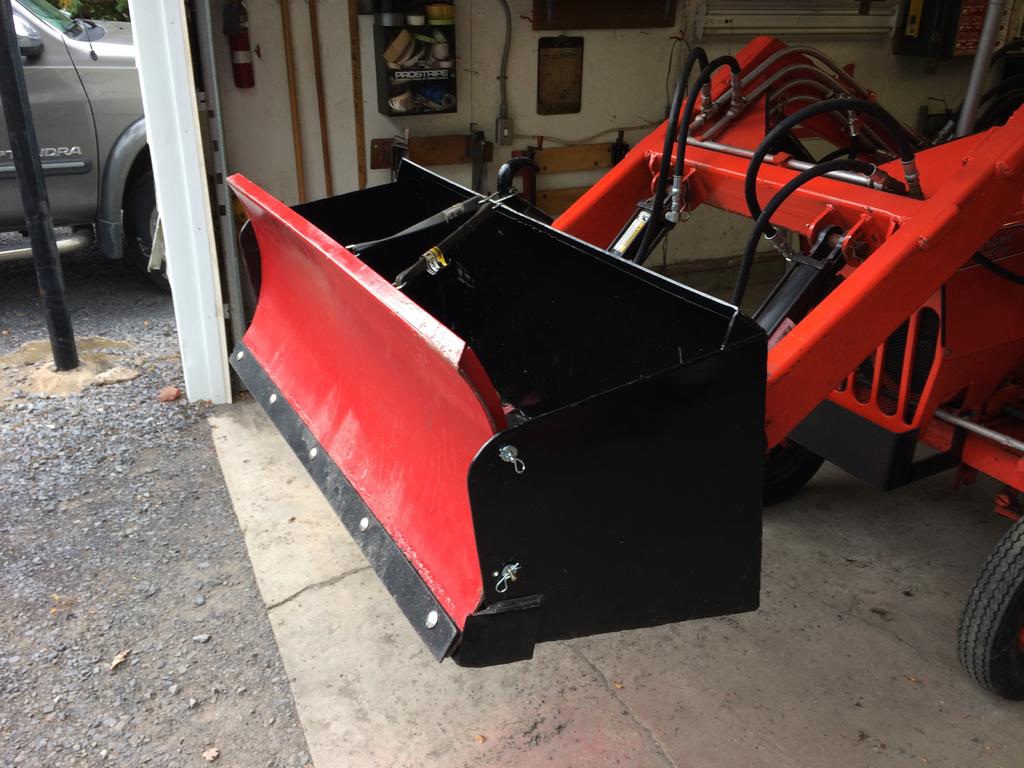

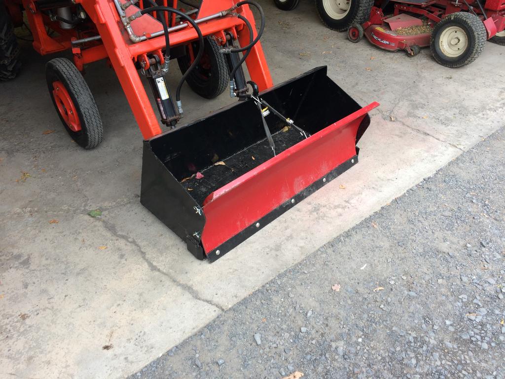

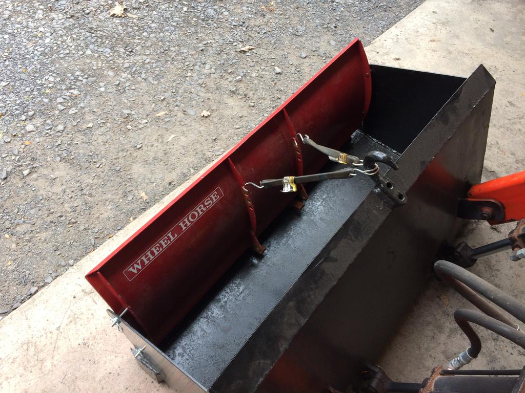

squonk 45,849 #1 Posted October 20, 2018 We get heavy wet snow more often than not. I have a small driveway with not a lot of room to put snow. I've been moving piles back with Elvis but it gets to be a pain when half the snow stays in the bucket and you have to jog the loader. I had an extra 42" WH blade so I made up a Prototype. Comes on and off with pins. Bungee is temporary until I can come up with something better. 7 Share this post Link to post Share on other sites
ebinmaine 77,933 #2 Posted October 20, 2018 I think you've got a great idea there. The only concern I can see is that you may catch snow on the outside edges where the curve of the blade kind of sits in the bucket. Share this post Link to post Share on other sites
squonk 45,849 #3 Posted October 20, 2018 Yeah, I expect snow to get in the bucket some but that's not a big deal. Share this post Link to post Share on other sites
ebinmaine 77,933 #4 Posted October 20, 2018 If that gets so you'd like to stop it you could attach pieces of thick rubber to the edges and maybe even put a snow foil on the top to help it roll off instead of up and over. Share this post Link to post Share on other sites
Digger 66 3,525 #5 Posted October 20, 2018 (edited) I'm not really sure what you're getting at ... When you're dumping , does the bucket not have enough forward-curl to let the snow drop out ? So the blade is temporarily attached to the bucket to turn it into a plow ? Edited October 20, 2018 by Digger 66 Share this post Link to post Share on other sites
squonk 45,849 #6 Posted October 20, 2018 10 minutes ago, Digger 66 said: I'm not really sure what you're getting at ... When you're dumping , does the bucket not have enough forward-curl to let the snow drop out ? So the blade is temporarily attached to the bucket to turn it into a plow ? Wet snow sticks in the bucket unless you job the bucket and arms . Just want to push the piles. The curve of the blade will roll the snow forward without piling over the back of the bucket. If the piles get high I can raise the plow and angle it and move the tops back. I saw a similar set up on a Bobcat Turf Cat last winter. They were moving good of snow piles. Yes the blade comes on and off in seconds. 2 Share this post Link to post Share on other sites
ebinmaine 77,933 #7 Posted October 20, 2018 I'm sure you guys have the same scenario out there but a lot of people use a similar setup for doing parking lots here. The only difference is that they use a plow blade that is a foot or two wider than the total width of the snow scoop. 1 Share this post Link to post Share on other sites

AMC RULES 37,255 #10 Posted October 20, 2018 The idea is a bigger blade with wings, aka snow pusher is what you need. 1 Share this post Link to post Share on other sites
SylvanLakeWH 30,872 #11 Posted October 20, 2018 Nice Job! I think it will work just fine for what you describe as your intent... Share this post Link to post Share on other sites
Kenneth R Cluley 661 #12 Posted October 20, 2018 May want to cut a couple 2x4's or 4x4's and place in bucket behind blade for support. I don't think pins will take that much pushing. JMHO. 1 Share this post Link to post Share on other sites
JoeM 9,697 #13 Posted October 21, 2018 My neighbor used a similar idea on his Kubota. His problem was the same, snow stuck in the bucket. He removed the bucket and installed an old rear mount 3 point blade he removed from its frame. The blade was wider and plowed much better. He said he could float it or apply down pressure if needed to remove built up snow or ice with no issues. Your mounting is much simpler. Share this post Link to post Share on other sites
Pullstart 69,404 #14 Posted October 26, 2018 On 10/20/2018 at 7:04 PM, Kenneth R Cluley said: May want to cut a couple 2x4's or 4x4's and place in bucket behind blade for support. I don't think pins will take that much pushing. JMHO. My thoughts too. I wouldn’t have a ton of faith in the pins holding if the snow or snow pile stopped the tractor. On the the other hand, I’ve seen a guy push his entire driveway with a wooden folding table strapped against his F-150 bumper! 1 1 Share this post Link to post Share on other sites
ebinmaine 77,933 #15 Posted October 26, 2018 @squonk I meant to reply to this the other day. I had a similar thought on those smaller pins possibly not being strong enough. How would you feel about drilling for larger holes and maybe using some hardened steel pins? Share this post Link to post Share on other sites

squonk 45,849 #17 Posted October 27, 2018 (edited) 3 hours ago, ebinmaine said: @squonk I meant to reply to this the other day. I had a similar thought on those smaller pins possibly not being strong enough. How would you feel about drilling for larger holes and maybe using some hardened steel pins? I am not going to be pushing an entire driveway or banging in to piles at high speed . I want to lift the blade and clear off the tops of piles then lower it to do the remaining. Edited October 27, 2018 by squonk 1 Share this post Link to post Share on other sites

WVHillbilly520H 10,378 #21 Posted October 31, 2018 On 10/20/2018 at 3:26 PM, squonk said: We get heavy wet snow more often than not. I have a small driveway with not a lot of room to put snow. I've been moving piles back with Elvis but it gets to be a pain when half the snow stays in the bucket and you have to jog the loader. I had an extra 42" WH blade so I made up a Prototype. Comes on and off with pins. Bungee is temporary until I can come up with something better. I'm thinking instead of "pins" at the top why not a long piece of "all thread" all the way through the blade and bucket that can be tightened up with nuts anything hardened would wear on the softer blade and bucket then snap if caught just right vs bending with the softer all thread, as far as the binge cords a ratchet strap may be all that's needed at the top, good luck. Share this post Link to post Share on other sites

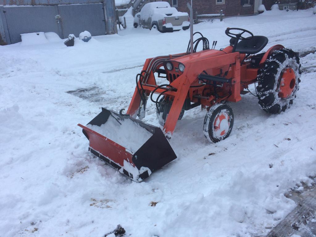

squonk 45,849 #22 Posted November 16, 2018 (edited) UPDATE:!!!!! Well I had to press the Power King into duty earlier than I planned on. A foot of concrete snow was a bit much for HHHOOOWWWAAARRRDDD!!! to handle and I haven't had time to mount the blower on the C160. This blade worked great. pushed and piled like crazy with no bending of the pins. Yes snow got behind the blade but it's in it's early stages. Edited November 16, 2018 by squonk 3 2 1 Share this post Link to post Share on other sites
rjg854 12,898 #23 Posted November 16, 2018 Glad to hear it worked for you, Mike. This snow storm surely was a good test. We generally don't get many storms like this lately. Share this post Link to post Share on other sites
AMC RULES 37,255 #24 Posted November 17, 2018 I'm thinking... the extra weight in the bucket is good thing. 1 Share this post Link to post Share on other sites
