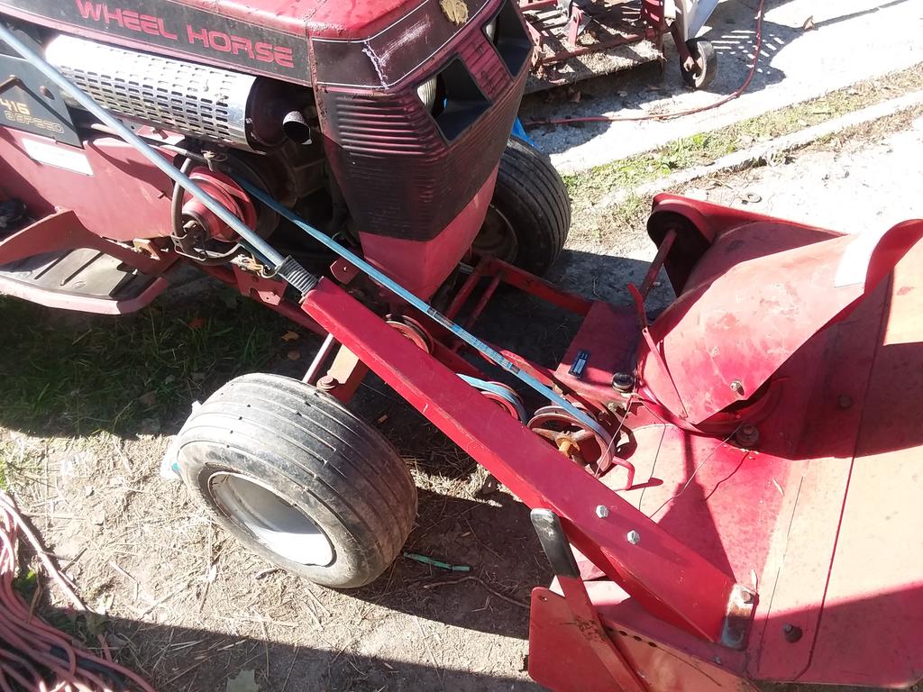

Shawnbige3 1 #1 Posted October 19, 2018 (edited) Finishing touch's on my project mounting a old (1972) single stage to my 416. Like a dope I unraveled the chute cable and having a he'll of a time trying to put it back together. Any help would be appreciated!! Edited October 19, 2018 by Shawnbige3 Share this post Link to post Share on other sites

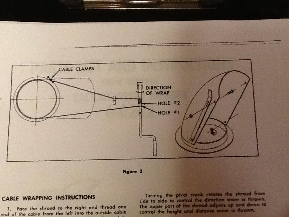

chris sutton 610 #2 Posted October 19, 2018 Not sure if this helps, I downloaded a manual for a snow thrower 6-9113 and this was in it, Im putting a blower together from a box of bits and havnt got as far as the cable yet so I will be watching your topic Share this post Link to post Share on other sites

Shawnbige3 1 #5 Posted October 19, 2018 Thanks for your help just joined not to familiar with things yet. I added a picture to the post. Share this post Link to post Share on other sites

gwest_ca-(File Mod) 12,361 #9 Posted October 20, 2018 6 hours ago, Shawnbige3 said: Thanks, where'd you download that from. Mine is a 6-6212 couldn't find a thing for it, even contacted Toro. I did same thing as you only mine wasn't apart. I had to shorten and do some drilling on the blower frame to get to attach to quick hitch. Click on the picture Garry 1 Share this post Link to post Share on other sites
gwest_ca-(File Mod) 12,361 #10 Posted October 20, 2018 Does you cable wrap around the crank rod as in the instuctions above or is there a spool on the rod for the cable? I think the instructions will be different for each. Garry 2 Share this post Link to post Share on other sites

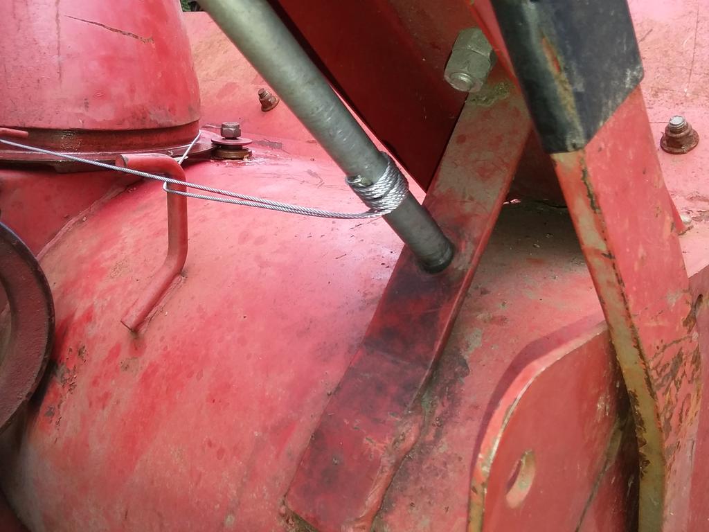

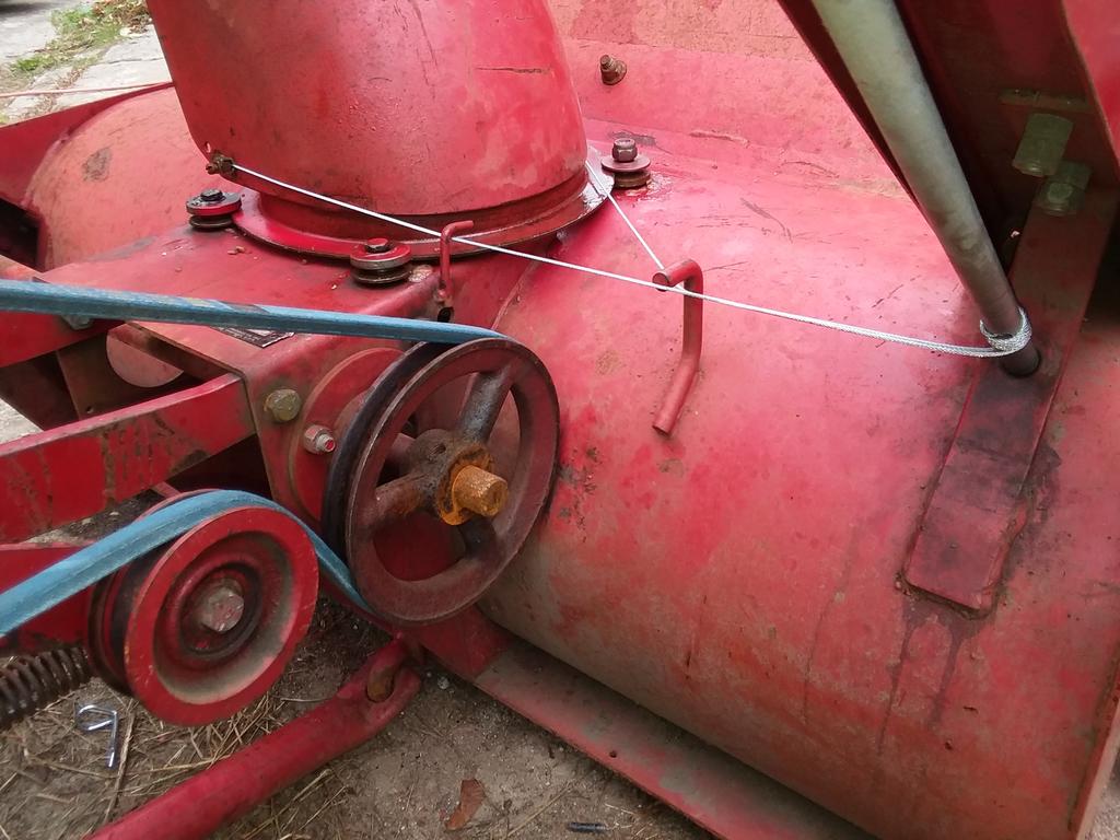

peter lena 9,945 #11 Posted October 20, 2018 yes this cable can bee confusing, I found using some fishing line, to initially ,route and function check this , makes your job easier. the line is more supple ,and cheaper than the 1/16" cable you will finally use. you can check and verify your chute scan easily, then just replace with cable. also replaced the cable clamp screw ends with , electrical brass lugs, much more solid. just drill out the pop rivets, and bolt on the brass lugs, do not forget to lubricate all slide areas , making for a smooth solid chute turn. I also threaded the top of chute turn rod, and screwed on a 1, 1/2" brass threaded ball , for easier use. pete Share this post Link to post Share on other sites
Shawnbige3 1 #12 Posted October 20, 2018 15 hours ago, gwest_ca said: Does you cable wrap around the crank rod as in the instuctions above or is there a spool on the rod for the cable? I think the instructions will be different for each. Garry It wraps around. Wasn't difficult with a little direction. Share this post Link to post Share on other sites
Shawnbige3 1 #13 Posted October 20, 2018 21 hours ago, chris sutton said: Not sure if this helps, I downloaded a manual for a snow thrower 6-9113 and this was in it, Im putting a blower together from a box of bits and havnt got as far as the cable yet so I will be watching your topic Directions were spot on. I left cable a little long in case the 7 wraps wasn't accurate but it was a perfect length. Share this post Link to post Share on other sites
