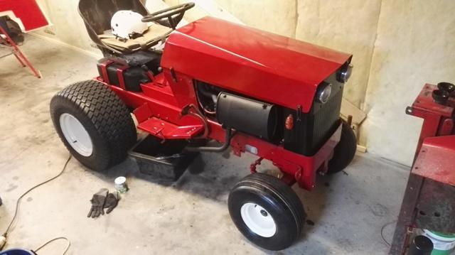

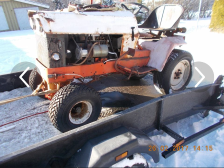

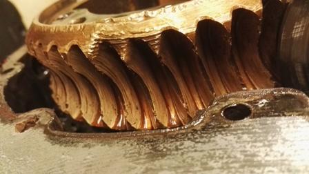

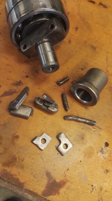

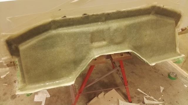

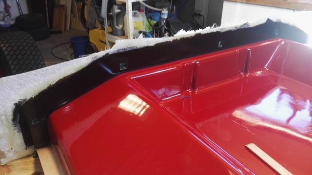

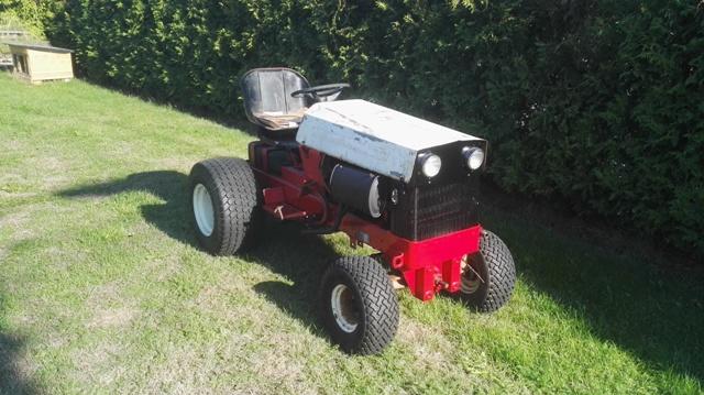

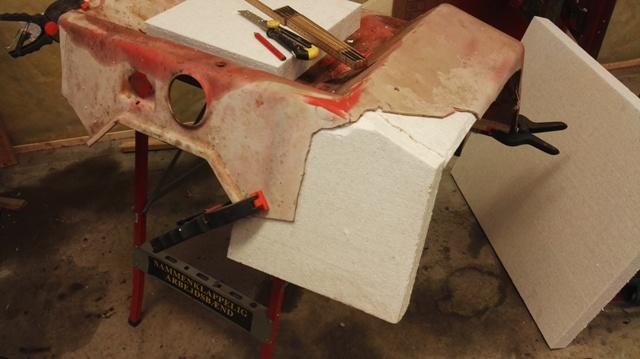

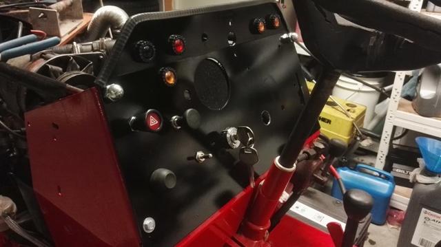

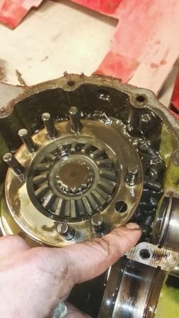

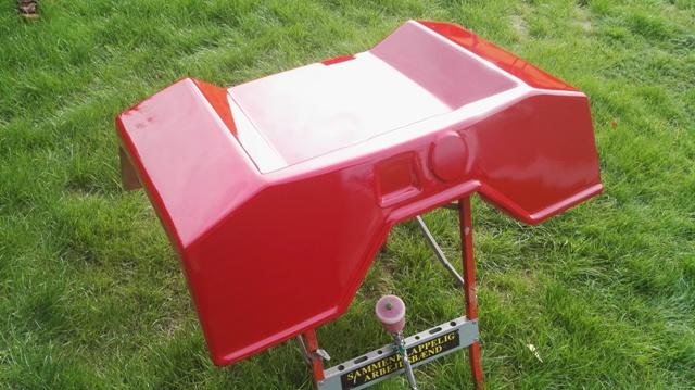

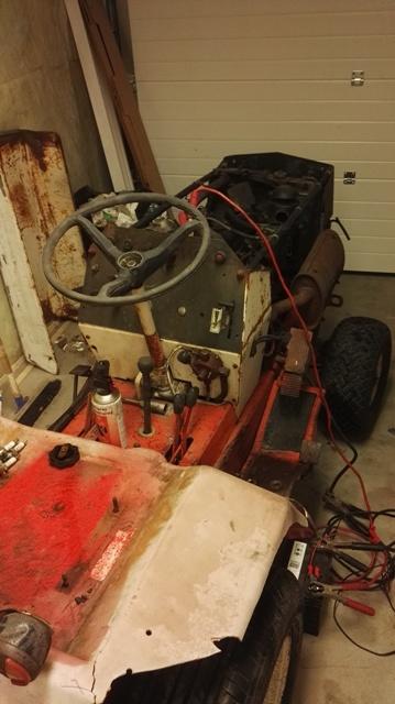

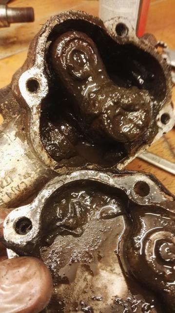

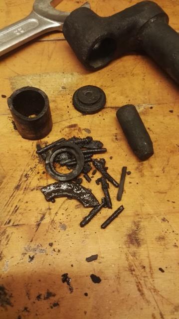

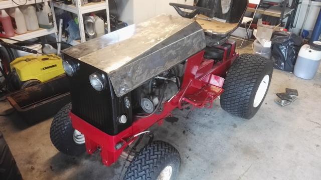

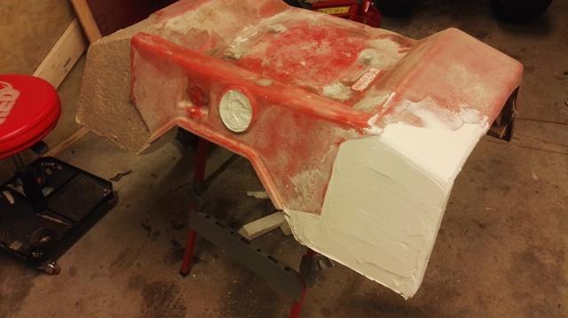

wh1054norway 30 #1 Posted October 19, 2018 Hello. One year ago I came across this abused but cheap Gutbrod 2500..... but immediately saw the potential for a vonversion to a D250. Much time and money has gone in to it, and I`m still not done. But I`l get there All the eigth bolts that holds the diff together was broken , but like a miracle the brass planetery gear was in one piece and no broke gears....some ugly wear, problaby from little and gunky oil, but it works. The ignition distributor was missing. Bought one from france....mounted it and it fired up. But after running it for a while, it was oil in the water and water in the oil Off with the cylinder head. It was bent like a banana, and previous owner had used the gasket over again Had the head milled down 0,4mm Back together with new gasket. Running fine, but now the oil was raising and smelled gas......gaspump was shot too. Engine was running nice, but there was something strange. The rpm got to high (Tractor was yet to be driven). Dismantled the gouvernor.....or whats left of it. Also the steering was pretty bad... First drive this summer with new rear wheels. Stripping some old paint to get ready for new I`m keeping the Gutbrod dash-style with the turnsignal and hazzard switch. Also gonna keep the turnsignal, cause I find them a bit cool. This is how it looks today. Painted hood and new tires in the front. Rear fenders where a mess. Built them up again so I could make a plug, to make a mold so I can cast a new one in fiberglas. this is how far I got, present time. I`ll have to rebuild the front Pto from a 6 splined to a axle with a keyway?? Cause I`m missing the the pulley mounted to the 6splined axle. Also the yokes in front I`m missing. found out that these are mouch easier to get with a standard 25mm bore and a keyway. If anyone know or can measure the outer diameter of the pulley mounted on the Pto axle I`ll appreciate that!!! I`m in the forum from time to time reading and watching all the nice tractors you have, and all the good work you are doing to them. My Suburban in weekly use. Here operated by my daugther. Love this little tractor Hope you enjoyed this reading. Best regards Christer 8 11 2 1 Share this post Link to post Share on other sites

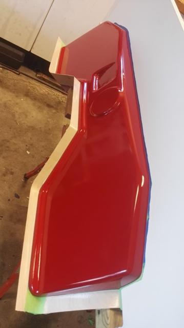

Pullstart 69,542 #2 Posted October 19, 2018 Christer, nice work you’re doing there! The fender molds are quite the work of art! I need to make it to Norway some day to visit an exchange student we had. How far from Oslo are you? Share this post Link to post Share on other sites
PeacemakerJack 10,917 #3 Posted October 19, 2018 Excellent Work Christer! I’m very impressed with all the fabrication and restoration work thus far, especially the fender pan. I also must admit that it can be hard to keep forging ahead when every time that you take a forward step in a given project, it feels like you have to take two steps back. It looks like you keep taking the challenges in stride though and already have a beautiful machine there. Please continue to post pics and details as you complete the project. I will definitely keep an eye on this one... Share this post Link to post Share on other sites

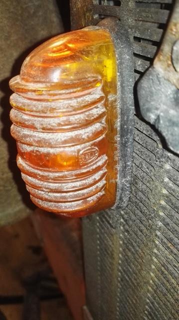

Tractorhead 9,217 #12 Posted October 19, 2018 (edited) Cool Project and well done. looks pretty in Red. Btw. The flash lights are still available, if you need spare from Hella. but they'r not cheap... Edited October 19, 2018 by Tractorhead Share this post Link to post Share on other sites

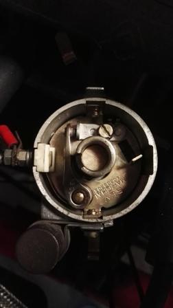

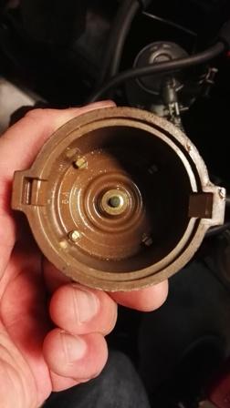

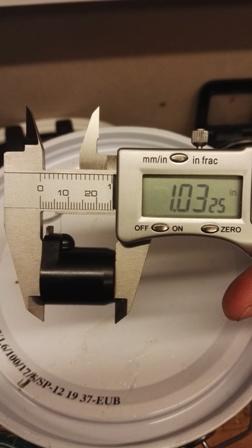

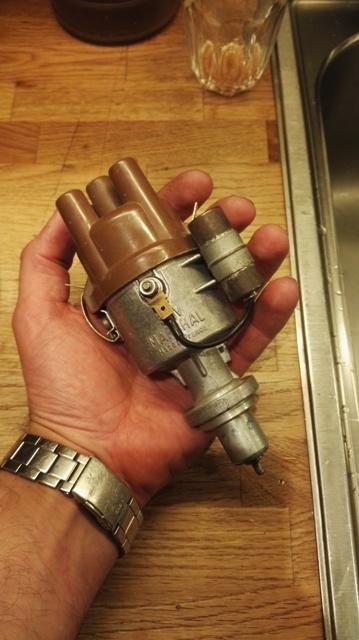

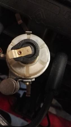

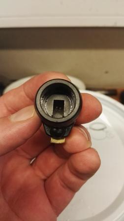

squonk 45,994 #14 Posted October 19, 2018 We have guys over here with the D250 looking for the distributor cap & rotor. I have a couple of part #'s That maybe correct. Can you post pictures of yours including the inside where they mount so I can compare them? Share this post Link to post Share on other sites

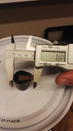

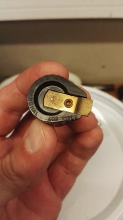

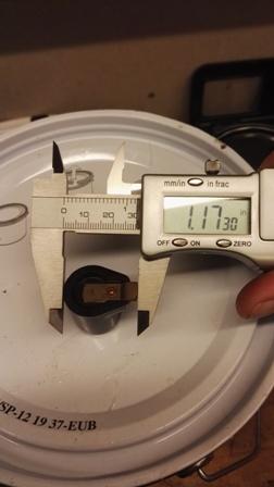

wh1054norway 30 #15 Posted October 21, 2018 On 10/20/2018 at 1:10 AM, squonk said: We have guys over here with the D250 looking for the distributor cap & rotor. I have a couple of part #'s That maybe correct. Can you post pictures of yours including the inside where they mount so I can compare them? Hi. If I understood you correctly,here are some pictures of the rotor. Hope this helps. Just let me know if this wasn`t what you ment and I`ll take some other photos. ebay France do have a lot of ignition stuff for these. https://www.ebay.fr/ Search for " Renault r4 allumeur" or "renault r6l allumeur" 2 Share this post Link to post Share on other sites
wh1054norway 30 #16 Posted October 21, 2018 On 10/19/2018 at 11:20 PM, elcamino/wheelhorse said: You are have placed a lot of work in the project. Are parts easy to find for your tractor? Most parts available is those on ebay in us. There are some on ebay Germany, but not much. For the most just whole tractors for sale........but to expensive and to far away. On 10/20/2018 at 12:04 AM, Tractorhead said: Cool Project and well done. looks pretty in Red. Btw. The flash lights are still available, if you need spare from Hella. but they'r not cheap... Have seen some in Germany and they want like 20-25$ and up........for one.....and almoste the same for shipping. I need one Share this post Link to post Share on other sites

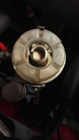

squonk 45,994 #17 Posted October 21, 2018 Thanks for the rotor pic. do you have a pic of the inside of the cap too? Share this post Link to post Share on other sites
Tractorhead 9,217 #18 Posted October 21, 2018 (edited) 24 minutes ago, wh1054norway said: Have seen some in Germany and they want like 20-25$ and up........for one.....and almoste the same for shipping. I need one Let me find out, what i can do for shipping, if it helps. but depends few day's, i will ask in my Company, if we are able to do. Gutbrod By the way, as far as i know, several of the Engine come from Renault. maybe this is the reason, you fund a lot of Renault parts, that fits. Edited October 21, 2018 by Tractorhead Share this post Link to post Share on other sites
wh1054norway 30 #19 Posted October 21, 2018 6 minutes ago, squonk said: Thanks for the rotor pic. do you have a pic of the inside of the cap too? Sure Share this post Link to post Share on other sites
squonk 45,994 #20 Posted October 21, 2018 Thanks. I'm going to go through my Napa electrical book to see If I can match them. 1 Share this post Link to post Share on other sites

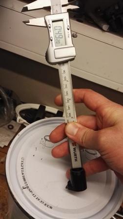

Marv 994 #24 Posted November 29, 2018 On 10/19/2018 at 6:37 AM, wh1054norway said: If anyone know or can measure the outer diameter of the pulley mounted on the Pto axle I`ll appreciate that!!! The Outer Diameter is 7 13/16 inches. You are doing great work. Marv Share this post Link to post Share on other sites
