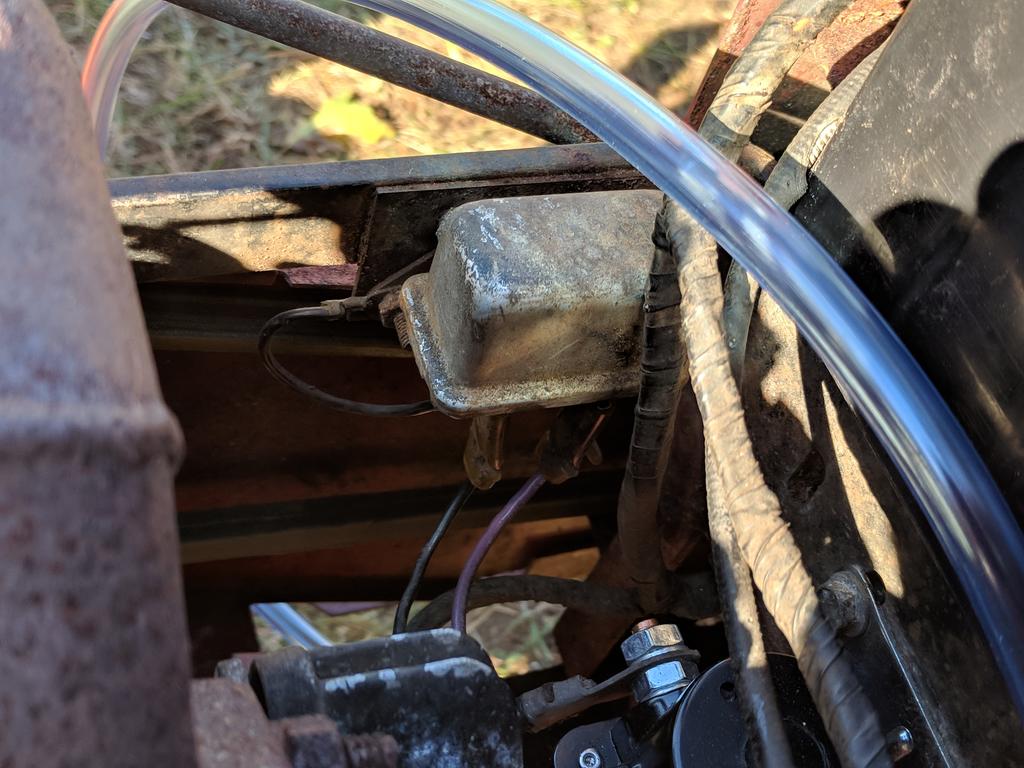

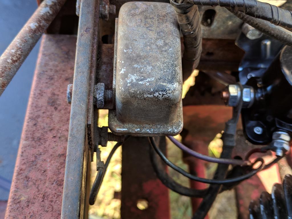

WildmanC120 613 #5 Posted October 19, 2018 Thank you for the diagrams. I did not get a chance to look into this yet. I spent the better part of the day getting the carb back on, fuel line buttoned up and the engine shroud etc back on. I also had another headlight lens that was not busted I installed. Even though its not the correct one, it is way better then the one that was one there since it was busted to pieces. Is this the relay you guys are talking about? Share this post Link to post Share on other sites
gwest_ca-(File Mod) 12,276 #6 Posted October 19, 2018 That should be the one. Garry Share this post Link to post Share on other sites
