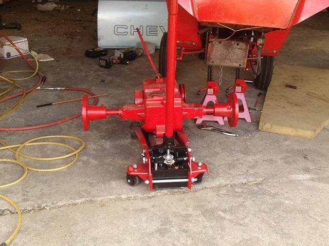

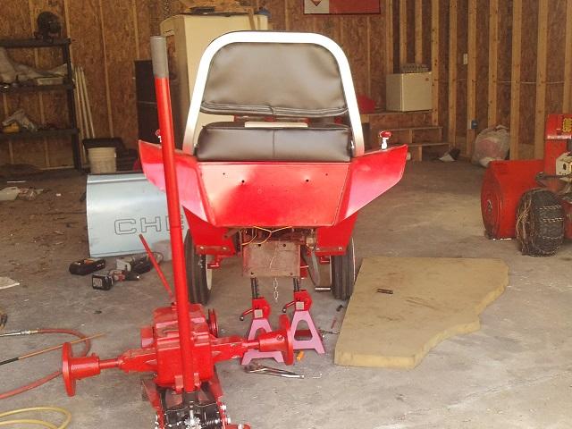

TravelinJavelin 621 #1 Posted October 17, 2018 (edited) well hopefully 3rd time the charm got gears from ebay and i hope its something simple locked into 2 and reverse i think and won't come back out.....i think what has happened is the 2 ball bearings and pin and spring assembly came undone inside and something got lodged or i believe anyways also when we opened it up before we painted it to change the casee gasket we noticed things that wern't going good like on the bull gear the four bolts well the heads were chewed up a bit and the pin and spring assembly with the 2 ball bearings well 1 was missing but the bevel gears themselves luckily looked in great shape so i have a friend of mine that has tinkered close to 45 years specializes in john deere and old fordson tractor stuff, but is doing firewood at the moment so i got to wait another month when he's done with that......so here it is pulled out so far........ couldn't help myself playing with the lights for a minute or too Edited October 17, 2018 by TravelinJavelin 3 Share this post Link to post Share on other sites

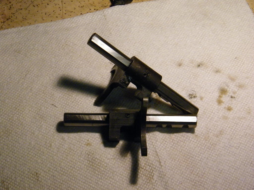

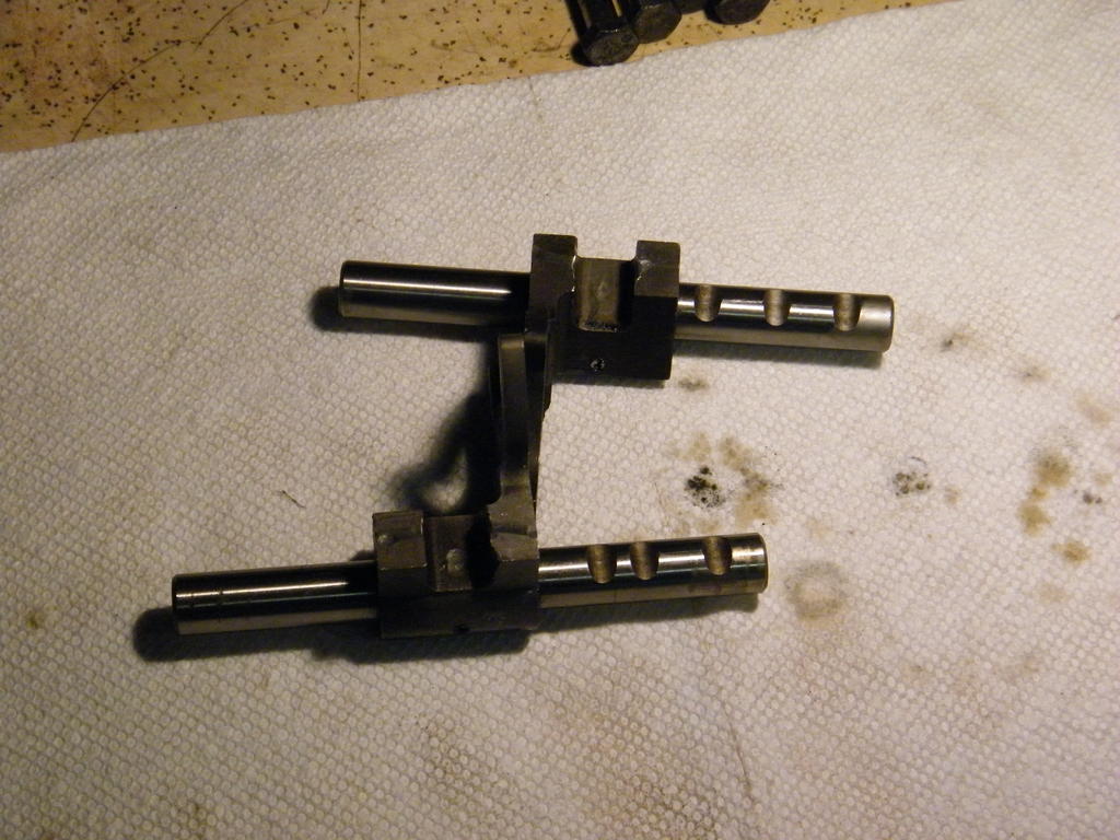

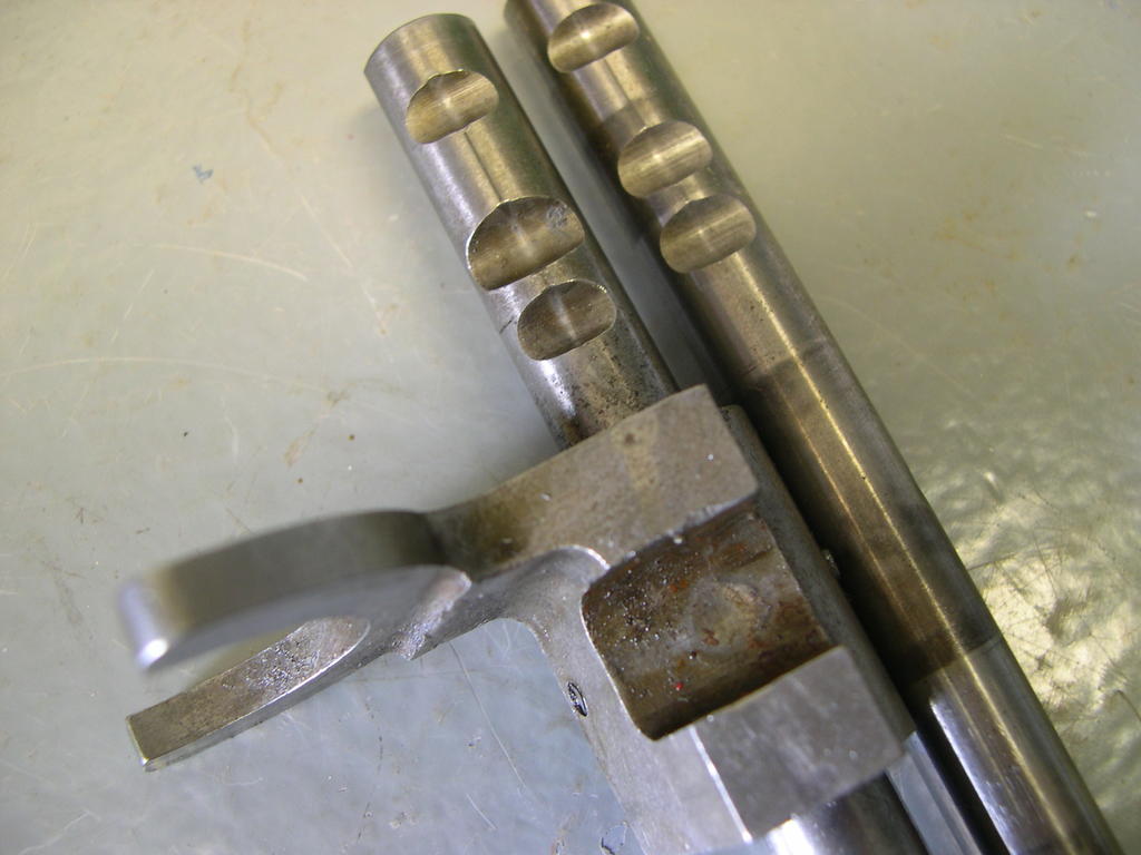

Racinbob 12,831 #19 Posted October 18, 2018 The problem is almost certainly with the shift rails. The suction issue as Steve said was a problem that Wheel Horse came out with a service bulletin instructing people to use 40wt in hopes to minimize it. Shortly after that they added the flat. Their next step was to make the center neutral detent deeper and use a 3/4" stop pin in lieu of the 11/16". This forced one of the rails to be in the neutral position at all times. The first revised rail was like the one on the left here: Then they made the detents go all the way around like this: That was done for manufacturing purposes as the rails don't rotate at all. You could find a set of newer rails. They all interchange. The spring and balls are the same. Only the stop pin is different. They can be used in any combination with the 11/16" pin but the 3/4" pin requires the newer rails. 2 4 Share this post Link to post Share on other sites
TravelinJavelin 621 #20 Posted October 18, 2018 stupid question the 3/4" stop pin the same length as the 11/16" and will i have to get a bigger diameter spring for 3/4" pin? Share this post Link to post Share on other sites
Racinbob 12,831 #21 Posted October 18, 2018 You use the same spring. The idea is that the extra 1/16" in the stop pin length requires one of the balls to be in the deeper neutral detent. Share this post Link to post Share on other sites

stevasaurus 23,628 #24 Posted October 18, 2018 Reading what you say happened, I am positive you are missing at least 1 detente ball. The trans shifted OK at first, with just the spring reaching into the groove of a shift rail. Then the spring, either got bent or snapped off enough to have nothing reach into a groove. Without that resistance, the shift rail could move around just from vibration and lock up your trans. That one detente ball is also still in your trans someplace. I would guess it is in the hole underneath one of the shift rails...which would keep the shift rail from being fully engaged in gear. You are going to have to drop and open your trans to fix the problem. The detente balls are just 1/4" ball bearings...ACE, TSC have these. The stop should be fine. I think the spring is still available from TORO. This video shows putting the detente parts together. 3 Share this post Link to post Share on other sites
TravelinJavelin 621 #25 Posted October 18, 2018 yeah i've been watching your vids for hours trying to grasp got to get my garage set up to it just my concern is with the axles wit the C clip in the roll pins in its place is that a good thing or bad thing? Share this post Link to post Share on other sites
