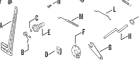

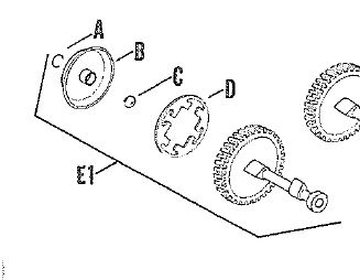

rmaynard 17,642 #5 Posted October 17, 2018 (edited) Attached to the back side of the camshaft gear is a retainer (D), 4 balls (C), and a thrust bushing (B). As the speed increased, the balls would move outward by centrifugal force causing the thrust bushing (B) to push against the governor shaft (H), rotating it slightly, causing the governor lever (A) on the outside of the engine to move. Hope that helps. Chances are your balls have come out of their retainer and fallen to the bottom of the oil pan. Edited October 17, 2018 by rmaynard added more context Share this post Link to post Share on other sites
KC8CST 0 #6 Posted October 17, 2018 1 hour ago, rmaynard said: Attached to the back side of the camshaft gear is a retainer (D), 4 balls (C), and a thrust bushing (B). As the speed increased, the balls would move outward by centrifugal force causing the thrust bushing (B) to push against the governor shaft (H), rotating it slightly, causing the governor lever (A) on the outside of the engine to move. Hope that helps. Chances are your balls have come out of their retainer and fallen to the bottom of the oil pan. That's exactly what I was looking for. Thank you for the explanation. Looks like I will be pulling it apart to see what is missing or out of place. Share this post Link to post Share on other sites
