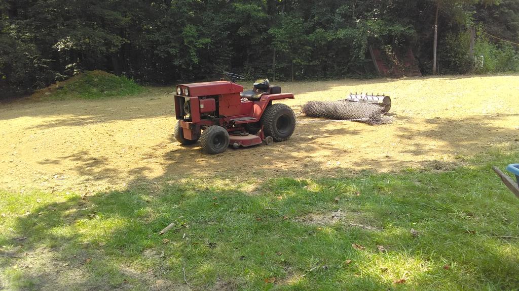

insertnamehere987 4 #6 Posted October 16, 2018 (edited) Not losing any strength on spark and adjusted the idle air screw to stock. It was turned way in (Walbro carb with non adjustable main). Ran much better but noticed I have a carb full of gas when I shut it off. Thinking the float is stuck now. Edit: File this one under the idiot attack problem. Somehow or another I never noticed the fuel still in the carb. Took it off, cleaned it thoroughly and we seem to be back to wheeling. Thought I'd add a pic of her at work from this summer for y'all. Thanks for the help. Edited October 16, 2018 by insertnamehere987 1 Share this post Link to post Share on other sites
