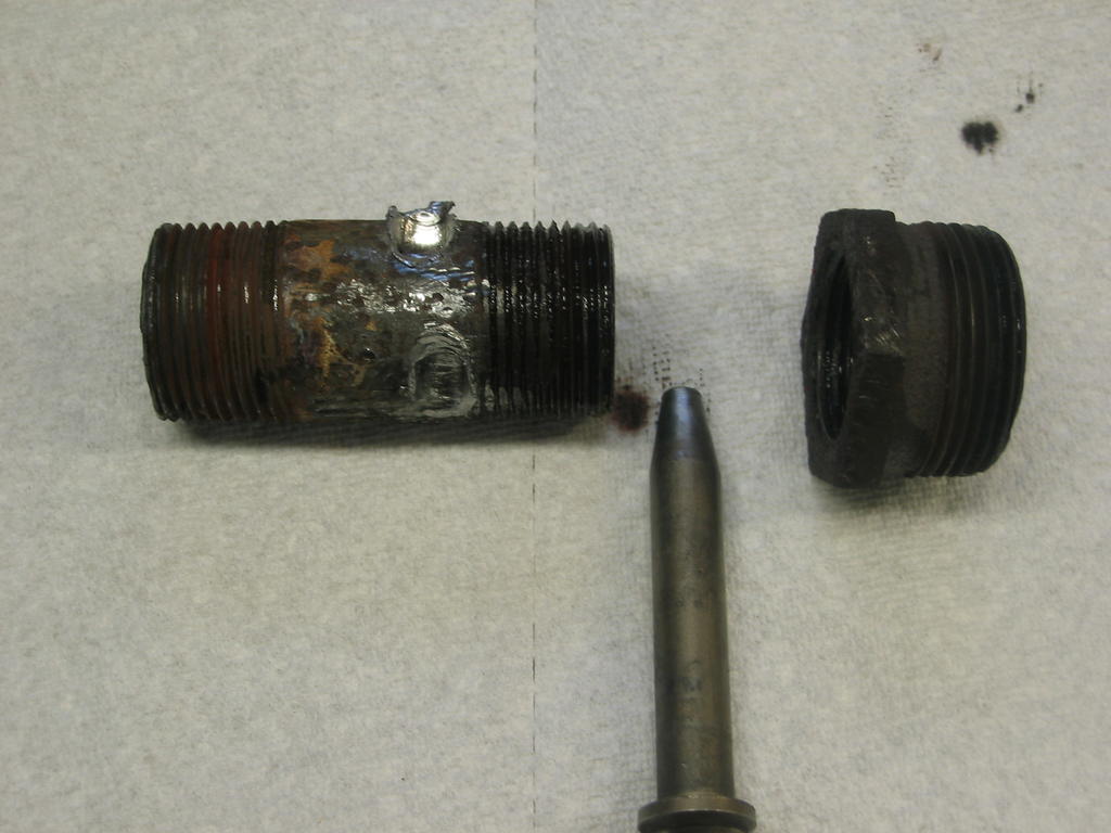

pfrederi 21,184 #1 Posted October 15, 2018 There are several thread on here about removing exhaust nipples. I had my second and unexpected success today removing the nipple for a 16hp K single. I am stripping it so it can go to the machine shop. The 16hp K's use a reduction bushing in addition to the nipple. I only planned on removing the nipple and leaving the bushing in place as I figured the machine shop could work around it and i figured also it would be a bear to get out and maybe damage the block in the process. Thus I treated the nipple threads with PB Blaster, Kroil and In-Force over a few days. Whacked it with a hammer every time I walked by. Used propane torch but no movement Dug out the air chisel and the blunt point tip. Pounded a divot in the pipe then angled the chisel against the side of the divot. Low and behold the nipple started to turn. Had to make a second divot to keep an good angle as it moved. Then it stopped, Darn..some more chiseling an suddenly the reduction bushing backed out of the block.. i hadn't soaked its threads but it came!! In a vice finally separated the nipple and bushing. Nipple is destroyed but the bushing can be reused. 9 1 1 Share this post Link to post Share on other sites
