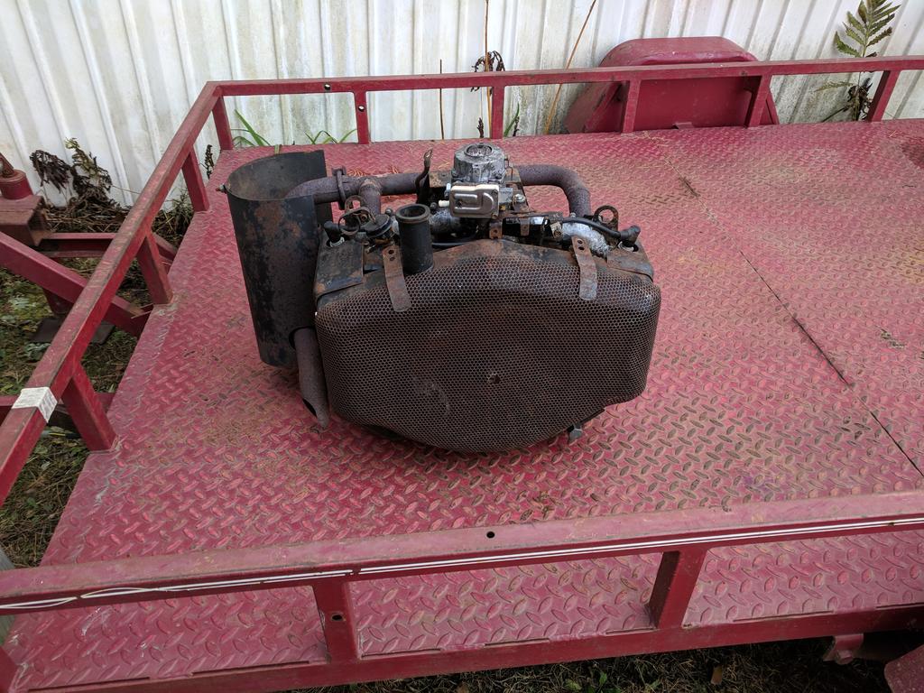

WildmanC120 613 #27 Posted October 21, 2018 46 minutes ago, c-series don said: I would say if you pulled the plugs already fill the cylinders with Marvel Mystery oil and let it sit for a day or two. Then try to bump it over with a wrench. I can't be bothered with it. I need something I can depend on for this winter. I'm either gonna repower it or dump it. Share this post Link to post Share on other sites
WildmanC120 613 #28 Posted October 21, 2018 46 minutes ago, c-series don said: I would say if you pulled the plugs already fill the cylinders with Marvel Mystery oil and let it sit for a day or two. Then try to bump it over with a wrench. I can't be bothered with it. I need something I can depend on for this winter. I'm either gonna repower it or dump it. Share this post Link to post Share on other sites

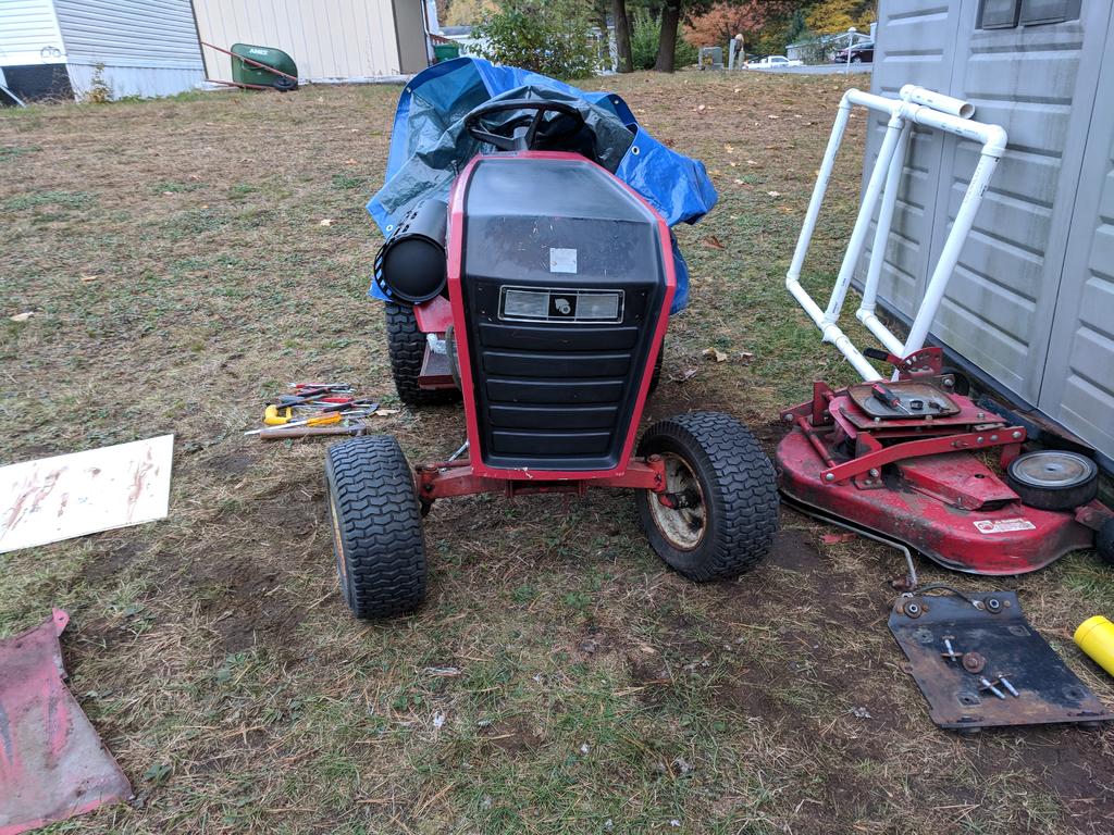

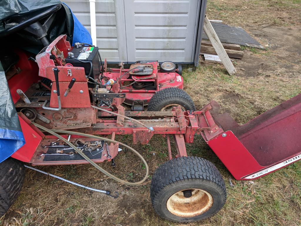

WildmanC120 613 #37 Posted October 24, 2018 And so it begins.... 2 Share this post Link to post Share on other sites

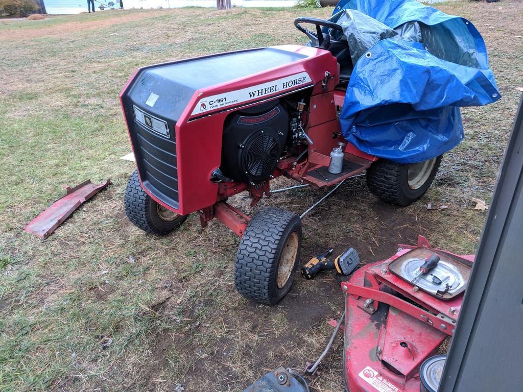

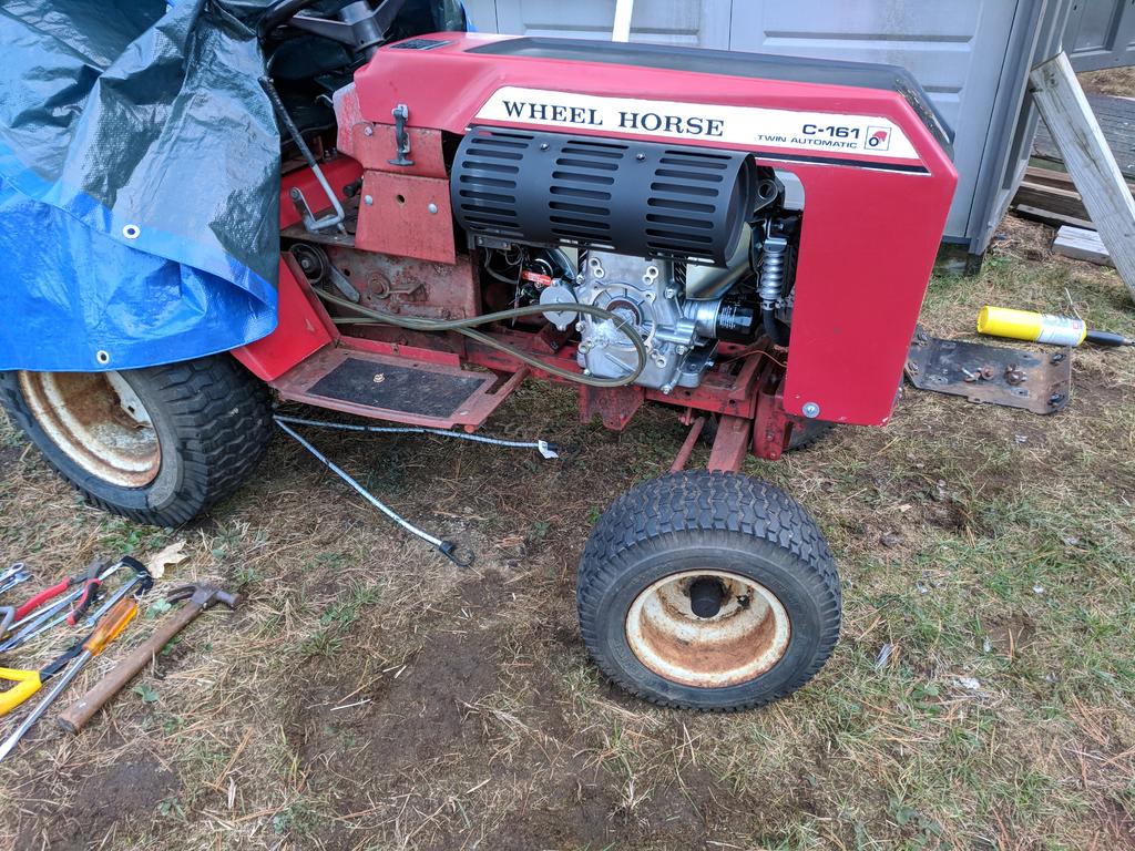

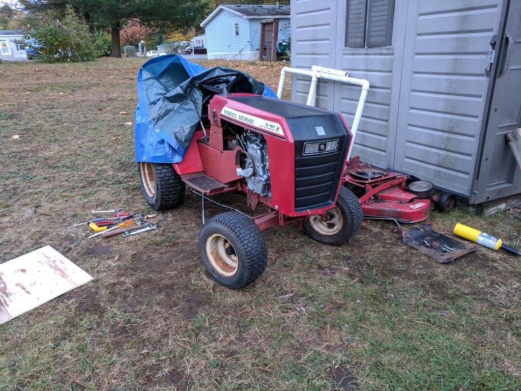

WildmanC120 613 #42 Posted October 24, 2018 Well there is my progress so far. I was hoping to mount it to the same plate the briggs was on but that will not work as then the engine is too tall and the hood will not fully close. Also the stock exhaust will need to be modified. The muffler outlet points toward the operator so that's not very good. Also the pipes will need to be either extended a little or rolled down as the hood hits the muffler. 1 Share this post Link to post Share on other sites
Pullstart 69,607 #43 Posted October 26, 2018 On 10/24/2018 at 6:11 PM, WildmanC120 said: Well there is my progress so far. I was hoping to mount it to the same plate the briggs was on but that will not work as then the engine is too tall and the hood will not fully close. Also the stock exhaust will need to be modified. The muffler outlet points toward the operator so that's not very good. Also the pipes will need to be either extended a little or rolled down as the hood hits the muffler. Good to see you are working through instead of dumping the tractor! I have that engine on my wood splitter, it’s a beast but do yourself a favor and install a fuel shut off if you haven’t already. My crankcase fills with fuel after sitting a while and the fuel tank is level with the engine. also, if you have a welder, a cheap but effective way to accomplish re-routing the exhaust is look for a cheap set of v8 headers on Craigslist or eBay... and they have a ton of special bends you can cut apart and use to put the spent gas about anywhere you’d like. 1 Share this post Link to post Share on other sites
