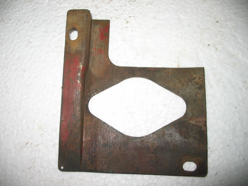

71_Bronco 1,072 #1 Posted October 12, 2018 When taking apart my K321, I pulled off 3 sheet-metal pieces to tear it down. I had one over the flywheel, one covering about half of the head, and one on the starter side. I was poking around online, and it looks like I am missing the sheet-metal that goes around the carburetor. It's the piece in the bottom left corner in the pic below. Does this piece do anything? Or am I fine running without it? Share this post Link to post Share on other sites
clueless 3,427 #2 Posted October 12, 2018 It helps with cooling the engine, I wouldn't run it with out it, at least not for more than a minute or two. Share this post Link to post Share on other sites
pfrederi 20,895 #3 Posted October 12, 2018 Since it costs money to make and install those covers i doubt Kohler did it if they weren't needed Share this post Link to post Share on other sites
daveoman1966 3,884 #4 Posted October 12, 2018 I have that cover plate.....pm sent. 1 Share this post Link to post Share on other sites
ebinmaine 79,740 #5 Posted October 12, 2018 As stated above. It really should be on there. Dave'll take care of you..... Share this post Link to post Share on other sites
daveoman1966 3,884 #6 Posted October 12, 2018 Here's that cover plate... not bent or beat up... I'll let YOU make it PRETTY... 1 Share this post Link to post Share on other sites
