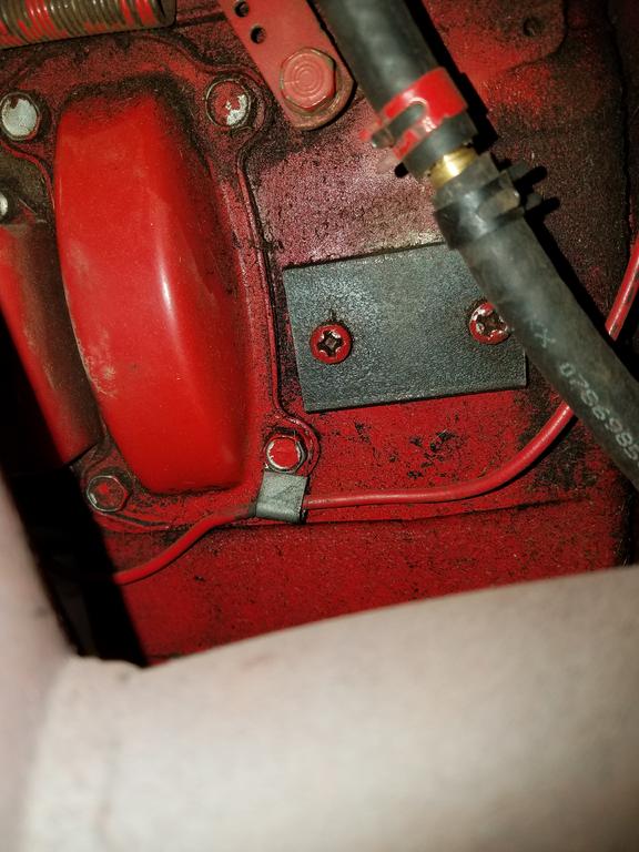

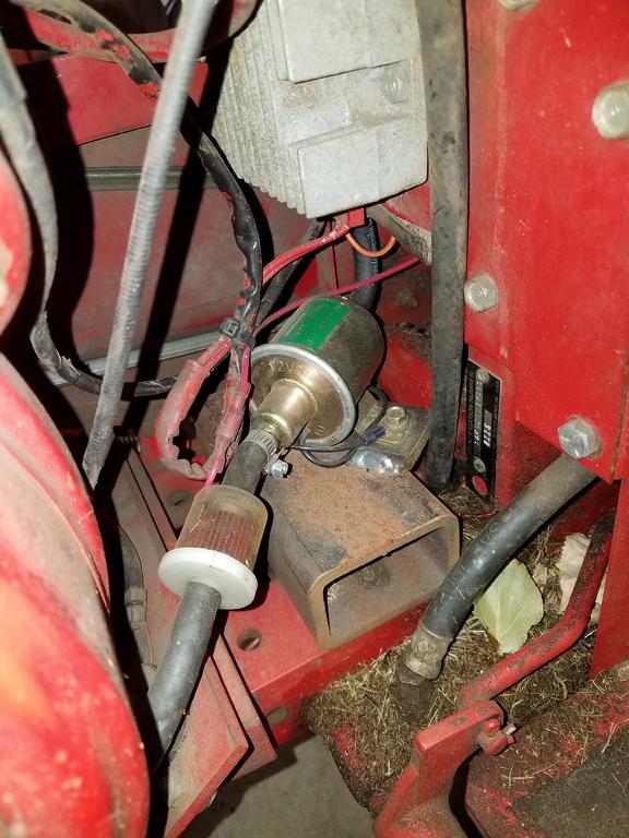

moe1965 774 #2 Posted October 11, 2018 Red wire is positive psi might be border line to much mine is below 4 psi. I'll send pix tomorrow evening for where I mounted it the tractor it is at my dad's house. You will have to make a plate to cover the existing pump mounting if you are getting rid of the existing mechanical pump 1 Share this post Link to post Share on other sites
pfrederi 20,895 #3 Posted October 12, 2018 pumps push better than they suck. Mount it back near the tank. I haven't put am e;electric on my D200 but i have on several other WHs I run it off the A terminal of the switch.. Doesn't pump while cranking but when i turn the switch on and i wait a couple seconds for the pump to build up pressure (you can hear the change) and then they start right up. 2 1 Share this post Link to post Share on other sites
moe1965 774 #4 Posted October 12, 2018 (edited) Sorry Trevor this will probably not be much help but I included pix just in case mounting could be of some help. Probably not because of different engine types. Edited October 12, 2018 by moe1965 Added pix Share this post Link to post Share on other sites
