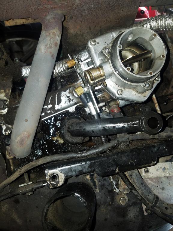

Schrec050584 2 #1 Posted October 11, 2018 Does anyone know the kit to rebuild my carb or could i get a new one? My tractor surges and i think the carb needs fixed or rebuilt. Any info is appreciated. Share this post Link to post Share on other sites

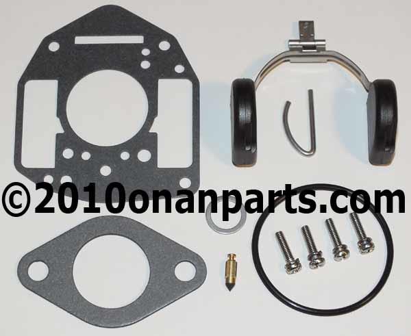

onanparts.com 185 #4 Posted October 11, 2018 2 hours ago, Schrec050584 said: Does anyone know the kit to rebuild my carb or could i get a new one? My tractor surges and i think the carb needs fixed or rebuilt. Any info is appreciated. Kurt's suggestions are spot on. The main problem is if the top cover float bowl gasket gets torn up during removal. After nearly 30 years that's a good possibility. If it comes off intact you might luck out! If not the basic carb repair kit is under $50 and we keep those in stock. Part number is 146-0657. New carbs are also available but rarely required. Part number is 146-0496 If a thorough carb cleaning does not cure the surging, a leaking intake manifold would be the next thing to investigate. This is what comes in the basic kit. 3 Share this post Link to post Share on other sites
Schrec050584 2 #5 Posted October 13, 2018 I got oil here. What is the tub that goes from engine to air cleaner? Is it a breather? Cleaned carb still surges some but i tightened a intake bolt towards the front of the motor. Share this post Link to post Share on other sites

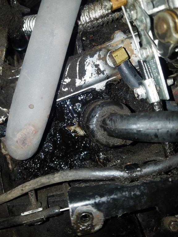

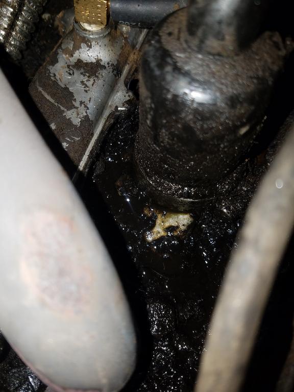

Schrec050584 2 #7 Posted October 13, 2018 Is that oil a something that is suppose to happen because it makes it way into air filter some. Also checked compression and front is 90psi and rear is 110psi. Share this post Link to post Share on other sites
lynnmor 8,268 #8 Posted October 13, 2018 I guess that there was a significant amount of oil inside the air filter. If the rubber parts are in good condition, that oil might be caused by too much blow-by, in other words rings or cylinder walls are compromised. While 90 PSI isn't terrible, I would still pull that head and have a look. It is probably way overdue for a decarbon anyway. I have had higher compression and found a loose valve seat, and 75 PSI caused by minor valve wear. A compression test is always good, but it can't tell you everything. Share this post Link to post Share on other sites

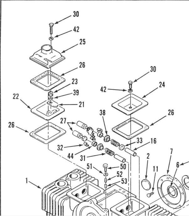

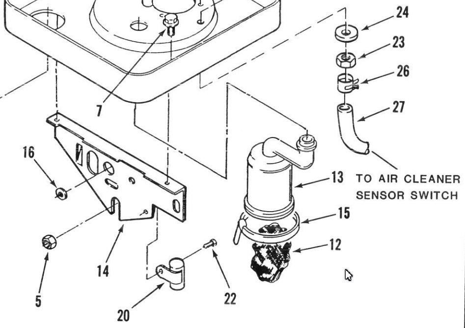

Kurt-NEPA 756 #9 Posted October 13, 2018 At the base of that hose is a chamber with a reed valve in it. I would check to make sure that is in good shape. Reed valve is number 21, Chamber cover is number 25. Above the chamber is mesh filter number 12. I would remove that filter and make sure it is clean. Share this post Link to post Share on other sites
