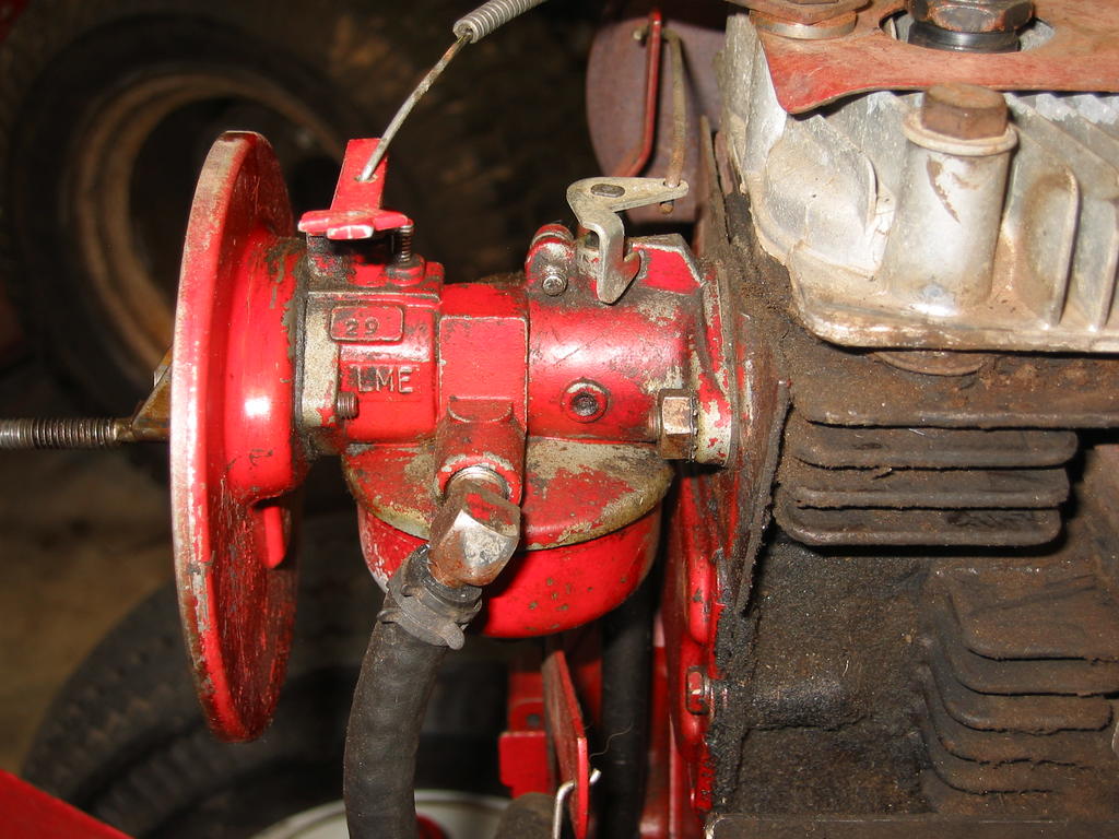

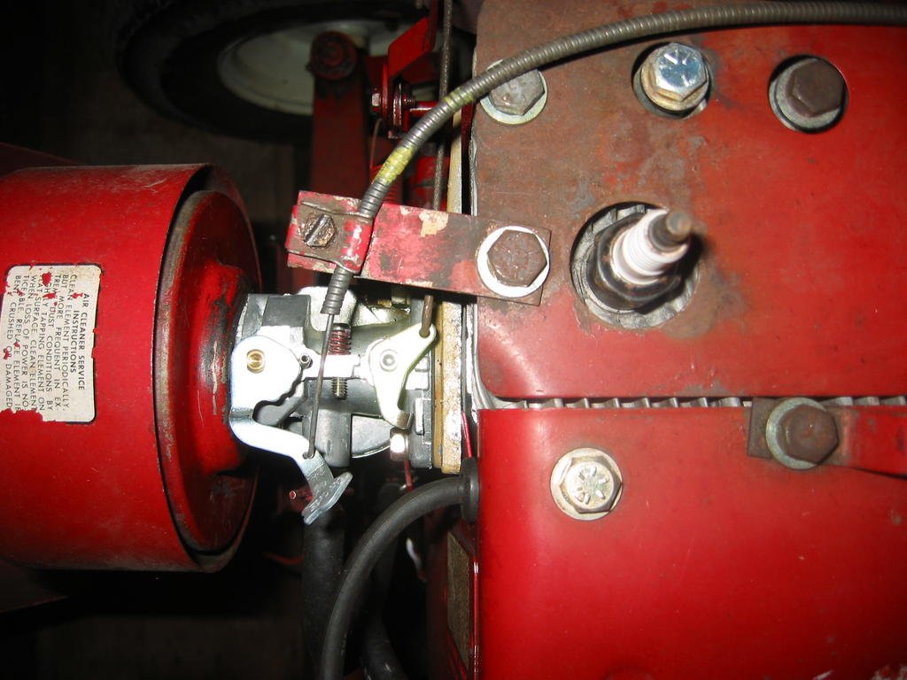

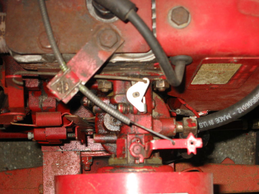

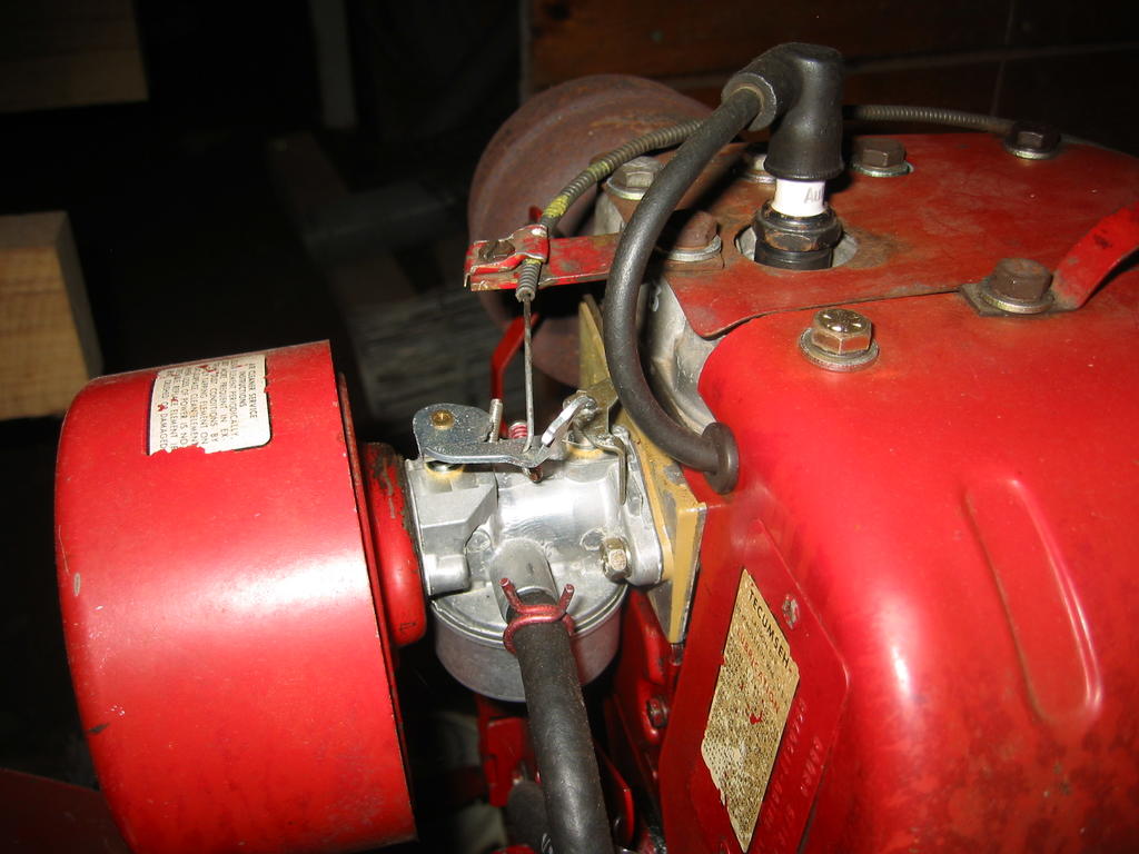

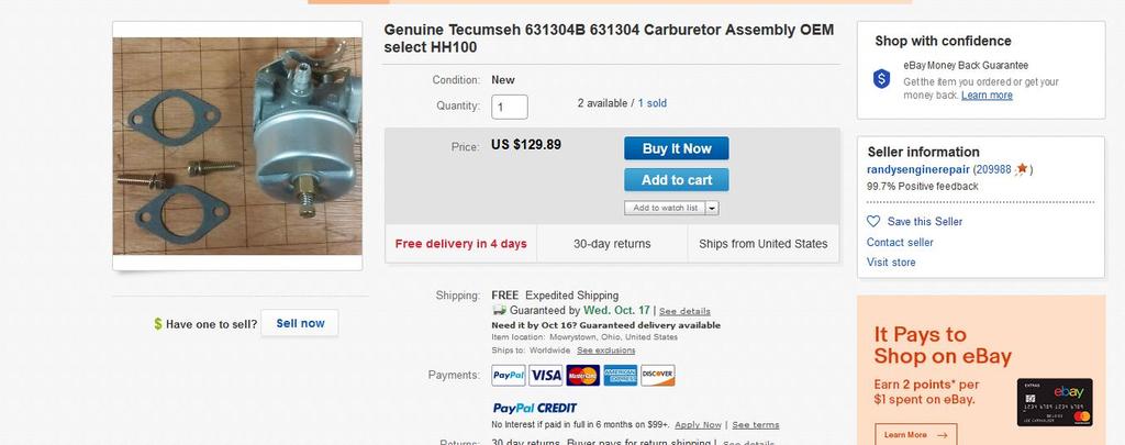

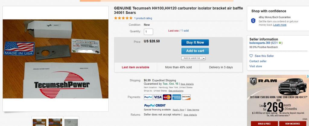

pfrederi 20,895 #2 Posted October 11, 2018 (edited) I bought a new replacement carb for my HH10 last year Was $100 now $130. These replacement carbs have a shorter body than the original LME 29. I also had to get a thick mounting plate otherwise the throttle linkage hit the block. (got mine used last year for $10). Will get some pics of the set up on the tractor later. Edit; Note the thin mounting plate on the original (red) carb. See the thicker one on the new carb. Edited October 11, 2018 by pfrederi 1 1 Share this post Link to post Share on other sites
War_horse86 5 #3 Posted October 11, 2018 4 hours ago, pfrederi said: I bought a new replacement carb for my HH10 last year Was $100 now $130. These replacement carbs have a shorter body than the original LME 29. I also had to get a thick mounting plate otherwise the throttle linkage hit the block. (got mine used last year for $10). Will get some pics of the set up on the tractor later. Edit; Note the thin mounting plate on the original (red) carb. See the thicker one on the new carb. Thanks for the advice! Share this post Link to post Share on other sites
