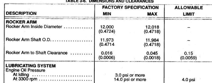

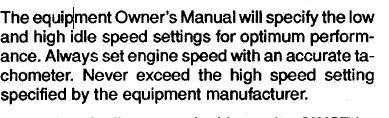

WHX?? 56,847 #4 Posted October 10, 2018 (edited) These are pressure fed motors Richard. 1850 is way too high & gotta be a typo. I did not see it in this manual but I didn't read the whole thing 492-4714 Onan E125V & E140V SM.pdf But here Is out of that manual This is in the same manual There is also a way to check the oil pressure on these engines. I would set the idle at 850 rpm and check the pressure. Edited October 10, 2018 by WHX21 Share this post Link to post Share on other sites
Tractorhead 9,217 #5 Posted October 10, 2018 (edited) 1 hour ago, WHX21 said: These are pressure fed motors Richard. 1850 is way too high & gotta be a typo. I did not see it in this manual but I didn't read the whole thing 492-4714 Onan E125V & E140V SM.pdf But here Is out of that manual This is in the same manual There is also a way to check the oil pressure on these engines. I would set the idle at 850 rpm and check the pressure. Hi, i read the same Manual, but i didn't read the last quote. maybe i am to tired, it's late.... *g* otherwise i think i need 🤓 😂 to measure the Oilpressure while slowdown the idle, is a real good Idea. thanks for Stefan. Edited October 10, 2018 by Tractorhead Share this post Link to post Share on other sites
