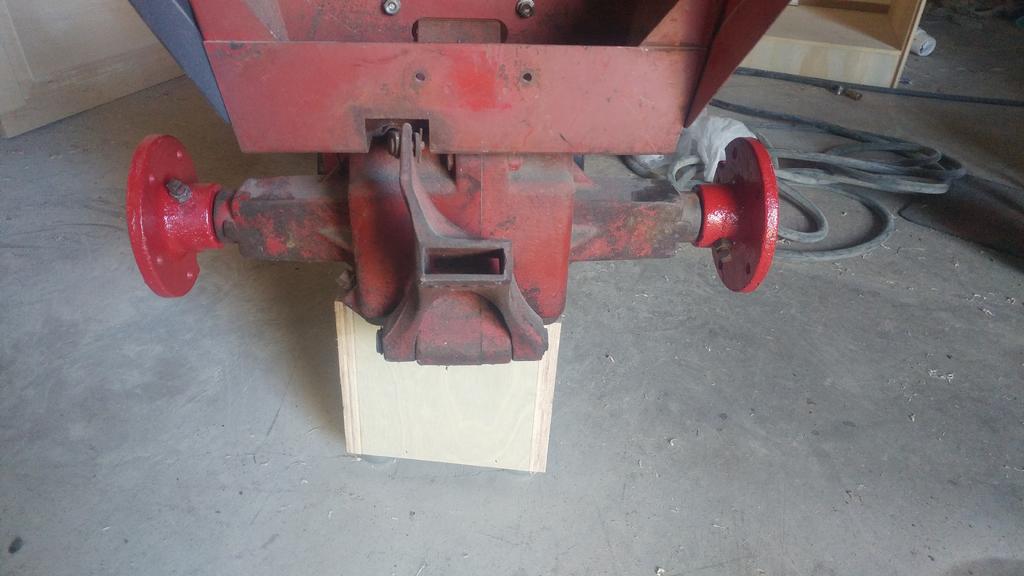

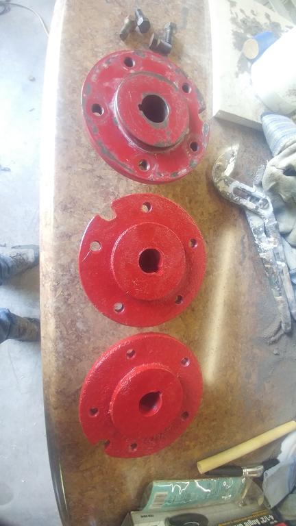

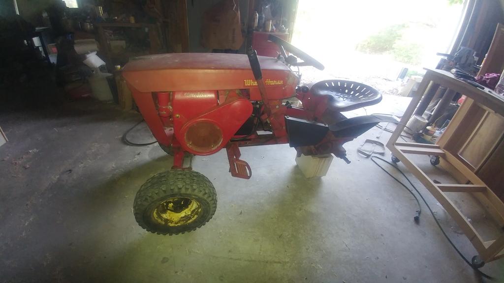

C&W 77 #1 Posted October 10, 2018 Well to start off with ,I brought home a 1045 in pieces some months back,and started assembling it last week .turns out my rear hubs where not in the pile lol. Im sure there still at my buddies place on the rims .being that is 500 miles im going to make a set to get me by till i make it back up there So I will post so pics of the progress in the days to come .I will be using a C series hub from my 120 as pattern for this project ,it's not like the 1045 hubs would look like but will get me by till I get the original ones back one day Will be making from Extruded aluminum as its better grade .I probably could make then out of cast iron but the aluminum will go alot faster and be easier for me bore right now well hopefully so stay tuned if you interested pic of the 1045 waiting on hubs 6 Share this post Link to post Share on other sites

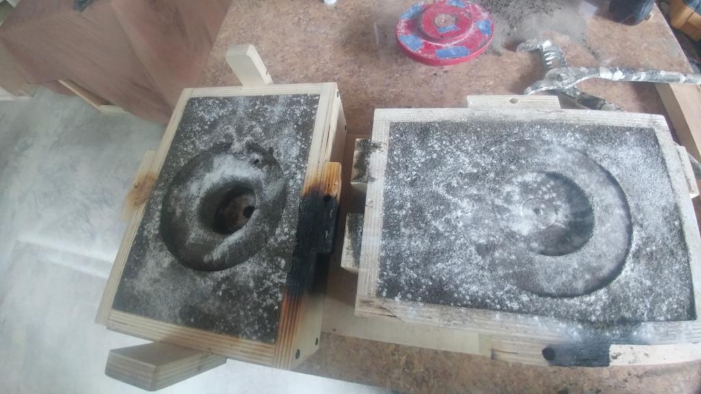

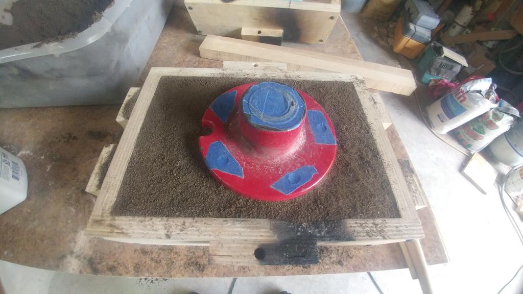

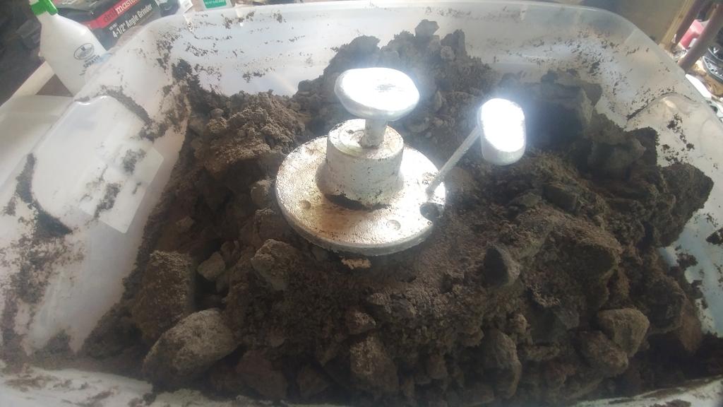

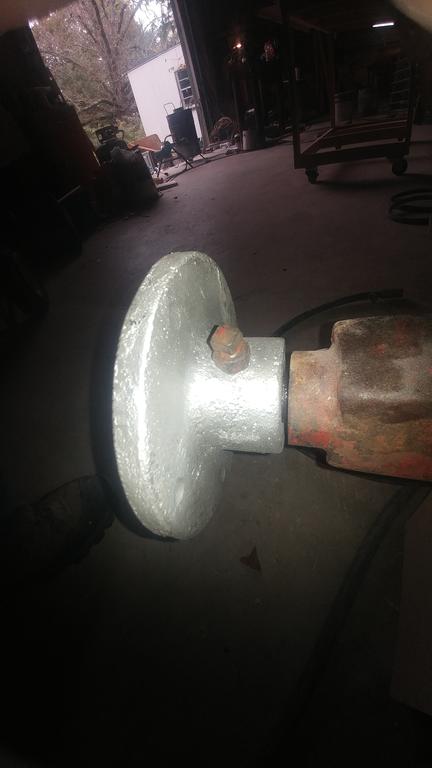

C&W 77 #9 Posted October 10, 2018 Here you guys few of the steps this morning got it keyed and bolted to tractor still need to pour other hub and drill and tap lug holes Buying would take all the fun out of this project. Started around 8 central time 2 2 Share this post Link to post Share on other sites

C&W 77 #12 Posted October 10, 2018 Yeah thats what im thinking as long as stay off the free way haha and not cutting ditches actually it is a good tight fit and might hold up longer than we all think I dont have a machine shop just old drill press so key way by hand with a file now that was fun been playing with casting for little while it's fun 1 Share this post Link to post Share on other sites

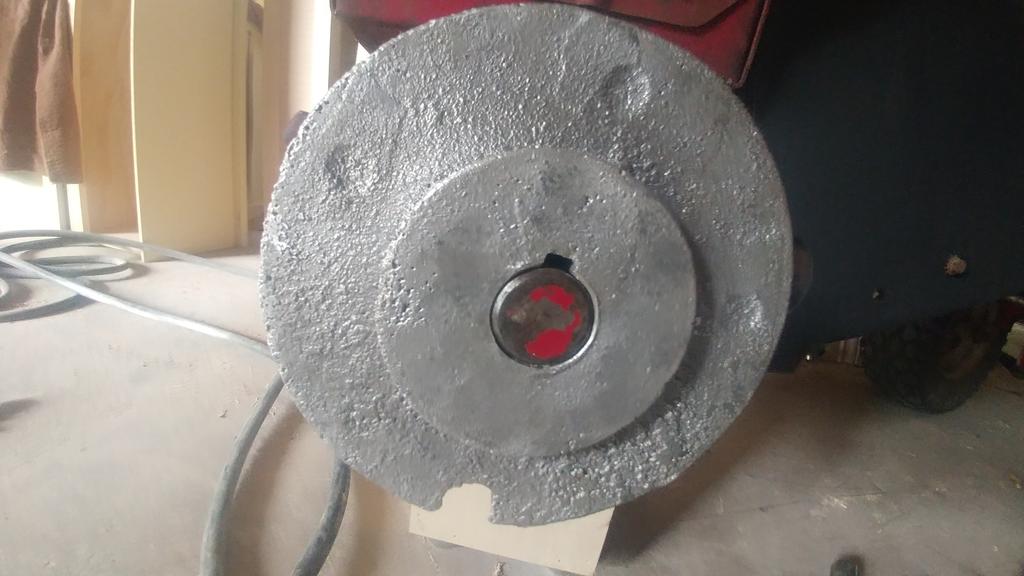

ebinmaine 79,154 #13 Posted October 10, 2018 39 minutes ago, C&W said: key way by hand with a file Wow !! Hey, one thing that would help you is if you put a second set screw in 90° from the first one. Makes a huge difference in the stability of the Hub to axle. I kind of want you to leave that thing on there Until It Breaks even if it's long after you get your other ones back. Just for curiosity reasons. 1 Share this post Link to post Share on other sites

C&W 77 #16 Posted October 10, 2018 Well im going call this project done i got to get back to working for real tomorrow Turned out well just very slight wobble way better than i would of thought if had a milling machine would been perfect i reckon all this done today with bare minimum of tools, file ,drill press furnace and some scrap aluminum Only set wheels an tires i had available at the momment 2 1 Share this post Link to post Share on other sites
ebinmaine 79,154 #17 Posted October 10, 2018 Well Done!!! Now we need you to go ride that thing around for a few weeks straight and see what the longevity of those aluminum hubs will be. Share this post Link to post Share on other sites

pfrederi 20,675 #19 Posted October 10, 2018 I do not see a flat surface around the set screw. Be very careful and do not over tighten the jam nut. the hub is somewhat tapered and the hole may not be perfectly perpendicular. WH machined a flat spot around the set screw. if you over torque the jam nut you can snap off the set screw flush with the hub... not a good thing..do not ask how i know this. 1 Share this post Link to post Share on other sites

C&W 77 #21 Posted October 11, 2018 Lol i would like to do it more often, but i have to work pretty much all the time .i havnt been doing it to long, plan on doing some cast iron before end of year hopefully. Yeah I just didnt get around to doing the flat service arund set screw got in a hurry Share this post Link to post Share on other sites
