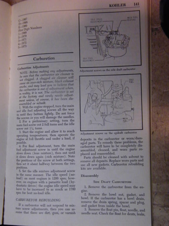

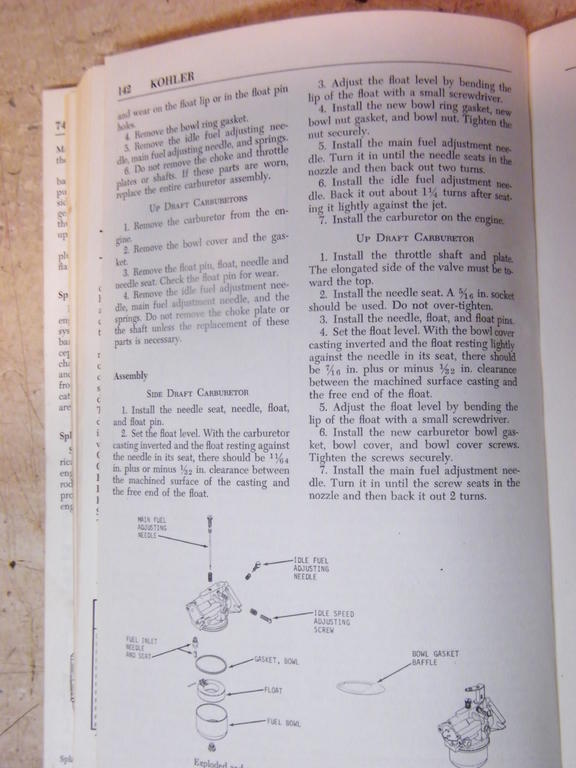

953 nut 70,304 #3 Posted October 9, 2018 This manual should give you more information to go on. Share this post Link to post Share on other sites
WHX?? 58,347 #4 Posted October 9, 2018 What manual Richard? ... not showing up? I assume you are looking for a carb for a 8hp Kohler Paul? If so just go to and look for K181 carb. Just make sure the choke configuration is correct. if in doubt let us know. Share this post Link to post Share on other sites
953 nut 70,304 #5 Posted October 9, 2018 10 hours ago, WHX21 said: What manual Richard? .. This one....... must have not pushed the Paste....... 1 Share this post Link to post Share on other sites

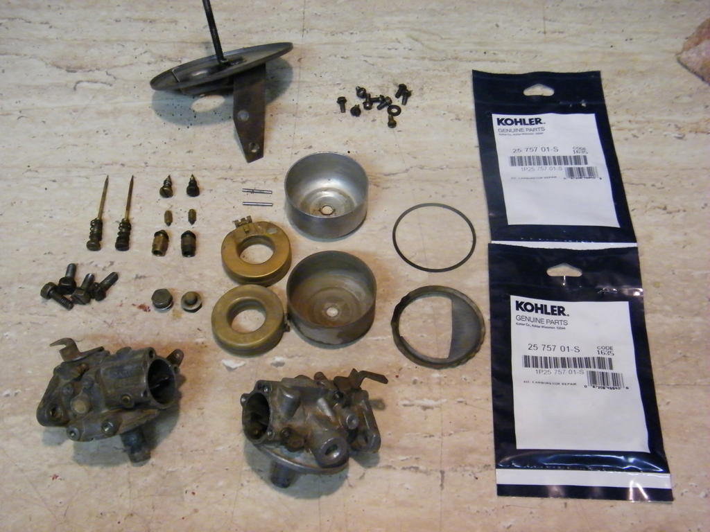

stevasaurus 23,884 #6 Posted October 10, 2018 It should be a Carter "N" carb. They are super easy to clean and rebuild with a kit from E-Bay. :) Share this post Link to post Share on other sites
