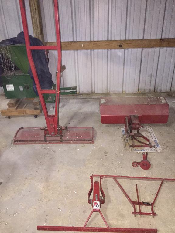

Razorback 1,370 #31 Posted October 12, 2018 Also found the mule for the tiller, and pulled out the items that were behind the tiller. I can identify the sleeve hitch, but what is the bar attached to it, and what is the other piece? 1 Share this post Link to post Share on other sites
gwest_ca-(File Mod) 12,478 #32 Posted October 12, 2018 See the green Mackissic shredder is also set up for this tractor. Garry 1 1 Share this post Link to post Share on other sites
953 nut 68,751 #33 Posted October 12, 2018 Once a bit of deferred maintenance has been taken care of you will be in good shape. With all of those attachments you need to add a few more to the herd so each attachment is mounted on its own . 2 1 Share this post Link to post Share on other sites
Razorback 1,370 #34 Posted October 12, 2018 Thank you for that manual. I was wondering if it was some sort of cultivator. Now I need to find the rest of the parts. Share this post Link to post Share on other sites
WHX?? 57,879 #35 Posted October 12, 2018 Good eye Garry...Yes that is a good find, scour the place for those parts!! Share this post Link to post Share on other sites

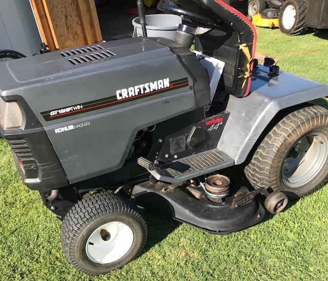

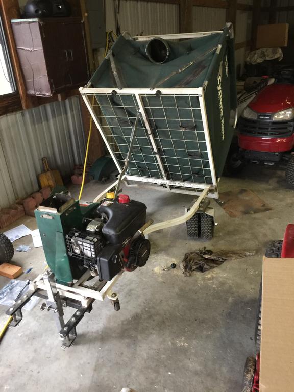

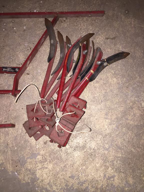

Razorback 1,370 #38 Posted October 31, 2018 Guess what I found while I was at my friend’s place replacing the impeller on her Cyclone Leaf Rake? Found ALL of the shanks and clamps for the cultivator attachment!!!! Also fixed that Craftsman you see in the Cyclone picture.... another “helper” was mowing her yard and ran into something solid..... bent the leading edge of the mower deck just below the left footrest.... enough to cause contact with that blade. Straightened the deck, sharpened the blades while I had them off. Then............ she told me she’d GIVE me the Wheel Horse! Still going to pay her something for the implements..... might also see if she’d just like to trade my handyman-ness for whatever she thinks it’s worth. She’s the type that even though I offer to help her with ANYTHING she needs, she’s always insisting that she pay me.... I don’t take a dime... so, maybe it’ll make her feel better if we barter! 3 1 Share this post Link to post Share on other sites
ericj 1,580 #39 Posted November 24, 2018 those cultivators must not have been used much, or used very lightly, the shovels still have most of the paint on them. Very nice find, good luck eric j Share this post Link to post Share on other sites

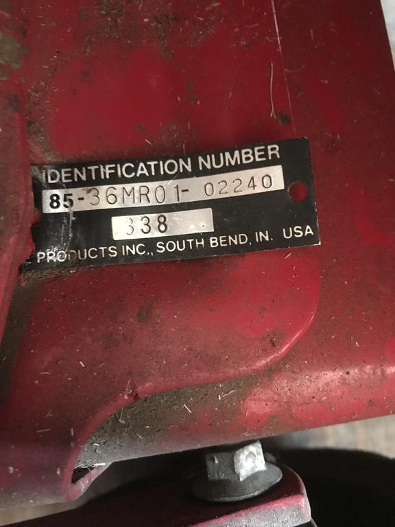

Razorback 1,370 #40 Posted December 18, 2018 On 10/9/2018 at 7:12 AM, gwest_ca said: Be hard to find one nicer than that one. Click on the pictures. The mower deck is much newer 1978-1982. The first 2 digits not in the photo should ID the model year. The 338 build date is missing the first digit. 338th day of ? year. Garry Finally remembered to look at the deck ID tag again.... first 2 digits are “85”. 1 Share this post Link to post Share on other sites
jay bee 915 #41 Posted December 20, 2018 On 12/18/2018 at 5:27 PM, Razorback said: first 2 digits are “85”. That makes it a 1978 1 Share this post Link to post Share on other sites
gwest_ca-(File Mod) 12,478 #42 Posted May 18, 2019 The 338 build date is missing a digit. With such a low serial suspect it should read 7338 which is Sunday December 4, 1977. Click on the picture. Garry Share this post Link to post Share on other sites
