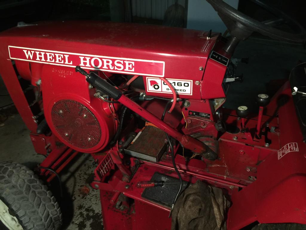

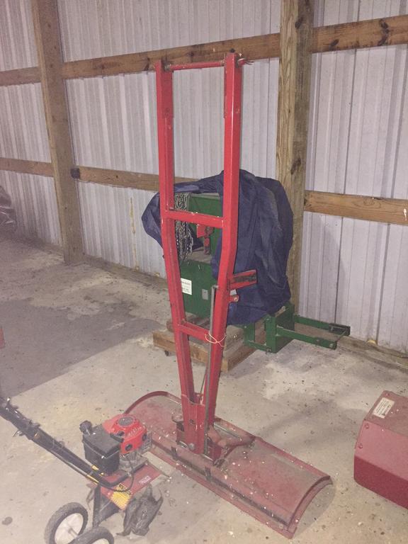

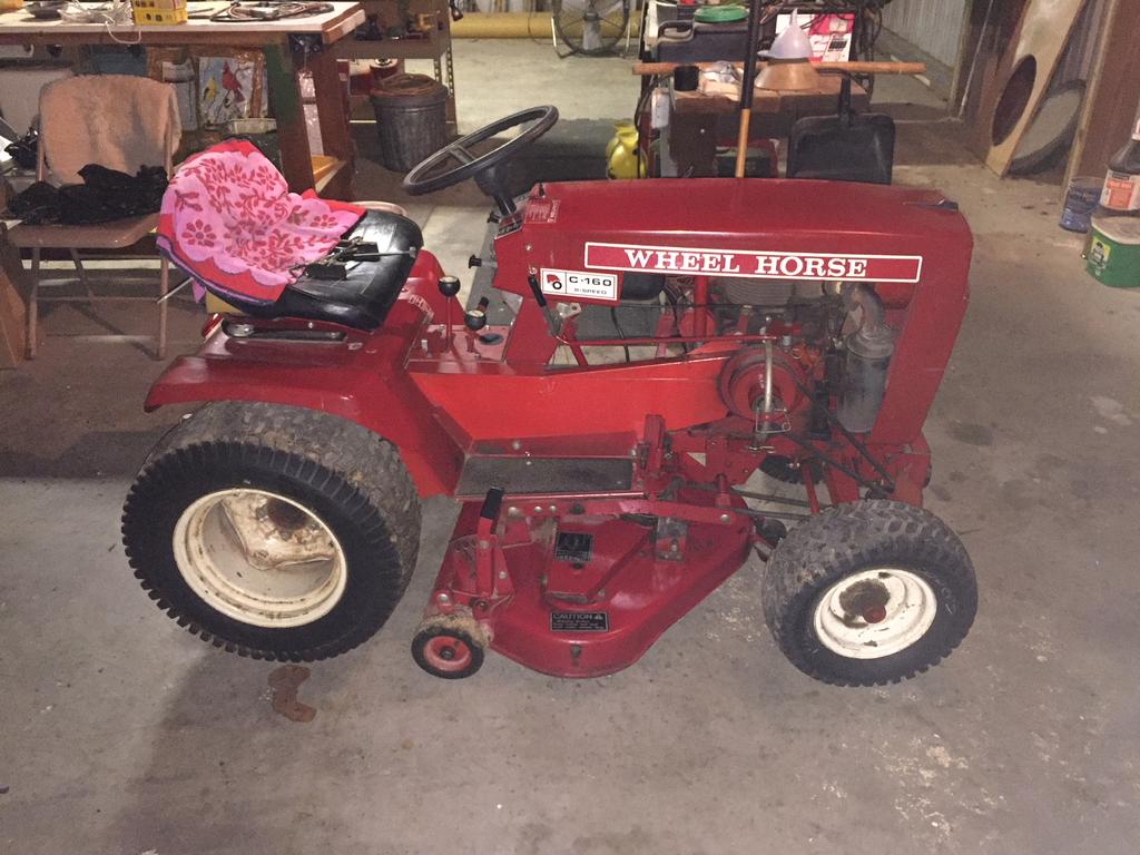

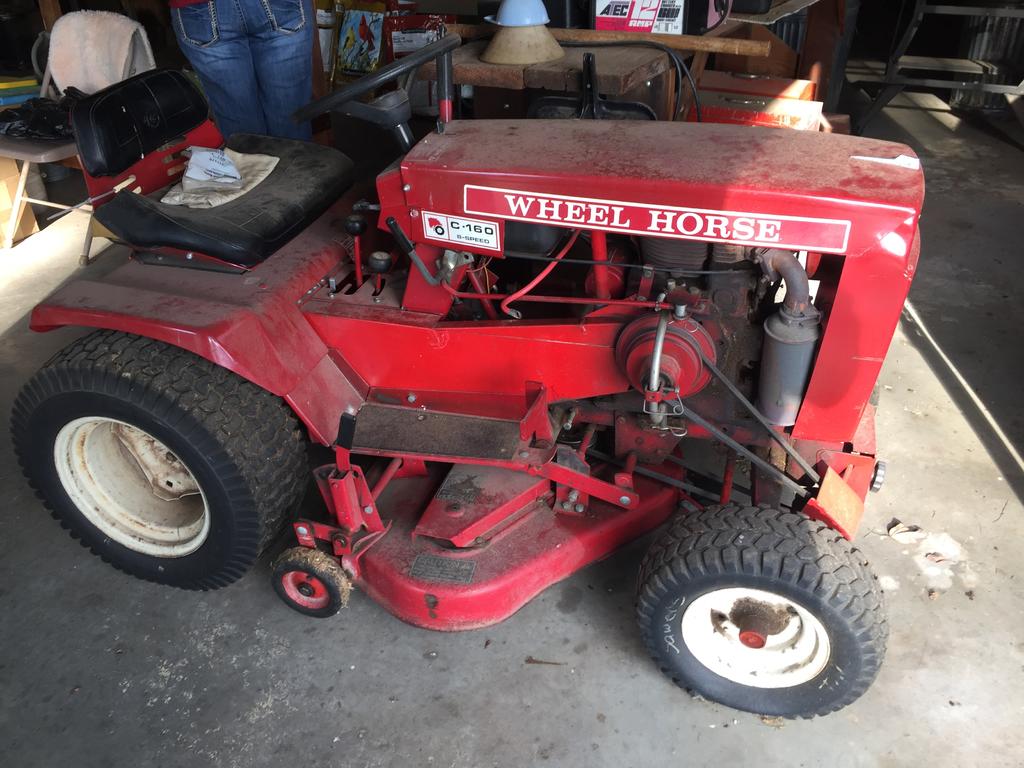

Razorback 1,370 #1 Posted October 8, 2018 (edited) Hello from beautiful NW Arkansas! I joined today because there is a good chance that I will be adding my first Wheel Horse (a 1974 C-160) to my set of garden tractors that I use in our garden. I was contacted by a lady I met a few years ago when my wife and I were visiting a friend at a local hospice. Her husband was there and we got to talking about gardening and garden tractors. We traded phone numbers but hadn’t heard from her until last week. Her husband passed a few months ago, so she is down-sizing and moving (locally). She remembered that I liked garden tractors, called, and asked if I would mind looking at their Wheel Horse to see what it needs (if anything) before she sells it. She thinks it has a problem but doesn’t know what. We went to visit her Saturday. The Wheel Horse is in very good condition, has a mower deck, tiller, front blade, aerator, and wheel weights. I will hopefully have time to give it a first look later this evening. It impressed me enough to consider buying it from her. We’ll see! I currently own 4 GT’s: 1966 Cub Cadet 123 1981 Speedex 1631 1994 Craftsman GT6000 2008 Craftsman PGT9000 Glad to be here! I hope to be a full-fledged owner soon! Paul Edited October 8, 2018 by Razorback 6 3 1 Share this post Link to post Share on other sites
WHX?? 58,290 #2 Posted October 8, 2018 (edited) Razor You would not be sorry in buying it. The C160 is a beast and can do just about anything. '74 is the first year they were made but were built on a time proven frame and transmission. They came in either hydro or gear jammer. On many of our tractor bucket list for sure. Just off the top that one looks like a nice one & you have come to the right place for anything . Great bunch of talented people here. Edited October 8, 2018 by WHX21 2 2 Share this post Link to post Share on other sites
953 nut 69,718 #3 Posted October 8, 2018 You are going to love the C-160! A sixteen horse Kohler "THUMPER" engine and a bulletproof eight speed transmission will last for ever with a little maintenance. It looks like it has been cared for and with all those attachments you will be able to do a ton of work. 5 1 Share this post Link to post Share on other sites
oldredrider 2,554 #4 Posted October 8, 2018 I'm with 953 nut. Many moons ago, when I first discovered Wheel Horses, did a lot of research and decided I HAD to have C-160. Fast forward a few years, have owned a few of them but sold them because they are in high demand around here and "everything has a price". Several years ago I got a C-160 auto that I am determined to keep. NOT FOR SALE! Has always done (with ease) everything demanded of it. Pay whatever she wants and feel good about helping her out and your new acquisition. 1 4 1 Share this post Link to post Share on other sites
c-series don 12,513 #5 Posted October 8, 2018 It looks to be well cared for. Maybe just needs some wax! I would be all over that. Then you will see why all of us here are addicted to these great tractors. Durability, ease of changing attachments, I could go on and on! 4 1 1 Share this post Link to post Share on other sites
JAinVA 4,638 #6 Posted October 9, 2018 Pinnacle of the C series and in nice shape.Go for it! 2 1 1 Share this post Link to post Share on other sites

Razorback 1,370 #10 Posted October 9, 2018 (edited) Went and took a look at the C160 this evening. After an initial inspection to make sure the engine was free, fed it some fresh gas, checked the oil, checked the air filter, and made sure the throttle and choke worked like they should, all looked good. Stuck my jump box on it, good strong crank, obviously getting gas to the carb, but no start. No spark. Not knowing if there are any safety interlocks to contend with, I made sure the tractor was in neutral, brake was set, and clutch was depressed. (All good?? Missing anything??) Inspected the points, checked the plug wire, cleaned the spark plug...... still no spark. Noticed a little bit of a gas leak at the fuel pump, but not much. Hoses look good, but the output-side hose clamp is a bit loose. Went to the truck to get my meter...... realized that I had left it on the shelf in the garage! So, did some cleaning on the tractor and decided to come back soon... hopefully tomorrow, with a coil and my meter. The points looked good, but could not check much without my meter. Took some more pictures. Its a great-looking machine. Sometime soon I will tell my wife that we're getting another GT....... Edited October 9, 2018 by Razorback 1 2 Share this post Link to post Share on other sites

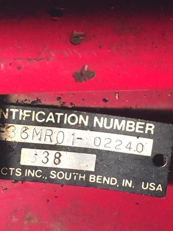

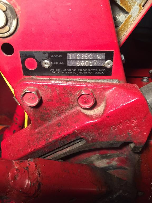

gwest_ca-(File Mod) 12,504 #13 Posted October 9, 2018 Be hard to find one nicer than that one. Click on the pictures. The mower deck is much newer 1978-1982. The first 2 digits not in the photo should ID the model year. The 338 build date is missing the first digit. 338th day of ? year. Garry 1 1 Share this post Link to post Share on other sites

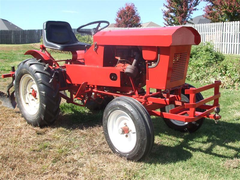

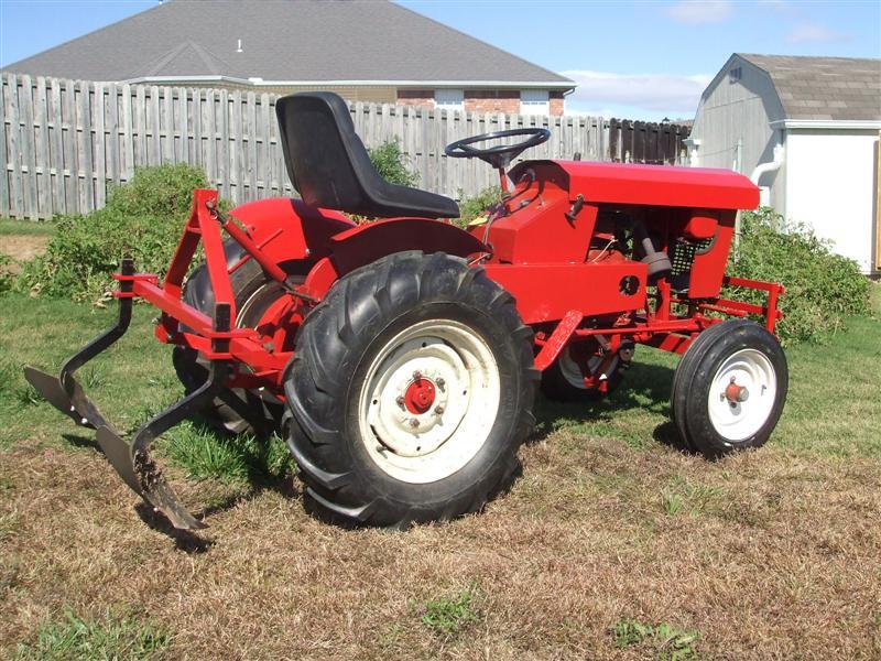

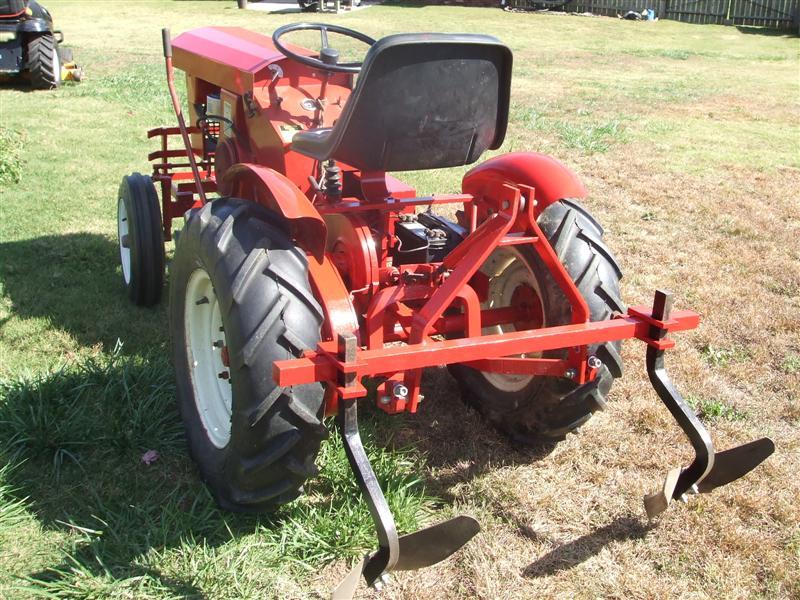

Razorback 1,370 #20 Posted October 9, 2018 I just reminded myself that Wheel Horse and Speedex are cousins, or actually brothers, since they were developed by the Pond brothers. No WONDER I like them so much! Here is my 1981 Speedex 1631. It also has a belly mower, plow, and discs. I REALLY like it for turning a furrow because it sits up high, allowing a deep furrow without high-centering: 2 2 1 Share this post Link to post Share on other sites

Razorback 1,370 #24 Posted October 11, 2018 (edited) Well, I brought a coil with me tonight and installed it. Didn’t seem to make a difference. Cleaned the points, made sure the safety switch at the clutch pedal worked like it should. Started it, and it ran! I let it run for 10 minutes or so. Shut it off to button things up, tried to start it and it would crank but not run. Kept checking things and never could get it to run. At the end of the time I could spend, it would not turn the starter. I am thinking that the key switch or the starter relay is not working like it should. I really think it was a fluke when it did run for me. (Lights come on with the key in the on position, go out in the start position. ) Does anyone know know where I might find a key switch and a starter relay? I have found similar suitable parts at TSC for my old Cub Cadet 123...... maybe the same? I am going to "borrow" the starter relay off of my Cub, might see if the key switch will swap, too. Also will bring a known good battery off of the Cub. Maybe tomorrow night I can get this figured out. Hearing it run so nicely was a good shot in the arm! Edited October 11, 2018 by Razorback 1 1 Share this post Link to post Share on other sites
