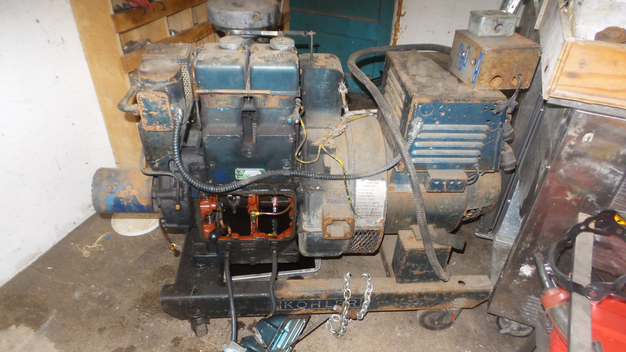

bc.gold 3,406 #1 Posted October 8, 2018 (edited) I recently purchased a Kohler 6.5 kw 3 phase generator with a ST2 Lister diesel engine, previous owner ran it low on oil. I've drained what little of it there was and found a lot of metallic particles, so to be on the safe side I'm going to disassemble the bottom end, mic the crank journals to see if I can get away with just a polishing with standard bearings. I'll go with name brand Clevite or Federal Mogul engine bearings, The generator was still on my truck when I went to the local station for gasoline for the truck and the guy there said diesels are hard to start in the cold, told him not real diesel that have high compression. The Lister is 23.5:1. In addition to being high compression the engine has an unusually odd looking cold starting aid, screwed into the intake manifold are two brass cups. You remove the caps from these and fill them with oil, that oil finds its way into the cylinder decreasing the volume of cc's inside the cylinder thus raising the compression further. Ingenious engineering Each cylinder is equipped with an injector but the unusual thing is each injector has its own individual fuel pump each of which is operated by independent lobes on the camshaft. The same cam that opens and closes the valves in the cylinder head. The ST2 is an air cooled engine, each of the cylinders are held to the block via stay bolts one end screwed into the block with the upper ends passing through the cylinder head, each cylinder has an independent head. The forged steel crankshaft with machined counterweights that are affixed via cap screws, I suspect that Lister used the same crank on several different models of engines by simply changing to the counterweight needed. Engine is full oil pressure fed, the oil pump is of the plunger type operated via a camshaft lob as well. The camshaft protrudes from the engine and doubles up as a PTO shaft running at half the engine speed. Edited October 8, 2018 by bcgold 4 1 Share this post Link to post Share on other sites

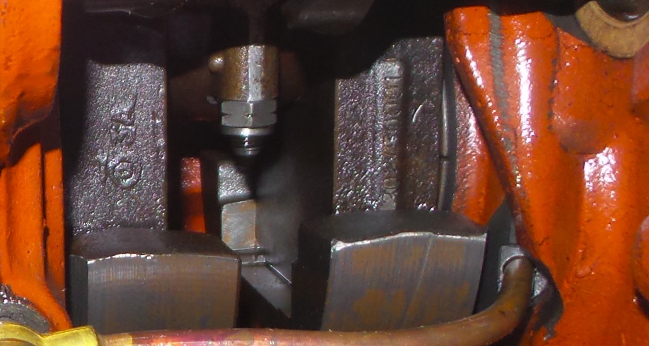

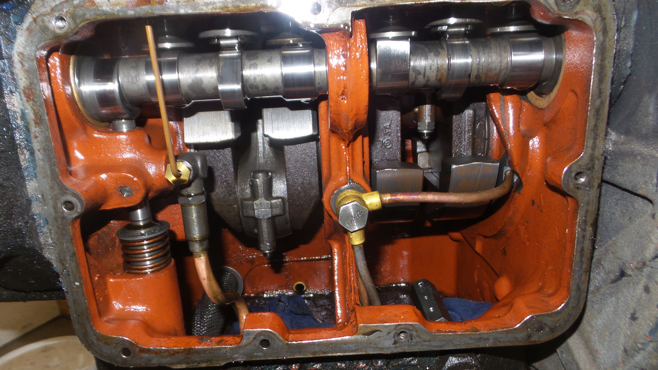

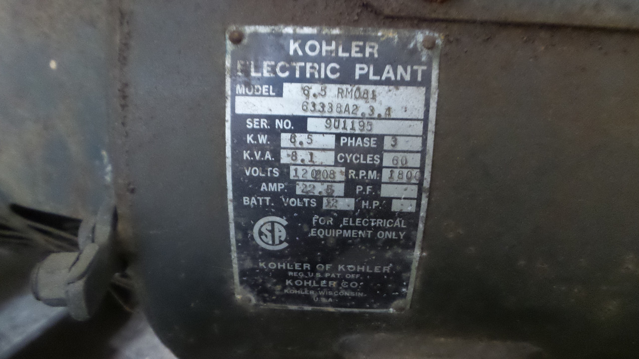

bc.gold 3,406 #8 Posted November 15, 2019 (edited) Now that the Petter PJ is on place and wired, waiting on a power outage. I now have some free time on my hands, I have started to investigate the bottom end bearings on that first Kohler generator that has a Lister ST2 attached. Very easy access to the connecting rods, so far a close examination of the image does not show any damage to the face of the thrust bearings. In the first image far right hand side you can see that the bearing material has not been scuffed away. And the lobes on the camshaft look decent. Tomorrow will see if there's excessive end play on the crankshaft. A closer look at the generator tag says that it's 8.5 KW generator. No wonder Lister and Petter have a solid reputation, full pressure oil system and three main bearings. Edited November 15, 2019 by bcgold Share this post Link to post Share on other sites
bc.gold 3,406 #9 Posted November 15, 2019 Using the formula below my Petter generator has maximized available horse power to KW capable of being generated while the Kohler plant with a 15 horse power engine used to generate 8.5 KW enables the Lister to handle this at a leisurely pace. As for benefits using more horse power than required the air cooled engine would never be over taxed. allowing it to run cool with possible savings in fuel consumption. I suspect the Kohler generator was a military spec. One horse power (1 hp) equals 0.75 kilowatt i.e. 20hp x 0.75 = 15kW 1 Share this post Link to post Share on other sites
