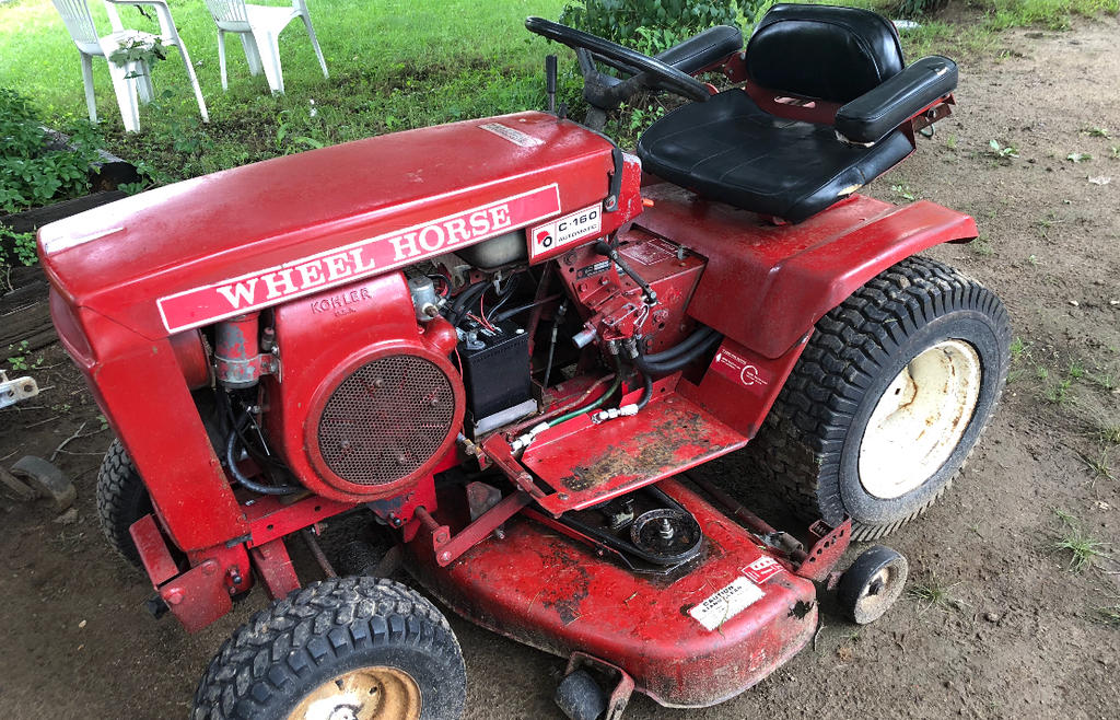

Chris1055 106 #1 Posted October 6, 2018 Hi I have a 1974 c160 auto nice machine. Hydro runs strong but needs some adjusting. Just got done with the hubs they were loose they had the wrong woodruff key in them and had some wobble or it was just really worn. Nothing leakes and I put new fluid in it but I can’t get the tranny in neutral because the dump valve is stuck I don’t want to hurt anything. Any suggestions?? Share this post Link to post Share on other sites

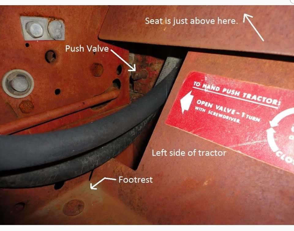

pfrederi 21,274 #2 Posted October 6, 2018 If by "dump valve" you mean the tow valve pointed to by the decal on the back of the foot rest you do not need to open it to do the neutral adjustment...or what else did you want to adjust??? Freeing a stuck tow valve can be frustrating 1 Share this post Link to post Share on other sites

KC9KAS 4,746 #4 Posted October 6, 2018 You may have to remove the tire and get ahold of the valve shaft with a pair of vise grips to turn it...or even do like the GT-14...loosen the jam nut. 1 Share this post Link to post Share on other sites
daveoman1966 3,884 #5 Posted October 6, 2018 You MAY have to remove the left running board AND the rear wheel to access this TOW VALVE.... there is NOT a jam nut on it. Find a small pair of locking vise grips...clamp it TIGHT onto the stem and give it a quick bump to turn the valve loose...the a flat screwdriver to remove it, if wanted. 1 1 Share this post Link to post Share on other sites
