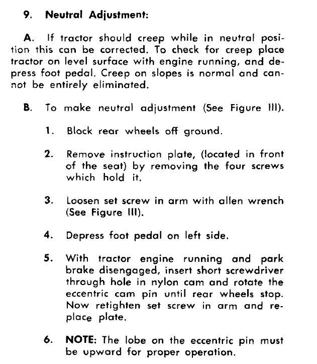

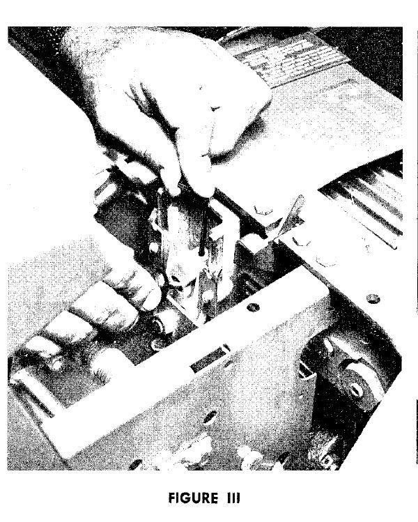

pfrederi 21,274 #8 Posted October 6, 2018 If it creeps on the level you need to do a neutral adjustment as outlined in the operators manual for you tractor. If your parking brake doesn't work (you can push it valve in tow and handle pulled up) then your parking pawl has been ground down by misuse (trying to set it while moving). This releases metal shavings into the system and anathema for hydros. As a minimum make sure you change the filter and fluid. Repair means opening her up ..which is a good thing as it allows yo to clean the suction screen which hopefully caught many of the metal bits. https://www.wheelhorseforum.com/files/file/332-tractor-1969-charger-10-da-om-ipl-wiring-snpdf/ 2 Share this post Link to post Share on other sites

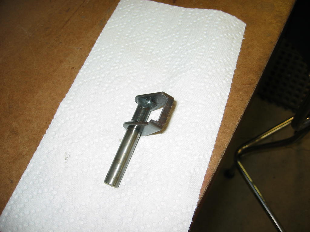

pfrederi 21,274 #10 Posted October 6, 2018 Then your parking pawl probably looks like this. It should be straight across. The metal ground away is what causes problems as it circulates. 1 1 1 Share this post Link to post Share on other sites
