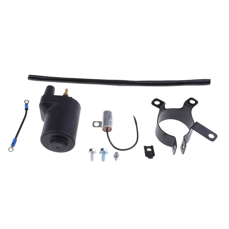

cleat 8,986 #11 Posted October 6, 2018 I just ordered 2 coils straight from China, They come with the mounting brackets and I have one installed and it works great. I paid $39.85 with free shipping. This was an ebay purchase (Ignition Coil Fit Onan 541-0522 166-0820 HE166-0761 HE541-0522 P Models New) is the listing description . Cleat 1 Share this post Link to post Share on other sites
TC10284 114 #12 Posted October 7, 2018 4 hours ago, cleat said: I just ordered 2 coils straight from China, They come with the mounting brackets and I have one installed and it works great. I paid $39.85 with free shipping. This was an ebay purchase (Ignition Coil Fit Onan 541-0522 166-0820 HE166-0761 HE541-0522 P Models New) is the listing description . Cleat Thanks! I ordered one. Share this post Link to post Share on other sites

TC10284 114 #16 Posted October 12, 2018 On 10/6/2018 at 5:30 PM, cleat said: I just ordered 2 coils straight from China, They come with the mounting brackets and I have one installed and it works great. I paid $39.85 with free shipping. This was an ebay purchase (Ignition Coil Fit Onan 541-0522 166-0820 HE166-0761 HE541-0522 P Models New) is the listing description . Cleat Might be a dumb question, but I looked at this some tonight and I'm not exactly sure how to get the replacement to fit into mine. The original has a squared side on it, while the replacement is a completely cylinder. Do I remove the third screw that sits a little further out on the metal plate? Share this post Link to post Share on other sites

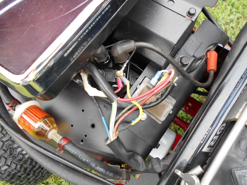

cleat 8,986 #17 Posted October 12, 2018 Not the best picture but all I have on the computer right now. New coil gets clamped into the supplied bracket then the bracket and coil get bolted down using the shorter screws provided with the kit. You just rotate it around until 2 holes line up, I think one of them will be under the long tab sticking out of the bracket. Coil will sit higher than it used to but it will still clear everything. I can get better pics tomorrow if required. Cleat Share this post Link to post Share on other sites
TC10284 114 #18 Posted October 13, 2018 (edited) Put on the new coil and condenser. Still the same problem. Spark plugs will fire the first time I turn key to Start and not fire again until I switch key to Stop. I cannot locate the oil safety switch. Where is it located? I broke the positive terminal on the coil tightening it down a third time. Didn't even put a lot of pressure on it. Chinese crap. Guess I'll be buying a new one. Edited October 13, 2018 by TC10284 Share this post Link to post Share on other sites
