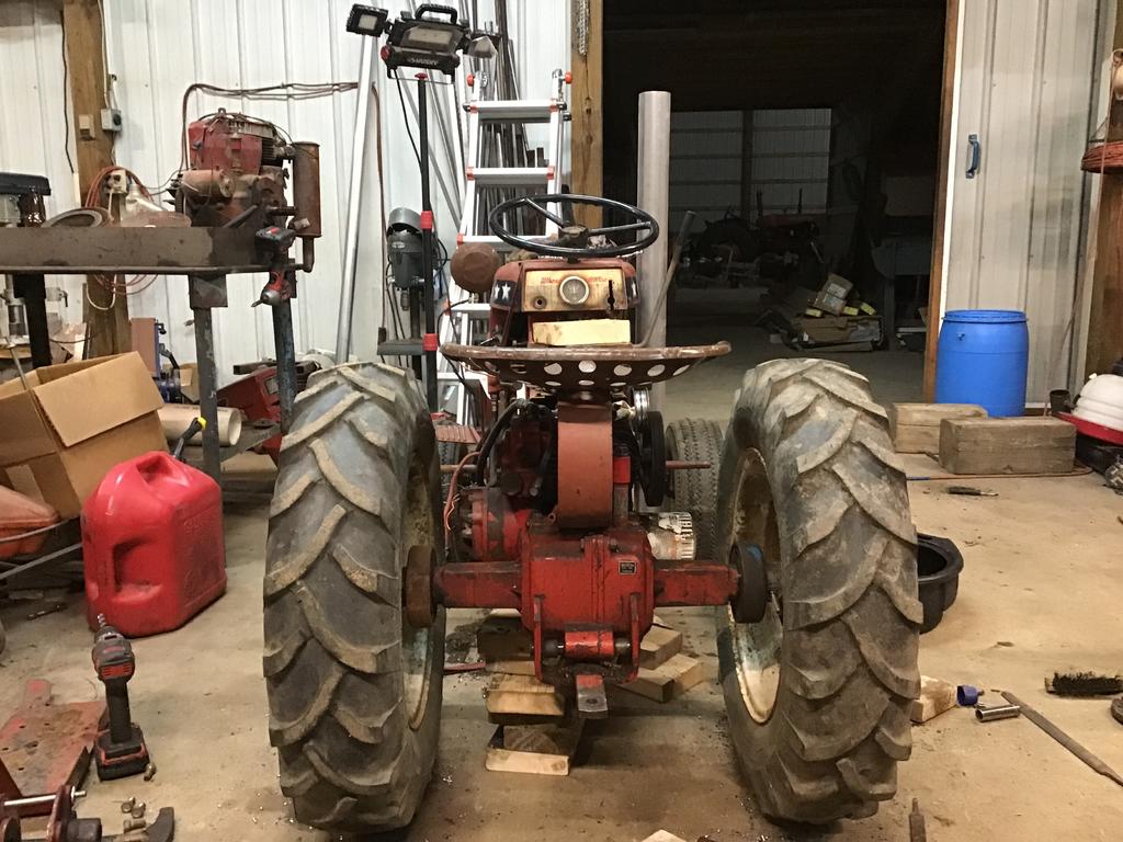

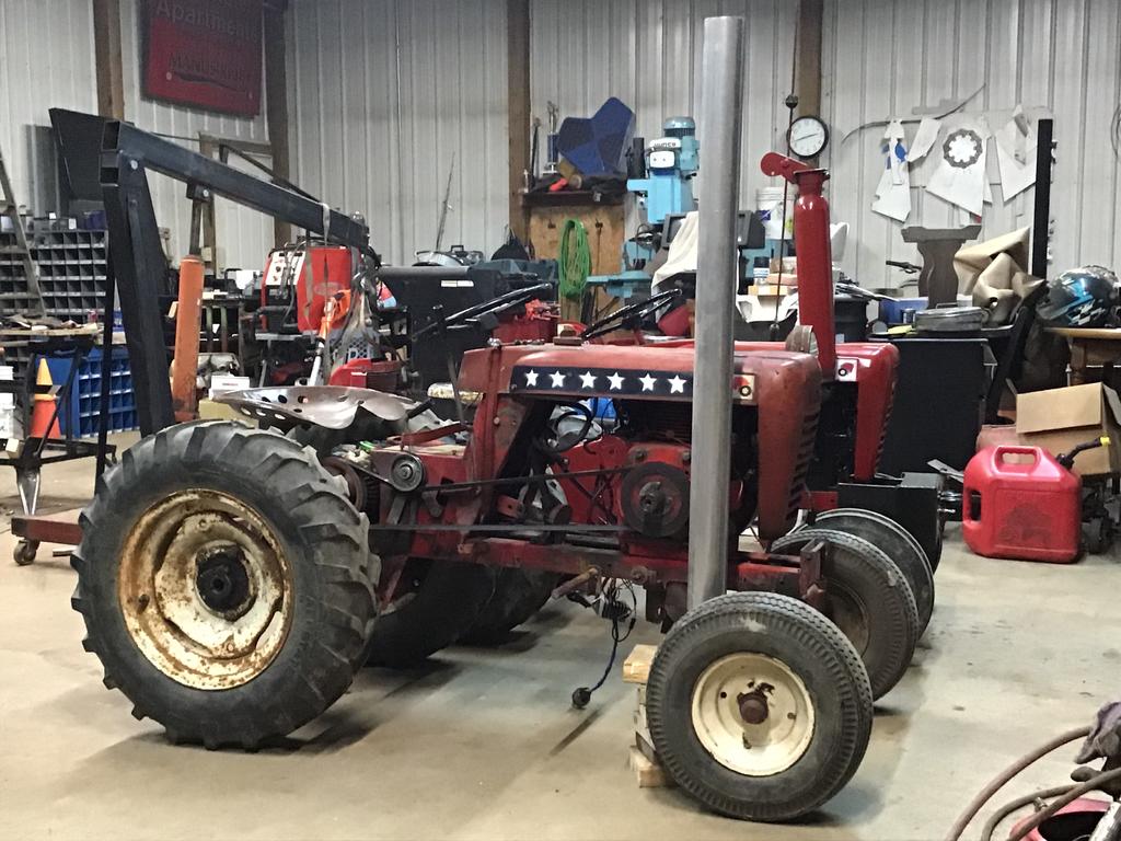

953 nut 67,449 #126 Posted October 25, 2018 1 hour ago, pullstart said: think I like it. Share this post Link to post Share on other sites
ebinmaine 79,713 #127 Posted October 25, 2018 44 minutes ago, pullstart said: I don’t want the thing to start leaning to the right though Eric! That's understandable Kev. So here's what you do. Because I try to help you out. You put about a six and a half foot tall stack on that thing and both tires on the same side as the stack can just be run with a little more air than the ones on the opposite side. By the way. Sometimes my ideas are not very good ... that might be one of them. 1 1 Share this post Link to post Share on other sites

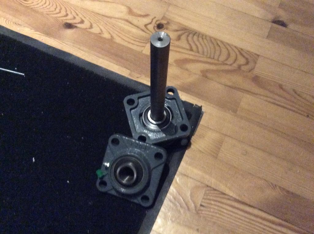

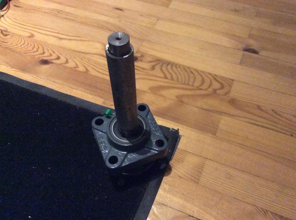

Tractorhead 9,217 #128 Posted October 25, 2018 38 minutes ago, pullstart said: Durablue, isn’t that in atv’s and whatnot? I think I’ve got one in my Raptor out back! Yup, you're right. durablue's are allmost wide Quadbike Rear Axles but they're without diff. Got also one in my Quadbike in the past, while driven several shorttrack races, but now quadbike is sold.😢 But my Supermoto still stay's - no option to sale😇 My "new" toy therefore is the Wheelhorse... Wich would be piece by piece improoved.😎 If you also plan to drive short track races with the horse, the durablue will be sure a fine solution, otherwise i doubt of a senseful use...😂 For extending the steering wheel, i would set a thicker (3mm) pipe wich fits the inside diameter of steering shaft, cutting steering shaft in half and extend it by the pipe. so you can easy find the best height. If all is fixed, weld it together and you're done. If you like to reinforce the stability, i would use a flanged ballbearing reverse mounted below the pipe, to improve the stability of the whole steering shaft itself, because of the extended length and a even smoother steering. 👍 let's Rock 1 Share this post Link to post Share on other sites
Pullstart 70,732 #129 Posted October 25, 2018 Well my tube is only 4 or 5’, I don’t feel like cutting my 10 footer up just for a tractor! 1 2 Share this post Link to post Share on other sites
ebinmaine 79,713 #130 Posted October 25, 2018 2 minutes ago, pullstart said: Well my tube is only 4 or 5’, I don’t feel like cutting my 10 footer up just for a tractor! I can deal with four or five feet. Hahahahahahahaha 1 Share this post Link to post Share on other sites
Tractorhead 9,217 #131 Posted October 25, 2018 Just a bit more in diameter i meant like my photos attached this was a 3/4" pipe by an 20mm shaft just for example 1 Share this post Link to post Share on other sites

LengerichKA88 1,885 #134 Posted October 26, 2018 I think that stack suits it. 1 1 Share this post Link to post Share on other sites

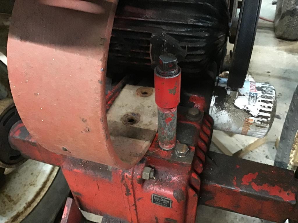

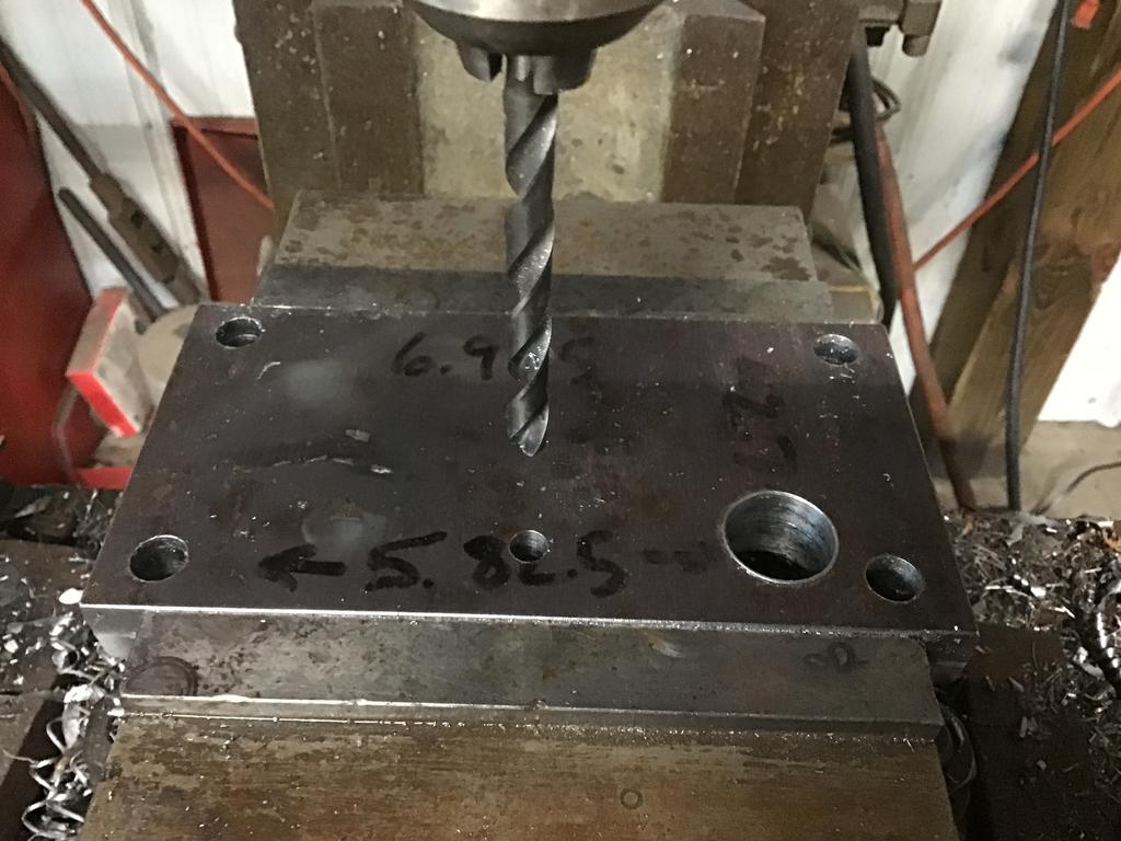

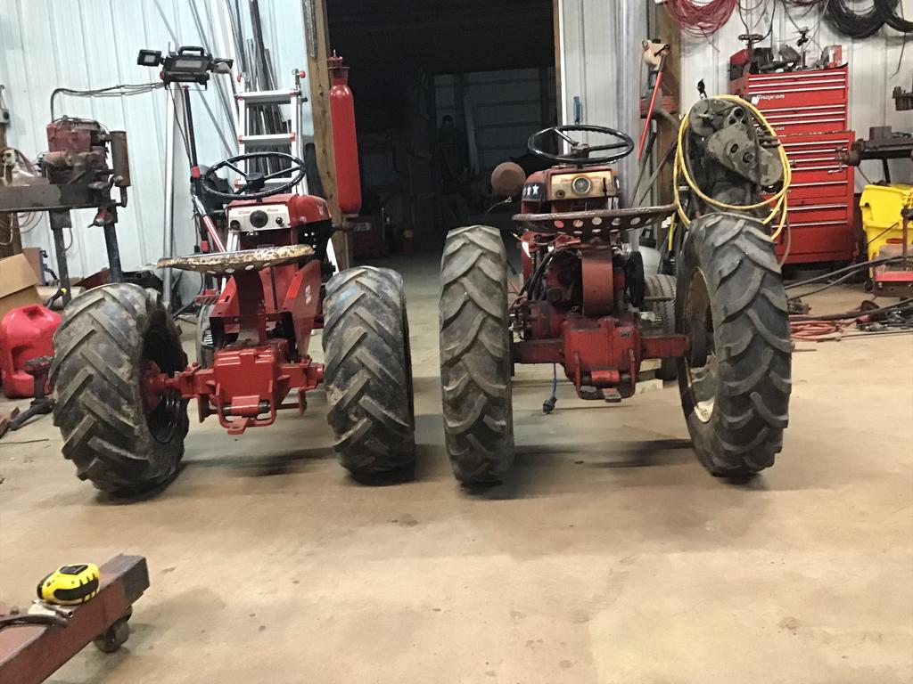

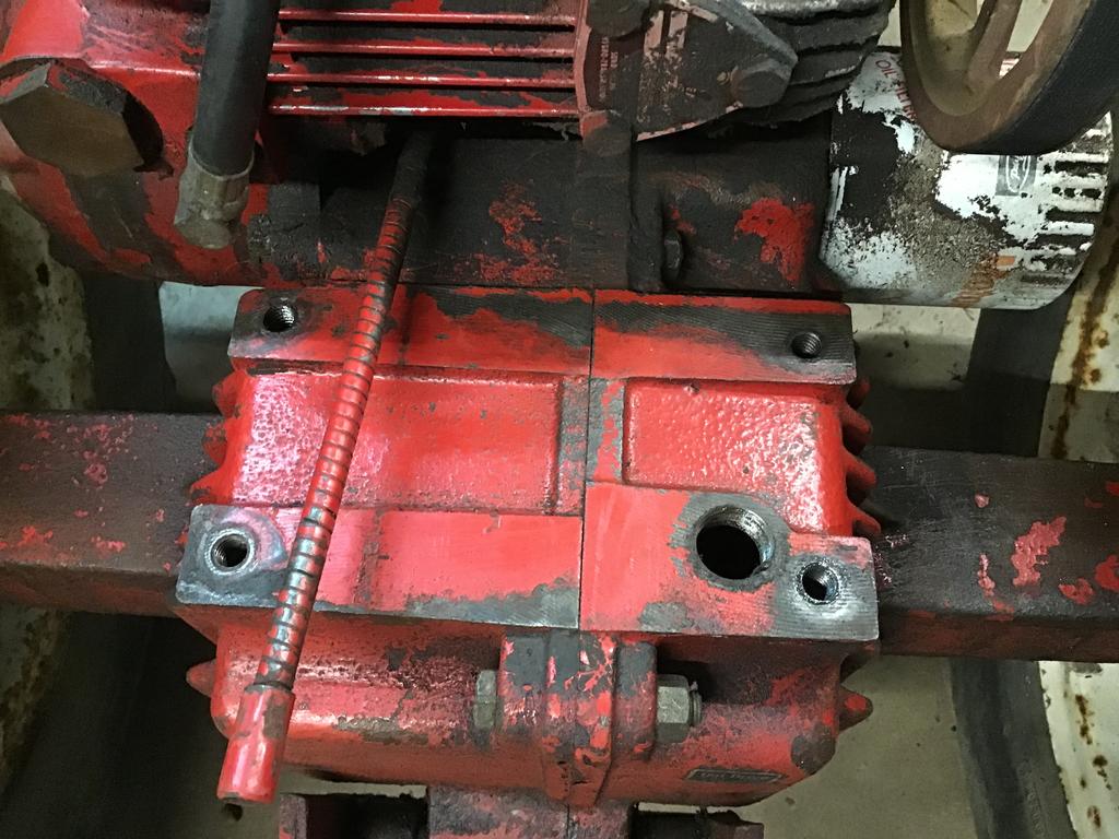

Pullstart 70,732 #136 Posted October 26, 2018 Well thanks to @PeacemakerJack for confirming my thoughts, the seat looks pretty “at home” with the spring reversed. The hydro transmissions have a four bolt pattern unlike the gear jammers, so the tool box/fender support will need to incorporate an adapter of some type. 6 Share this post Link to post Share on other sites
PeacemakerJack 11,022 #137 Posted October 26, 2018 Ya know Kevin, if you don’t own a “Big Wheel” , then you build one out of parts that you have! Looking great man That is coming together nicely... 2 Share this post Link to post Share on other sites

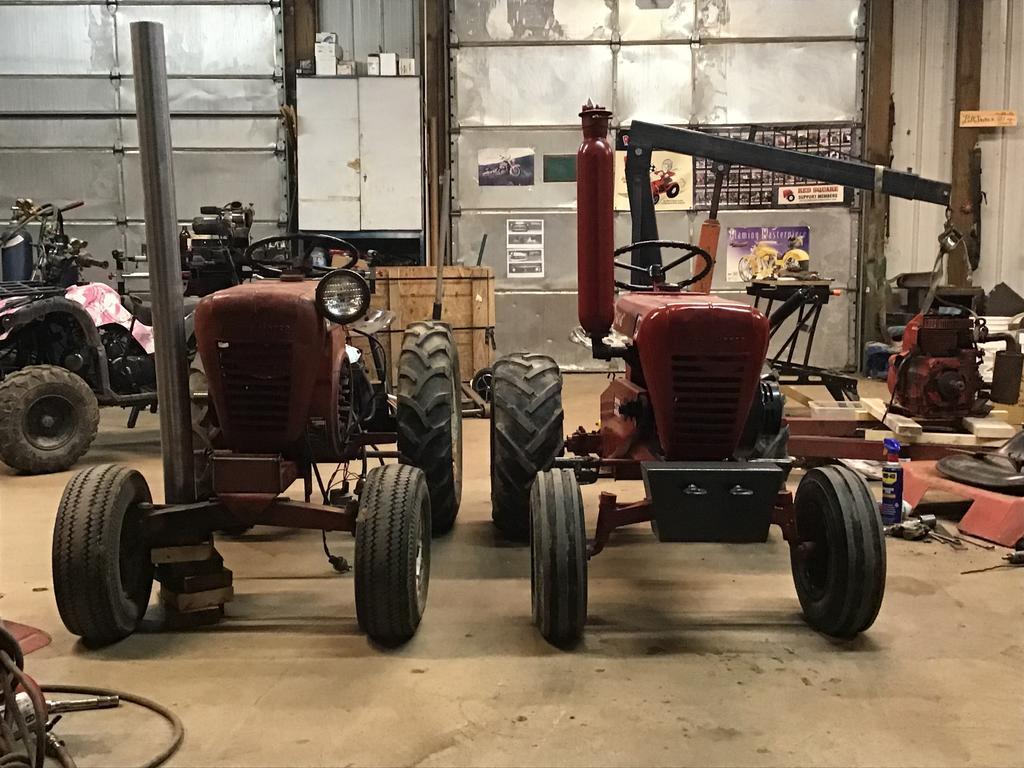

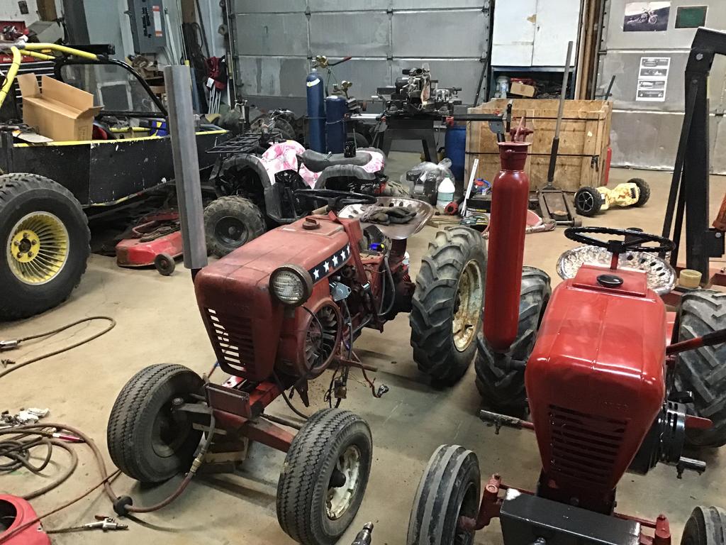

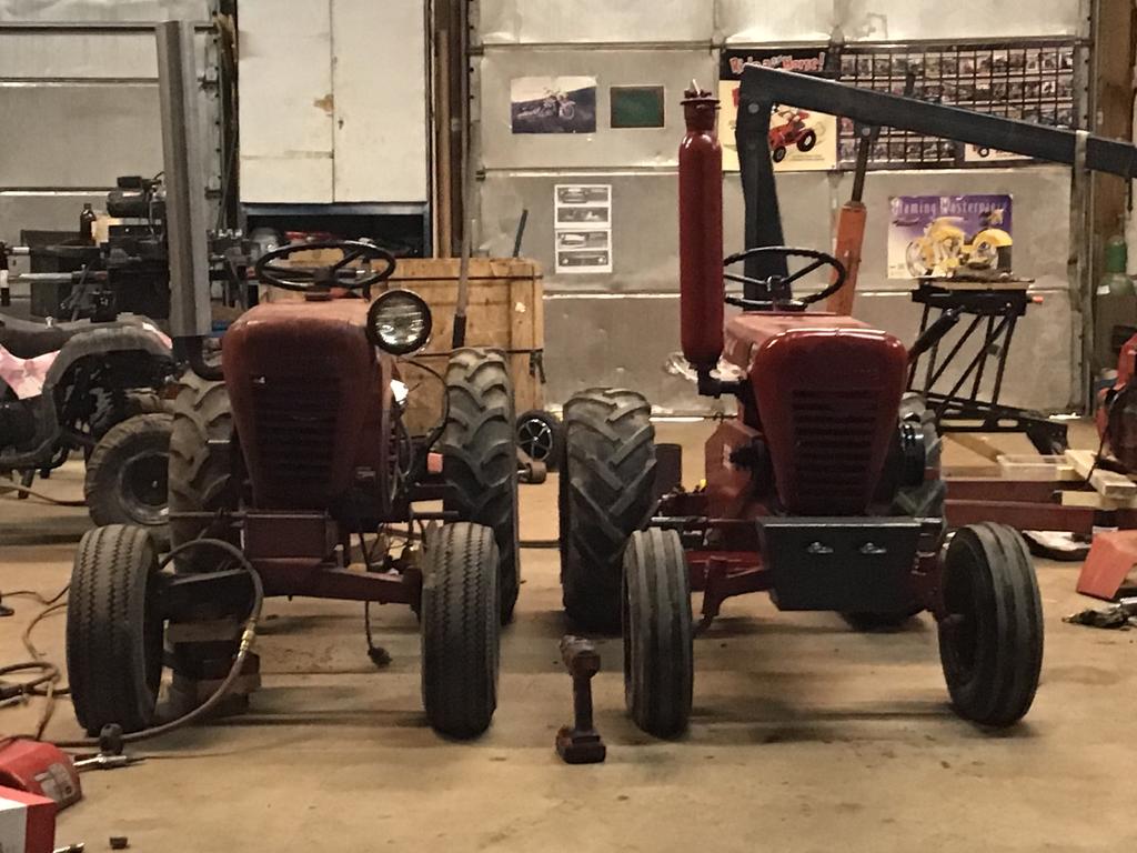

Pullstart 70,732 #138 Posted October 26, 2018 Putt Putt meets Star/Allis Star/Allistare/??? pay no mind to the oil slick under the engine hoist, that’s what happens when a fella like me tries to clean up shop. 2 6 Share this post Link to post Share on other sites
ebinmaine 79,713 #139 Posted October 26, 2018 You just go ahead and keeeeep that exhaust stack there. Boy I reeeellyy like the looks of that Bigg Wheeler... Mayhaps I'll have to procure me some huge rear Rollin stock. 2 1 Share this post Link to post Share on other sites

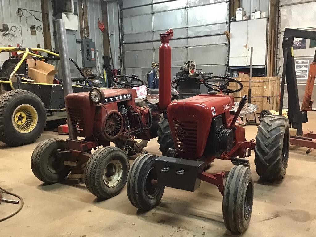

Tractorhead 9,217 #140 Posted October 27, 2018 (edited) When i look at the Photos it looks damn cool with big wheels. The only issue what irritates me , was the single light just on right side..... otherwise this looks also cool somehow... each more i looked the Pic, each more i got a name putt putt beside No.7 You know the Movie No.9 by shane acker, i must think to, if i see your "No.7" Edited October 27, 2018 by Tractorhead 1 Share this post Link to post Share on other sites
AMC RULES 37,259 #141 Posted October 27, 2018 I dig the single head light offsetting that big ol' stack... gives it character. 2 Share this post Link to post Share on other sites
19richie66 17,930 #142 Posted October 27, 2018 Not into stacks so I’ll keep my mouth shut but otherwise I think it looks great. 3 Share this post Link to post Share on other sites

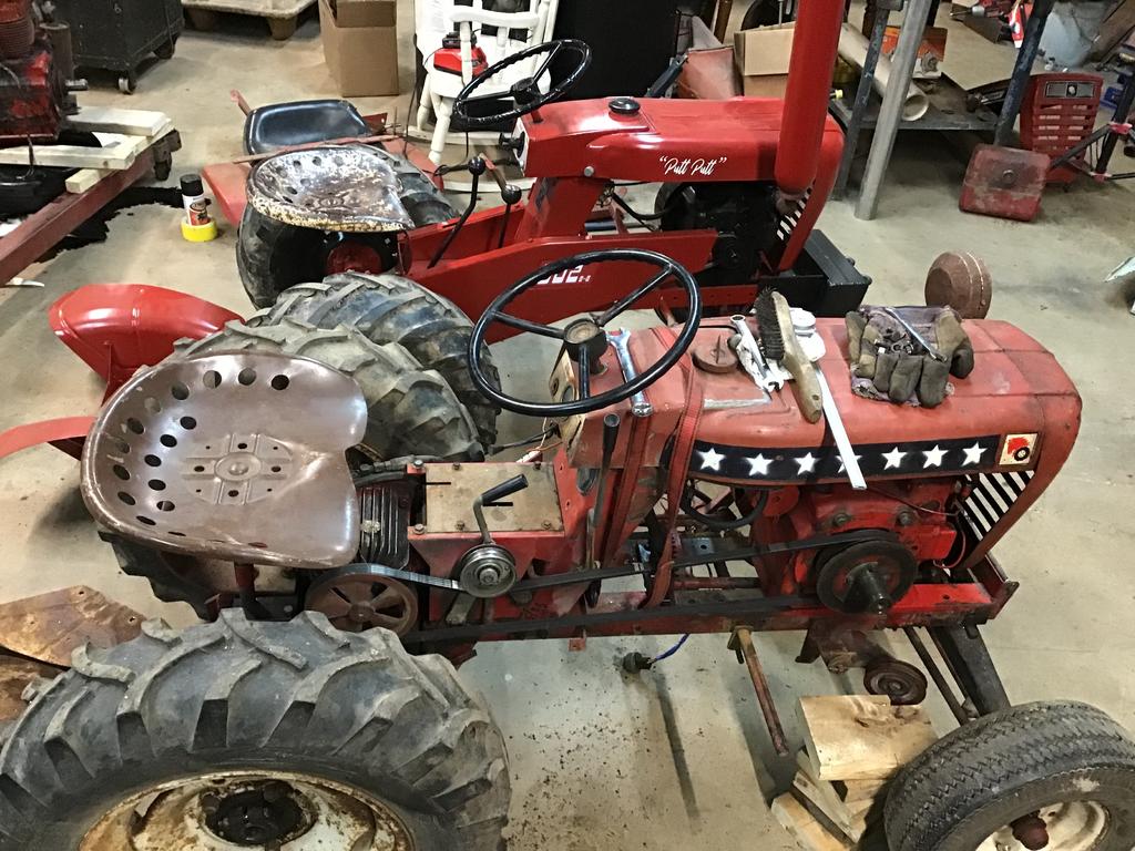

Pullstart 70,732 #148 Posted October 27, 2018 Seat adapter is roughed in! 2 Share this post Link to post Share on other sites
Pullstart 70,732 #149 Posted October 27, 2018 Steering wheel is looking more acceptable. The spring feels weird to me, but I bet she won’t mind! 6 Share this post Link to post Share on other sites

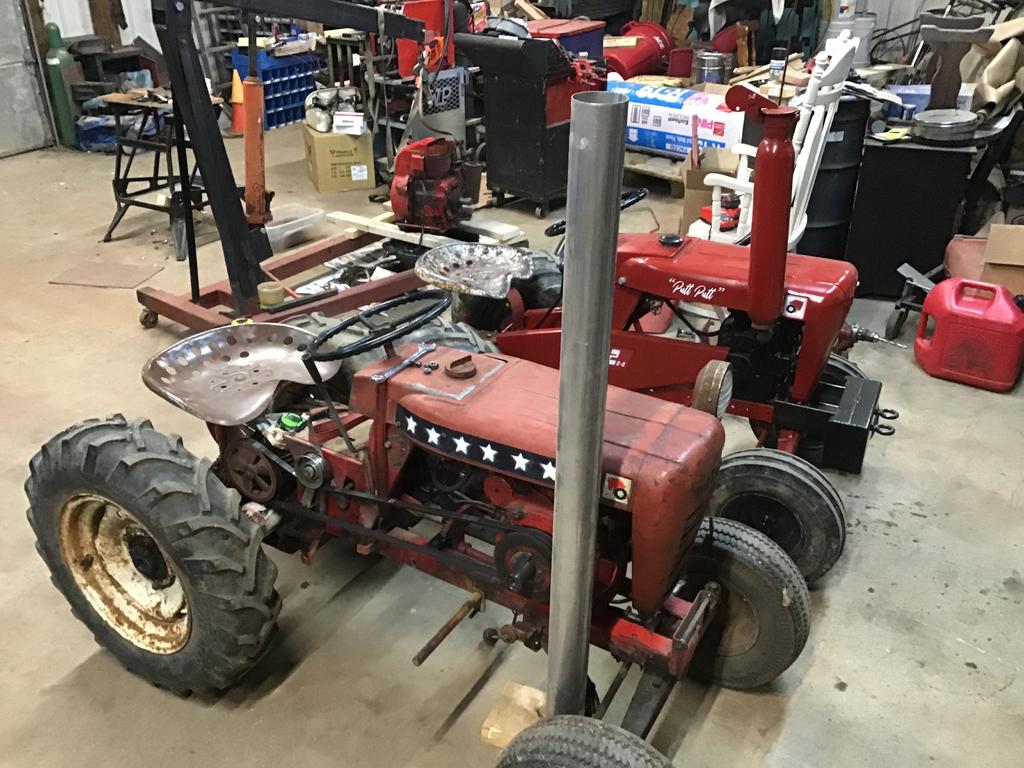

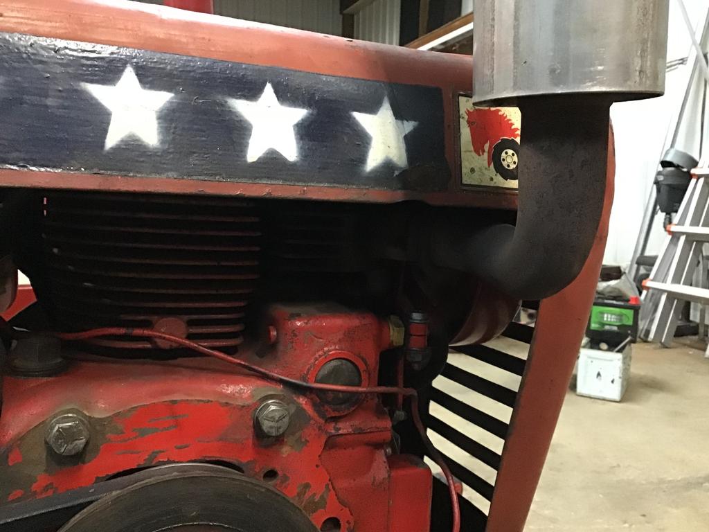

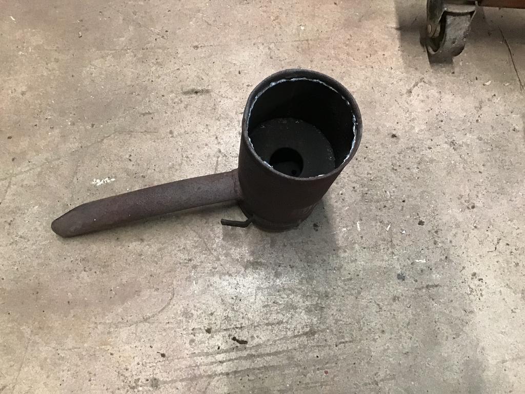

Pullstart 70,732 #150 Posted October 27, 2018 I used the elbow and first baffle from the 10 horse muffler, and tacked the stack together. 1 Share this post Link to post Share on other sites
