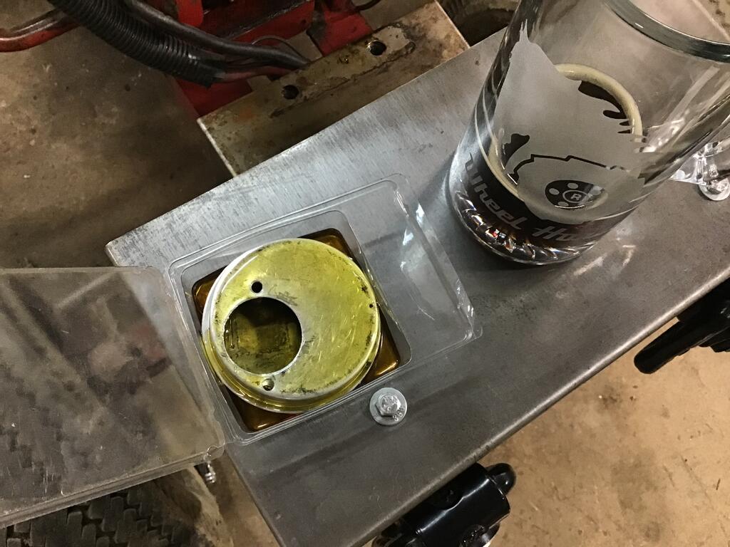

Pullstart 70,804 #829 Posted November 14, 2020 Changed the oil in the air filter! Share this post Link to post Share on other sites

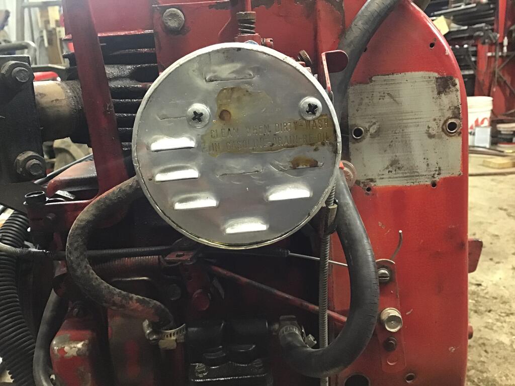

Pullstart 70,804 #830 Posted November 16, 2020 Frank’s freshly oiled air cleaner is back on, dripping a bit more residual oil now. I’ll stick the hood back on then toss a rag under the filter to catch any more drips. 4 Share this post Link to post Share on other sites

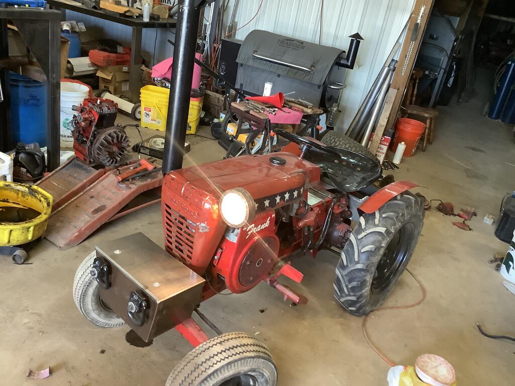

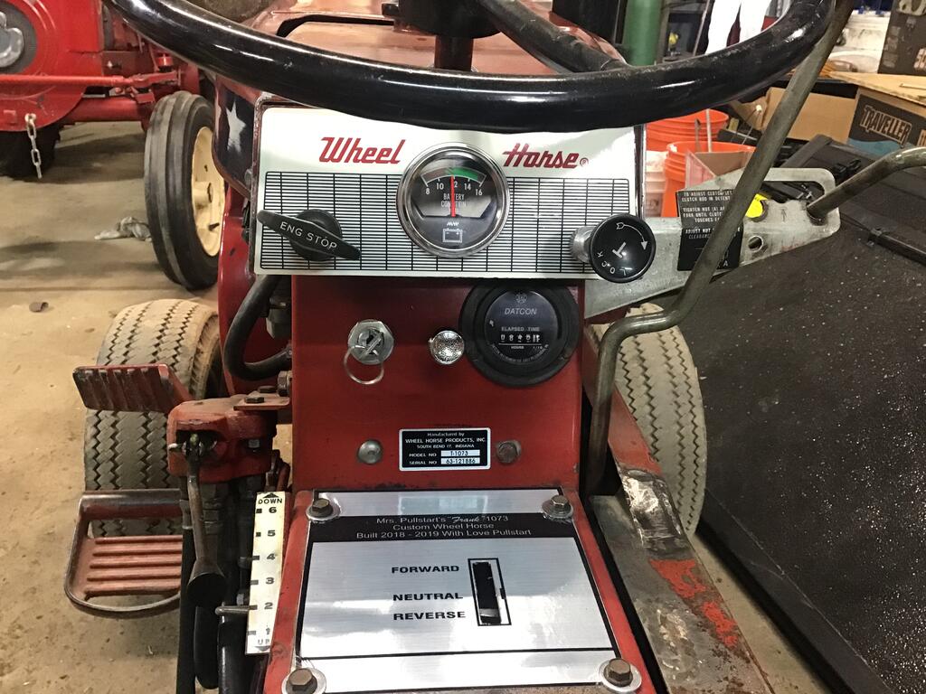

Pullstart 70,804 #831 Posted November 16, 2020 It feels good to say that Frank is finally finished! I’d love to some day get him to quit smoking so much, as in bore and rebuild the engine... but otherwise it is complete and finished “ 2 6 Share this post Link to post Share on other sites

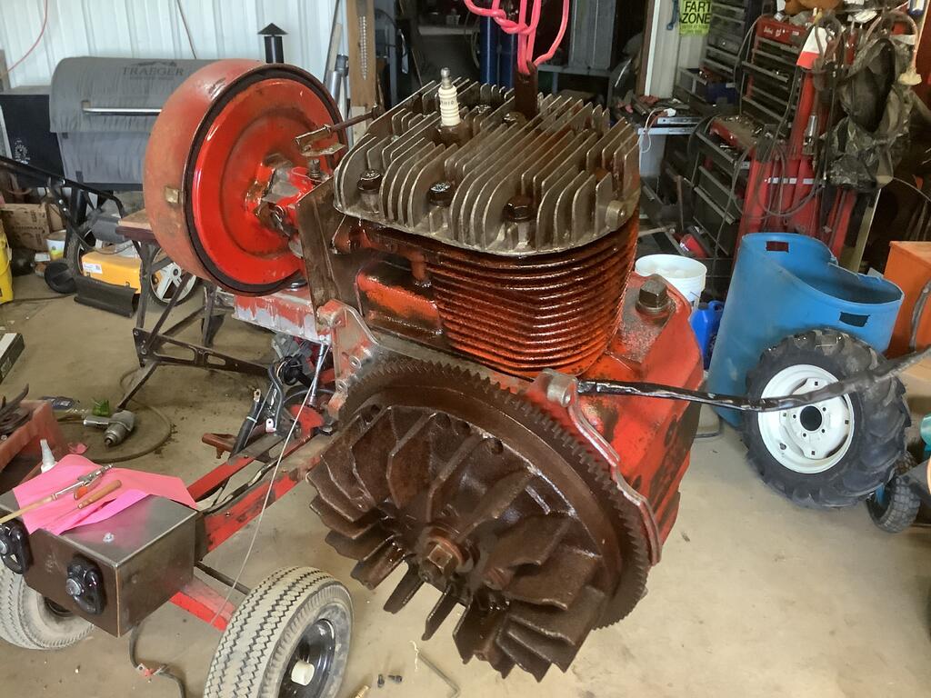

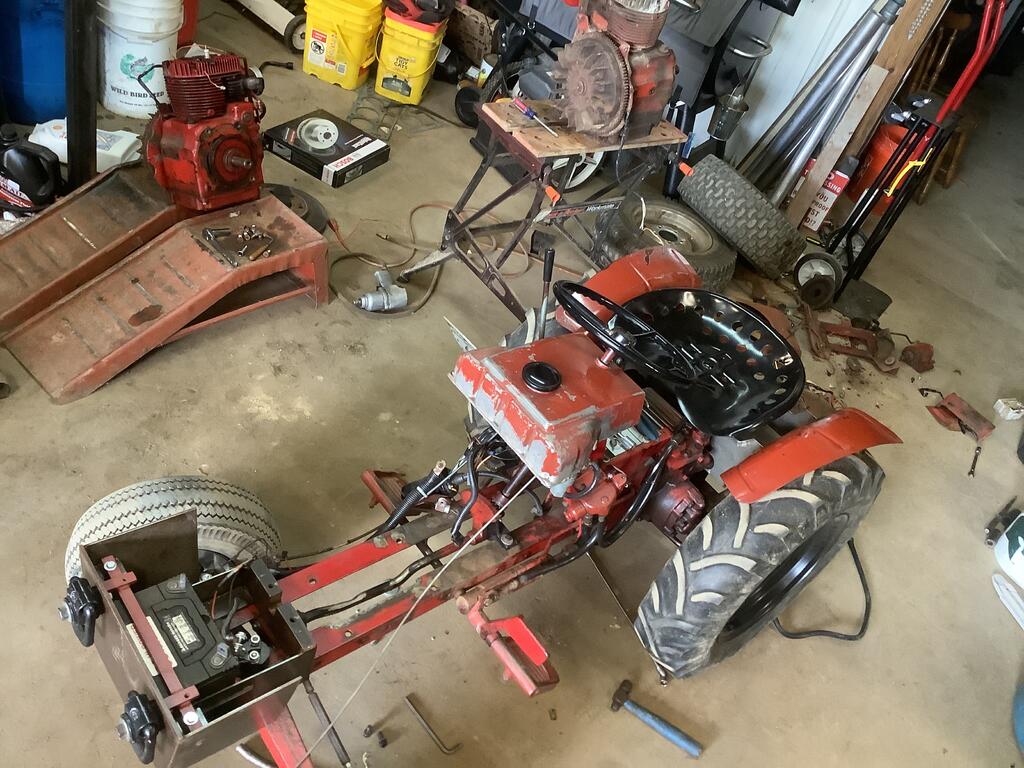

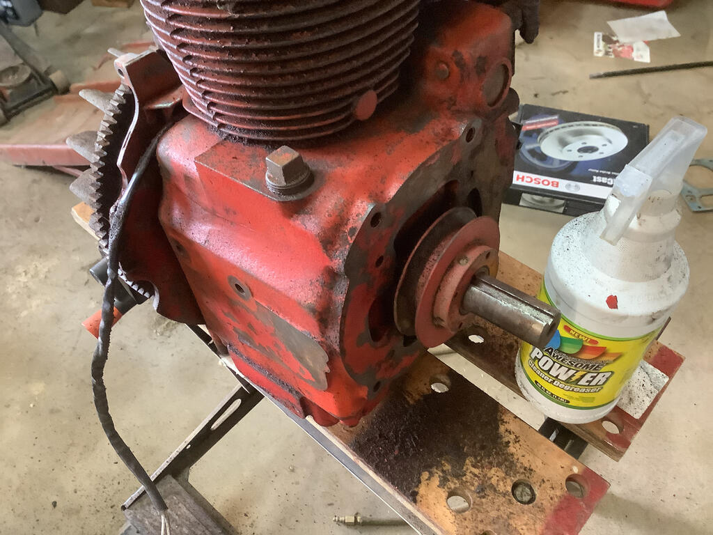

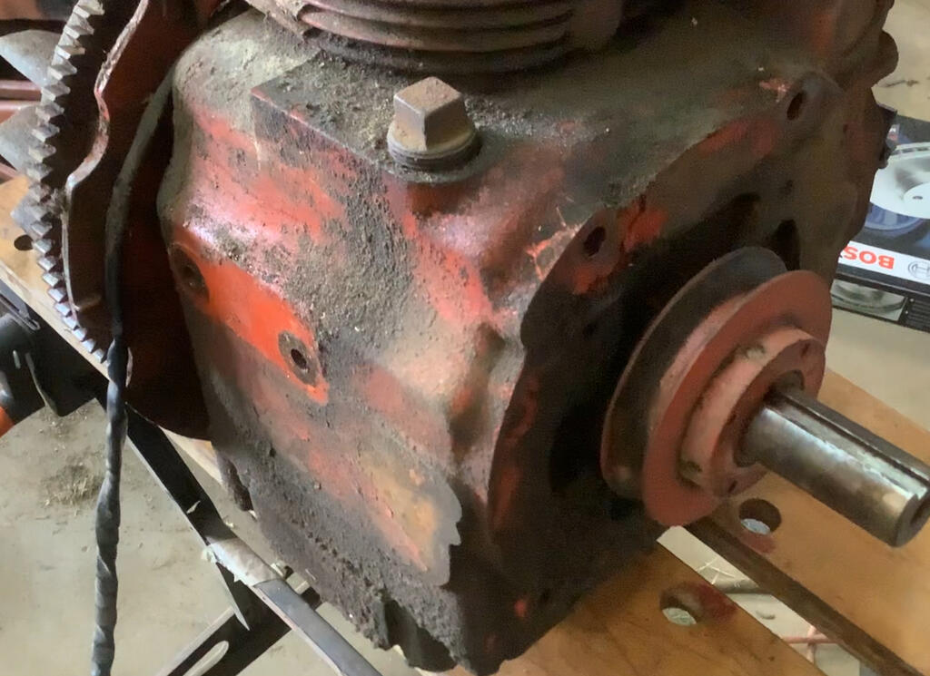

Pullstart 70,804 #838 Posted June 29, 2022 Frank is all kinds of blowed apart! His new engine needs some serious cleaning and some clear coat! 2 Share this post Link to post Share on other sites
Pullstart 70,804 #839 Posted June 29, 2022 Some degreaser to break up the grime… 1 Share this post Link to post Share on other sites

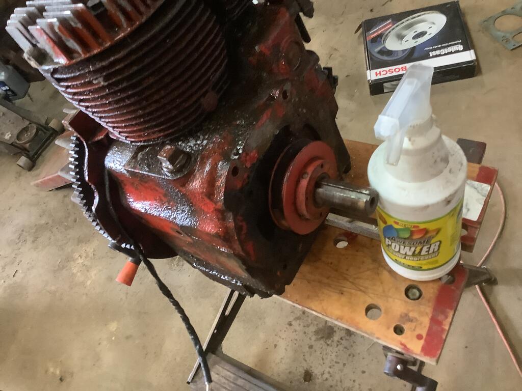

Pullstart 70,804 #840 Posted June 29, 2022 It’s amazing what some soak time and a wire wheel can accomplish! 6 Share this post Link to post Share on other sites
Pullstart 70,804 #841 Posted June 29, 2022 Degreased, washed and clear coated… 4 1 Share this post Link to post Share on other sites

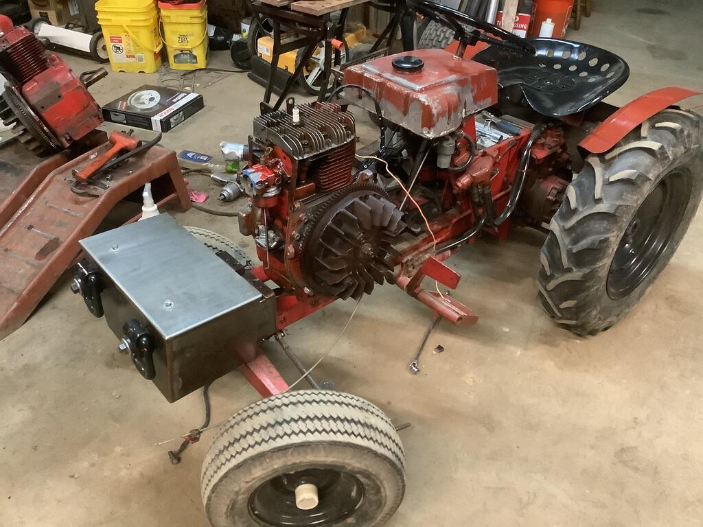

Pullstart 70,804 #842 Posted June 30, 2022 The new mill is sitting in place! Now to re-do everything that I un-doed! 2 4 Share this post Link to post Share on other sites
Pullstart 70,804 #843 Posted June 30, 2022 (edited) For reference, this is the engine I’m putting in. I’ll refrain from using the shroud though. Serial 9183072 The casting tolerance I understand doesn’t need to be perfect here. Well for my bolt holes, it’s too big. It was galling up the clear coat where it was hitting, so I ground down the high spots and smoothed the rest. Waiting for the clear to dry and I’ll stick it back on for another test fit. Yee haw! Edited June 30, 2022 by Pullstart Auto coorrekt 3 Share this post Link to post Share on other sites

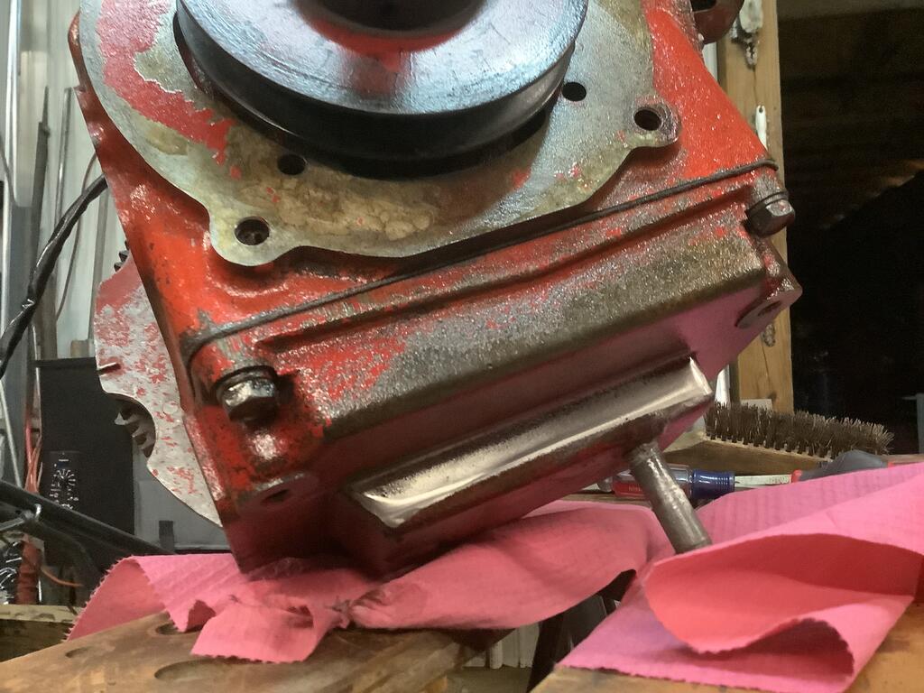

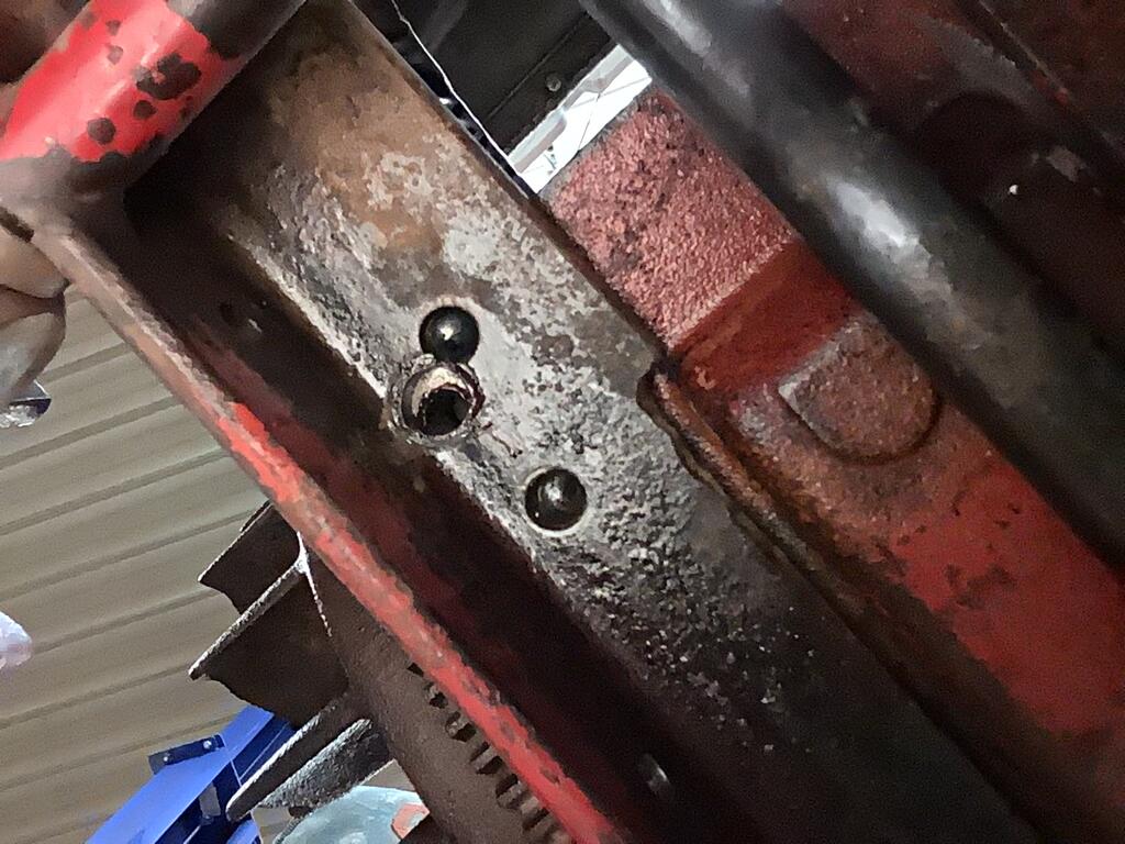

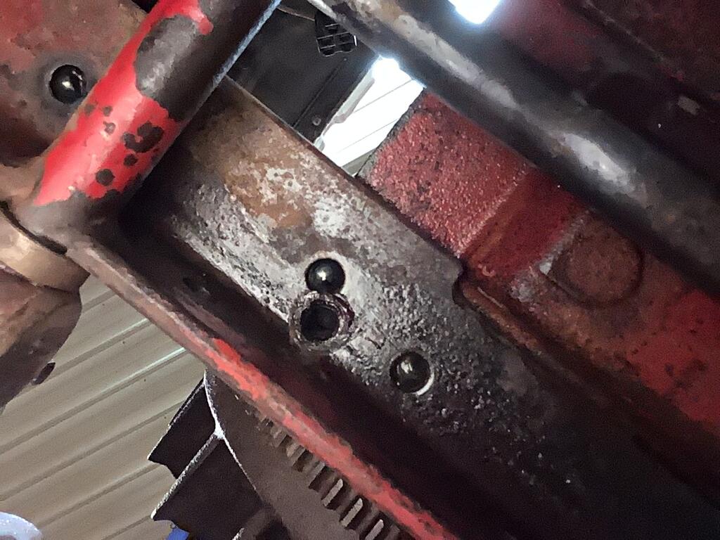

Pullstart 70,804 #844 Posted June 30, 2022 Holes found (thanks to flash photography), threads chased for good measure, bolts greased. The nub looking things are plug welds to fill some p.o. mounting holes. 4 Share this post Link to post Share on other sites

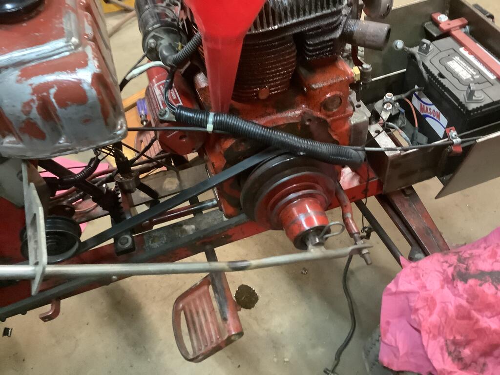

Pullstart 70,804 #845 Posted June 30, 2022 Just had to dump fresh oil all over before I found a funnel…. 4 Share this post Link to post Share on other sites

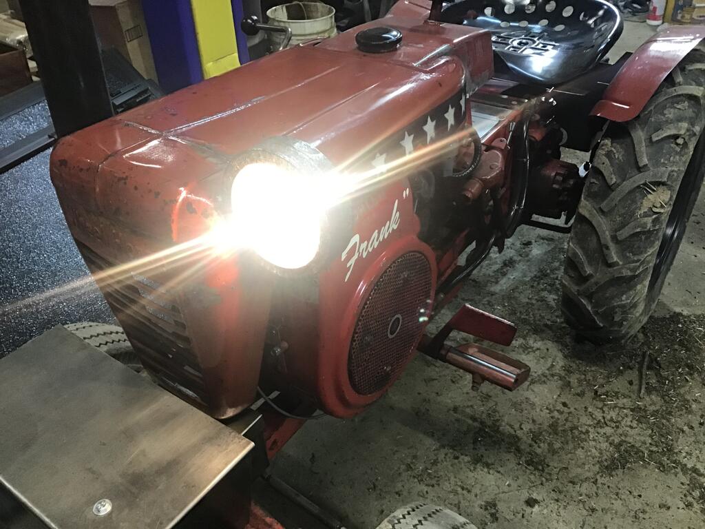

Pullstart 70,804 #846 Posted June 30, 2022 Done! Frank’s fired up and I didn’t even have extra parts! 1 5 Share this post Link to post Share on other sites
