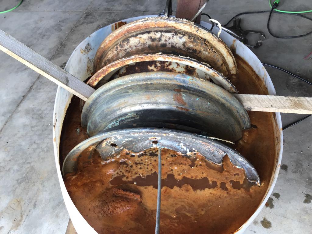

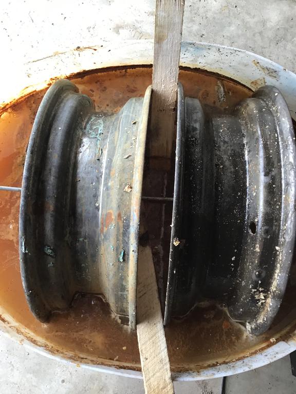

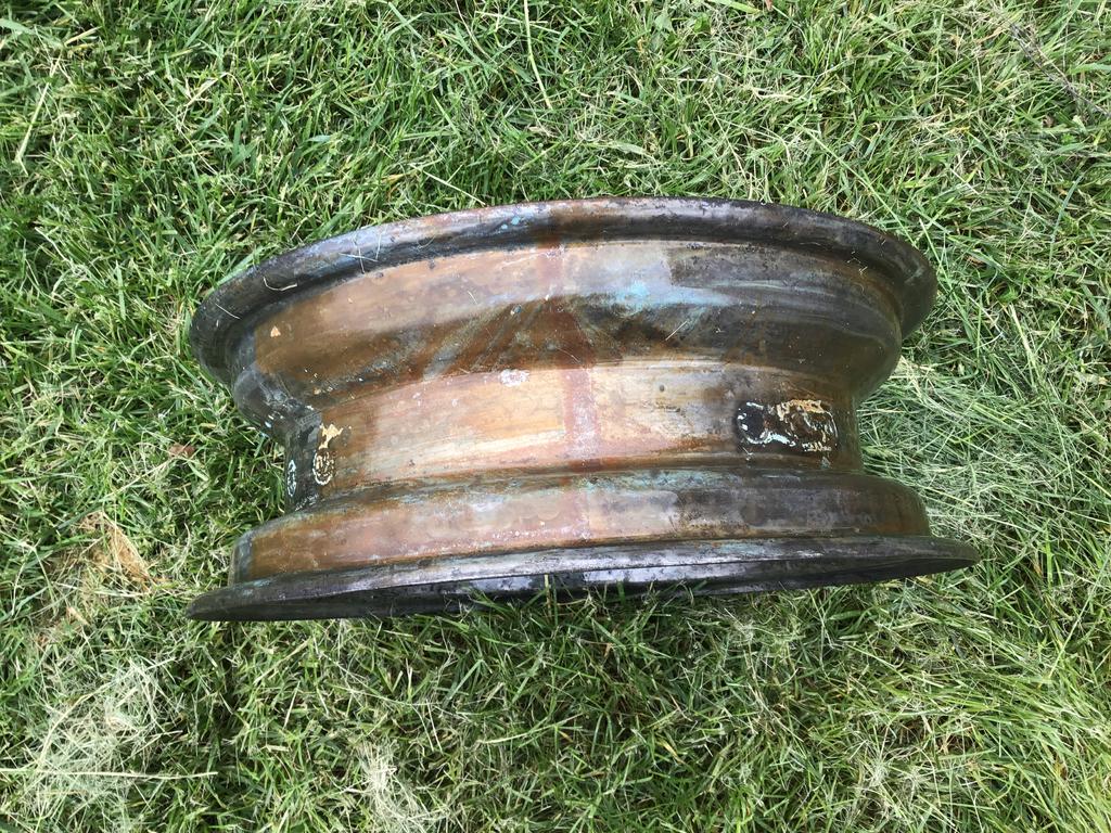

Pullstart 71,378 #676 Posted May 28, 2019 (edited) @Jennifer these pictures were taken 6 minutes apart. The wheels have been inside the dip less than 24 hours. I simply ran the wire brush along the paint that was dried and cracked, now there’s a second bare wheel. No hard work required! it’s quite amazing, really. I’m glad some smart person figured this our for some Neanderthal like me! i found a 2 pack of the Washing Soda (not baking soda) on Amazon, and gave my loving wife the other box for laundry. Edited May 28, 2019 by pullstart Washing soda 4 Share this post Link to post Share on other sites

Jennifer 1,878 #678 Posted May 28, 2019 (edited) 3 hours ago, pullstart said: Metals. anything that is conductive, from what I understand. The 24v is where it’s at today! All the bare steel here was wiped away by hand! Thank you all for your help I found this topic very helpful and interesting to say the lest! Edited May 28, 2019 by Jennifer 4 Share this post Link to post Share on other sites
Pullstart 71,378 #679 Posted May 29, 2019 I have no pictures this morning, but I flipped the wheels inside out yesterday and rotated them this morning. The paint and rust at 24 volts is coming off like melted butter! I imagine tonight I’ll pull them out and pressure wash ‘em, then decide if they need any extra time cooking the hard to reach spots. 1 Share this post Link to post Share on other sites

Pullstart 71,378 #684 Posted May 29, 2019 My battery charger will switch from 12 to 24. I wish I had gotten the 6/12, but now I found a use for it! 1 1 Share this post Link to post Share on other sites

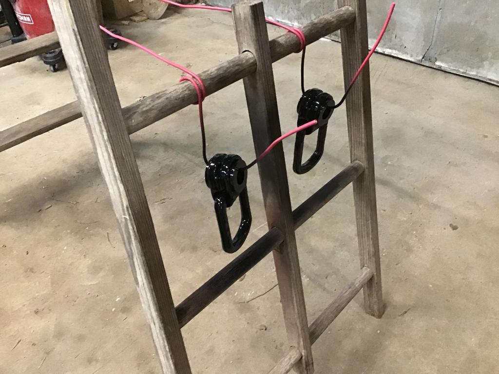

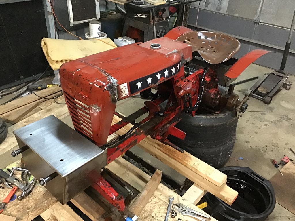

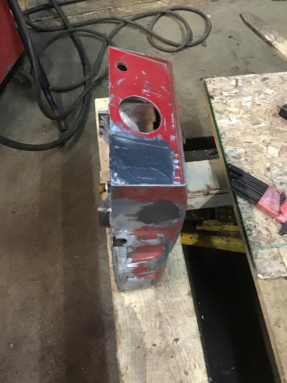

Pullstart 71,378 #688 Posted May 29, 2019 Don’t tell my wife, but I painted a few things! A little contrast to go with the wheels will be a good thing. 2 Share this post Link to post Share on other sites
Pullstart 71,378 #689 Posted May 29, 2019 Doesn’t quite fit.... maybe next project! 2 Share this post Link to post Share on other sites

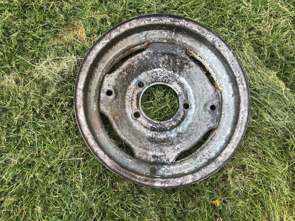

Pullstart 71,378 #690 Posted May 29, 2019 Here is one of the wheels, just rinsed off with the hose. I put it in the dip laying down, then I’ll flip it and swap them out. Share this post Link to post Share on other sites

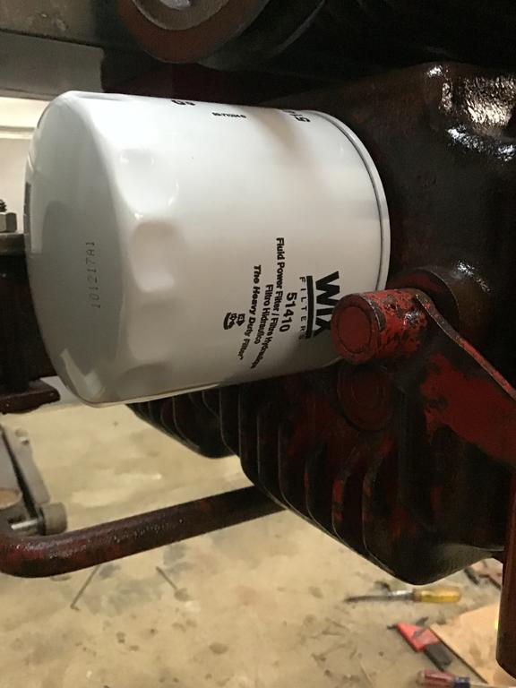

Pullstart 71,378 #691 Posted May 29, 2019 @ebinmaine just to prove I’m not lazy, I put that new trans filter on! 1 Share this post Link to post Share on other sites
ebinmaine 80,970 #692 Posted May 29, 2019 37 minutes ago, pullstart said: @ebinmaine just to prove I’m not lazy, I put that new trans filter on! Share this post Link to post Share on other sites

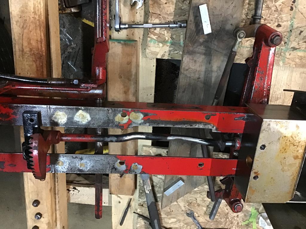

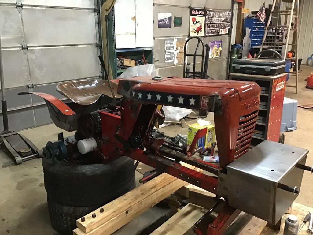

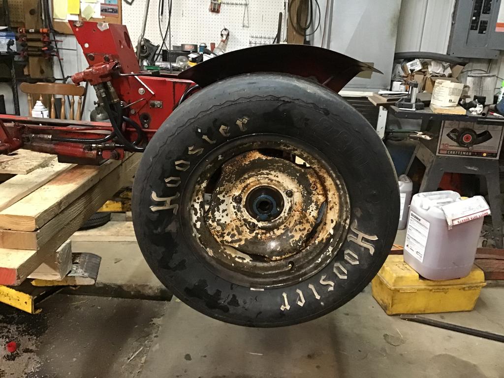

Pullstart 71,378 #695 Posted May 29, 2019 The steering is coming together. It seems though, I am running out of bolts... even though it was together just a couple weeks ago! 1 Share this post Link to post Share on other sites

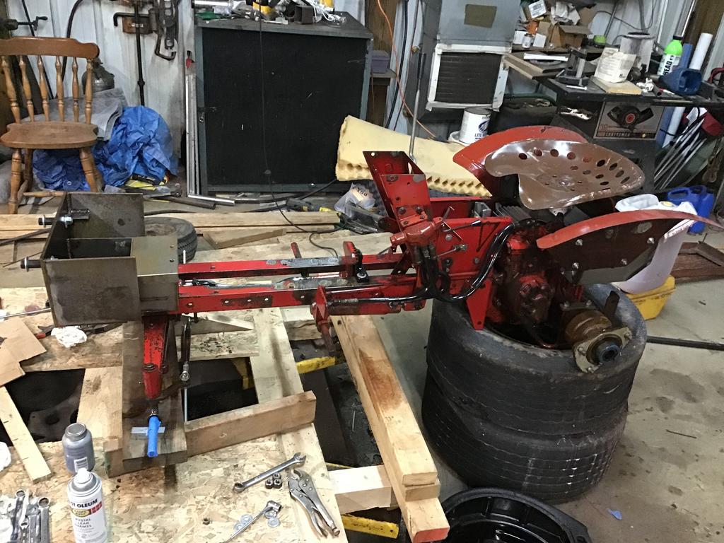

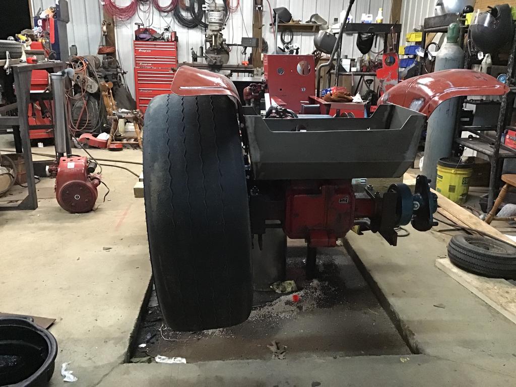

Pullstart 71,378 #697 Posted May 29, 2019 If only I had the wheels finished, this thing could be a roller! The tank got it’s last PC-7 coat today too. 4 Share this post Link to post Share on other sites

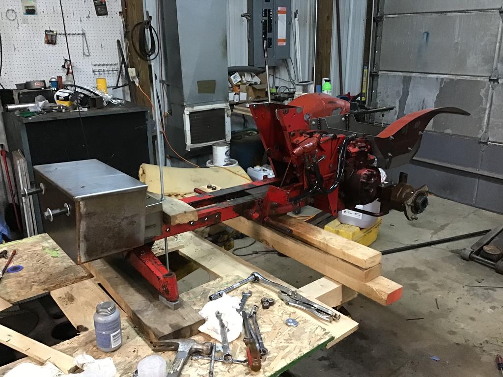

Pullstart 71,378 #700 Posted May 30, 2019 These teaser pictures are teasing me the most! 3 3 Share this post Link to post Share on other sites
