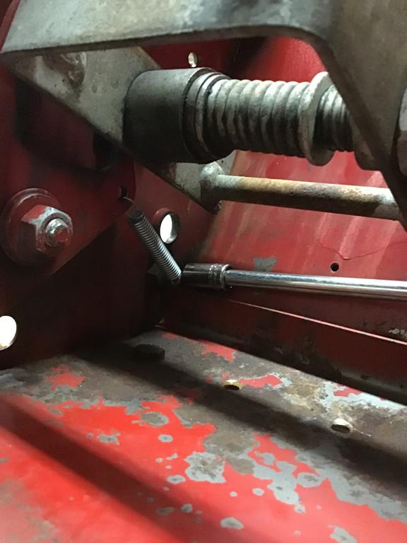

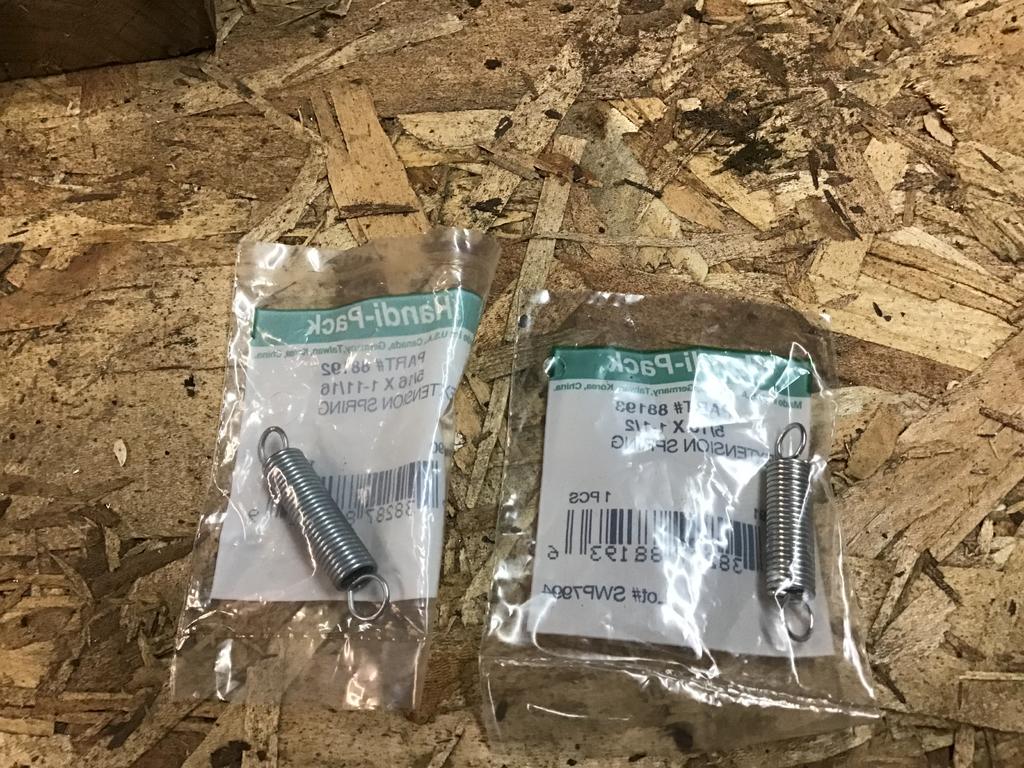

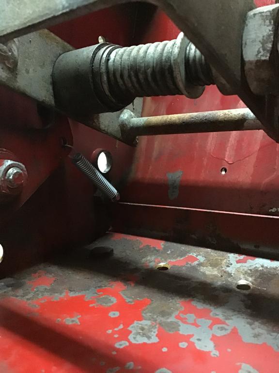

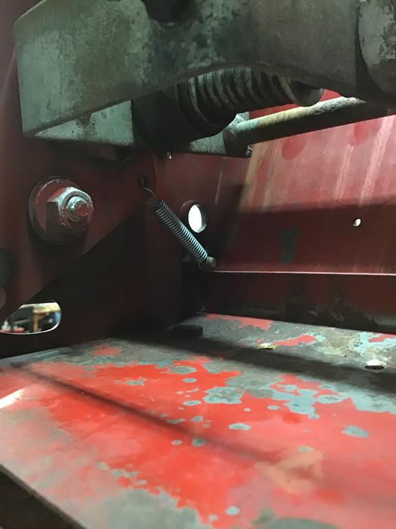

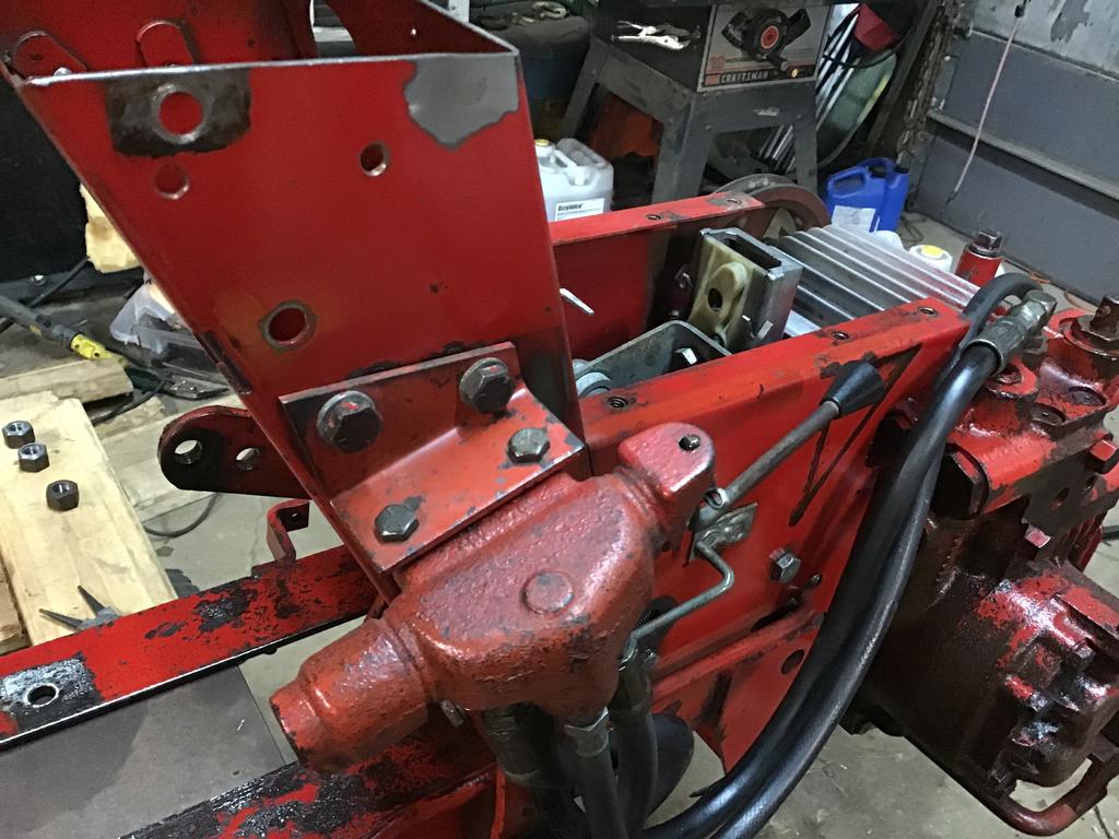

Pullstart 69,806 #659 Posted May 27, 2019 Once one of these here springs jumps onto Frank’s brake linkage, we’ll be marrying two major components together for good. 2 Share this post Link to post Share on other sites

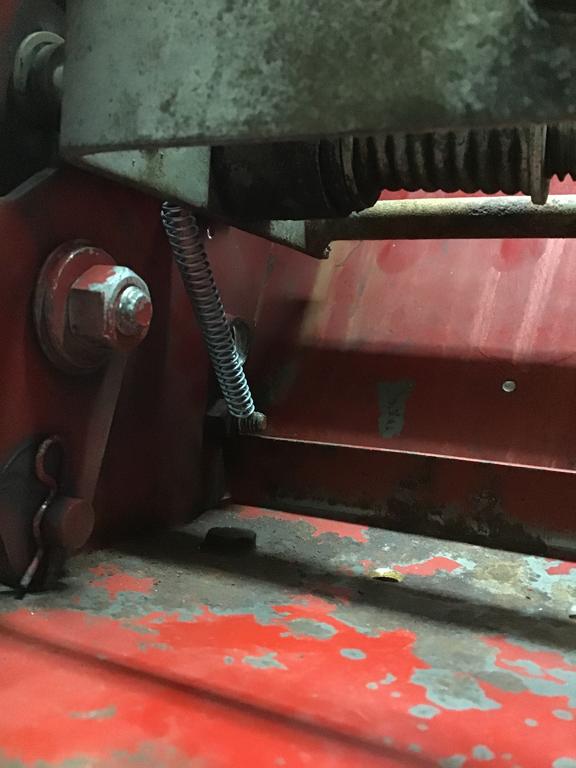

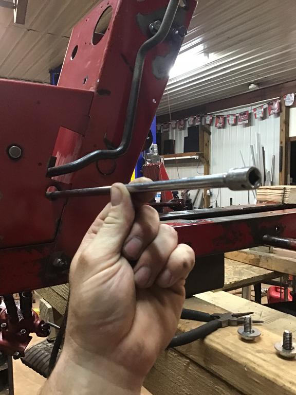

Pullstart 69,806 #660 Posted May 27, 2019 This was the perfect time to replace the spring. I was able to reach in and get it started on the 1/4-20 stud then give it a little push with a long extension and a socket. 6 Share this post Link to post Share on other sites

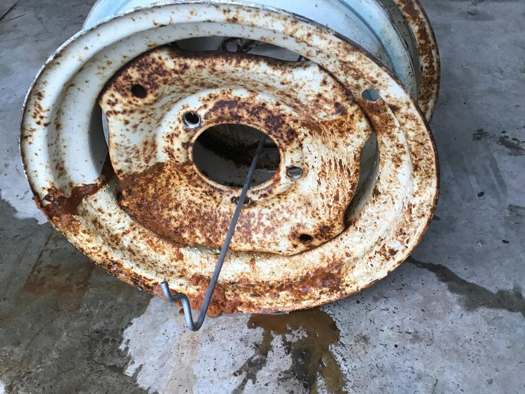

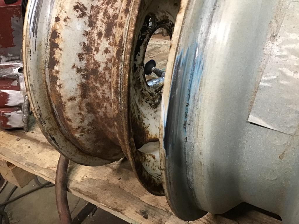

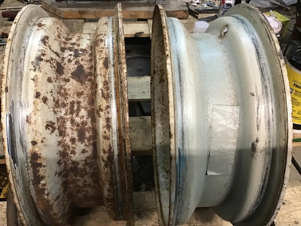

Pullstart 69,806 #662 Posted May 28, 2019 I wonder if these wheels and hubs didn’t come from two different David Bradley tractors. Hubs are different colors and one wheel has an aqua base under the cream color too! 1 Share this post Link to post Share on other sites

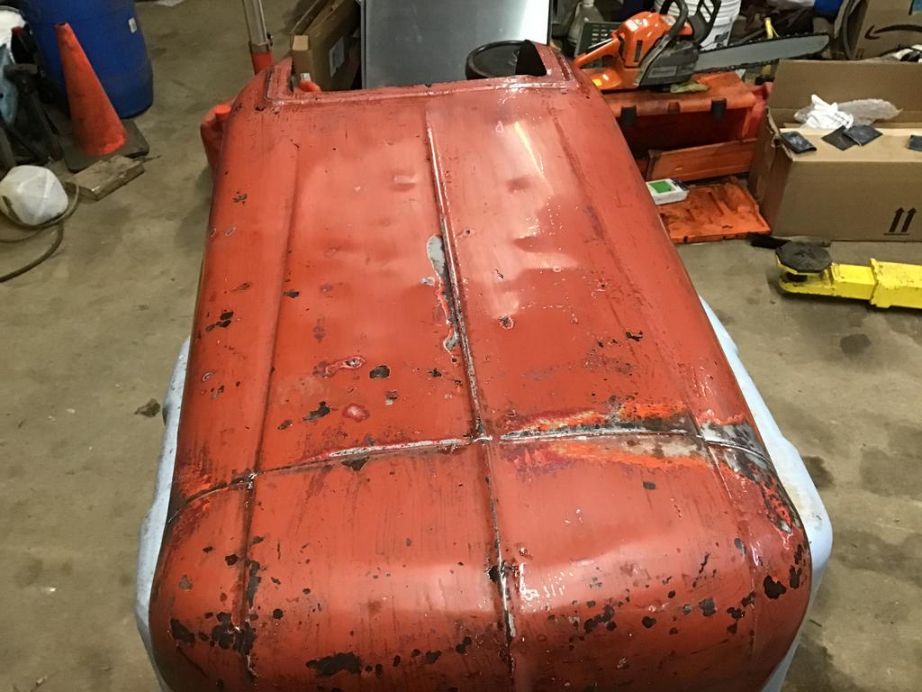

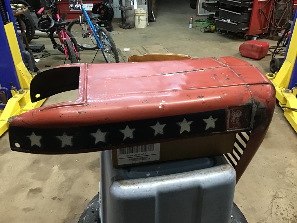

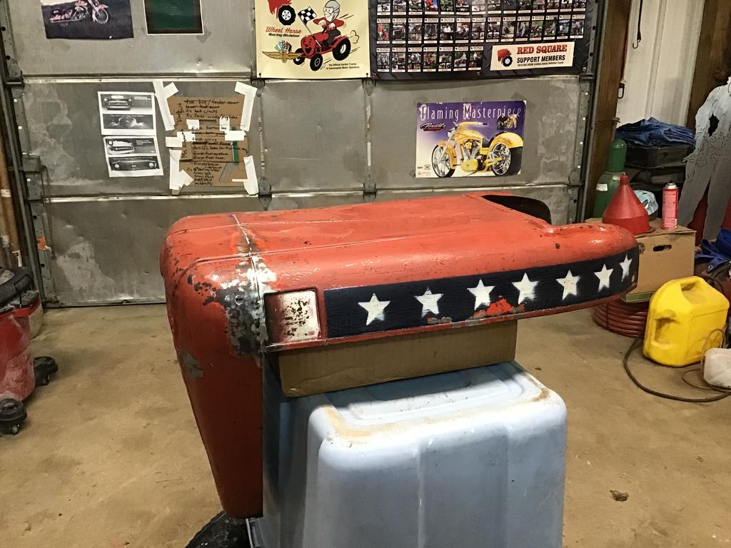

Pullstart 69,806 #663 Posted May 28, 2019 The hood has been wet sanded and final clear sprayed, I say it’s pretty nice 👍 3 2 Share this post Link to post Share on other sites

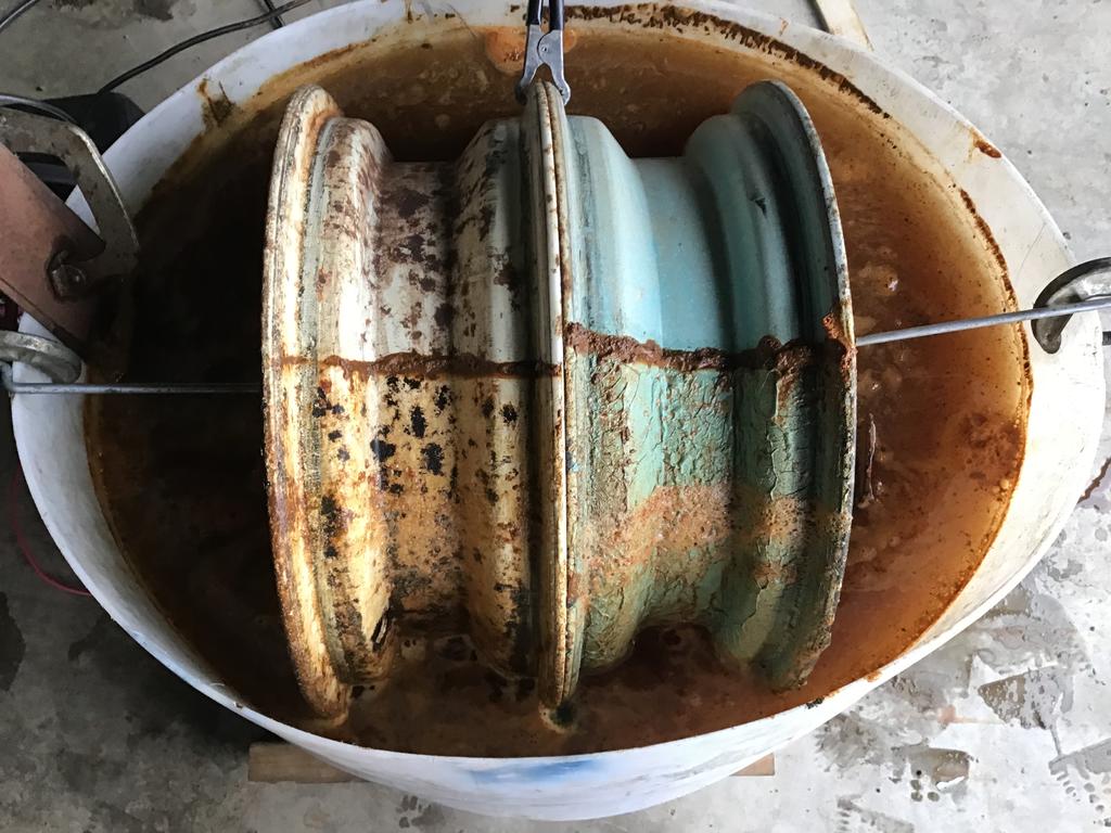

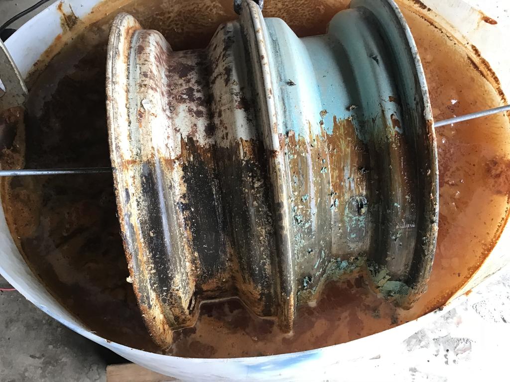

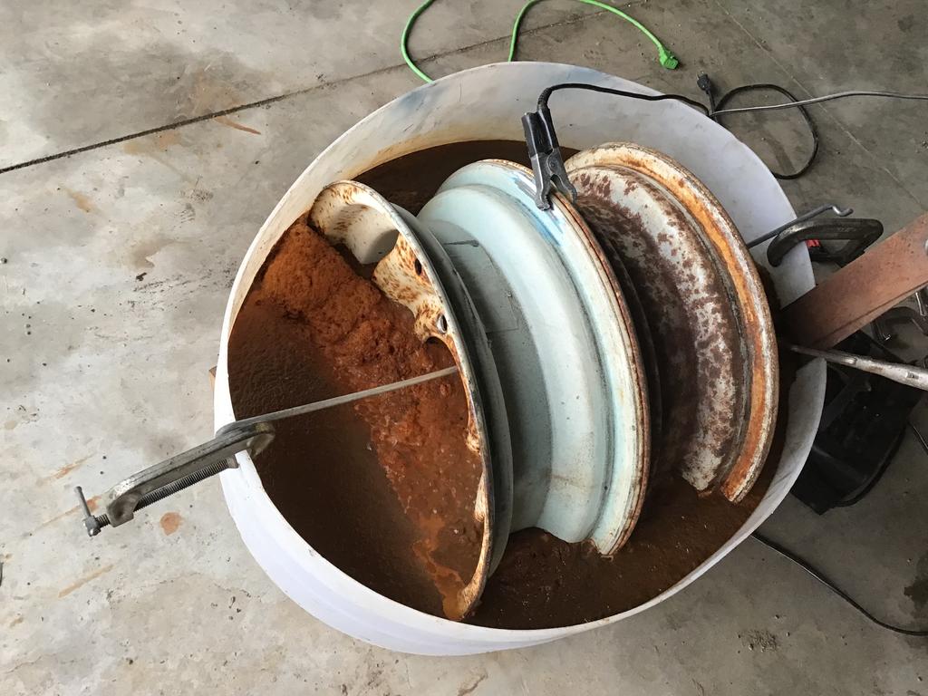

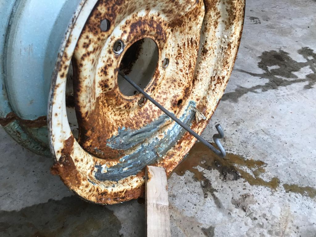

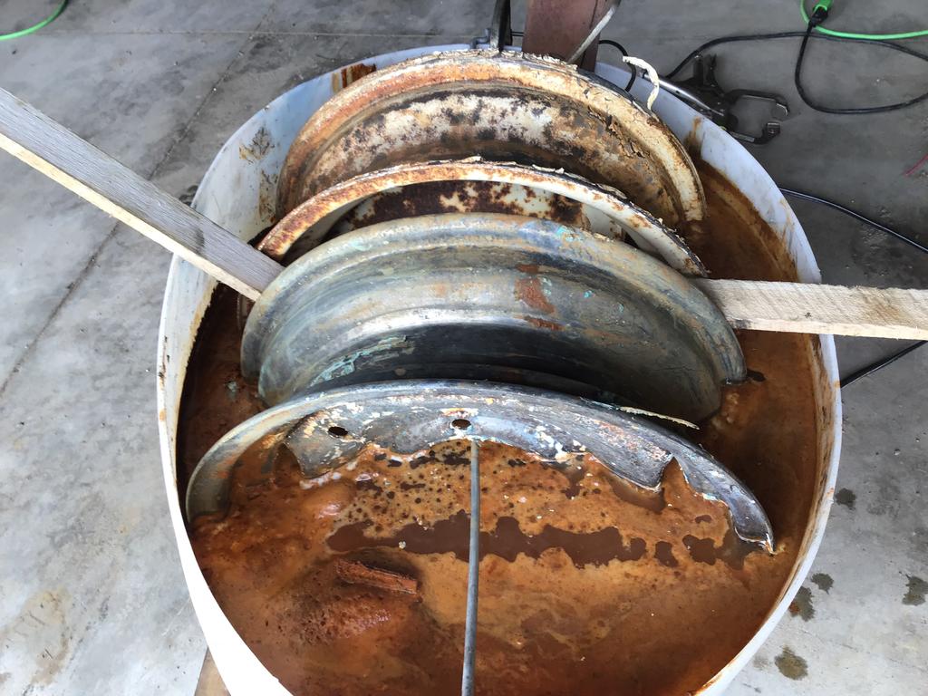

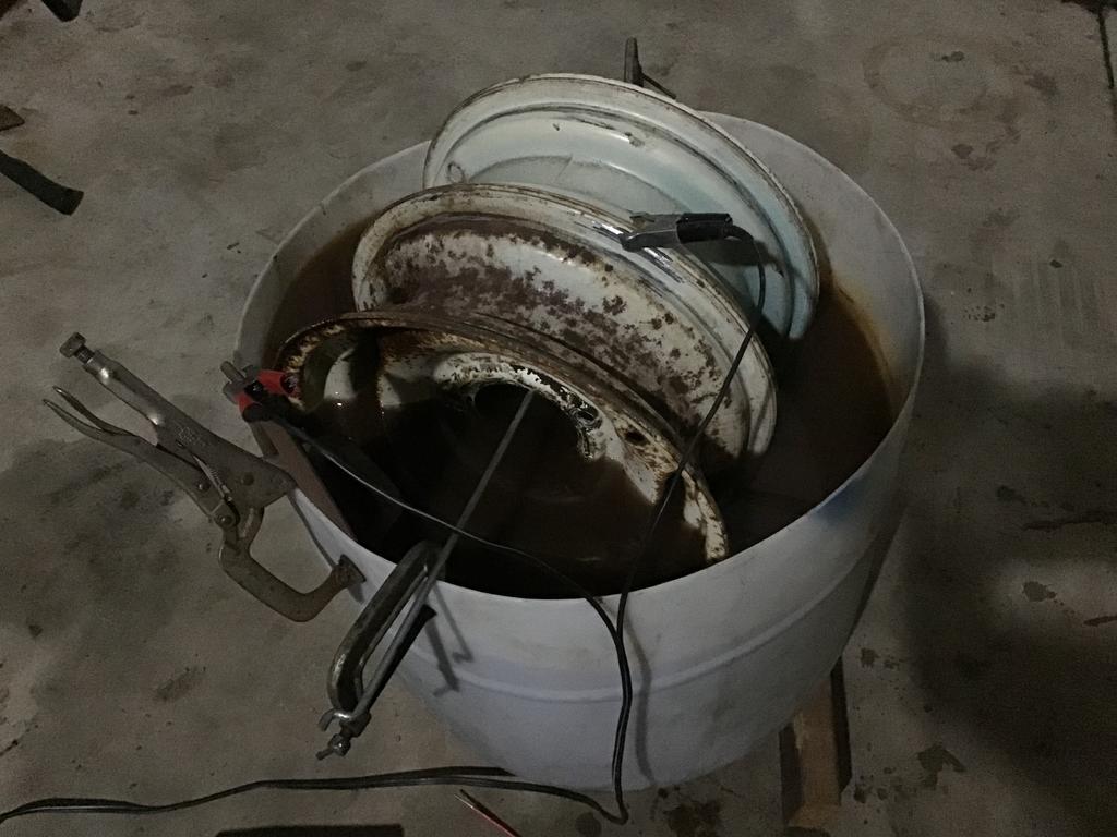

Pullstart 69,806 #664 Posted May 28, 2019 (edited) I bumped the charger up to 24 volts last night, the paint seems to just wipe off this morning! I rotated them about 90 degrees for another dip, then I’ll spin them inside out if needed because there isn’t as much action between the rims without an anode present. Edited May 28, 2019 by pullstart Added a little wire brush action 4 Share this post Link to post Share on other sites

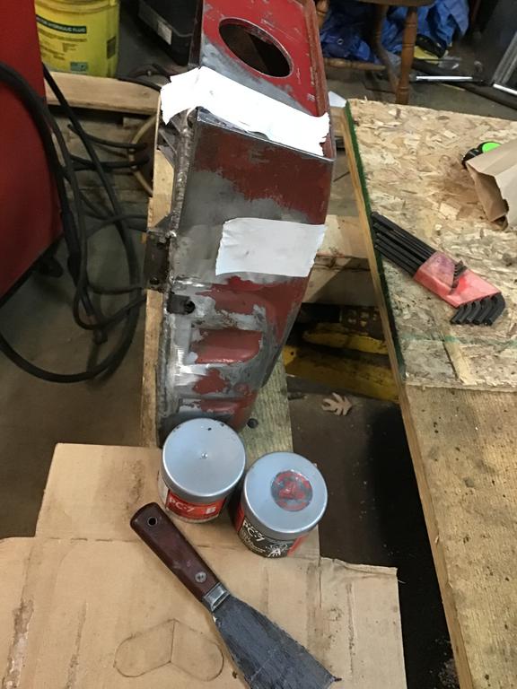

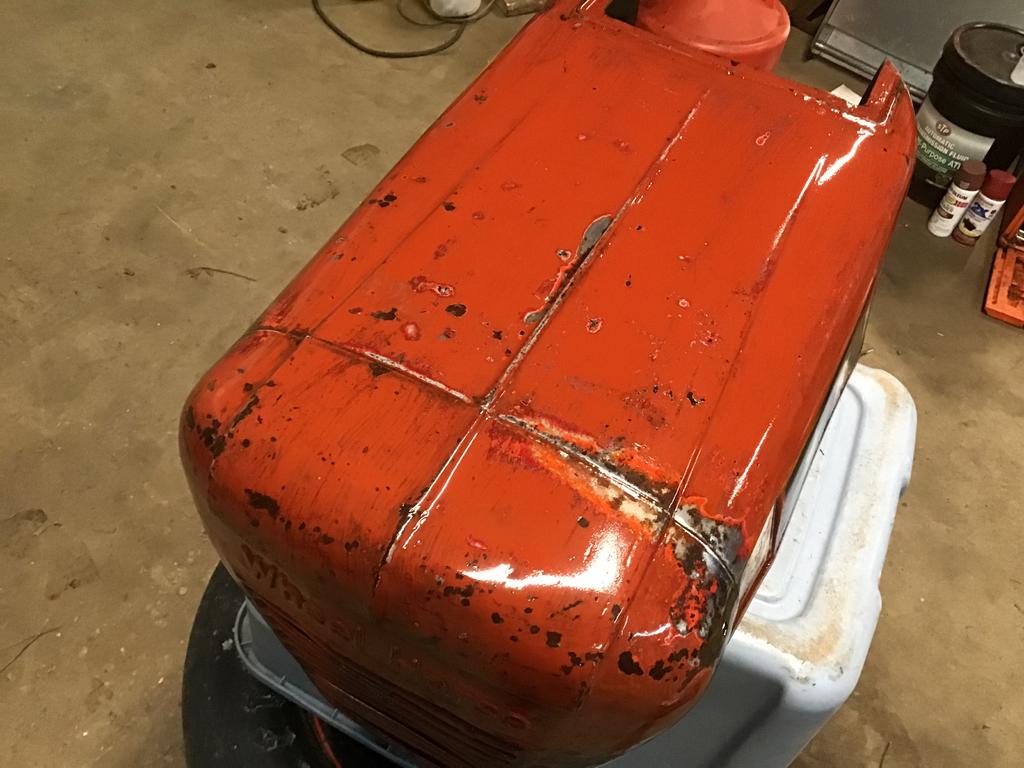

Pullstart 69,806 #665 Posted May 28, 2019 A little body work on the gas tank with PC-7 today, there are a couple slots and holes that need work before wet sanding. I don’t know if there is a proper way to do this, so I covered the majority of the patchwork with duct tape and filled it from the back. I’ll pull the tape, prep the surface and smooth the front whenever it is cured. 2 Share this post Link to post Share on other sites

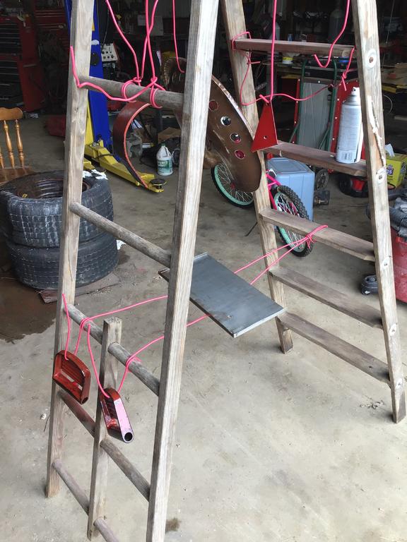

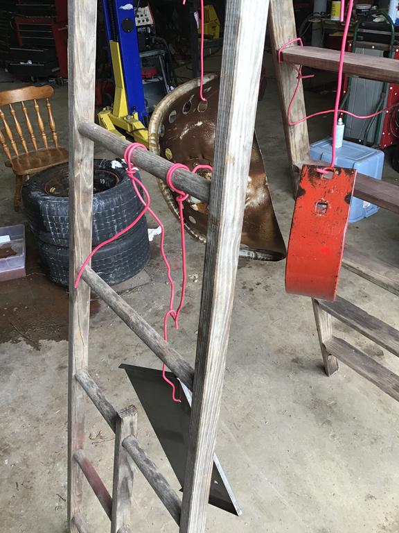

Pullstart 69,806 #666 Posted May 28, 2019 My tractor wind chimes are changing around, I’m getting close to running out of parts to shoot! 2 1 Share this post Link to post Share on other sites

Jennifer 1,878 #668 Posted May 28, 2019 4 hours ago, pullstart said: I bumped the charger up to 24 volts last night, the paint seems to just wipe off this morning! I rotated them about 90 degrees for another dip, then I’ll spin them inside out if needed because there isn’t as much action between the rims without an anode present. I realize that you’re removing paint possibly rust what is this process called. How easy is this to do and what are the benefits!? Thanks! Share this post Link to post Share on other sites
ebinmaine 78,382 #669 Posted May 28, 2019 9 minutes ago, Jennifer said: I realize that you’re removing paint possibly rust what is this process called. How easy is this to do and what are the benefits!? Thanks! Google search e-tank or rust electrolysis Fascinating stuff. 2 Share this post Link to post Share on other sites
Pullstart 69,806 #670 Posted May 28, 2019 8 minutes ago, Jennifer said: I realize that you’re removing paint possibly rust what is this process called. How easy is this to do and what are the benefits!? Thanks! It’s an Electrolysis Tank, Or E-tank. It’s water and washing soda, a plastic tank, a steel “anode” and your part. A 12(-24) volt dc charge from a battery charger, or the like. Ground your part, give the anode a positive charge and you’re off to a clean part! 2 1 Share this post Link to post Share on other sites
Jennifer 1,878 #671 Posted May 28, 2019 1 hour ago, pullstart said: It’s an Electrolysis Tank, Or E-tank. It’s water and washing soda, a plastic tank, a steel “anode” and your part. A 12(-24) volt dc charge from a battery charger, or the like. Ground your part, give the anode a positive charge and you’re off to a clean part! Thanks so much for the detailed info very helpful going to give it a try!! Every new tip is helpful working on these fabulously addictive horses!!!! 1 Share this post Link to post Share on other sites
ebinmaine 78,382 #672 Posted May 28, 2019 16 minutes ago, Jennifer said: Thanks so much for the detailed info very helpful going to give it a try!! Every new tip is helpful working on these fabulously addictive horses!!!! Check these videos out. They were helpful to me. 1 Share this post Link to post Share on other sites
Jennifer 1,878 #673 Posted May 28, 2019 2 minutes ago, ebinmaine said: Check these videos out. They were helpful to me. What all metals are able to be dipped Share this post Link to post Share on other sites
Pullstart 69,806 #674 Posted May 28, 2019 2 minutes ago, Jennifer said: What all metals are able to be dipped Metals. anything that is conductive, from what I understand. The 24v is where it’s at today! All the bare steel here was wiped away by hand! Share this post Link to post Share on other sites
ebinmaine 78,382 #675 Posted May 28, 2019 1 minute ago, Jennifer said: What all metals are able to be dipped I'm not exactly what you would call the definitive authority on this but I gather that it's iron or steel. The reaction is intended to remove or change RUST. Share this post Link to post Share on other sites
