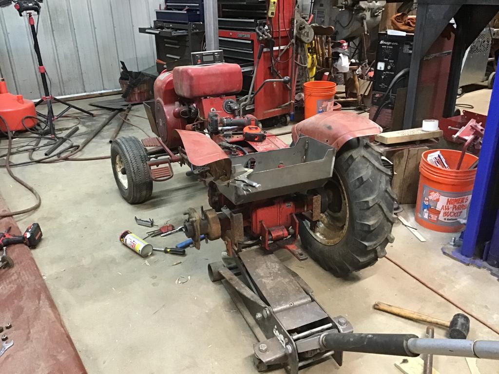

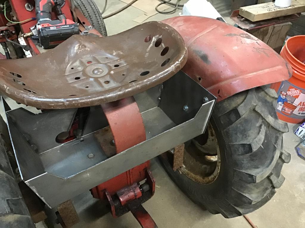

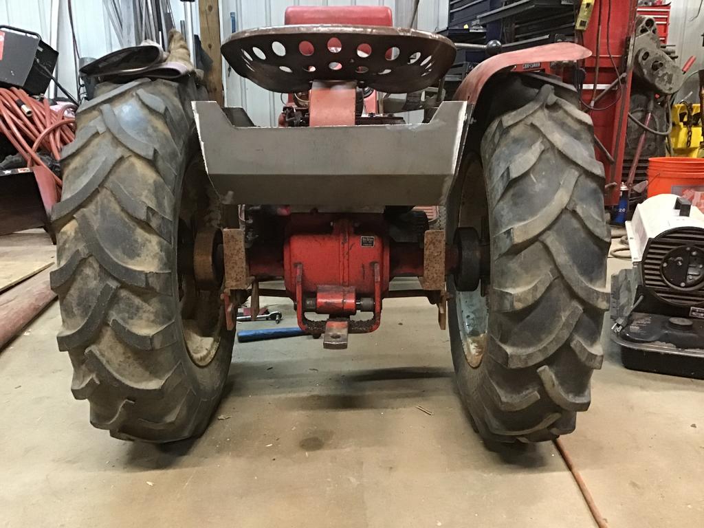

Pullstart 71,368 #352 Posted January 7, 2019 I’ve got some trimmin’ and tackin’ to do on the rear to make it square and tight. 2 4 Share this post Link to post Share on other sites

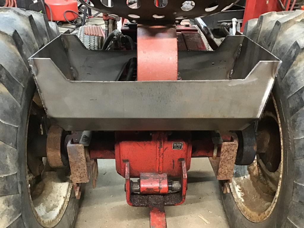

19richie66 17,937 #358 Posted January 7, 2019 So how did you end up bending it? Share this post Link to post Share on other sites
Pullstart 71,368 #359 Posted January 7, 2019 34 minutes ago, 19richie66 said: So how did you end up bending it? Ball end mill to make the groove, then clamped it to a bench, and clamped a thicker piece of steel to the “tab” needing bending for the front. The sides I pushed down against the bench with the box upside down and the rear, with the front tacked up I clamped some OSB to the back of the panel and lifted it up. Worked pretty slick, just had to move clamps and my force a bit with the wide pieces. It wasn’t too difficult, I’m glad for the grooves for sure! 3 1 Share this post Link to post Share on other sites

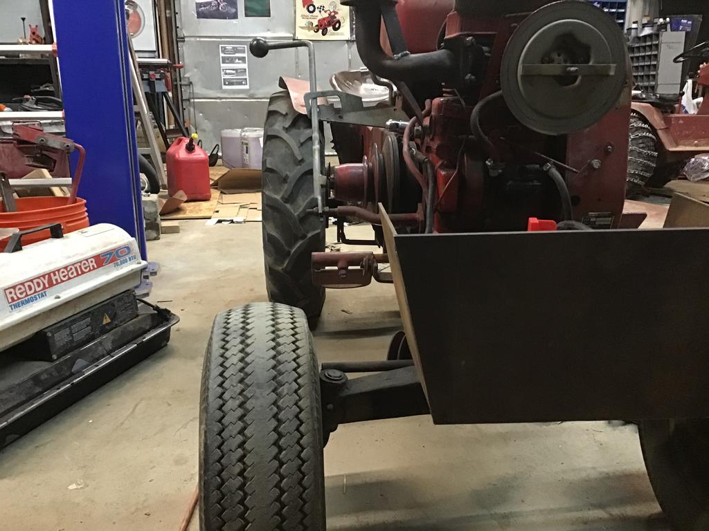

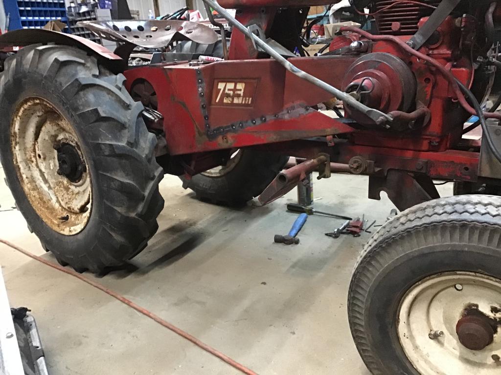

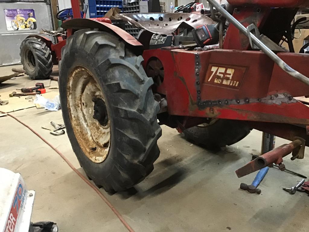

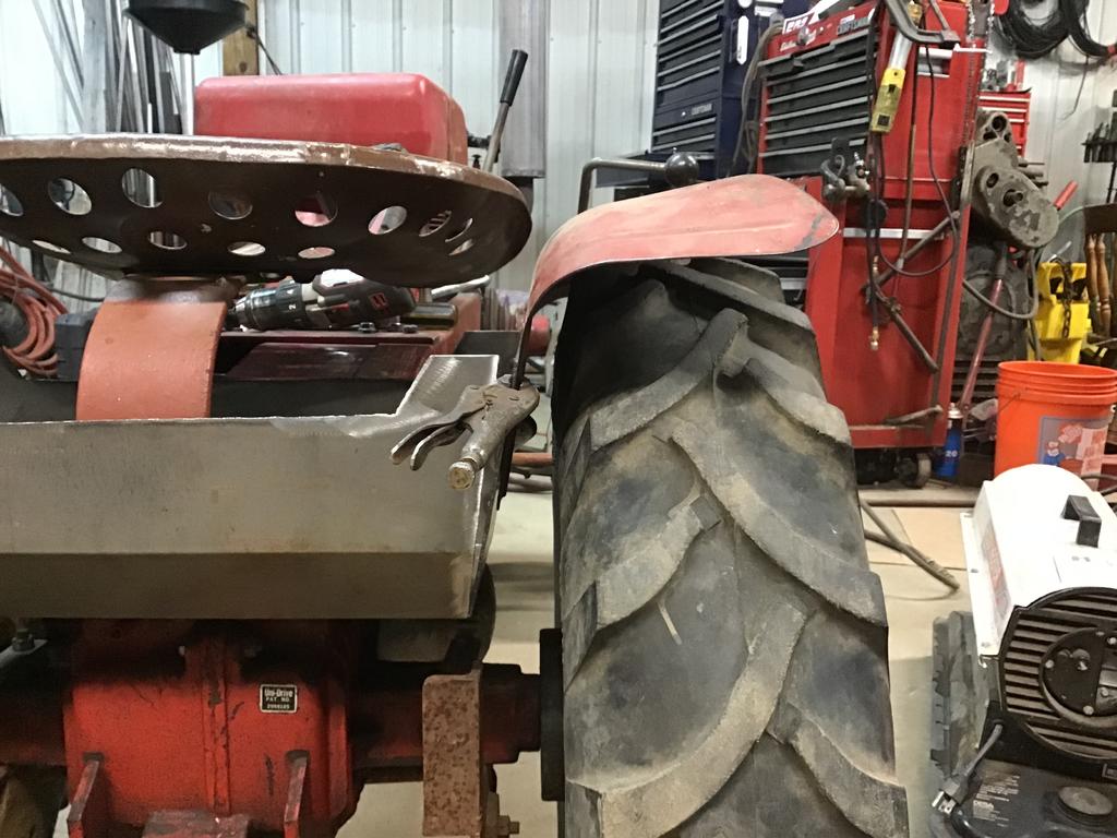

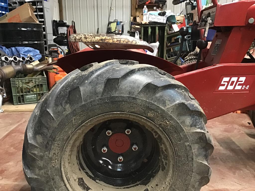

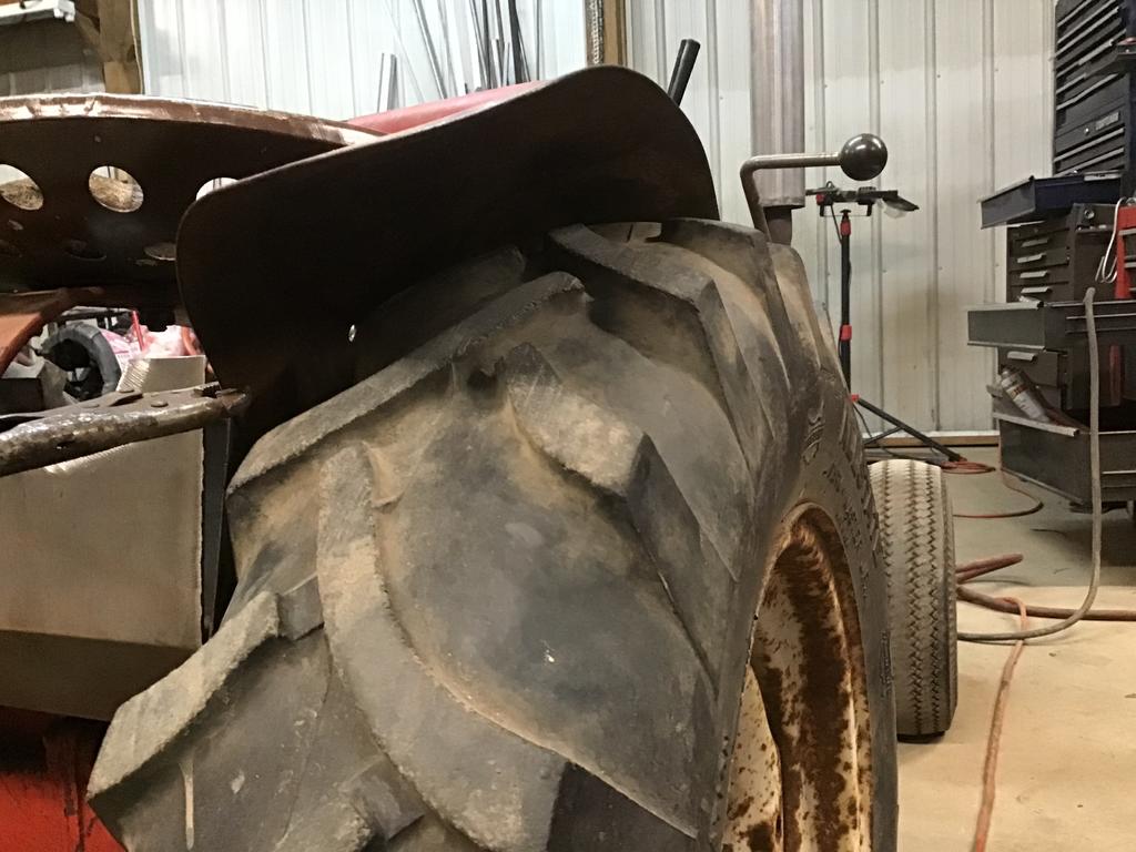

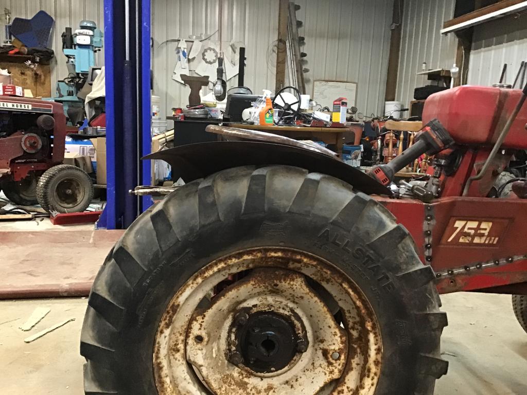

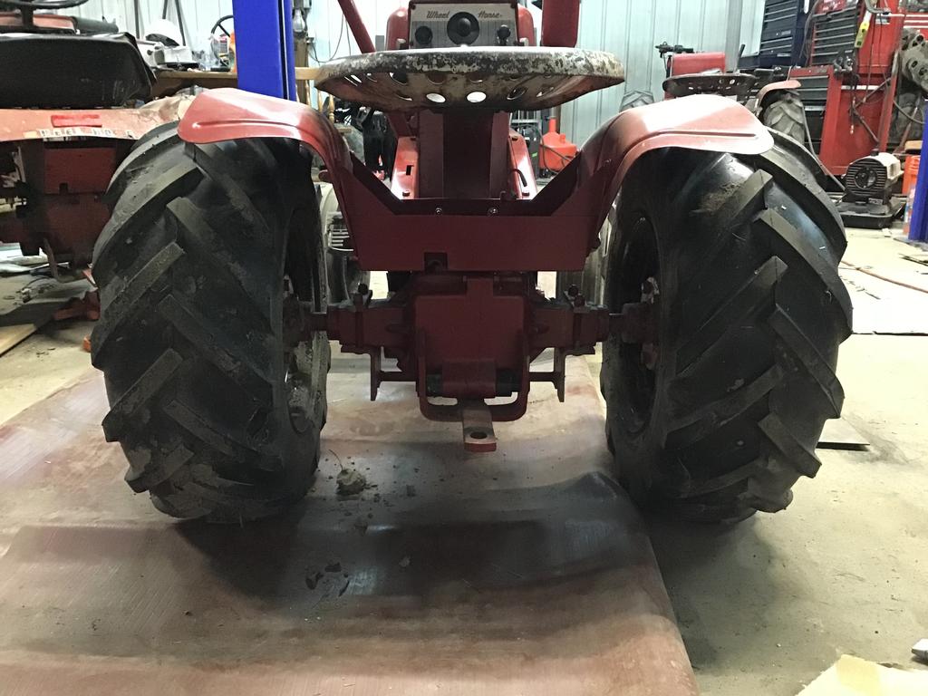

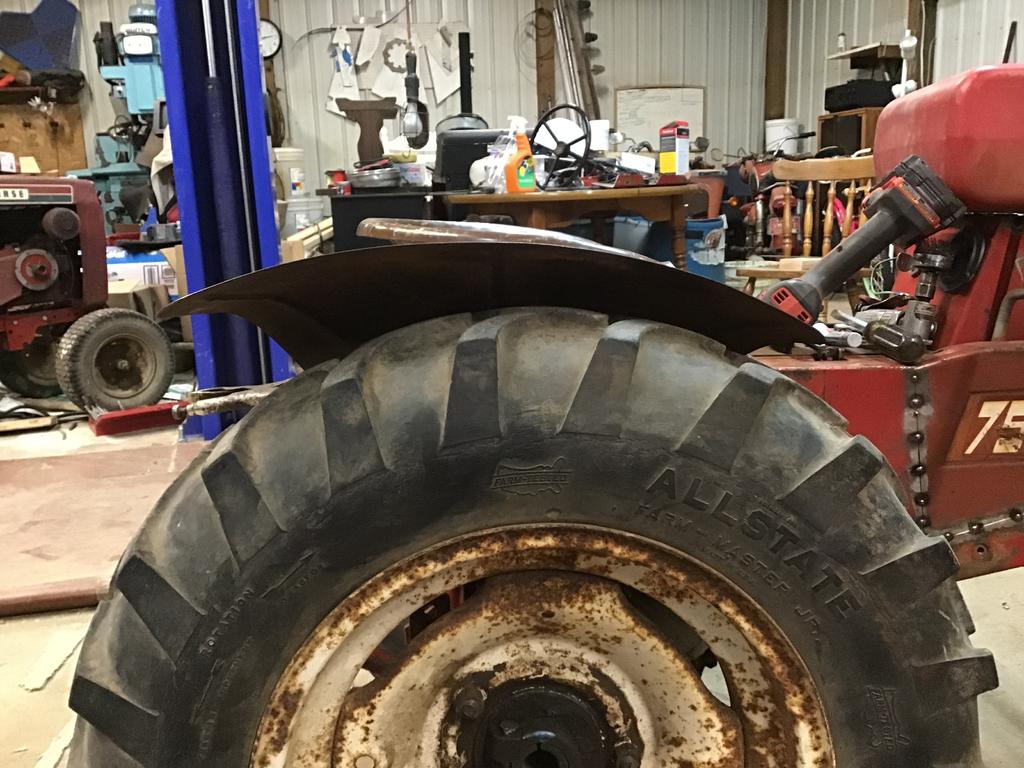

Pullstart 71,368 #360 Posted January 9, 2019 Playing around with fender placement.... I currently have about 1” clearance between the tire and fender. A couple of my filthy Putt Putt for my only reference... initial placement... current standings... 5 Share this post Link to post Share on other sites
Pullstart 71,368 #361 Posted January 9, 2019 Remembered the 753 donor had a set of stirrups. I might have to bag the floorboard idea. 1 Share this post Link to post Share on other sites
Chris G 3,392 #362 Posted January 9, 2019 The tool box and fender placement look pretty good and the stirrups seem to fit well. Great job on that box though. 1 Share this post Link to post Share on other sites

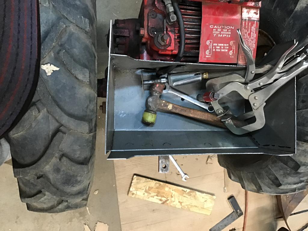

Pullstart 71,368 #363 Posted January 9, 2019 Look Ma, no clamps! 1 5 2 Share this post Link to post Share on other sites

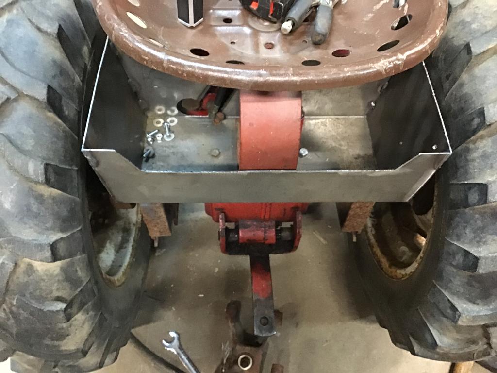

Pullstart 71,368 #372 Posted January 10, 2019 Finished tacking it up! 3 1 1 Share this post Link to post Share on other sites
