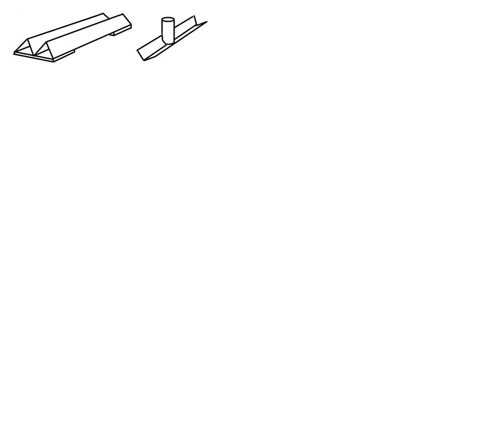

Tractorhead 9,217 #333 Posted January 6, 2019 (edited) 19 hours ago, pullstart said: Please do share picture examples of the lifts, I haven’t seen an Iseki? Thinking on this 3Point just to demonstrate what i mean.. Edited January 6, 2019 by Tractorhead Pic changed 1 Share this post Link to post Share on other sites
Pullstart 69,195 #334 Posted January 6, 2019 I wonder, could a 3 point lift like that be powered via linkage (rock shaft?) from the bottom hydraulic lift lever? I haven’t looked at too many before and Mrs. Pullstart’s Allis Chalmers has an unconventional snap coupler lift. 1 Share this post Link to post Share on other sites
953 nut 64,599 #335 Posted January 6, 2019 10 minutes ago, pullstart said: I wonder, could a 3 point lift like that be powered via linkage (rock shaft?) from the bottom hydraulic lift lever? I haven’t looked at too many before and Mrs. Pullstart’s Allis Chalmers has an unconventional snap coupler lift. Given the desire to do it and your skills and tools I know you could do it. 1 2 Share this post Link to post Share on other sites
Tractorhead 9,217 #336 Posted January 6, 2019 I just mentioned, because i think you have allready a Hydro Gear and be so prepared for hydraulic applications. Things you maybe additional need was: a hydraulic valve 2Way with pass thru and a double action cylinder. The rest will be simple( but stable) mechanics. i'm conform with @953 nut you are able to make it happen. 👍 I see several additional benefits for. 1 1 Share this post Link to post Share on other sites

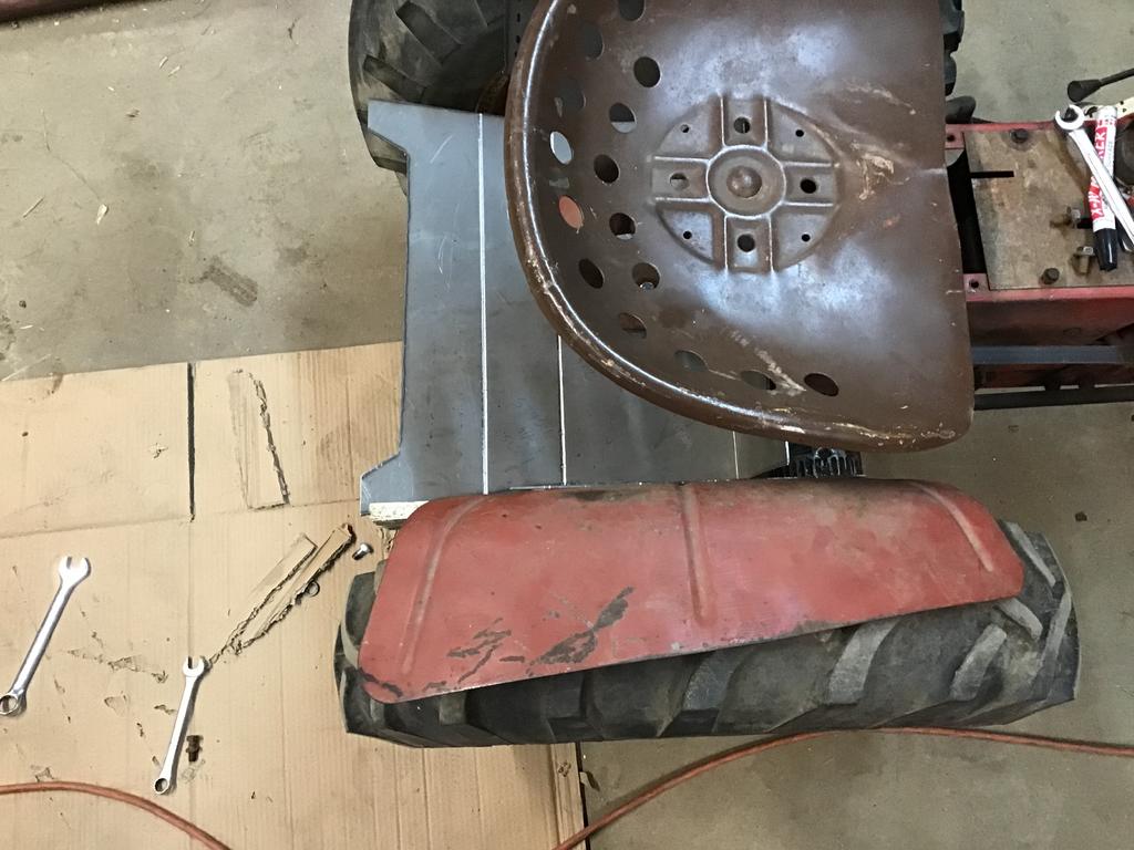

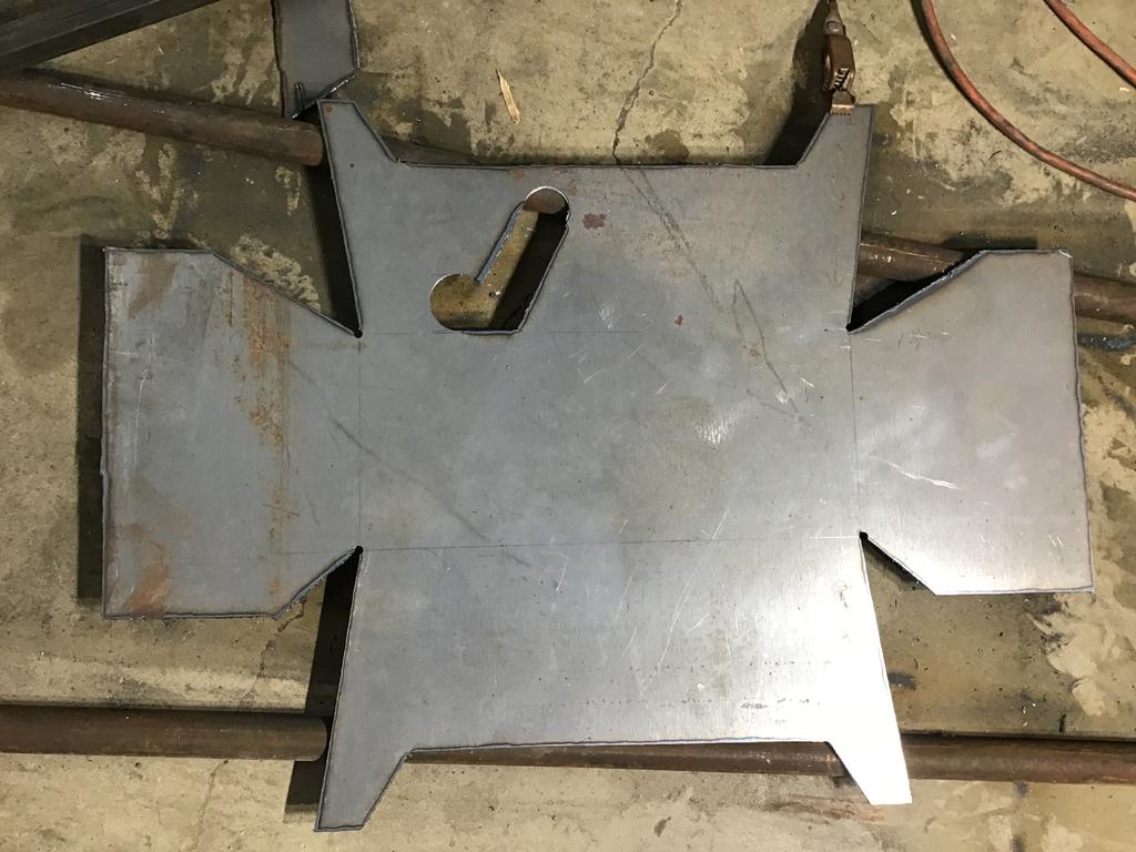

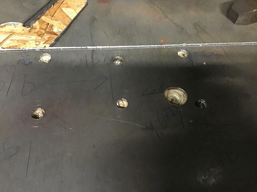

Pullstart 69,195 #337 Posted January 7, 2019 Well, well... Time to lay out the clearance and mounting holes, I s’pose. 1 Share this post Link to post Share on other sites

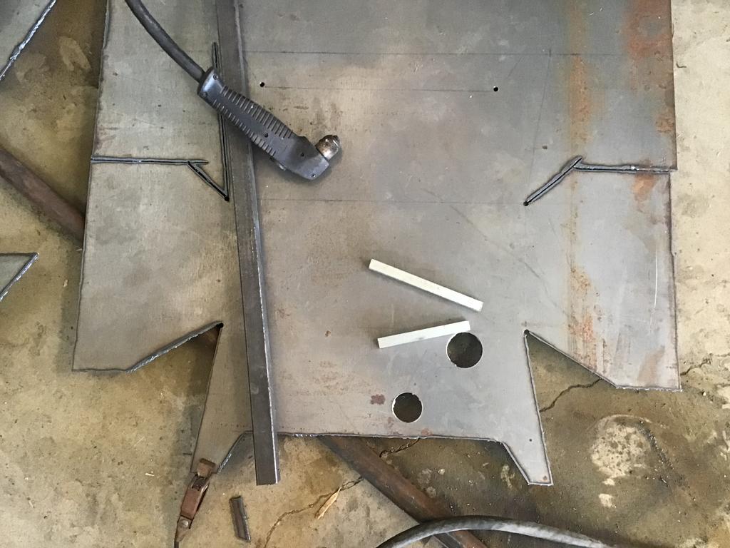

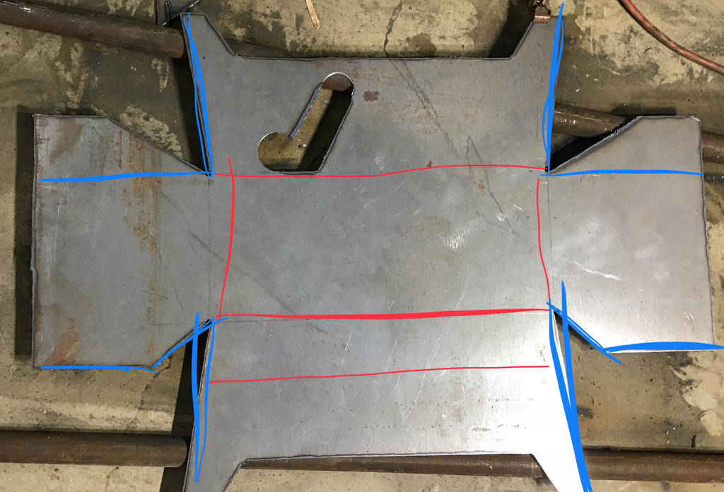

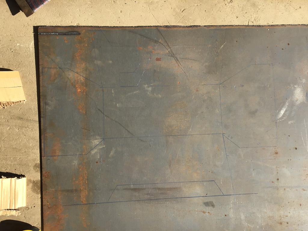

Pullstart 69,195 #338 Posted January 7, 2019 I don’t have a sheet metal brake capable of attacking this job, so I’ve been daydreaming about my next step. the red lines indicate a brake, the blue lines will be mating surfaces once complete. Any sheet metal advice fellas? I contemplate scoring the brake lines part way with a ball end mill on the Bridgeport, but I imagine there’s any easier way? .090” stock. I doubt I can clamp it to a bench and hand bend it uniformly. Share this post Link to post Share on other sites

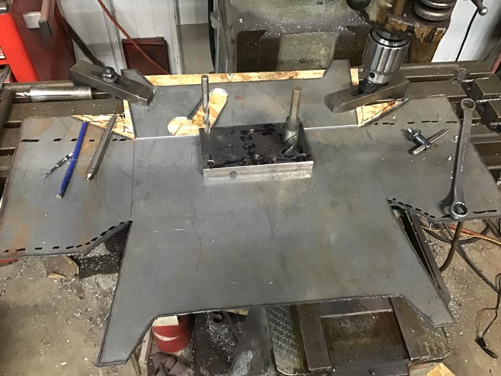

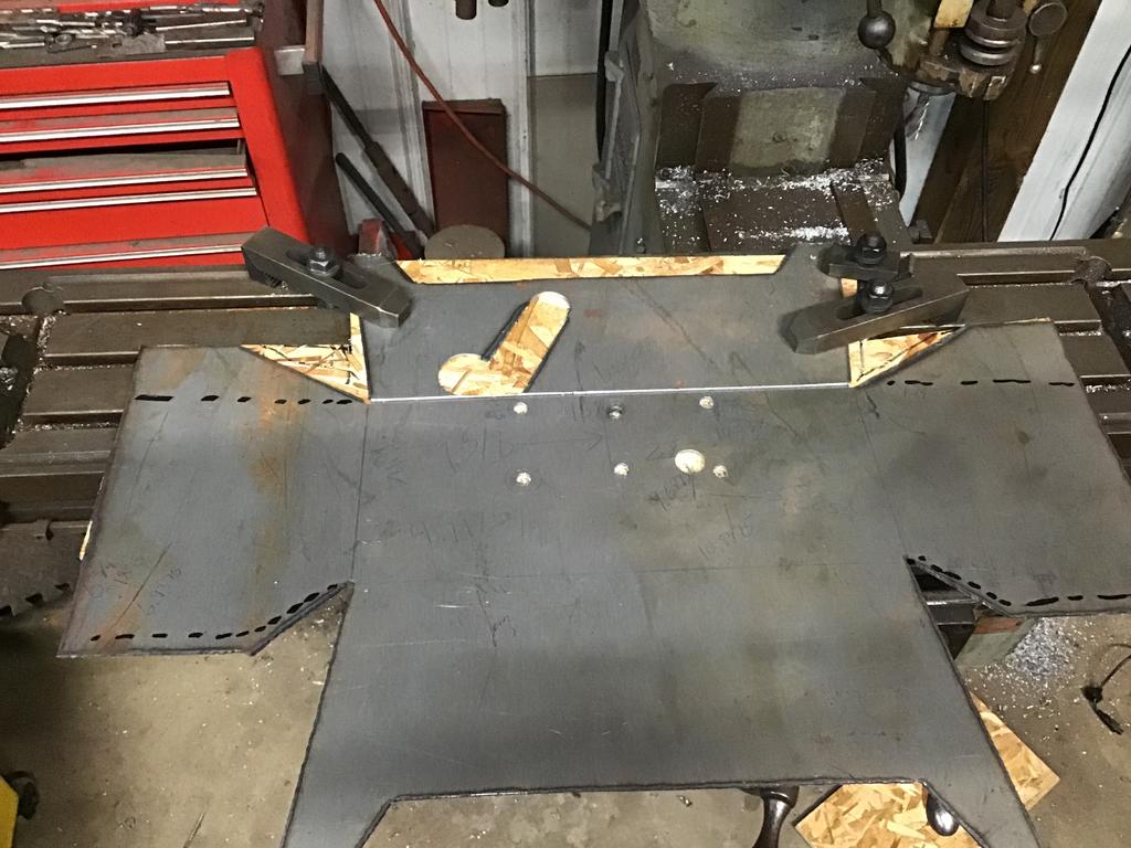

Pullstart 69,195 #339 Posted January 7, 2019 I indicated in my “critical” bend line, then laid out the holes. It worked out pretty good! While it’s on the table I’ll buzz the top edges of the box flush and square. Probably not the most ideal way to skin this cat, but it’ll be accurate, I hope! Enough for tonight, see ya! Share this post Link to post Share on other sites
19richie66 17,821 #340 Posted January 7, 2019 I have cut slightly into the metal with a cutoff wheel to where it would bend, make the bend, tack the corners and then go back and fill the cut with weld. As long as it is not a load critical piece I don’t think it would be a problem. 1 1 Share this post Link to post Share on other sites

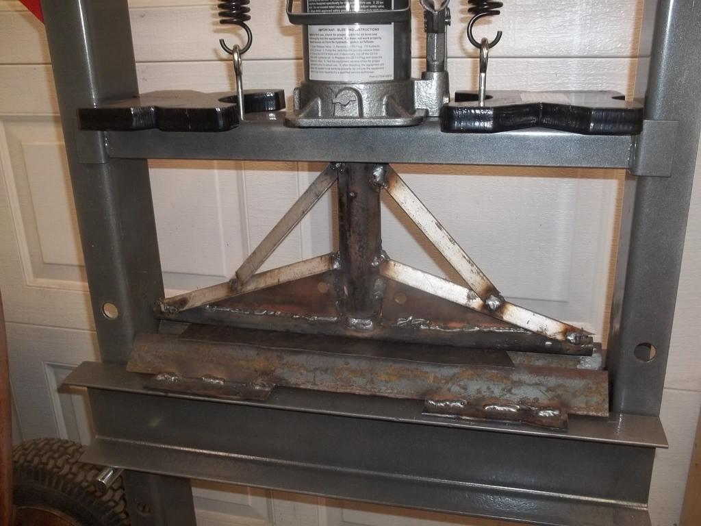

953 nut 64,599 #341 Posted January 7, 2019 I made up a box break of sorts to use in my 20 ton press. Not too professional, but it gets the job done. The upper piece in the photo has 1/2" pipe to provide a rounded bend, but a piece of angel iron cut to size for your internal bend would give a good sharp bend. 2 2 Share this post Link to post Share on other sites

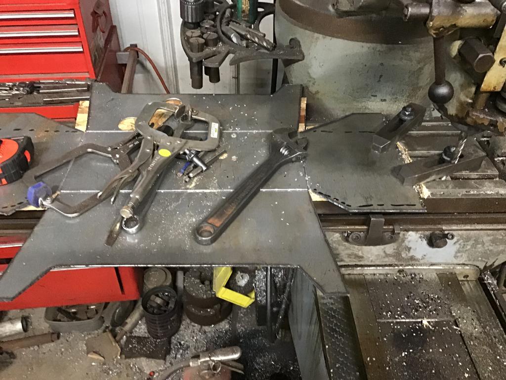

Pullstart 69,195 #342 Posted January 7, 2019 Richard I was thinking of using some vertical force to do the bending, but believe it or not I don’t have an arbor press. It’s one of my bucket list tool items. I thought about using some other hydraulic force, like the in floor hoist, but decided that’s too risky! I like the design of your brake though... maybe some day I’ll build one too! 3 Share this post Link to post Share on other sites

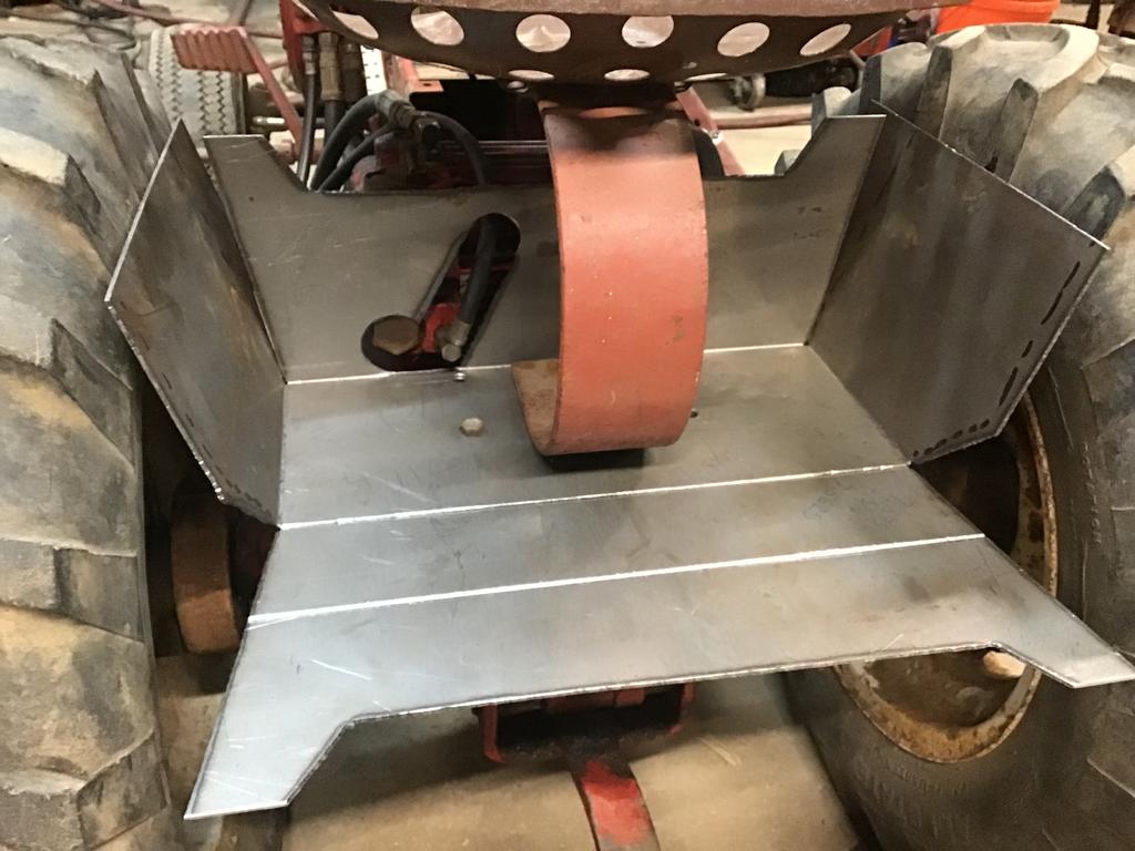

Pullstart 69,195 #343 Posted January 7, 2019 It’s taking more setup than I expected, but I’m already into it! 2 1 Share this post Link to post Share on other sites

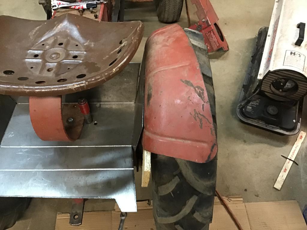

Pullstart 69,195 #346 Posted January 7, 2019 Oh boy oh boy oh boy I think I’m gettin’ excited! 4 Share this post Link to post Share on other sites

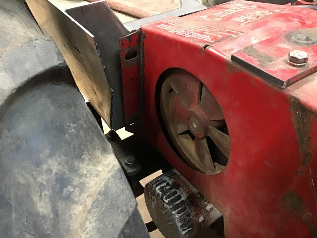

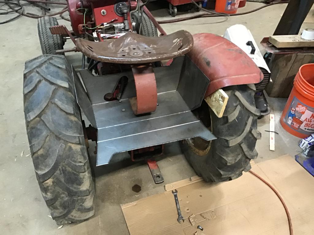

Pullstart 69,195 #349 Posted January 7, 2019 Belt guard modified a bit, need to trim the top a bit. 2 Share this post Link to post Share on other sites

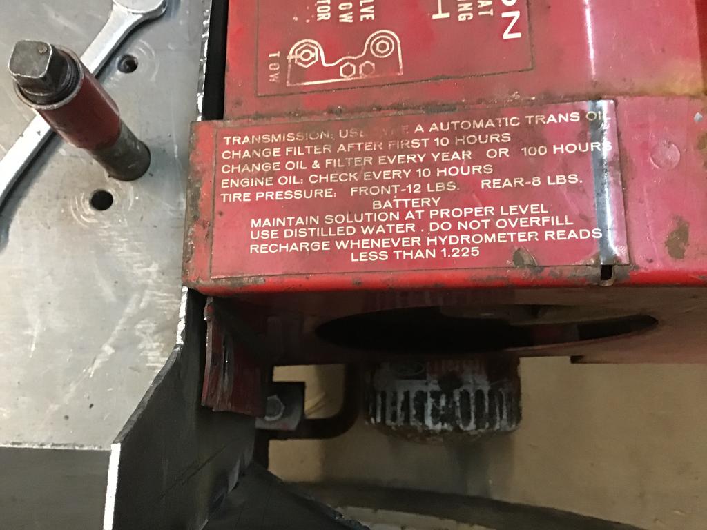

Pullstart 69,195 #350 Posted January 7, 2019 I’ll take this time to point out that I DO have a new trans filter for this, once fab work is finished up I’ll clean things up and change the oil. 1 3 Share this post Link to post Share on other sites
